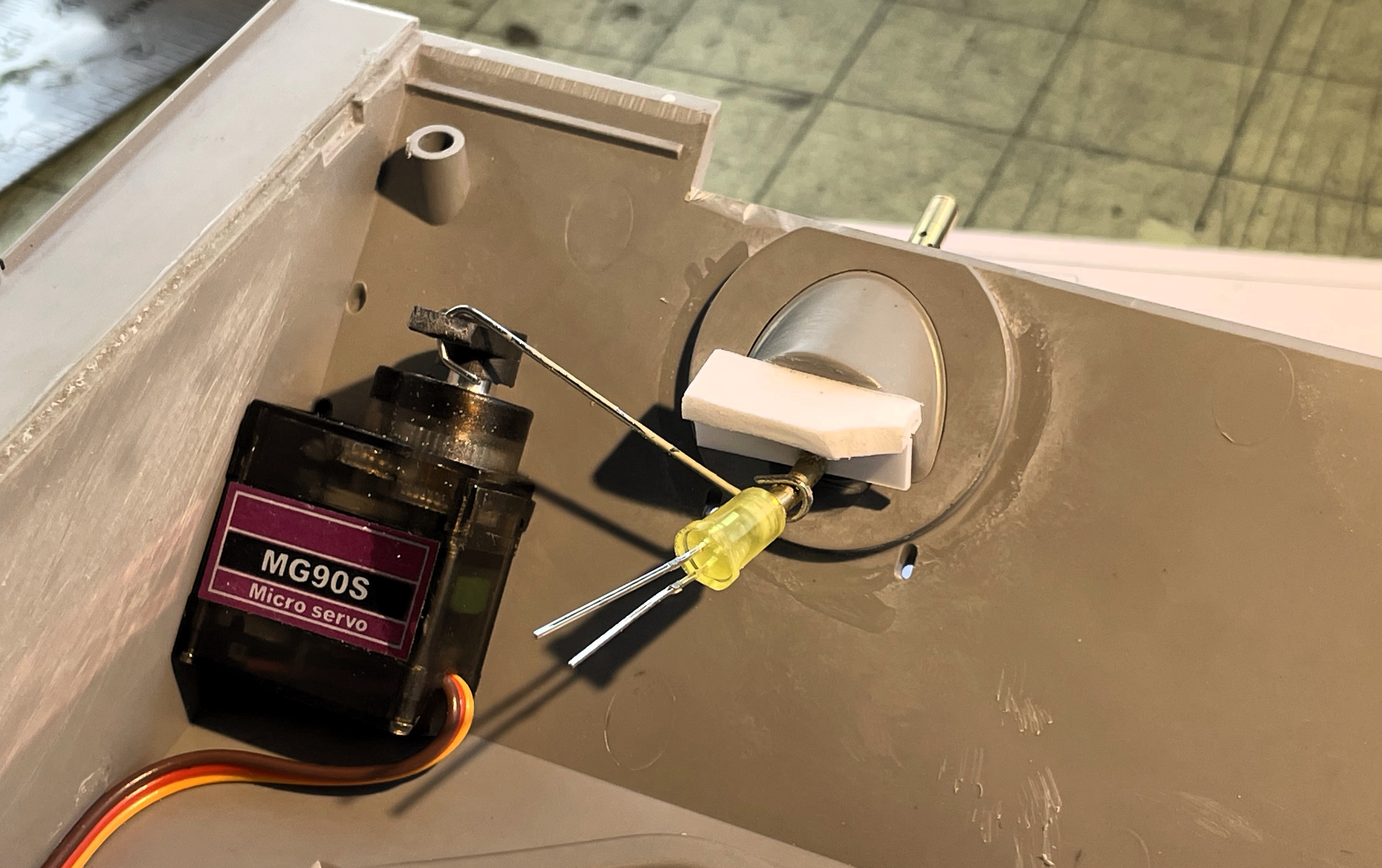

So i had an idea, since the hull machinegun on the HL Panther G is pretty good articulated, i thought i might try and build a way of making it swing left to right when the machine is used.
So i bought a RC “Lyre” (dunno of its the right word, but that thing offroad vehicles have to pull themselves out when they are stuck)
Because this would have a nice slowed down rotation, on which i could connect a wheel with an arm that would connect to the MG ball-mount, a bit like a locomotive wheel.
(Sorry if use incorrect terms, im not an engineer)
Anyways, my thought was to just to connect the little motor to the same connector the MG light goes to but than i started thinking the led of the MG flashes and of course i would want the motor to run continuously while firing the MG.
Is there any easy way i could get this to work?

You’d have to use a mini servo to get the MG to swivel, it has been done before.

:) Exact already done, on this forum, with photos and explanations, see Sherman by Imcq11 :thumbup:
viewtopic.php?t=34892&start=20

"of course i would want the motor to run continuously while firing the MG." :think: I would want the MG to fire while I could independently move the barrel. That could be accomplished with a micro servo such as you see above and an electronic MFU (maybe the HengLong 7.1?) with the capacity to run the servo independently.
