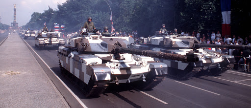

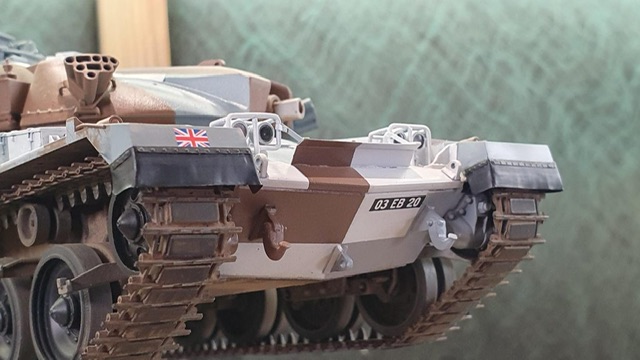

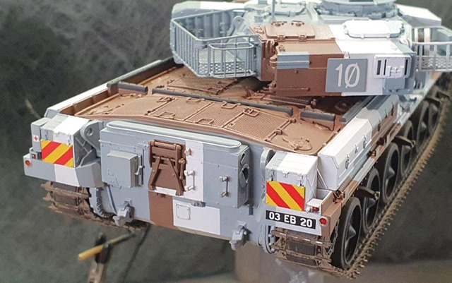

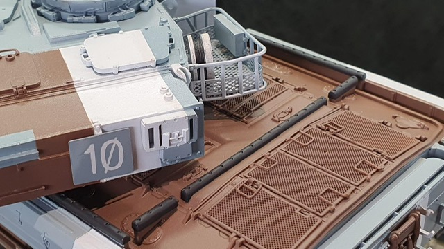

Some inspiration for you Mr Zooma.
Up until 1982, British armoured vehicles in West Berlin were camouflaged in the standard pattern of green or green/black.
With the deployment of D Squadron, 4th/7th Royal Dragoon Guards, the commanding officer started to challenge this way of camouflage as the vehicles always looked out of place in urban areas. After trials on cardboard it was decided that a rectangular pattern of white, grey and brown would best match the buildings, windows, doors
Don’t half fancy doing a Challenger.

That is rather nice
Is it one of yours?
It might be a bit ambitious for my painting skills

I wish. I just posted these, for fun, as you wanted ideas for Berlin Brigade. I fancy a Chieftain, or Challenger, in this camouflage, one day.
