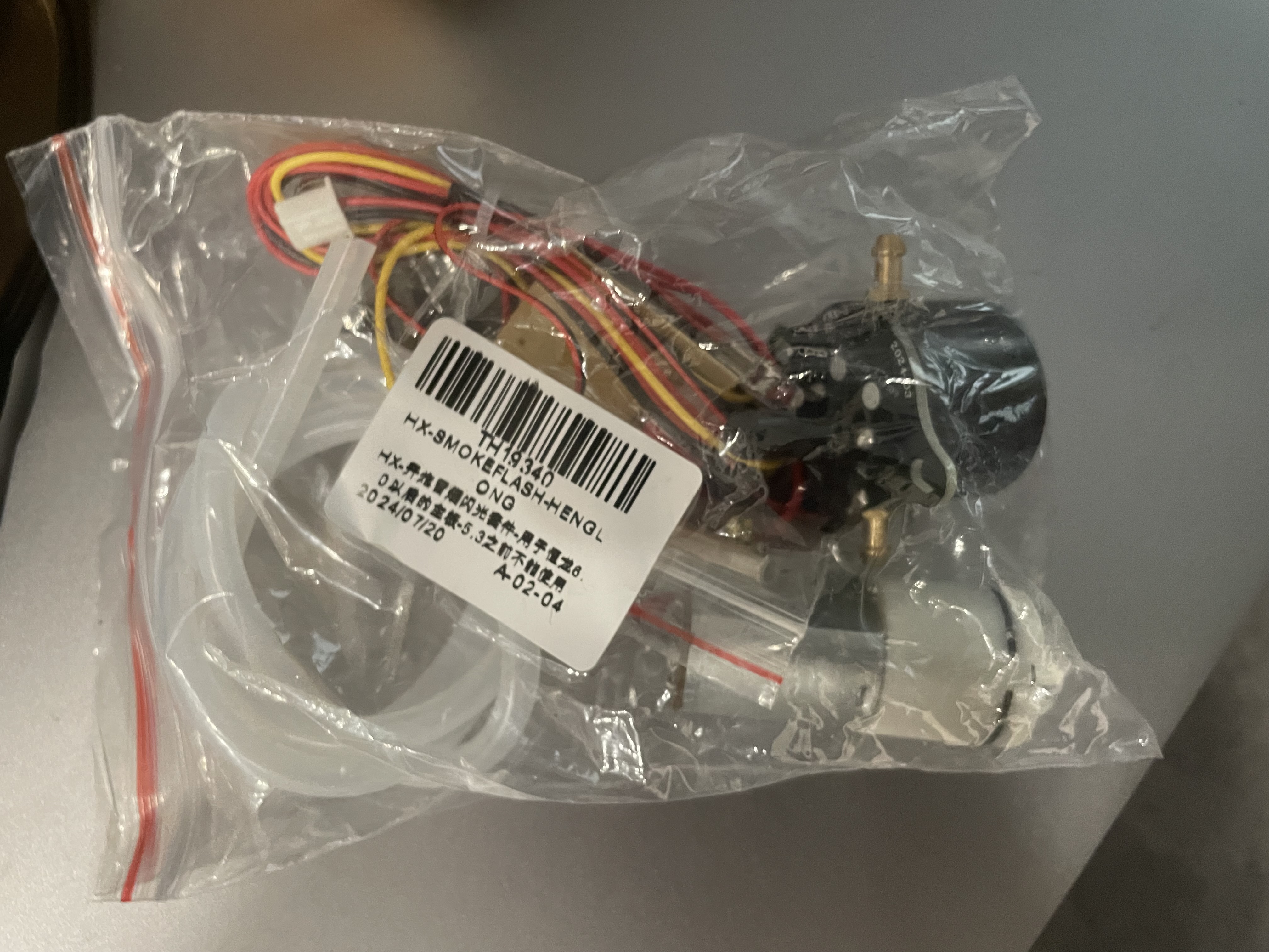

Denis

Hi I'm just about to try and get this working too. Check this out. Think this is the way to set it up.
https://www.facebook.com/share/v/AZMxbnUmPYcUZngg/
You can set the recoil to be air pump on the claek settings.
I just need to figure out how to get the power into it. Not sure if I split the power into the board and run a dedicated supply to the switch module or a dedicated second battery. Don't think there is a second socket on the clark board that would supply power to the smoke gen unit for the barrel smoke.

Hello Velthal, looking at Gillaspy's video, you have the solution.
Gillaspy,
Currently do not see on the video? if only one battery for the whole, or 2 separate batteries? What exactly are you looking for? have more power, smoke level? already not bad, or more electrical power? battery capacity?
I think it is possible to use a second battery, but be careful with voltage mixes, in order to avoid transforming into a "Barbecue «  :{ avis perso !!

If I look closely at the video, it seems to me that the smoke bomb control board only works with a minus (black wire) and TK signal (white wire) the + (red wire) is not connected? hence my question, about the mixture of tensions, with a specific battery? but maybe possible, other more competent members will give you an opinion

The signal in to the switch runs off ch3.1 and ch3.3 so no connection for the middle pin. Nearly.got it all hooked up at the moment, will see if it works, will let you know if it does

I've soldered another jst power cable off the power switch loop to feed the switch module, will use the nimh main battery pack to feed everything, I am basically adding in another smoker. In effect the smoker has a direct power feed now that I can turn on and off from the clark. What do you think?
Will post some pics to tell the story and help anyone else to do it if it works.

:) the card on the FB video is not a TK 60? hence my questions? However, I would recommend installing a fuse (mini 10 A) just after the battery. If I understand correctly? you take the 7.2 volts 2 in parallel on the power supply of the Clark card? which is OK. Be careful on the general interchange, there is no more and less? Chinese logic does not systematically respect the color standards of other countries, we can have a common thread, as being a minus? Generally, Inter only cuts one wire.

If I understand correctly, the pump control can be connected to the place where the airsoft gun is connected. Well, the filament needs to be plugged in instead of the main smoke machine or through a separate battery.
then the question is how the gun works. Do you have to choose between airsoft and xenon, or can you use them at the same time?
I would like a xenon flash + smoke.
I found out for sure that elmod can implement this. But for Clark, I don’t know.
