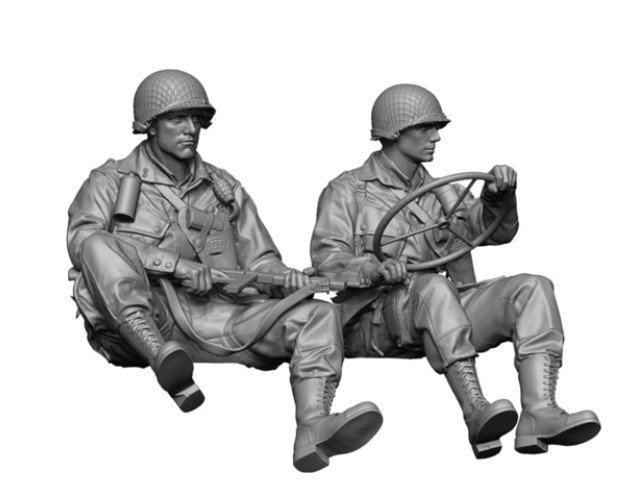

I have wanted a driver for my WCP 4X4. Today I dug out a possibility. The potential driver and passenger for the WCP 4X4 were airborne troops carved and 3D printed by H3 models of Korea:
Jeep Occupants 01 (83).jpg (43.8 KiB) Viewed 5401 times
https://eng.h3models.com/product/hs1602 ... display/4/

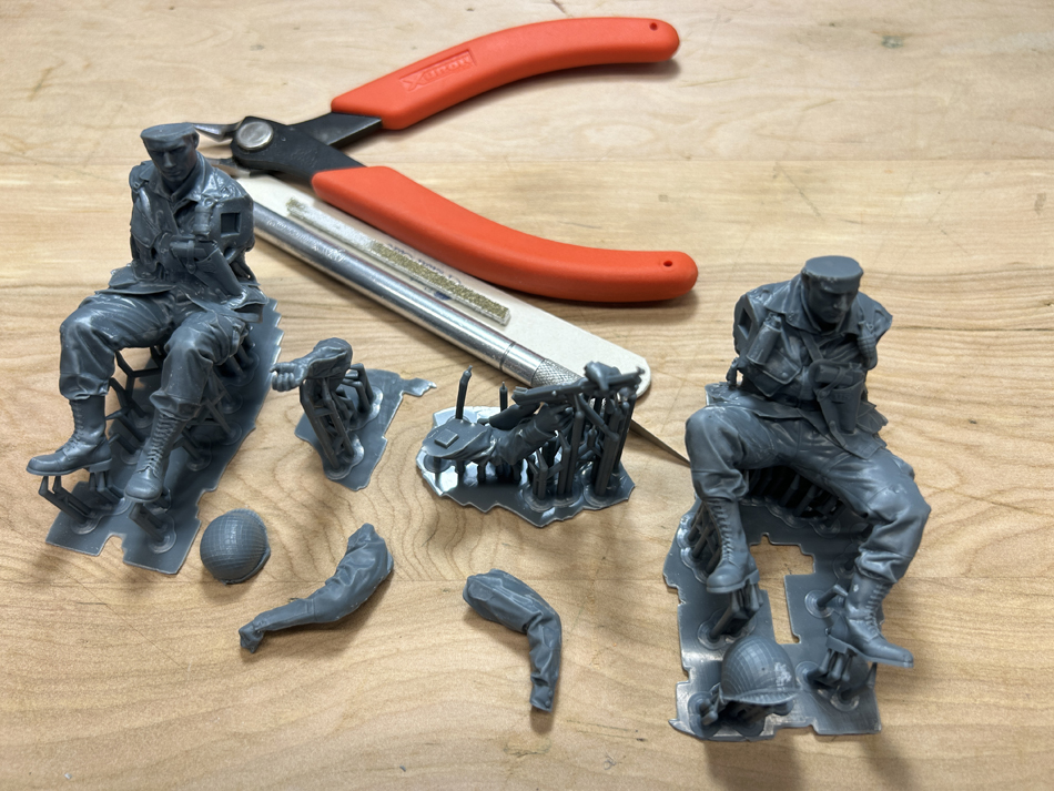

I had to cut the parts of the figures off of the 3D supports, always a tricky task. Using a sharp, fine pointed sprue cutters, I cut the braces off the base away from the figure so as to help minimize breakage of delicate features of the figure. Then using the same sprue cutters, I worked in closer to the figure, snipping off the supports. Even so, the machine gun in one figure's right arm broke at a delicate part. I was able to glue it cleanly back together with cyanoacrylate. Whew! In the following photo, you can see some parts already cut away and others still on the supports.
Jeep Occupants 02.jpg (513.92 KiB) Viewed 5401 times
By comparing the two photos, you can see, too, that I carefully cut away the 3D cast steering wheel and sanded then hand to hide the evidence. After all, my WCP 4X4 already has a steering wheel, which I made removable so a figure can be fit under it.
I then had to carefully sand away any little "nipples" left from where the supports were attached to the figure. After all that preliminary work was done, I slipped out the 4X4's steering wheel and tried fitting the driver in place.
Not a chance!... not even close! Oh, well, the figures will be useful for some other AFV.

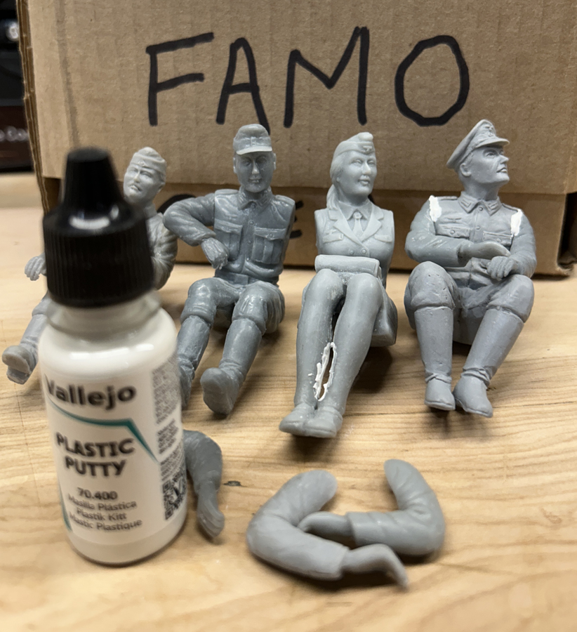

I also have a set of figures for my FAMO, these include a driver, rider, a woman courier holding a bag of important documents, and an officer. These figures seem to have been cast of resin, and one even came with some repairs and the arms already attached. :eh: The 3D printed H3 figures (see my post just above) are more realistic and detailed, but that FAMO needs sitting passengers.
In this case, the castings had flaws needing sanding and filling. Here you can see the figures, some already with filler drying in place drying. I am trying out Vallejo's Plastic Putty (70.400), applying it with the tip of a toothpick. (I sharpen round toothpick tips by sanding.)

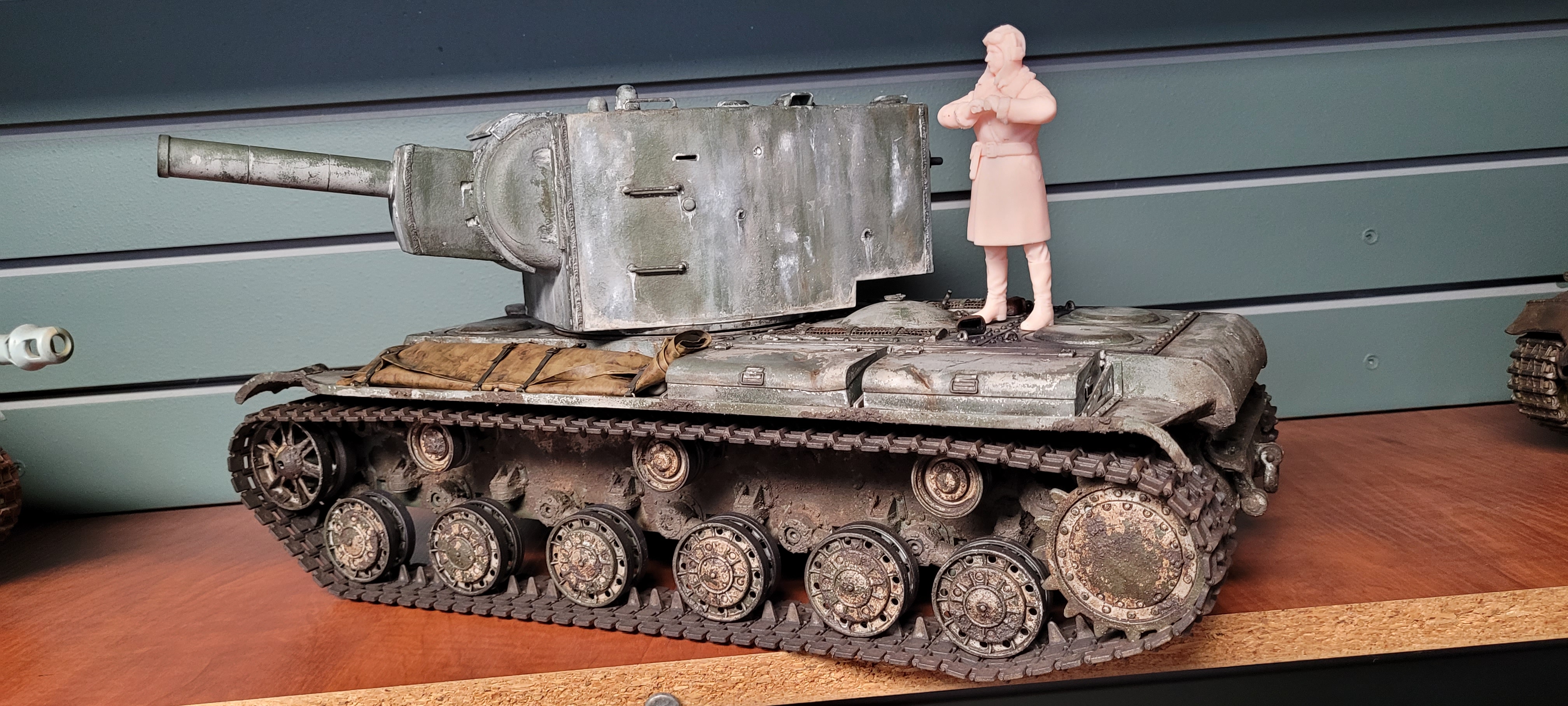

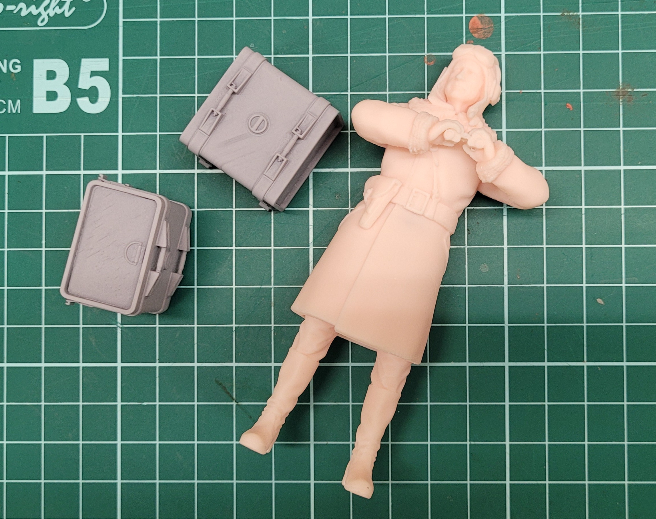

Back during a KV-2 build, RCTW enabler Herman Bix sent me a couple of fuel tanks plus this little cutie!

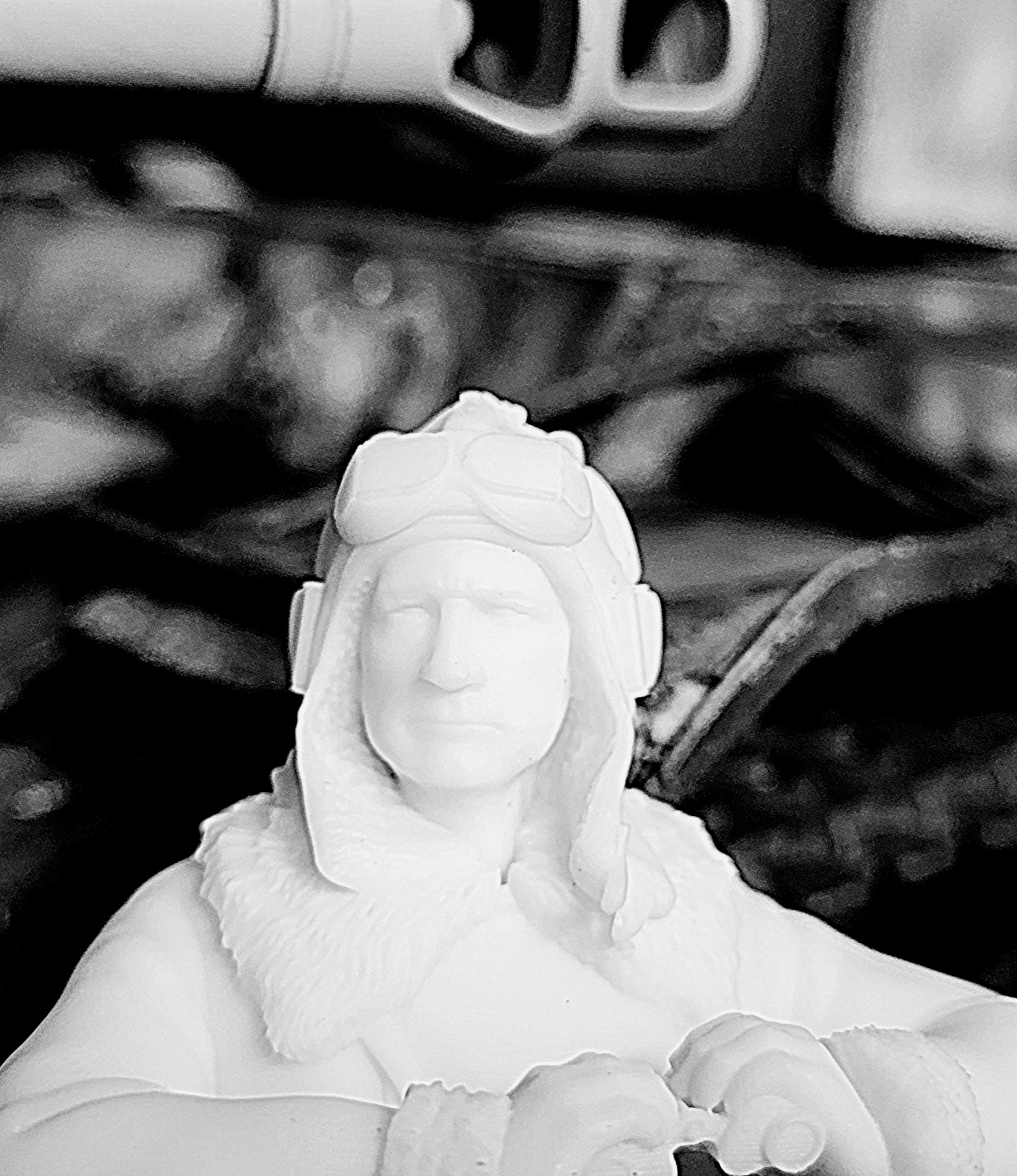

HB even offered to paint it up for me (whaddaguy!), but I politely declined saying I needed to face my demons...one of them being faces! Enter HDP messaging me with a great idea: let's do it as a mutual support group build, share/swipe/copy techniques and get some figures done!
Posed him like this:
And immediate memories of the box art on that Fujimi 1/76 KV-2 I built maybe 45 years ago!

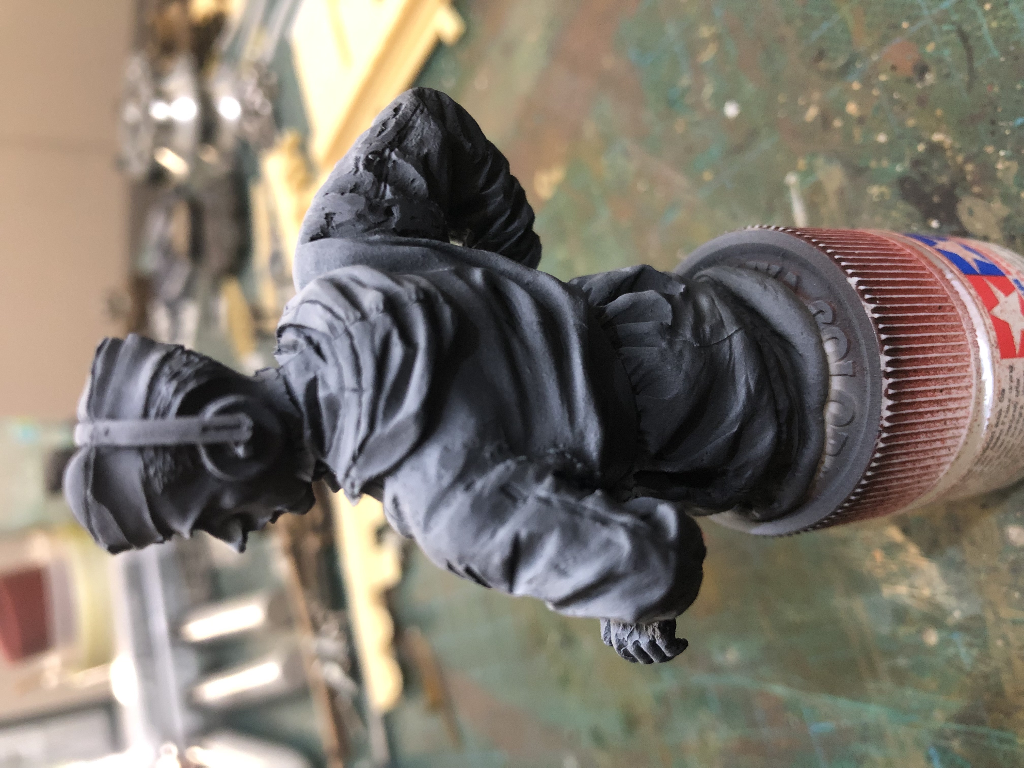

He'll get a quick primer coat so I can see the rough spots etc. He reminds me of the famous photo of the the poor Leningrader and his tiny crust of bread.
I know my challenges will be getting the right winter pallor for his face, the eyes, and the right look for the binocular optics. I'm really liking the approach by this figurist(?):
