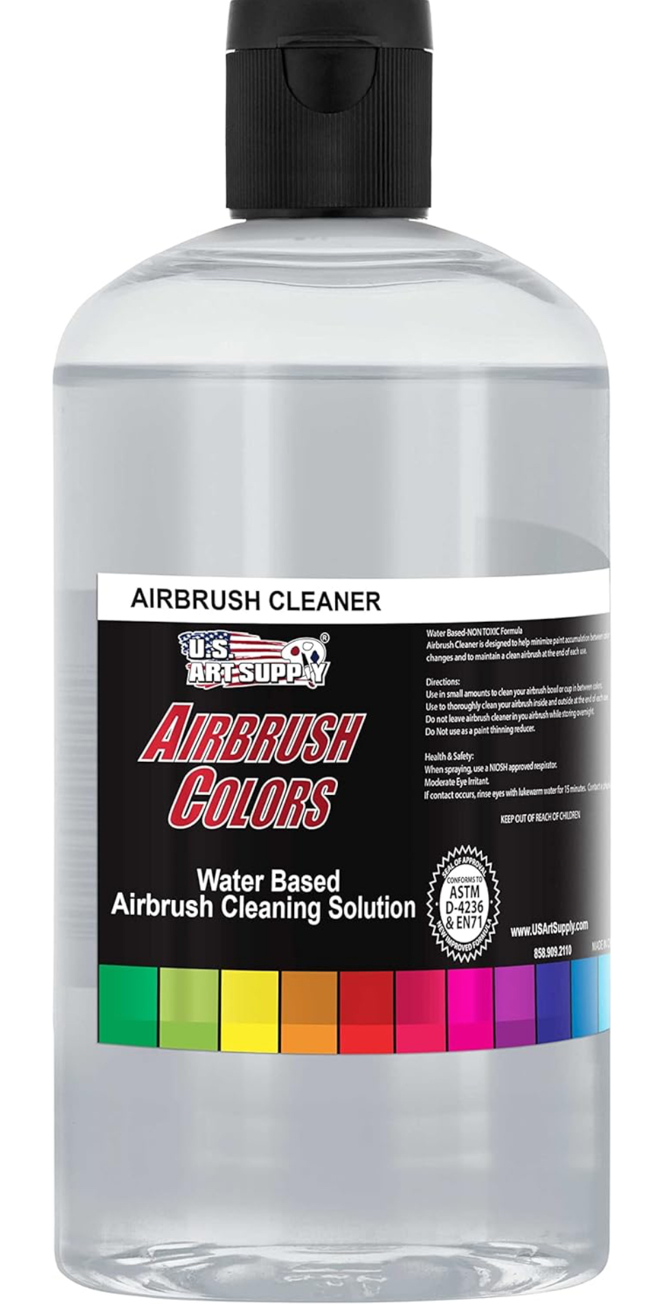

Hi guys im a total beginner to art of airbrushing ... so i went down to my local hobby shop and got myself some Tamiya XF Acrylic paints. I know that im to thin the paint with the Tamiya X-20 Thinner but my question is -
What do i use to clean my airbrush and not destroy it?
Water? Thinners? Alcohol?
Thanks all! Image Image

I am quite fussy about cleaning my airbrush. For acrylics, such a Tamiya, I immediately put the nose of the brush in Windex, which I buy in gallon jugs at "big box" home improvement stores such as Home Depot or Menards. Then I disassemble the needle and cone to clean them in a small amount of windex, carefully using cotton swabs and pipe cleaners. I then wash everything in warm water, inspect it, and reassemble it. I can be even fussier, so my air brushes last a long time (I have one age 52). There are also commercially-produced airbrush cleaners. I often use one sparingly on the disassembled brush. I clean with this care even when changing colors in a given painting session.
