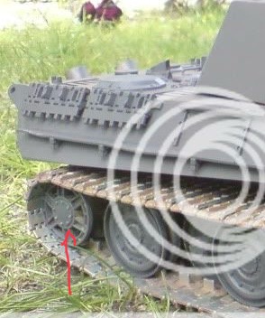

:'( Sorry photo quality....this kind of cover, pass a thin blade between this part and the wheel, see if it can be dismantled? Have you looked from the back if between the wheel and the side of the tank, not a hidden screw? what is the track tensioner?

A clearer photo...red arrow, part that needs to be removed? blue arrow, here you have to insert a thin blade and lever it, on both sides at the same time would be better, personal opinion

If it's the heng long idler with the hole in the middle then it's a phillips head screw Image

:thumbup: So, it is necessary to remove the small cover in the center, and not where I indicated in blue?

Jofaur86 wrote: Fri Jul 05, 2024 8:54 pm :thumbup: So, it is necessary to remove the small cover in the center, and not where I indicated in blue?
Your picture is of a Taigen sprocket not a heng long the heng long has a hole in the centre with no cover the Taigen has a cover over the screw

:'( OK, sorry, but they look a lot alike? would have learned something, thank you
