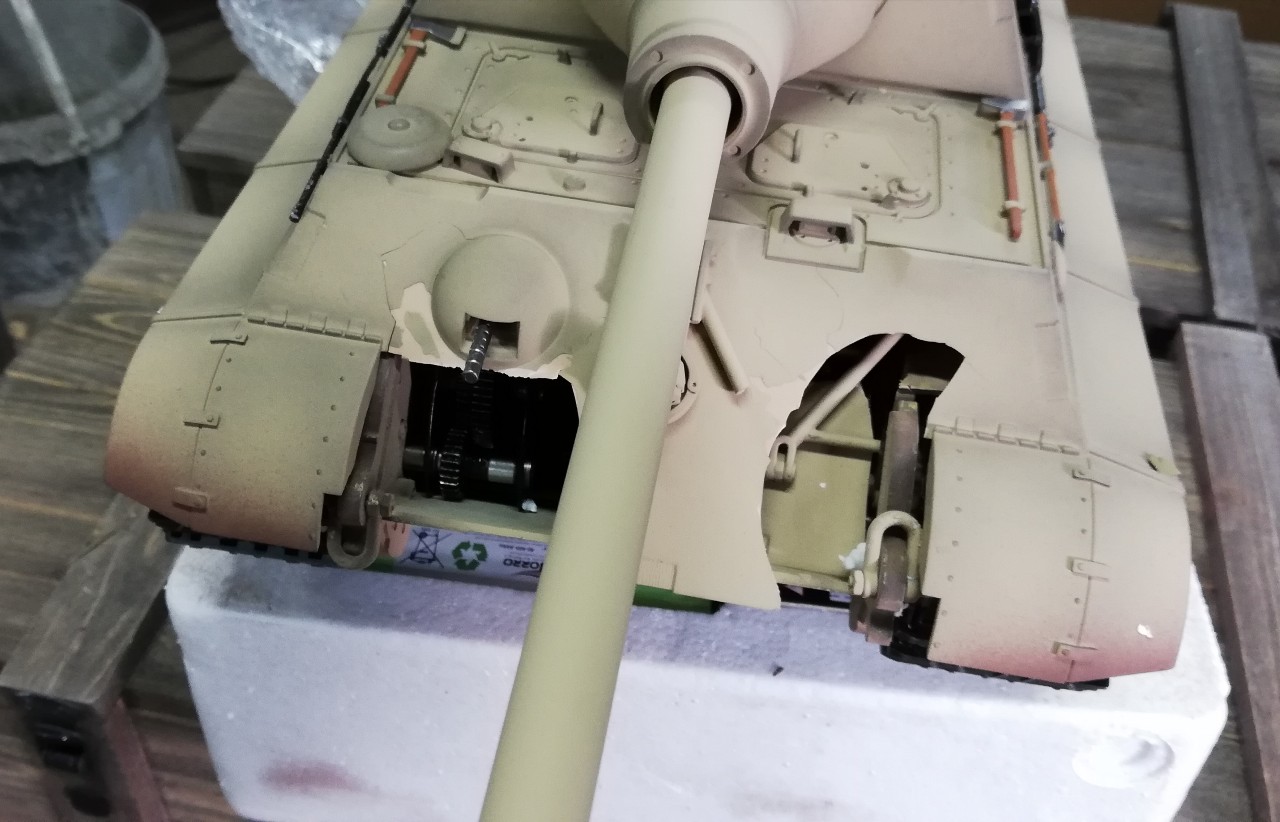

Yeah, Taigen plastic is brittle, mine Jagdtiger was destroyed in shipping few years ago
Combining Mato, Taigen and Heng Long elements sometimes causes problems (e.g. the turret ring may be different as in the case of my Sherman modification where the lower hull and turret is Taigen but the upper hull is Mato). Sometimes this means a lot of cutting, sanding and puttying
