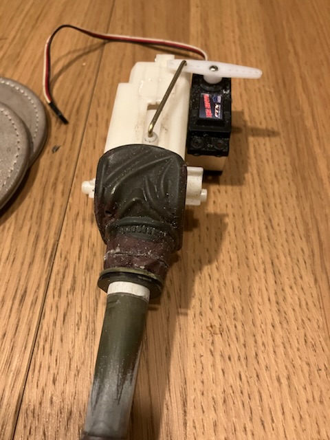

The tank recoils when I fire the main gun but the barrel is fixed. I am looking to add a recoiling barrel. Am I right in thinking that that the barrel and mantlet are moulded as one piece? If I’m right I would need a separate barrel and mantlet to allow the barrel to slide in and out. Question is where can I get the parts that i need?

Thanks for getting back to me. I’ve been a member of this forum for quite a few years but took a break for a couple of years. I’ve managed to use my existing account with some help from son of a gunner. I’ve just got the one tank at the moment which is a hl king tiger with a tk7 board. I’m planning to swap to better electrics so that I can add more features. I think that I’ve found what I need from forgebear but if you have a suggestion for re-using the existing barrel I’d be interested to hear about it. The one at forgebear is the h/l snap type recoil but once I swap the electrics I am planning on fitting a Servo recoil

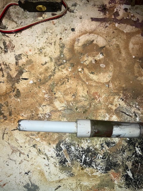

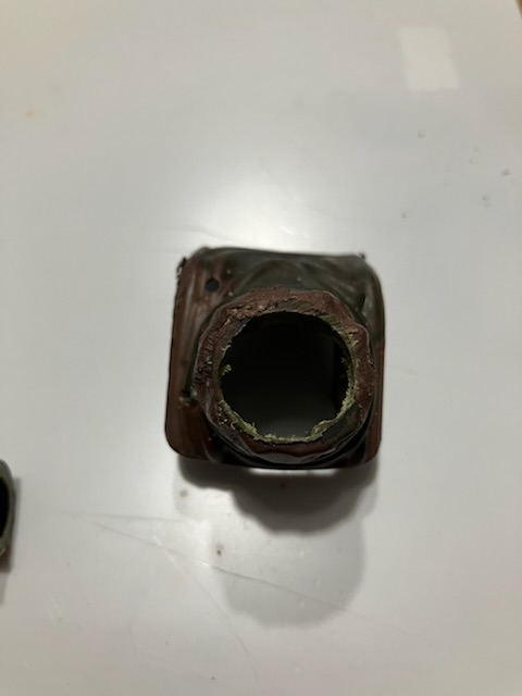

Hi Percy 1510. Welcome back to the family. The HL, as you call it, snap barrel can be adapted to servo. To use reuse the existing barrel involves sawing, filling, and drilling. Essentially, you cut the barrel where it enters the mantle, extend the barrel, and then drill and file out the mantle.

Think I will order the snap recoil from forgebear to give me the separate barrel and mantle then use your method to make into servo recoil. Thanks for your help
