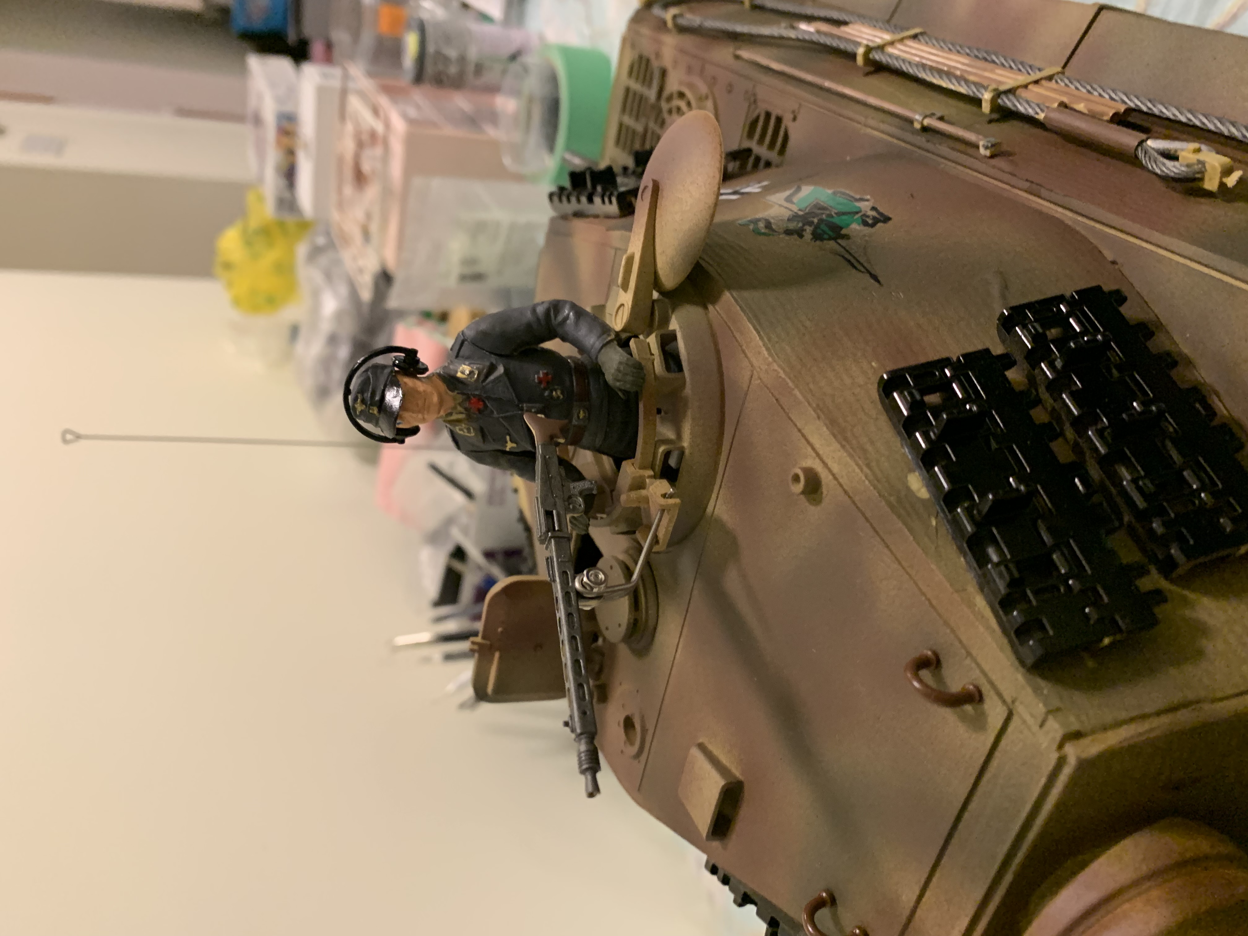

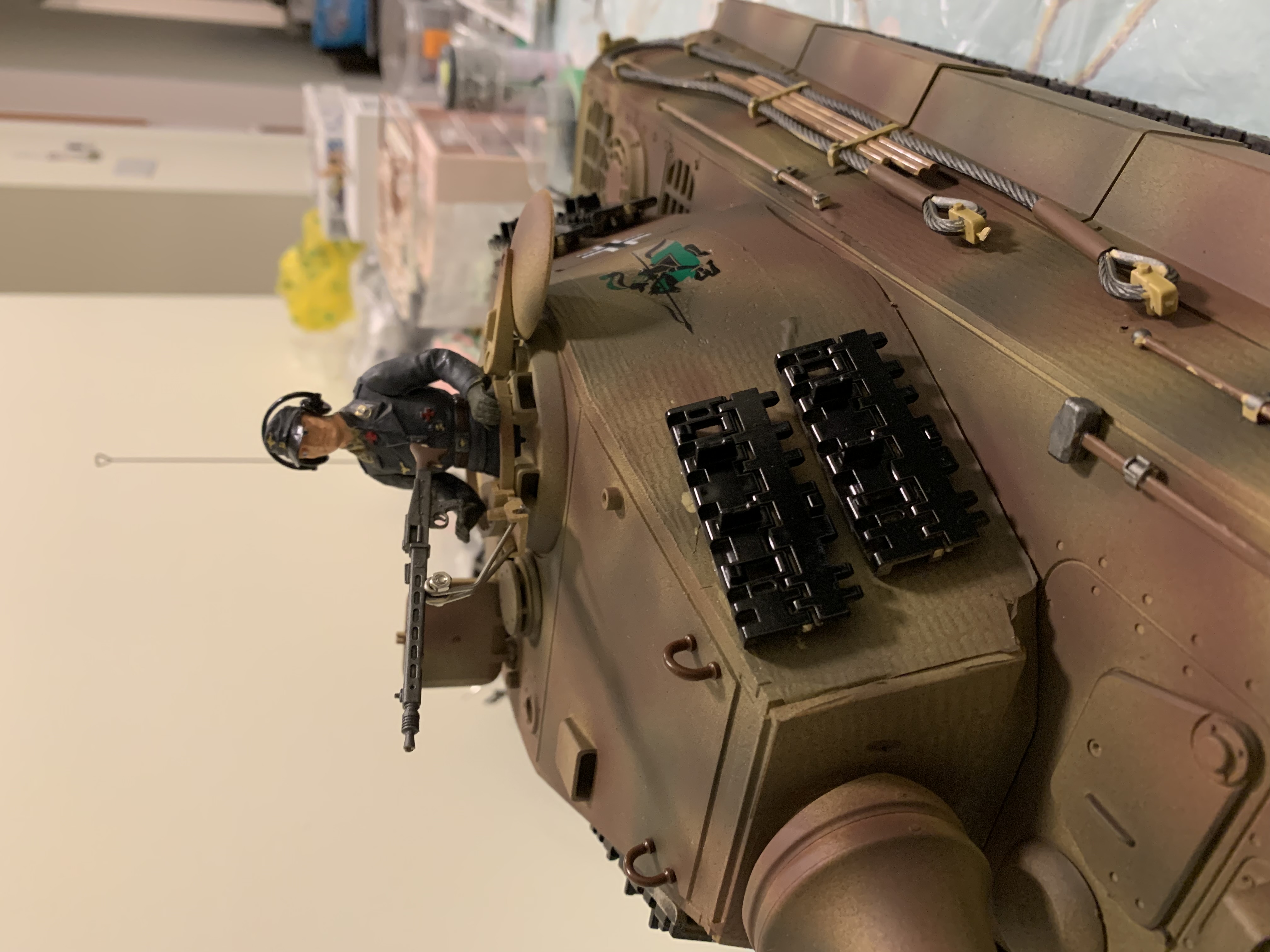

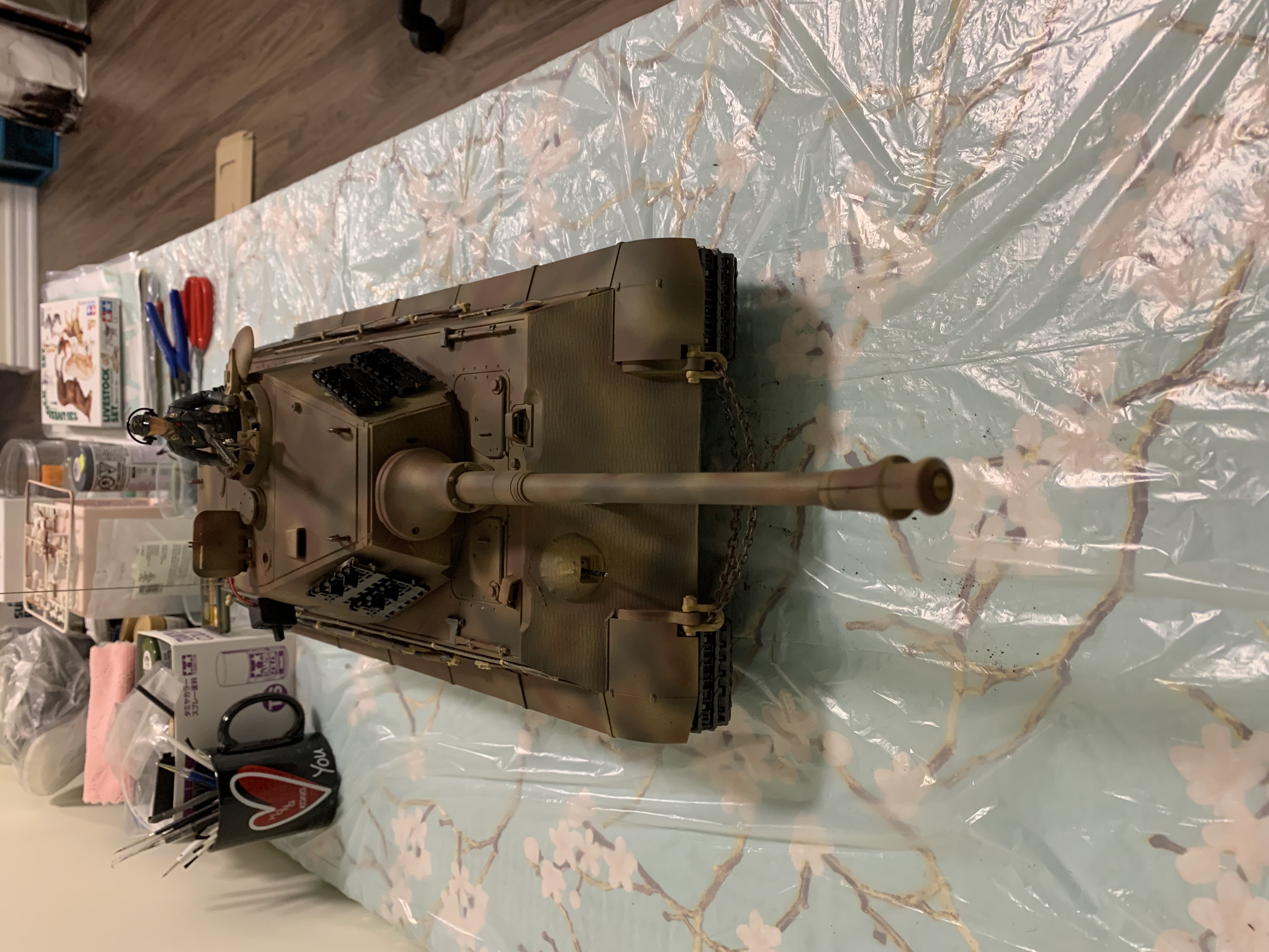

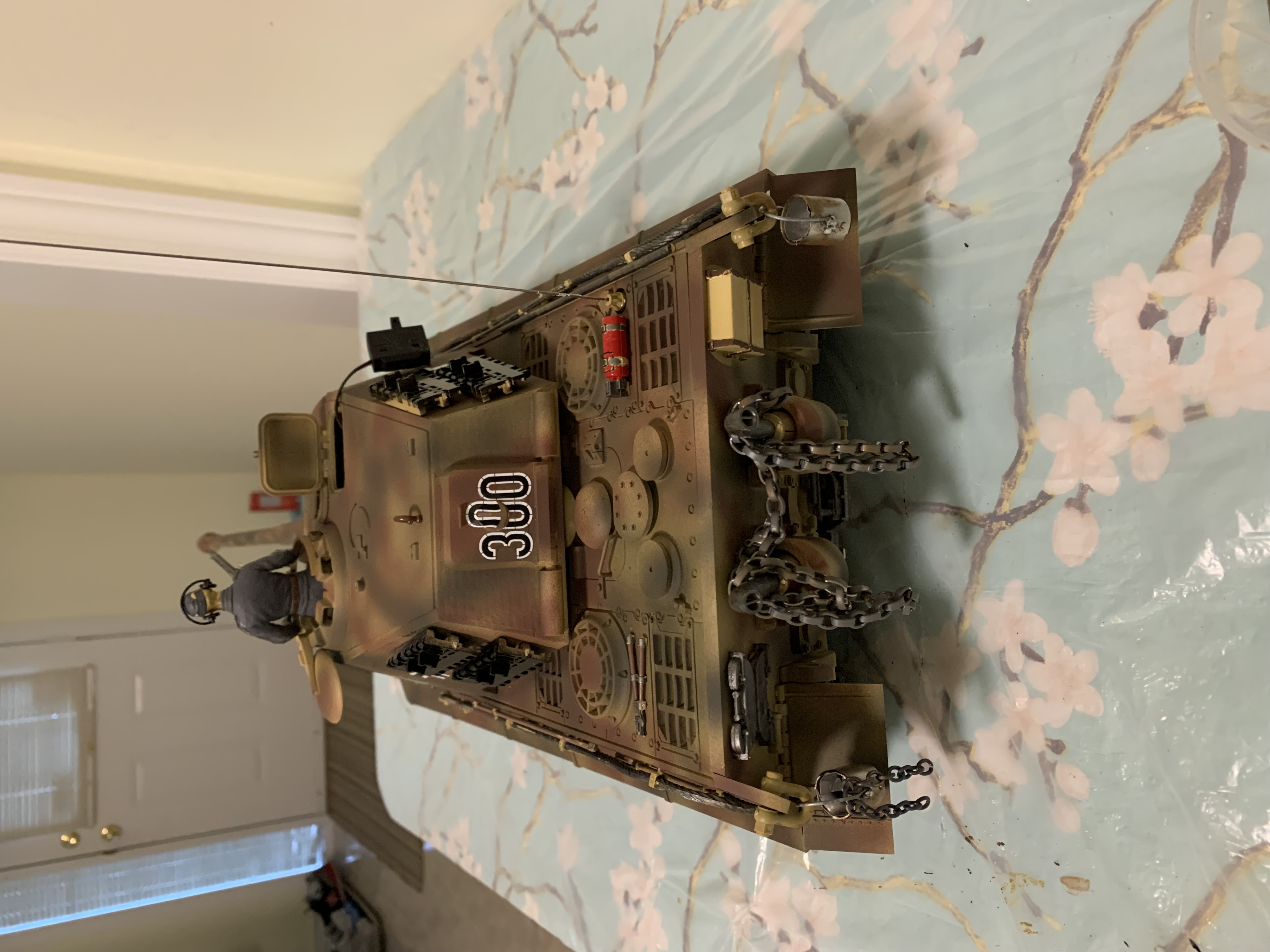

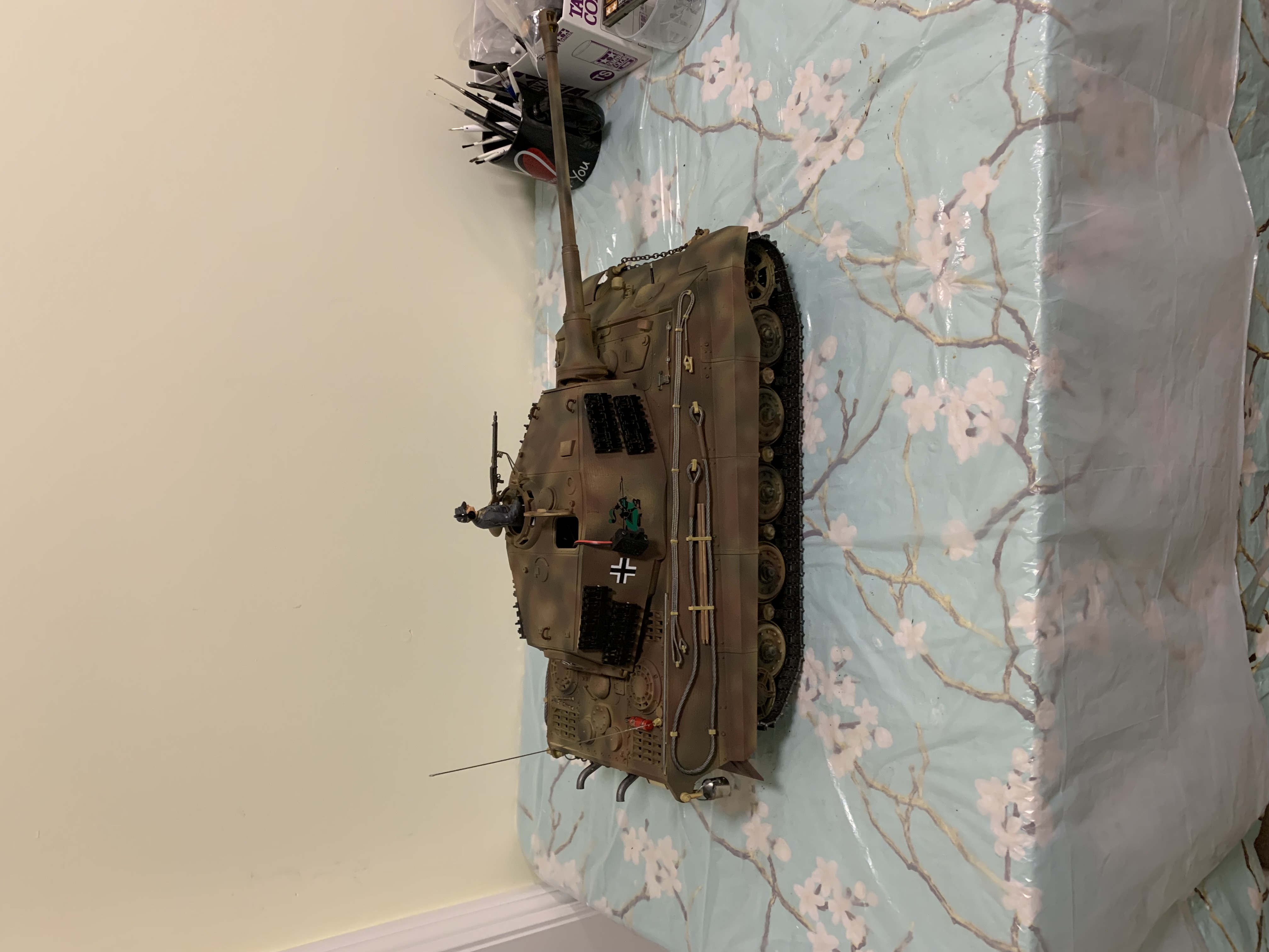

Hello Everyone,
Finally completed my King Tiger build and I received a lot of help and just wanted to say Thank you to everyone who have helped me out along on this journey. Below I will also post issues I came across as a future post for people who build this tank and how to best solve them
1) Tank Recoil is forwards/Tank goes forward when pressing backward
Easy fix will be switching your drive channel to reverse but it only fixes that and not tank recoil where it still jumps forward, so swap motor wires within the same motor, flip your channel drive switch to whatever it is so from normal to reverse or vice versa
2) Weak or cannot rotate turret
Buy the TAM 72005 take out the clutch gear and install that lots of instructional videos on that
3) Gun elevation not working
Make sure the MT2 and MT3 is of the correct position
4) Road wheels not spinning
Play with the track tension, first lock the idler arm than tension it tightly down
5) Road Wheels
I built mine wrong with both disc touching each other leaving close to no gap when going between track teeth. Make sure to assemble it correct which means both disc in opposite direction, make sure back of A5 the nudge that sticks out wraps around the first disc and second disc with screws goes into the A5 holes. If built correctly A5 should sit inside of the metal disk with a gap between both disk.
Courtesy of Rad, Jofaur and Panzer
Courtesy of fellow forums and people who contributed to solving my issues,
Thank you

It was a good idea to list the fixes for various control problems for others who might build the Tamiya Königstiger. :clap: I like the range of gun depression, something not always as great on other RC tanks. Then, too, the speed of the turret rotation, seems realistic for a WWII tank.
