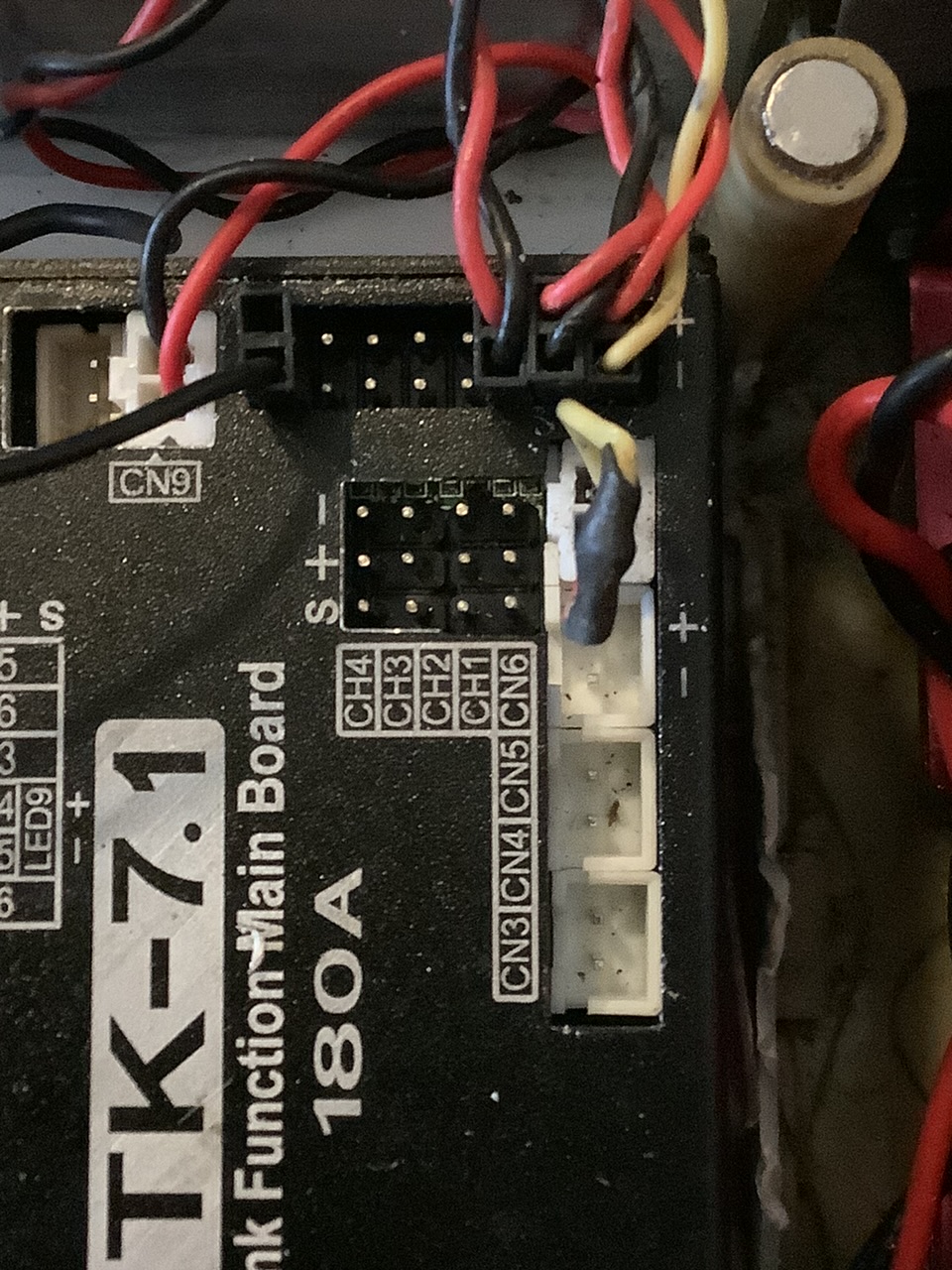

If I may ask? Is the cannon smoke an after market one, or was it in the model when purchased? If it was an aftermarket one, have you made a little jumper plug for CN6?

The tank came directly from HL with just a BB/recoil unit in the turret, which I did not want. HL, bless em, and at my request, sent me the metal servo barrel recoil and elevation units to delete the BB function. I then removed all the HL 7.1 system to fit the CS-TK16 mainboard, the dedicated TK16 slip-ring unit with turret daughter-pcb as I want to use my FlySky i6 10ch TX/RX. It DID come with a working exhaust smoking unit connected directly to the HL 7.1 MB. This was reconnected to the TK16 MB via the CS-MY30 control pcb and works perfectly including on/off from the TX. Tried the same idea with the cannon smoker but nothing? (the oil-heater unit does work ok and switches on/off from the TX) But, no matter what I try I can not get the blower/fan unit to trigger a puff of smoke as it does not seem to make the 6v required to fire it from the control pcb?? Completely at a loss just now!

Know anyone on this forum who you think can help? I`m faily sure its something simple, but like you, my `electronics` and with little knowledge/info out there for the TK-16 mainboard the last bit of my tank build seems to have stalled.....for now anyway!
