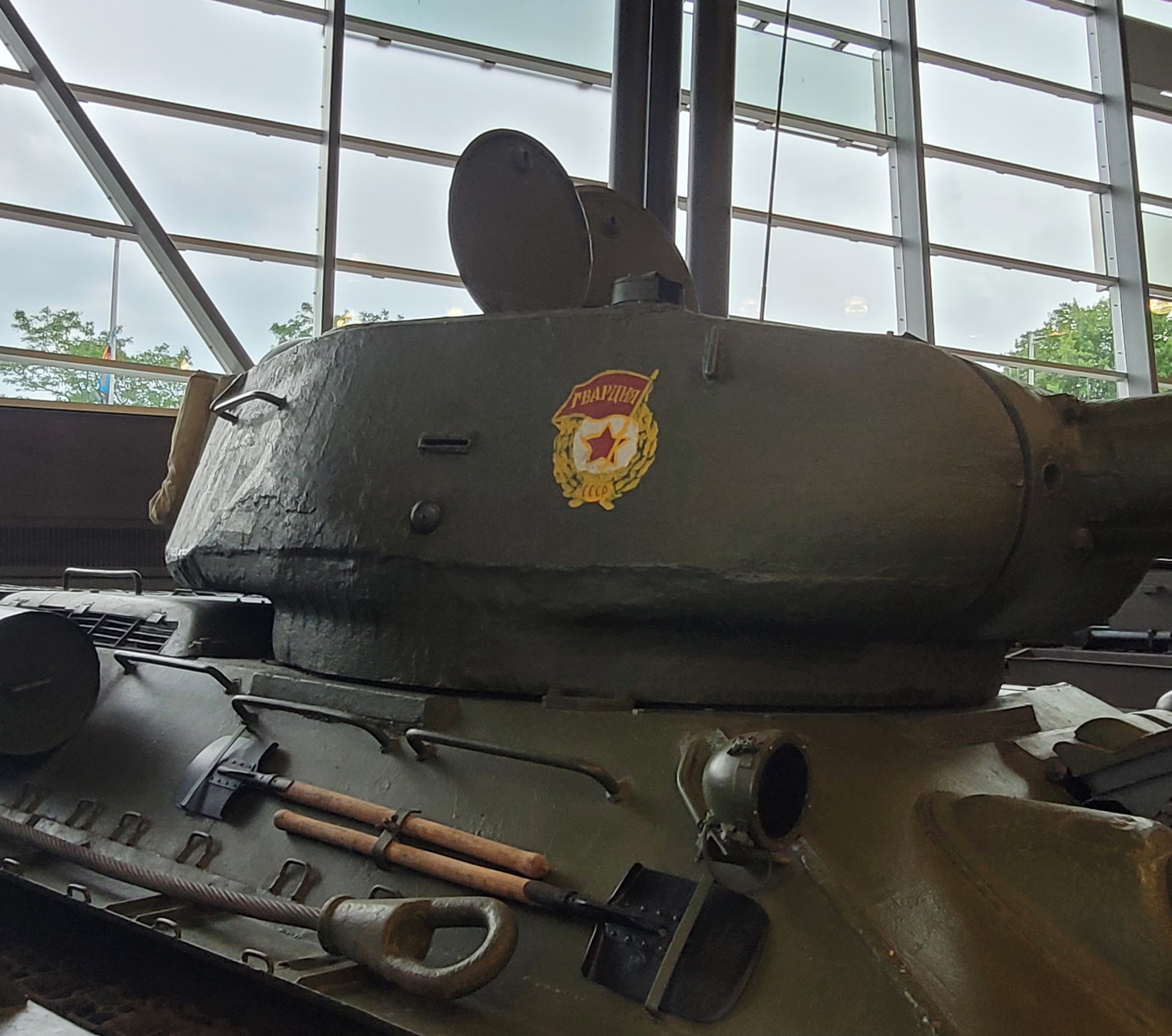

Most tanks should have texturing on the cast and rolled armour areas. The tin work stuff like fenders and grill work areas typically not. Best thing to do is find some walkarounds of your vehicles and really look at each picture for the texture type, roughness of finish, and grinding areas. Check out HDPs M26 in the group builds. He did a nice mix of cast texturing, seam grinds, and the more subtle textures of rolled steel, and the non-textured fender steel, etc.
I'm headed to the Canadian War Museum tonight where they have displayed a T34/85 with what has to be the nastiest, lumpiest, wartiest, pimpliest cast turret on the planet!

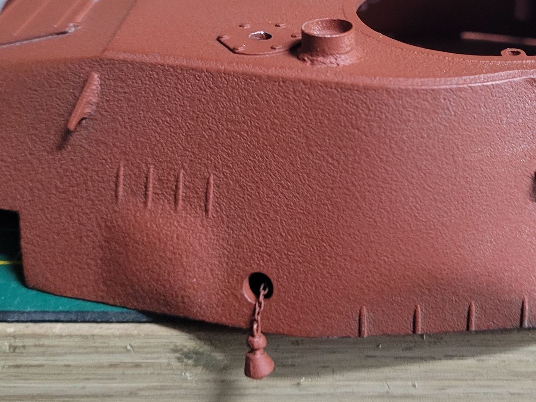

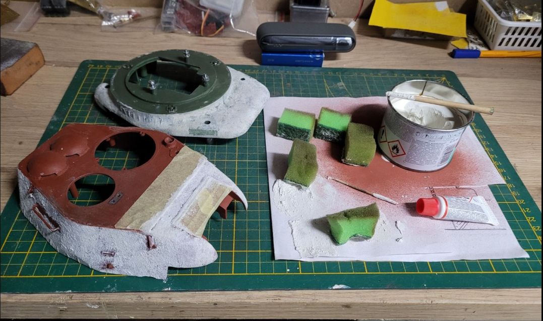

From my friend Andrzej and his T-34 - two part car putty and kitchen sponge:
tankme
Posts: 3277
Location: Elgin, TX
Re: HL tanks: adding armor textures
Post by tankme »
Don't get me wrong, it looks good...only too good for Russian casting...LOL

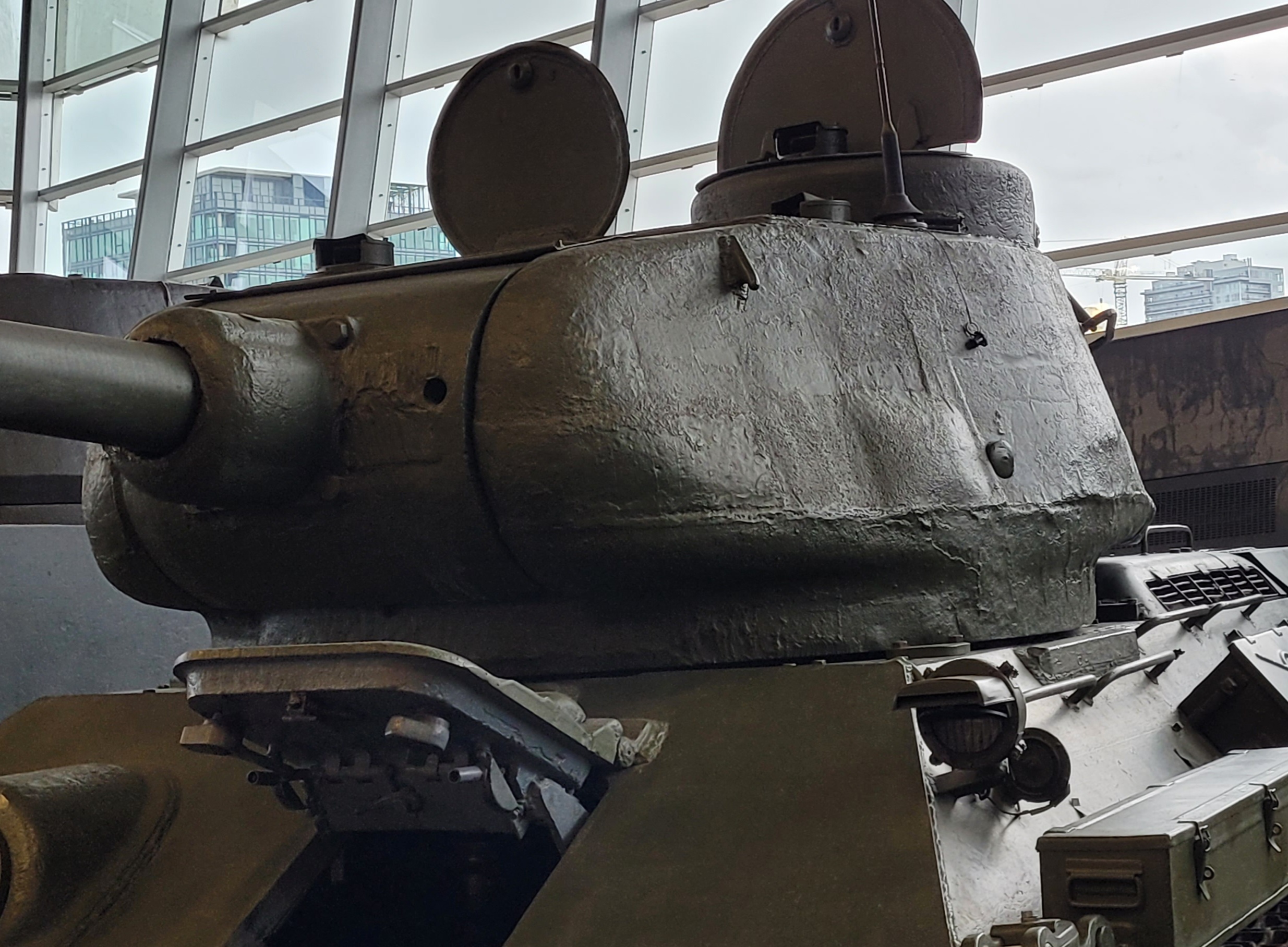

You mean more like this? LOL
Mike.

Use a sponge! Thank you, Kaczor. Why didn't I think of that? Next time, I'll try it. That way I can get a relatively even look of cast-iron texture and then mess it up on purpose.

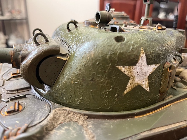

michaelwhittmann
Posts: 525
Joined: Mon Dec 04, 2023 7:03 pm
Post by michaelwhittmann »
my fledgling attempt on a Sherman.
too much??
