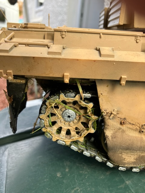

Looking at the grass in the photograph, you should be alright. Just remember modern long wheel base, rear drive tanks will de-track more. Than front drive tanks. Take wide turns, don’t do spin turns, be prepared to stop at the first sign of a track walking off, and look out for grass building up in the sprockets.
I’ve even taken my own advice. Occasionally.
Mr Bix. Has even questioned why I have track retention issues, and says I run my tanks too hard. :haha: :haha: :haha:

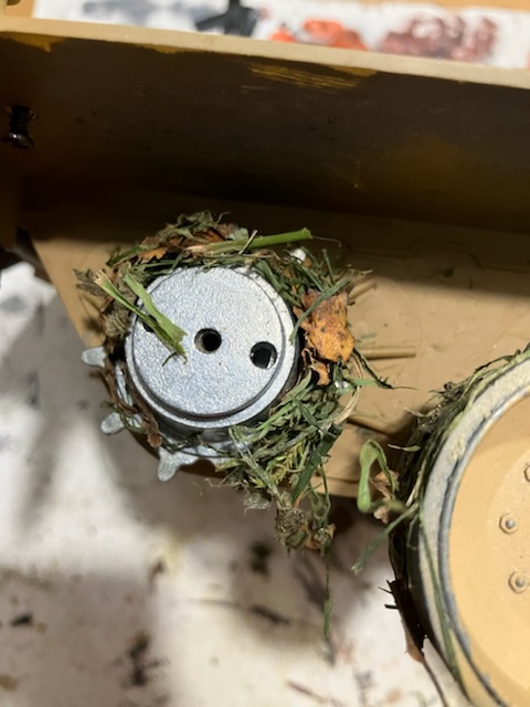

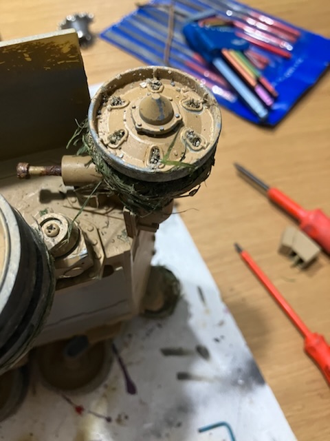

Contrary to the advice given so far it is very easy to burn out a motor if grass is trapped in the sprockets,
Do avoid wet and/or long grass it has the potential to ruin the drive train of a 1/16 tank or half track,
Sand will grind away the moving parts and water will destroy the electrics,
Model tanks are just that models use them wisely.

jarndice wrote: Wed May 29, 2024 6:45 pm Contrary to the advice given so far it is very easy to burn out a motor if grass is trapped in the sprockets,
Totally agree with Mr Jarndice, and was what I was trying to show in my pictures. I will not show you what I have managed to brake on mine. But the list is long. The type of track does have an influence. Plastic tracks are less “grippy “ and are more, forgiving than grippy metal tracks with pads. As Mr J says we are trying to drive a comparatively small model over 1:1 terrain. Your cautions approach is good.
