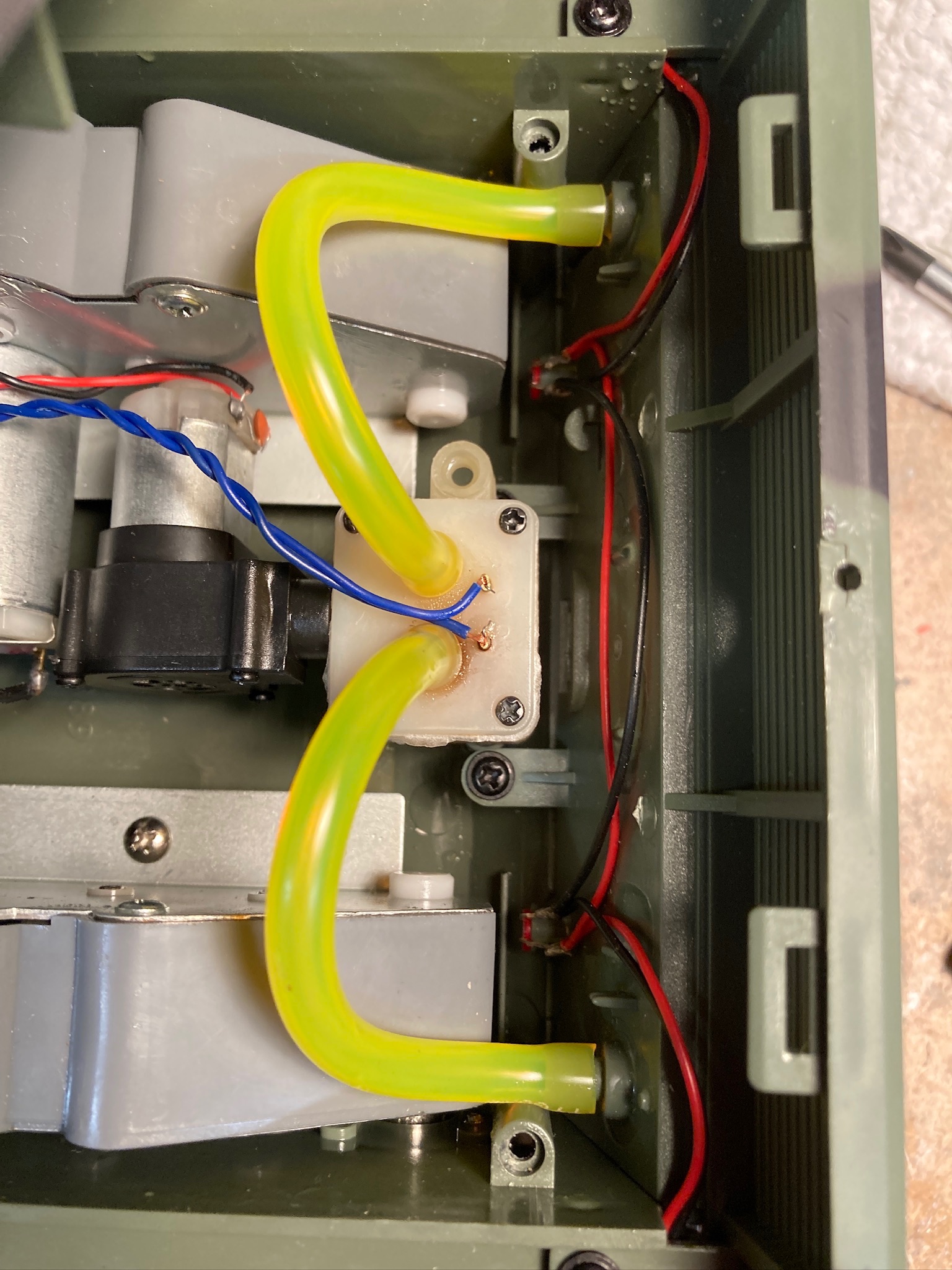

I enjoy running this HL Leo with the smoke feature, but last time I took it out the smoke stopped coming out of the two exhaust pipes and started coming up through any joints or gaps that it could find instead.
There are two black plastic caps that fit on top of the smoke unit, and each one has a fairly loose fitting tube pushed onto them to direct the smoke out of the exhaust ports .
After unscrewing the top deck I could look inside the hull to see that both of these had melted and were no longer attached to the tubes.
I had no spare parts so I cut a couple of lengths of yellow Tygon fuel tubing to fit directly onto the smoke unit and the exhaust ports.(it’s all I had !) and screwed the top back on again.
This was a simple fix and it is working well with the smoke now only coming out of the two exhaust ports, and no cash was spent making the repair.

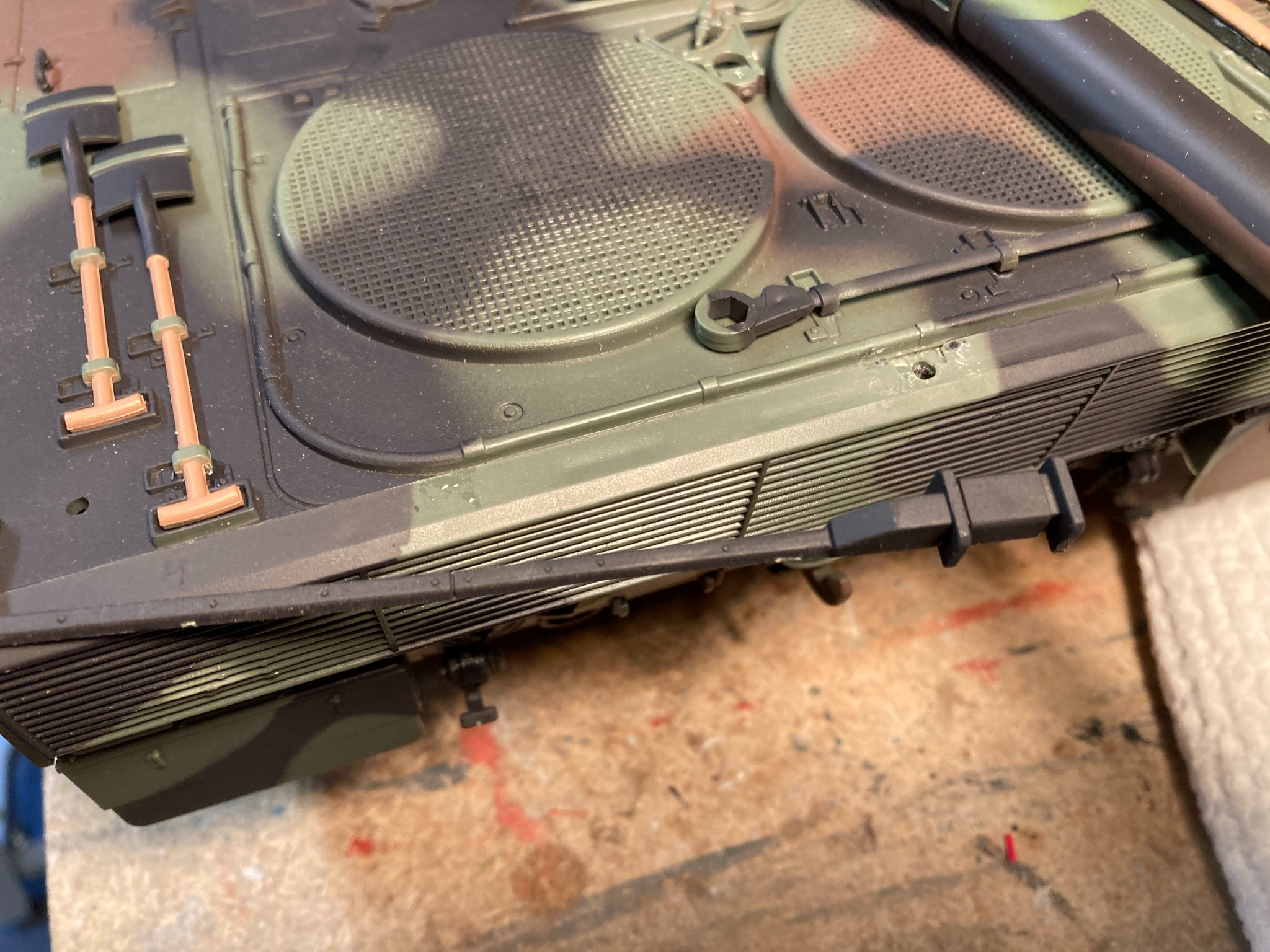

I glued all of the small detail parts onto the tank but when I needed to take the top deck off of the hull (to repair the smoke pipes), one of the long moulded parts that fits across the back of the tank (don’t know what it is called) stopped them coming apart!
Fortunately I was able to prise one end of it off with a small screwdriver blade (without damaging it) and this then allowed me to get the tank apart.
The end that I prised off is a nice firm “push fit” into its mounting hole so I just pushed it back on again without any more glue and it has not fallen off since, so I would recommend not gluing this part - just rely on a “push-fit” to keep it in place.
