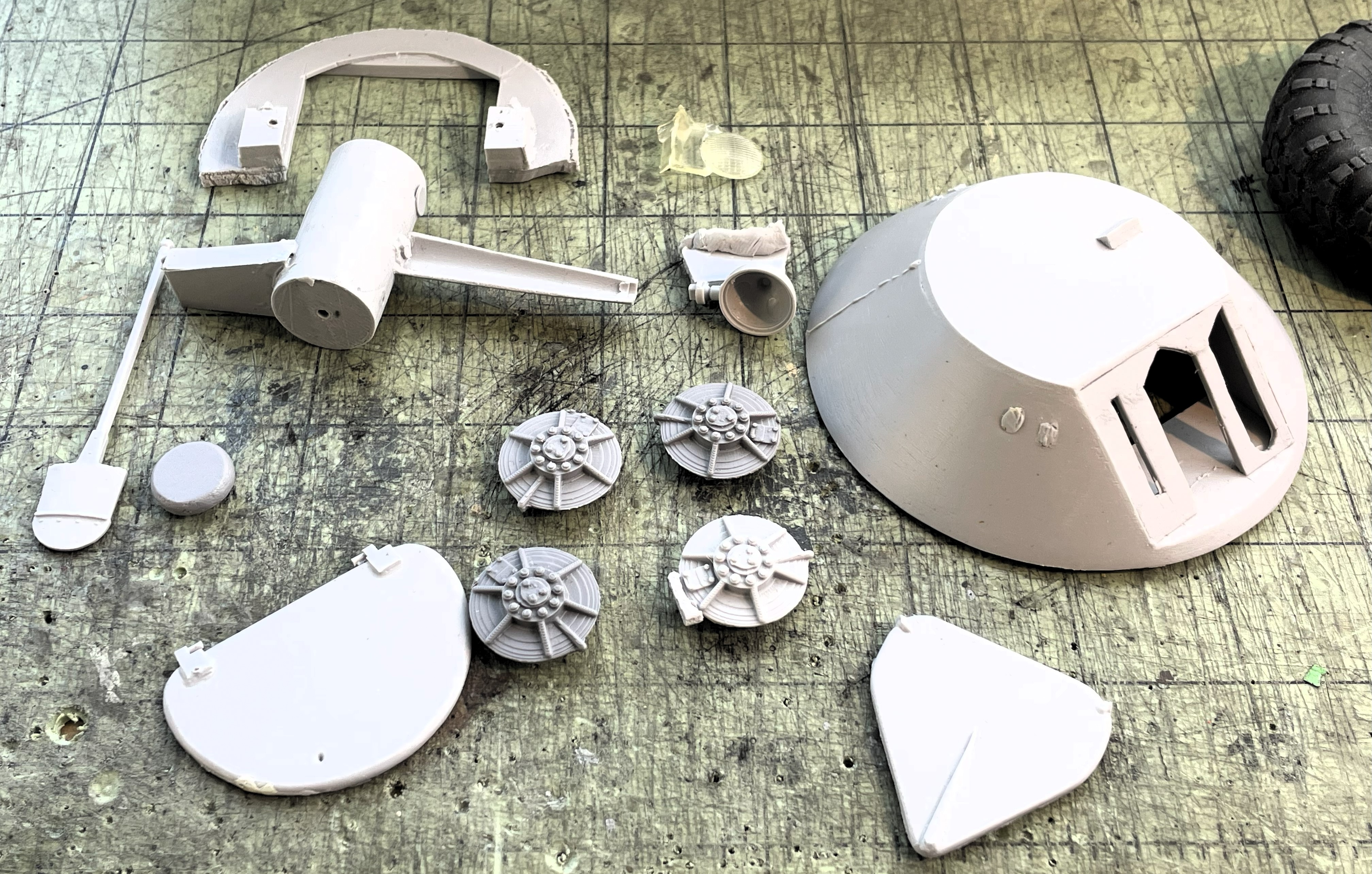

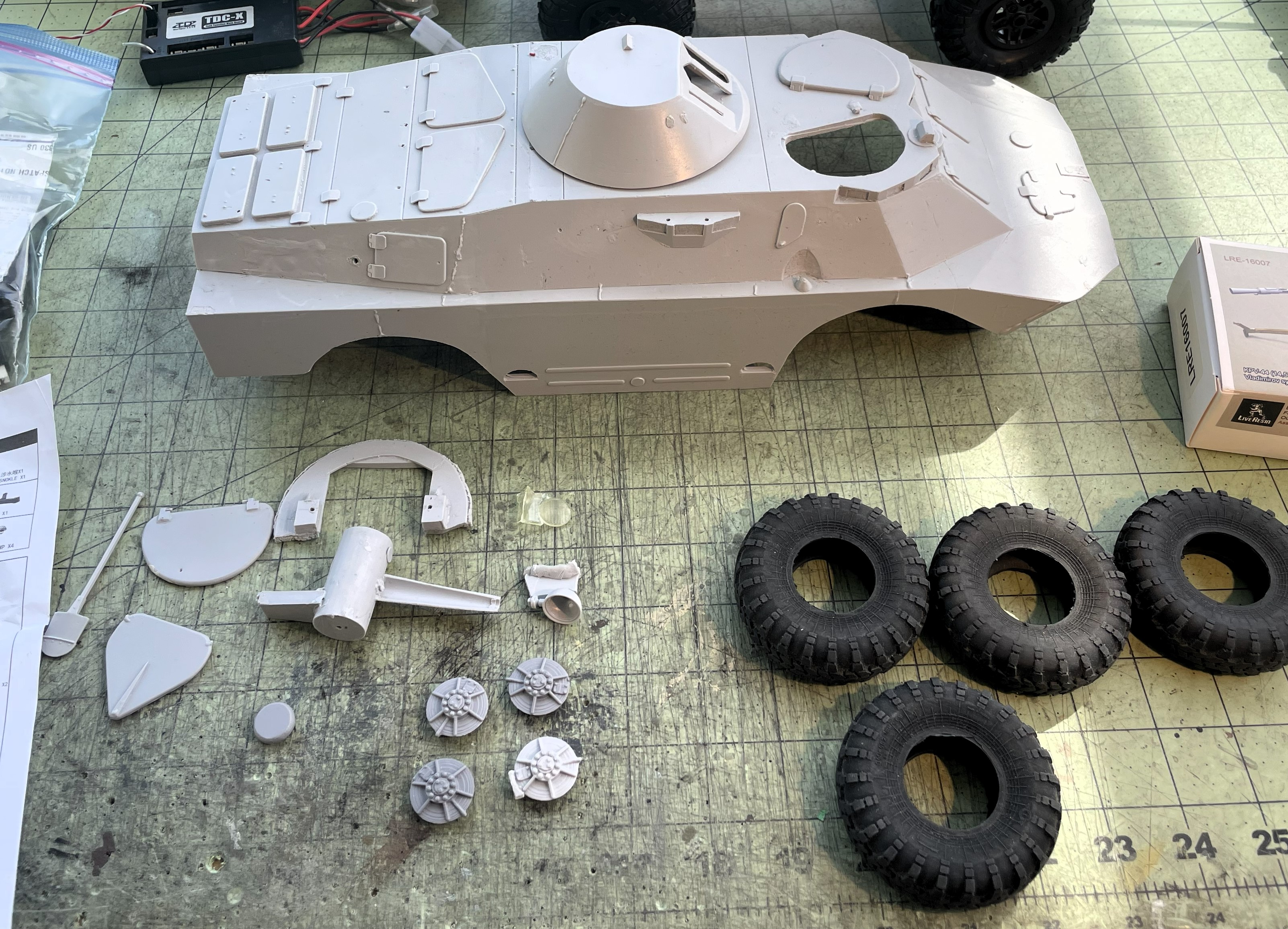

These are all the other parts provided, main machine gun elevation pivot, two hatches, 4 wheel hubs, one searchlight, one ventilation cover and one spade. That's all.
1/16 RC BRDM-2 Soviet Combat Recon Patrol Vehicle - Build

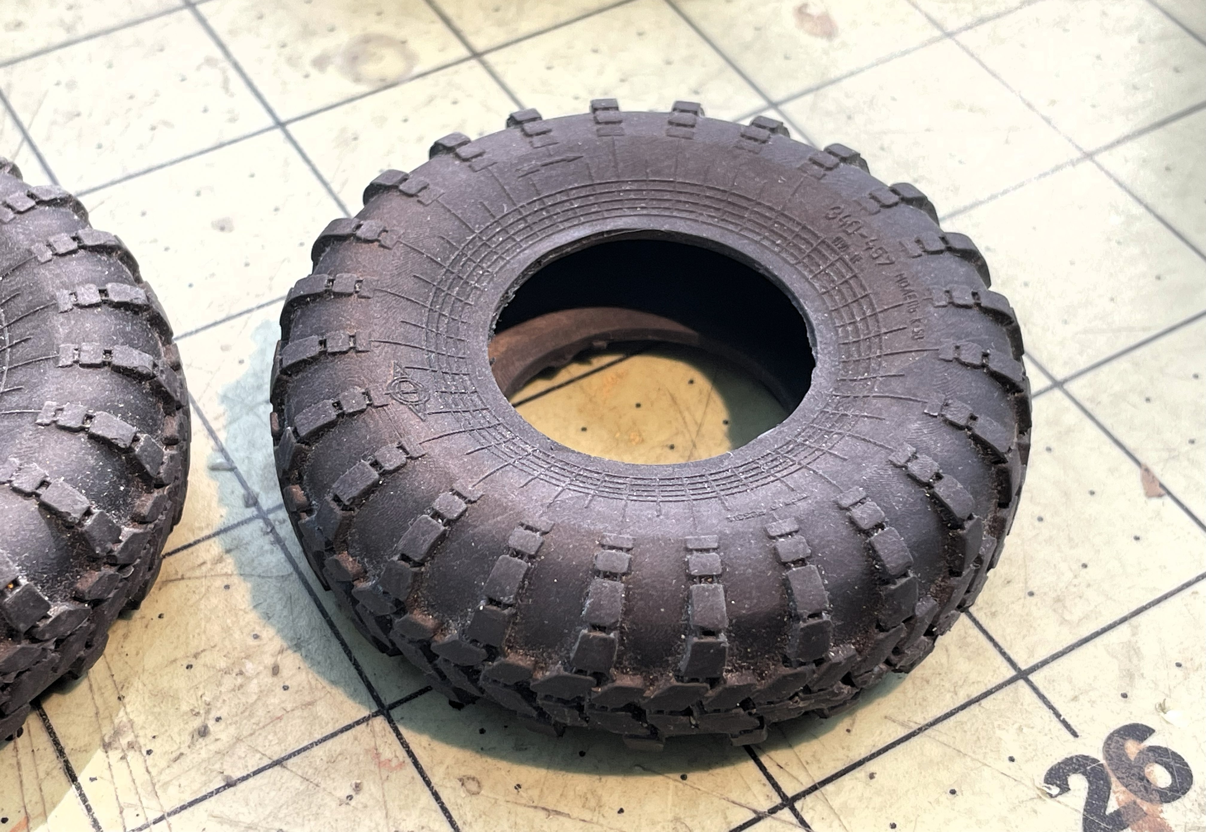

I purchased the matching rubber tires later from the same Russian seller when i saw them available. Finding and selecting appropriate tires are as much of an issue with wheeled vehicles as finding tracks for scratch built tanks. I was glad when these were offered, even if somewhat expensive.

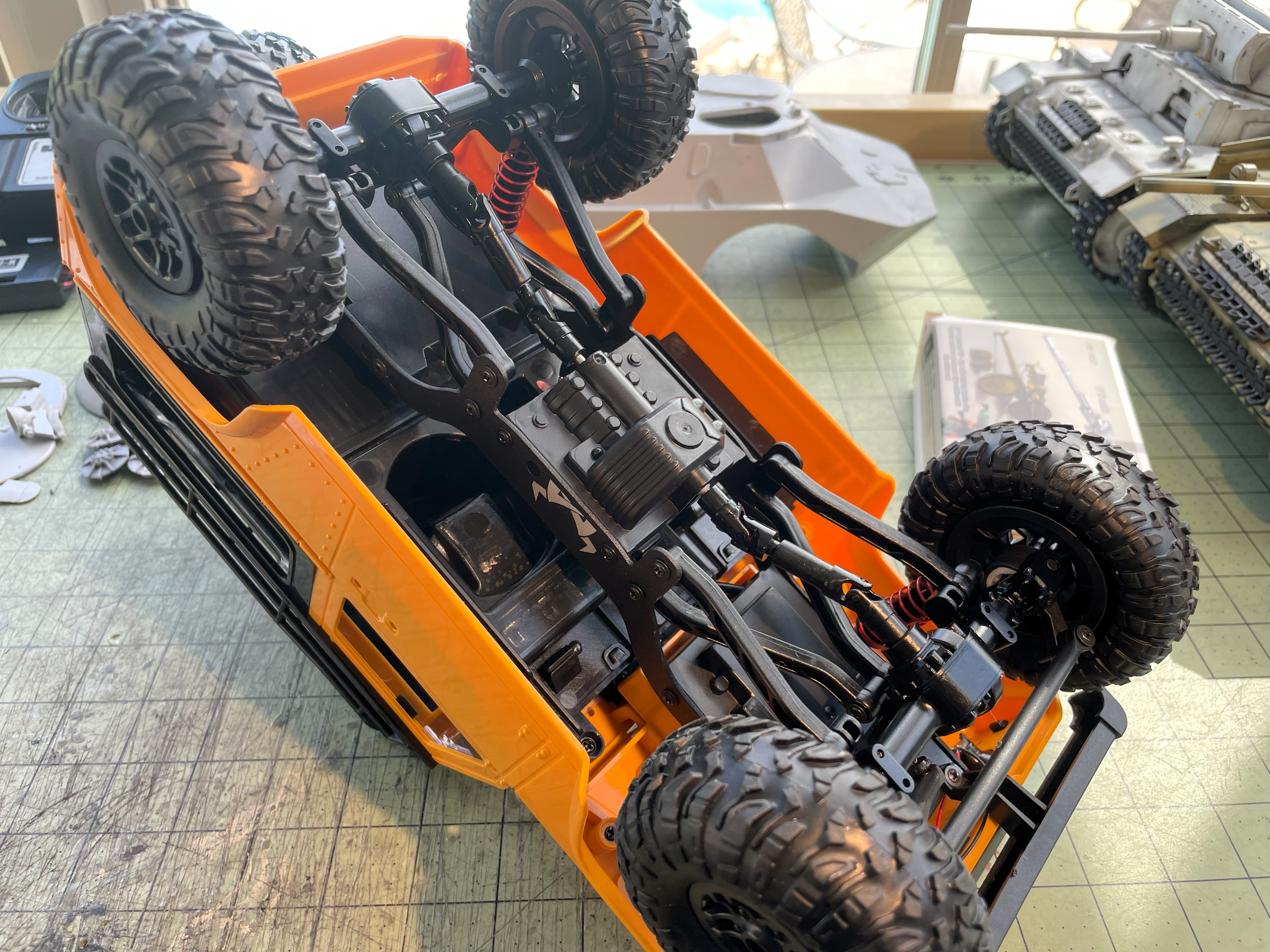

On the surface, it is a nice model, looking good.

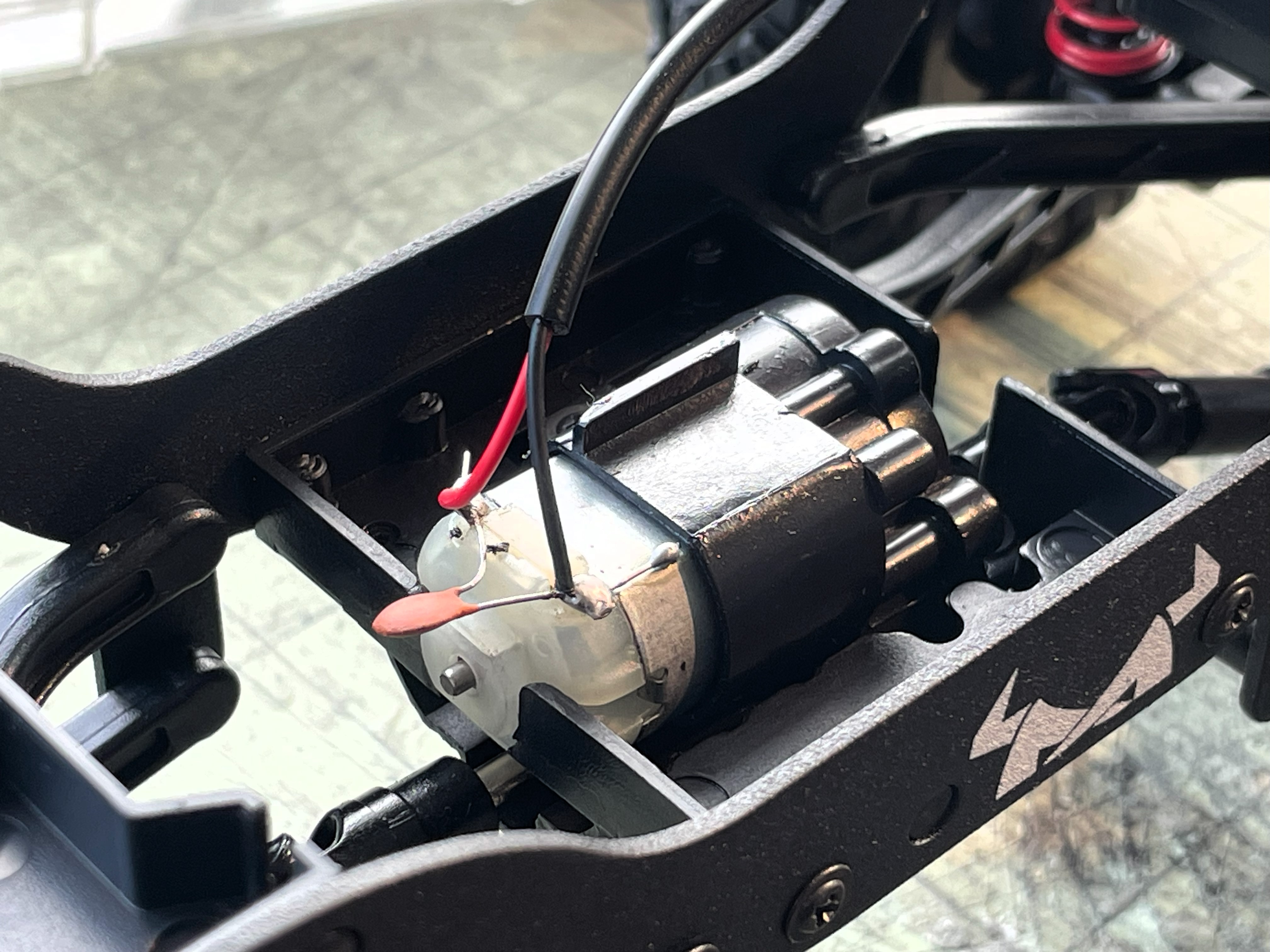

However, the mechanical parts are mostly all cheap plastic, including the gears inside the axels. Only the frame is in metal.
As a "crawler", it is equipped with a ridiculous size 130 motor. That's just wrong.
From previous experience with these tiny gearbox and motor on a large model like this one, it is not even powerful enough to make it climb on a carpet sitting flat on the floor.

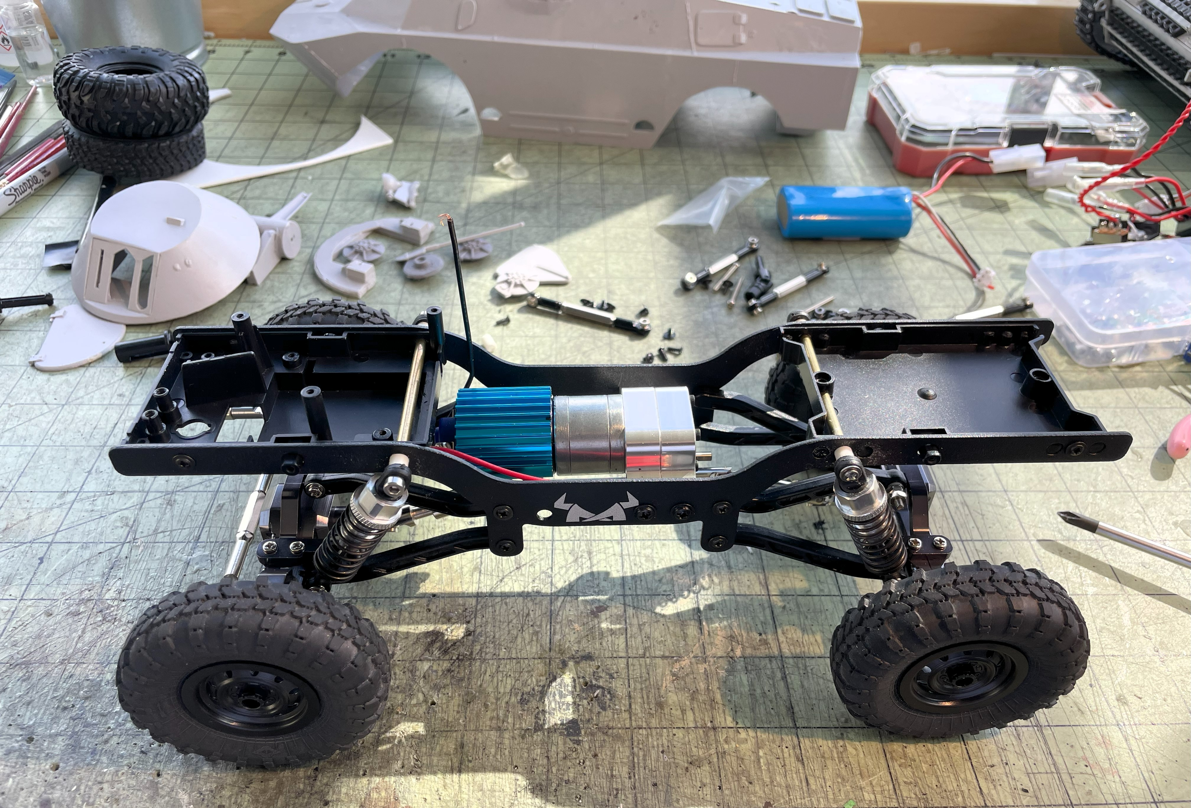

A cheap way to immediately improve it a bit would have been to replace the 130 motor by a 180. However, i decided to replace the whole thing with a metal gearbox with 370 motor designed for WPL trucks i had on inventory, leftovers from a previous build.

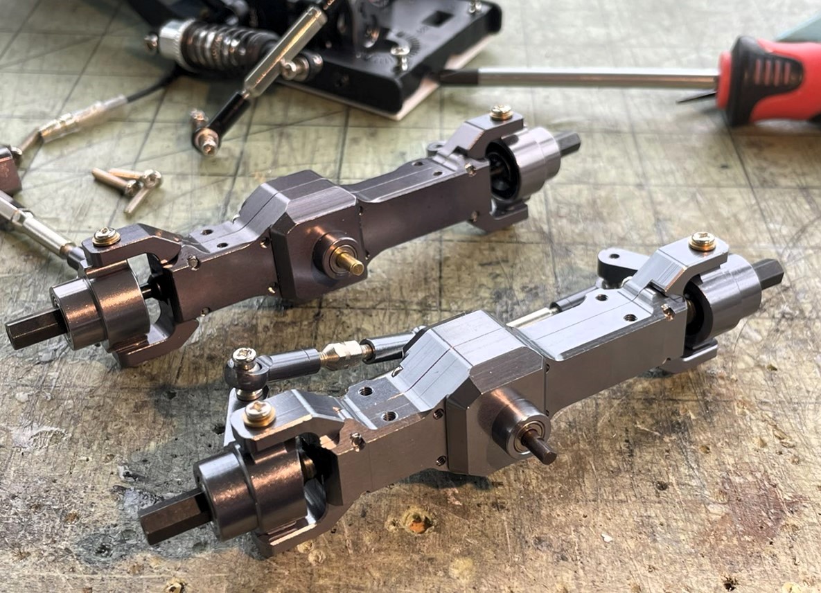

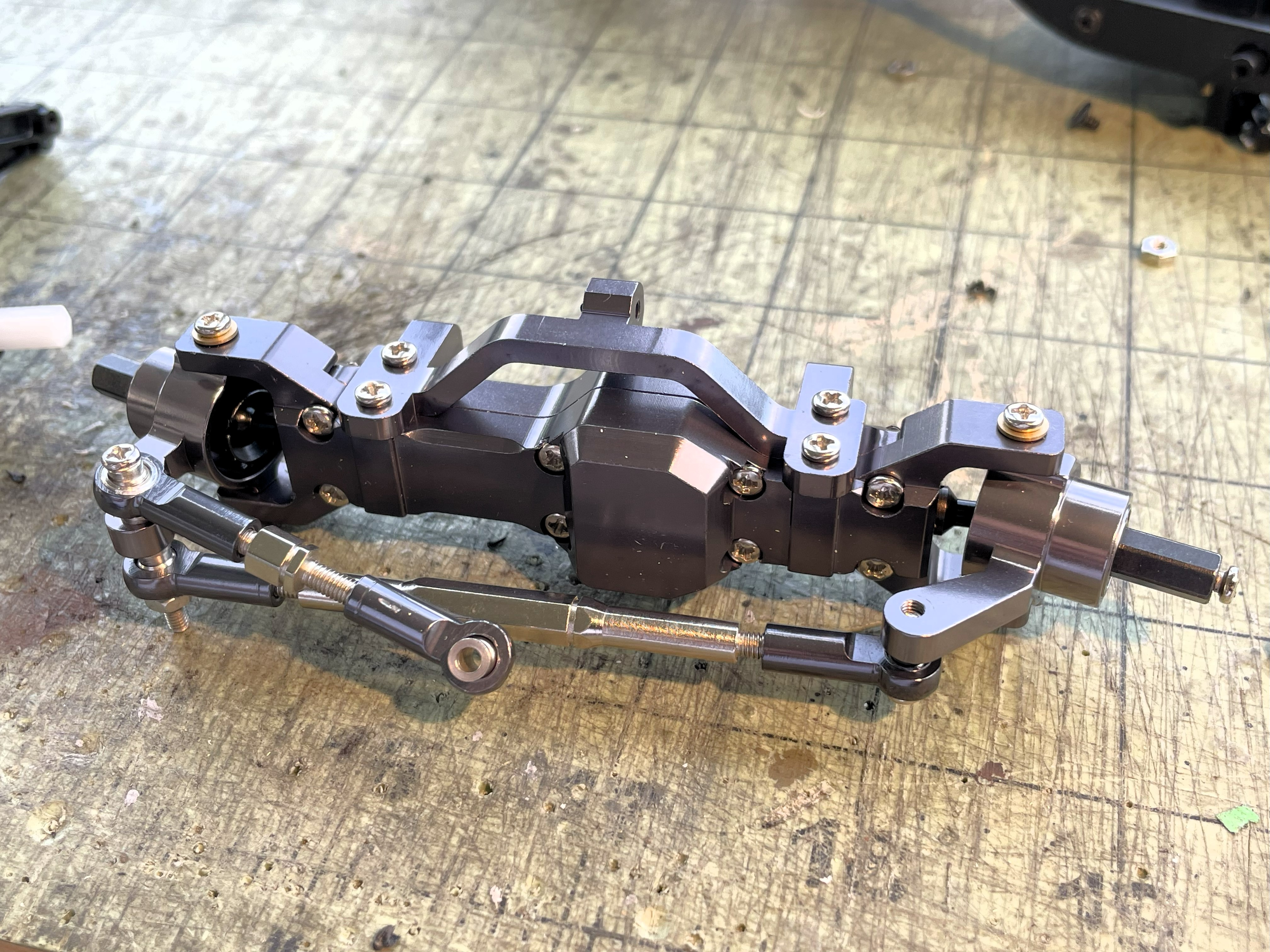

And when you start replacing plastic by metal, need to go all the way. So, it will be given new metal axels, shocks and drive shafts, also designed for WPL trucks.
These are just superb for the price, and available on eBay.

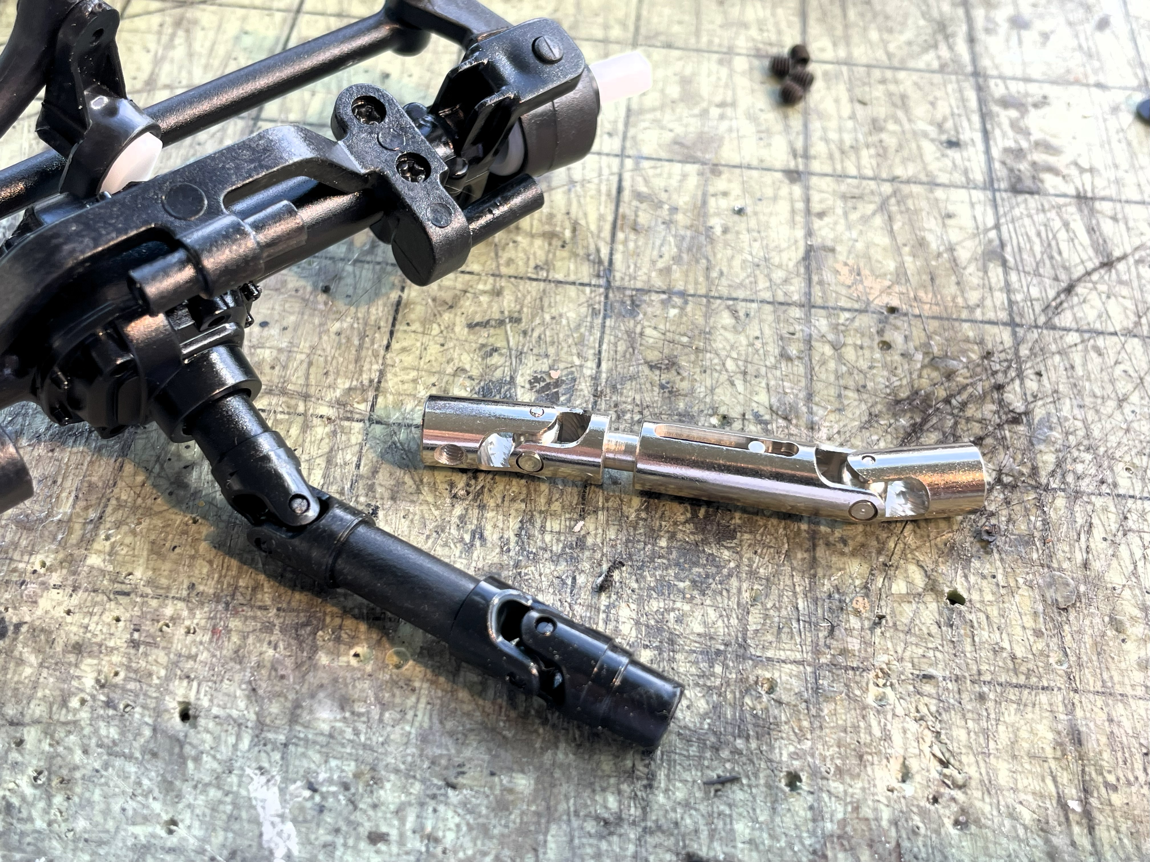

New stronger metal shocks, replacing the weak ones coming with the model.
Metal drive shafts.

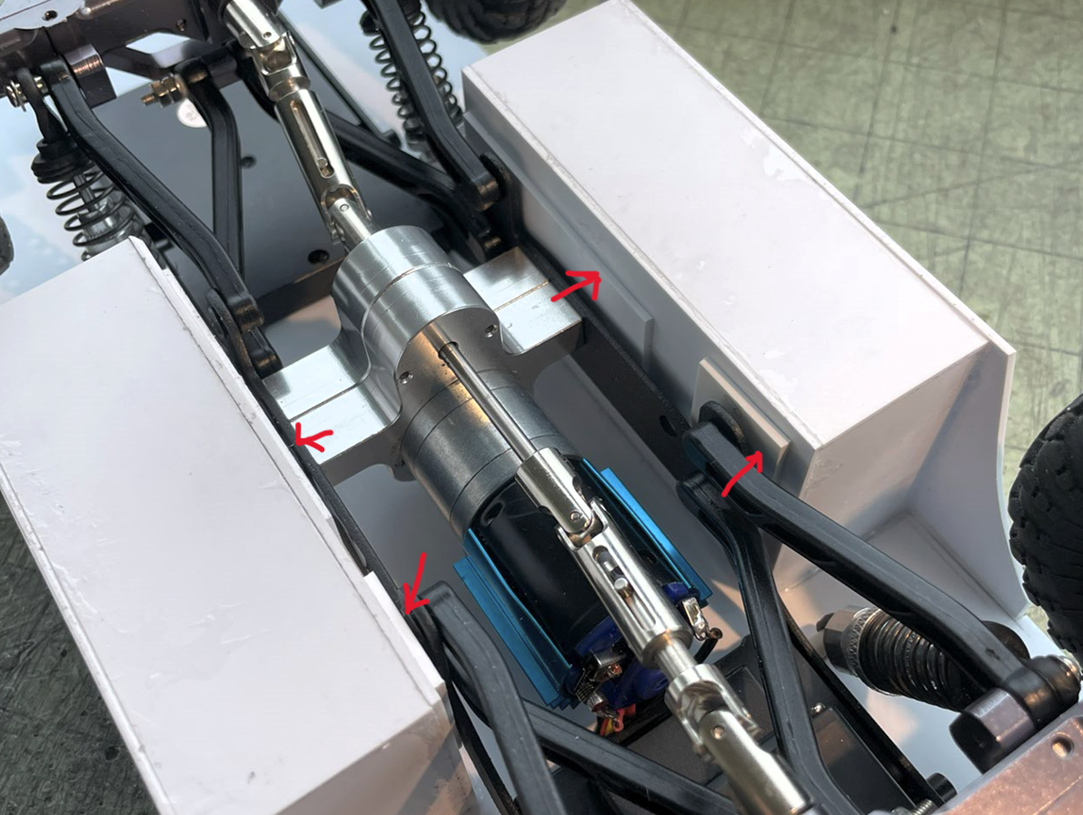

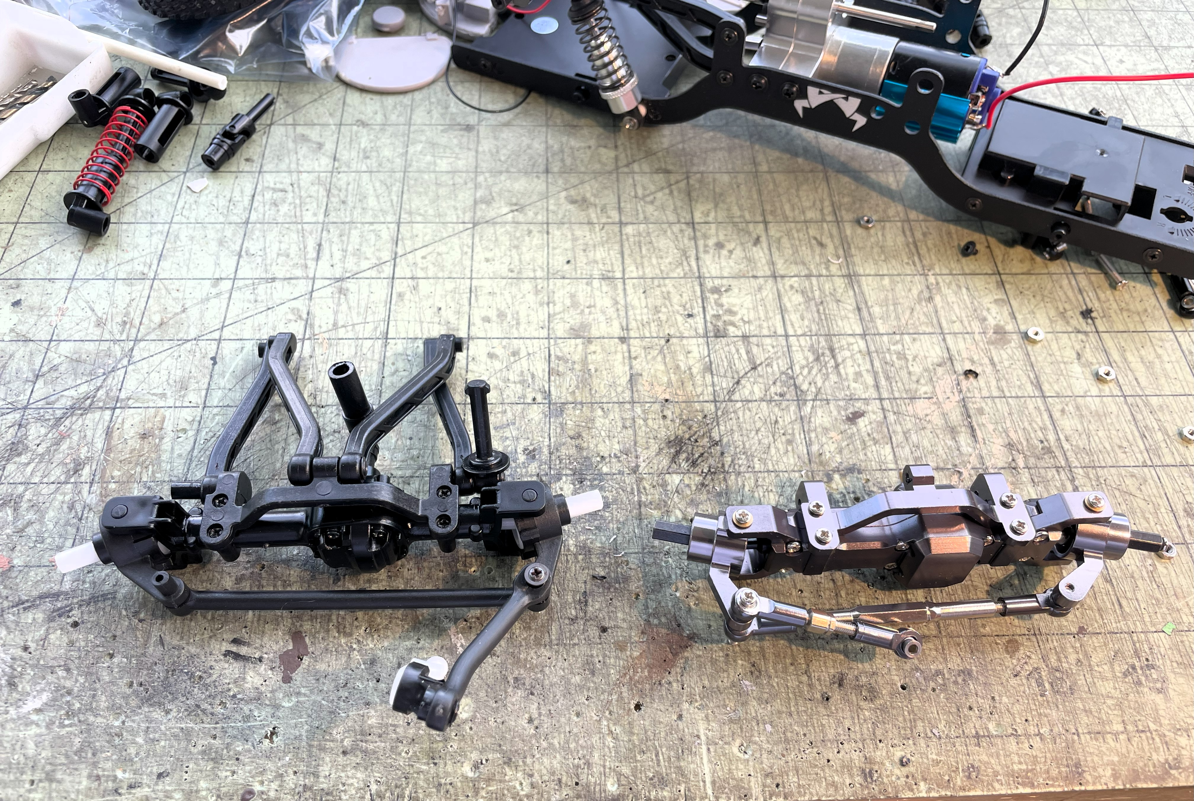

And here we have the new improved chassis for the BRDM-2. Only the thick and solid plastic tie bars matching the metal frame are reused. That's all of what is left of my investment on the MN-90 4x4 truck...

The BRDM-2 wheel are mounted on regular WPL plastic rims. Don't look at the rotation direction, i did not bother about it at this time.

Overview of the mechanical parts.

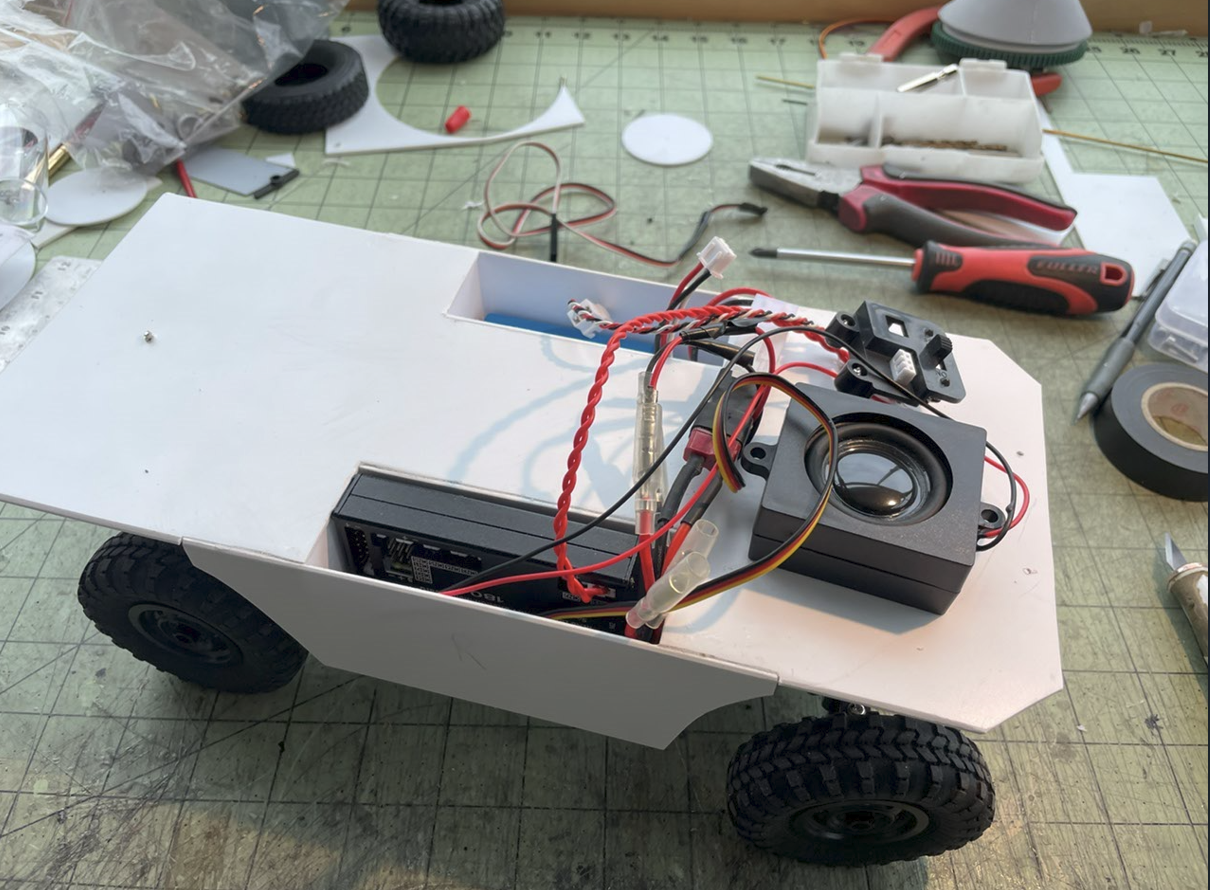

A HL TK 7.1 control board and remote will provide the main electronics for the build. I needed a control board with combat capabilities for the turret KPVT main gun and PKT coax machine gun, with turret rotation and gun elevation, something not possible with a Racing board. The steering servo is connected to CH5 servo port and controlled with the slide bar under stick 2 (only on TK 7.1).
Test runs were done, including crawling over objects. All is working well between the TK and the gearbox, providing reasonable speed but also super low speed control for crawling. This is really powerful stuff.

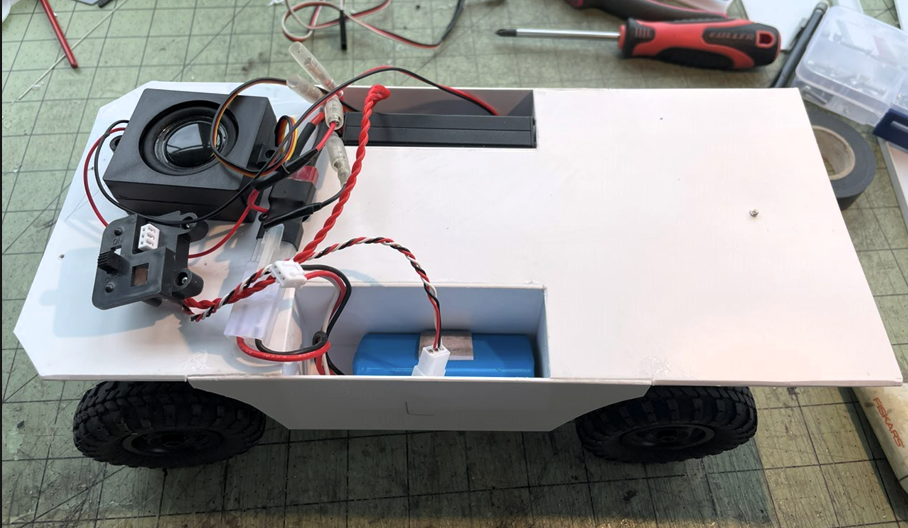

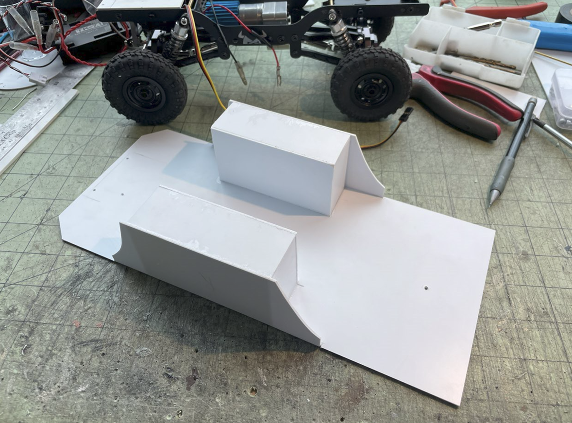

Re-testing the integration with the shell. Plasticard strips are put inside to start positioning the shell at the proper height and position, with lots of dry fitting.
Weird, i am noticing that the frontal metal axel with the steering is 2mm longer on each side than the rear axel without steering, wth. I will have to do something about that because i want all my wheels to be properly aligned with the hull.

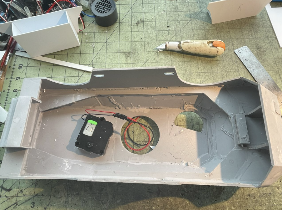

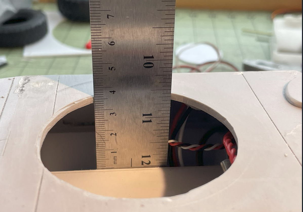

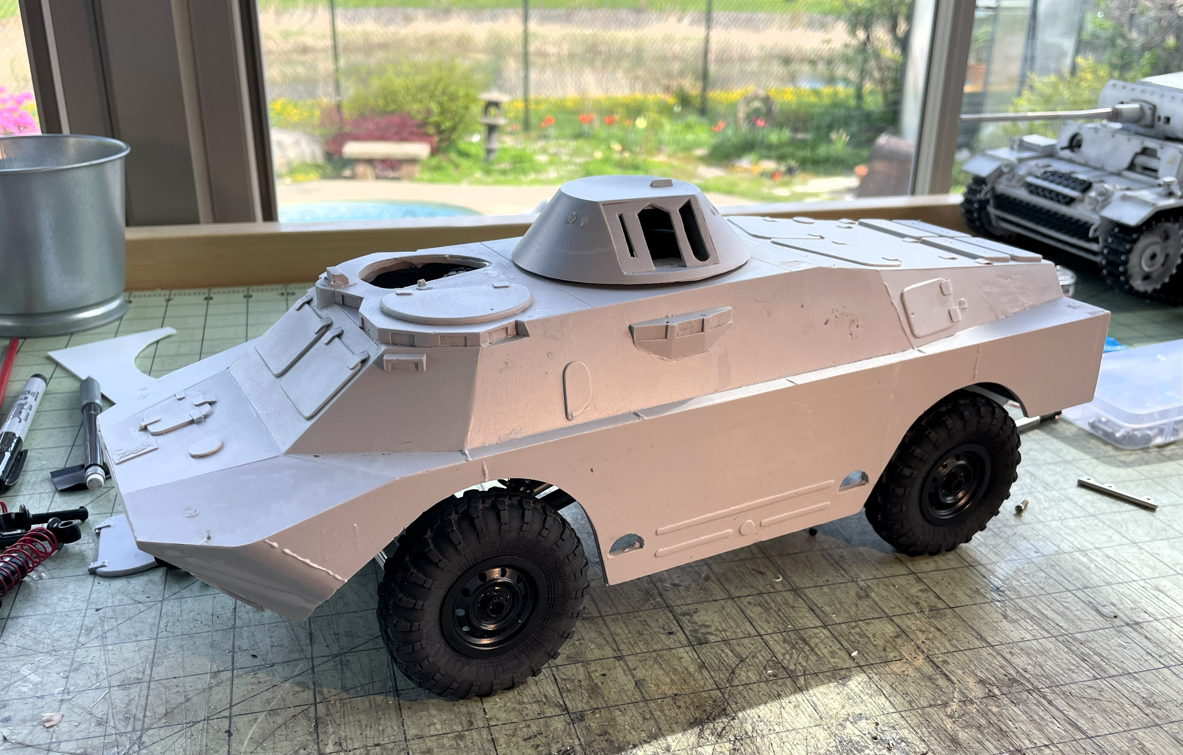

There is a lot of space on the interior sides to put electronics like battery and speaker, freeing some space on top for the turret rotation unit and other stuff i have in mind. I will need to design a structure to hold it all together inside the hull, and create some wheel wells to protect the inside of the vehicle from dust, mud, etc. No, it will not be amphibious.

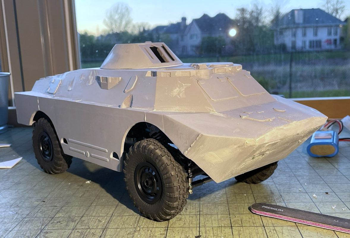

The hull shell and turrets have a lot of imperfections, needing cutting, sanding, plasticard filler and putty. I started to prepare them for the build, its ongoing.

Hello Louis,
nice build.
I have several sets of the CNC axes in use.
Please check the setting of the ring gear and pinion.
This has always been set too far.
This only gives you short pleasure, then the pinion spins or loses teeth...

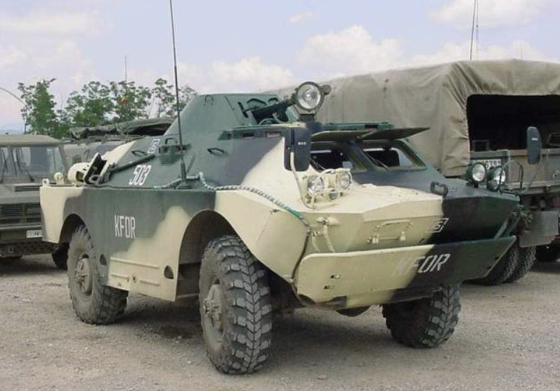

There is limited documentation on the BRDM-2. Below is a rare view of a suberbly restored East German BRDM-2 with its original armament. Most of the walk around pictures on the web have the guns removed or replaced by inaccurate metal tubes.

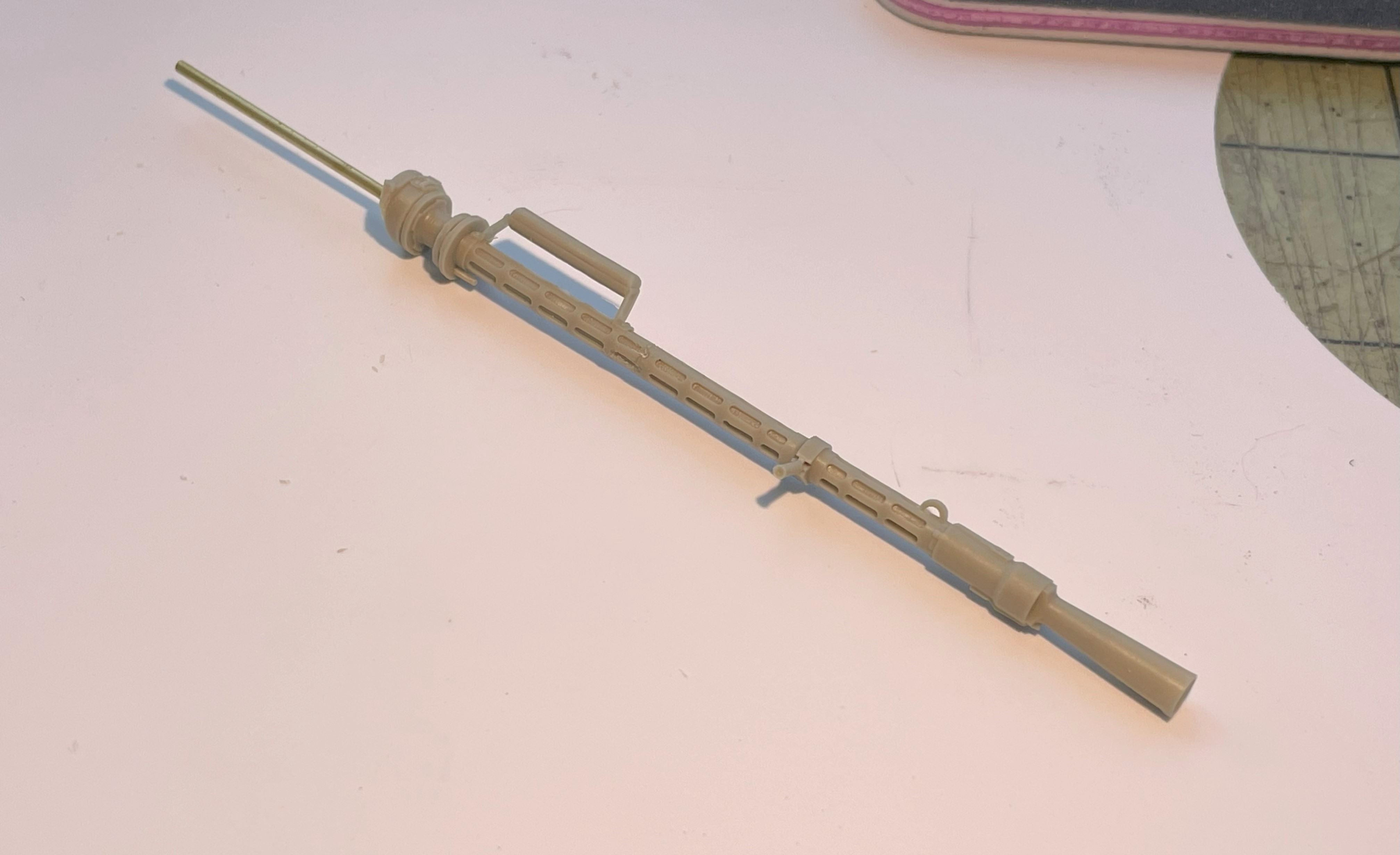

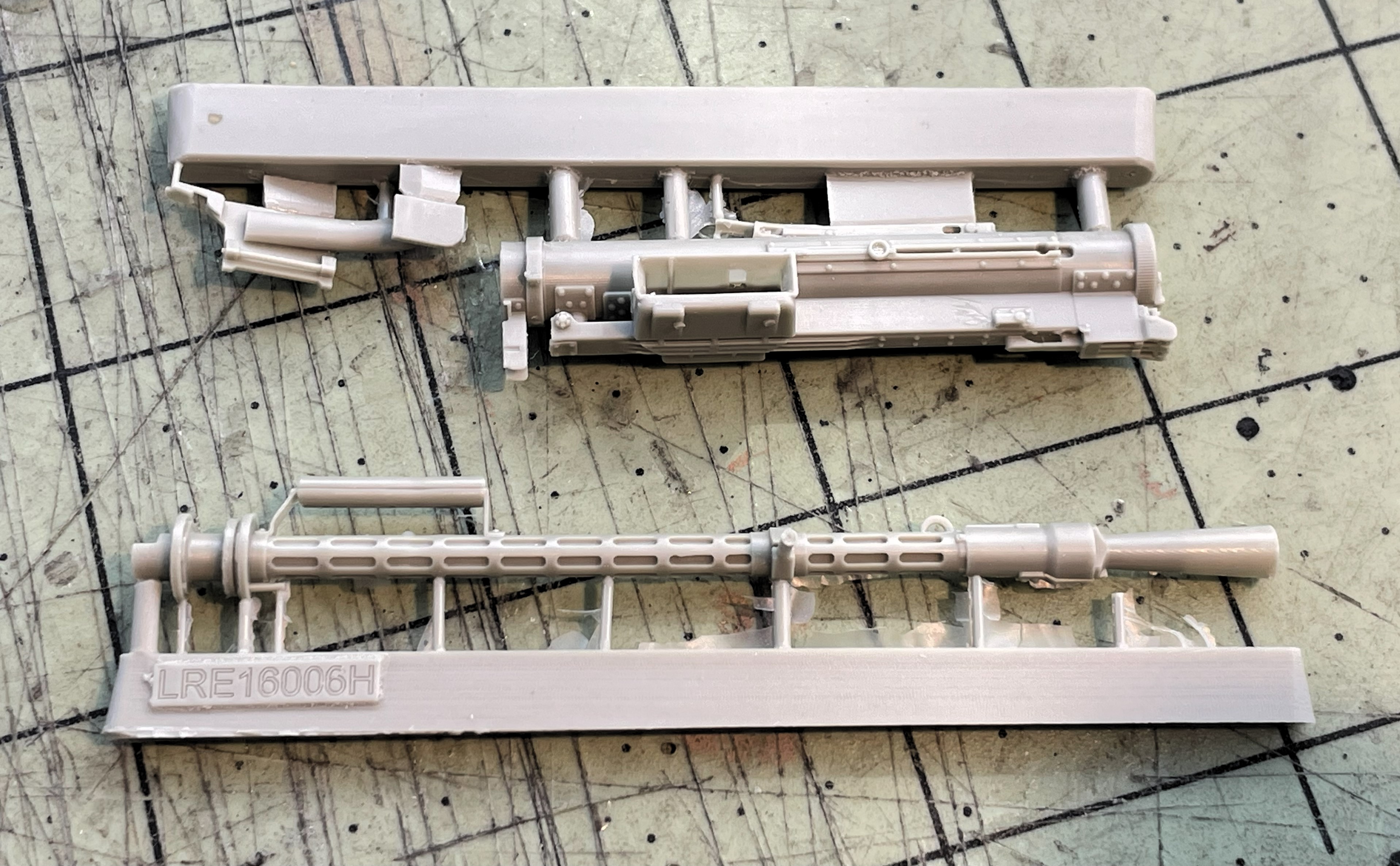

The Live Resin 14.5mm KPV-44 high caliber machine gun resin barrel is superbly delicate. It needs to be made hollow in order to carry a fiber optic for the flash. It is quite long and there is no fine drill bit or modeller that can realistically do the job in one single attempt. That small barrel handle is especially fragile and could break at any wrong move.

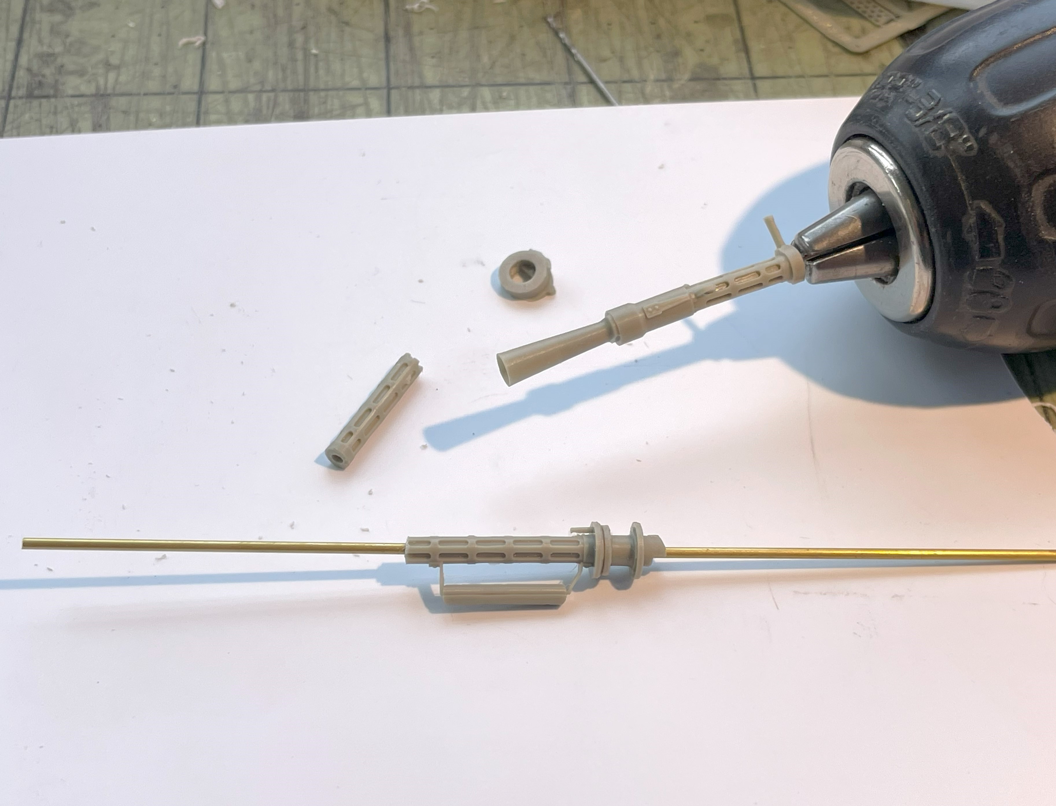

My strategy was to cut it in 3 sections carefully selected and drill them separately. A 1.2mm brass tube is inserted to reinforce the barrel and carry the fiber optic.
Once all 3 sections are hollowed, the barrel is re-assembled and glued around the central brass tube for an almost seemless integration. Now i have a reinforced 1/16 scale KPV machine gun with a inner tube for the flash and connection to the mantlet and LED.
Keep in mind it is not easy to do this and I had to use all my skills. It is difficult to make a hole that does not go a bit sideways and potentially ruin the barrel.

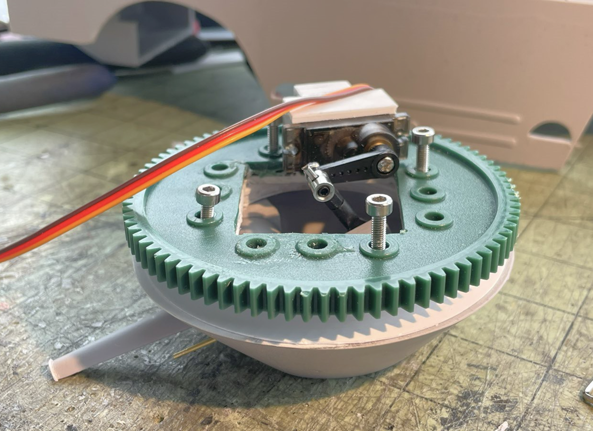

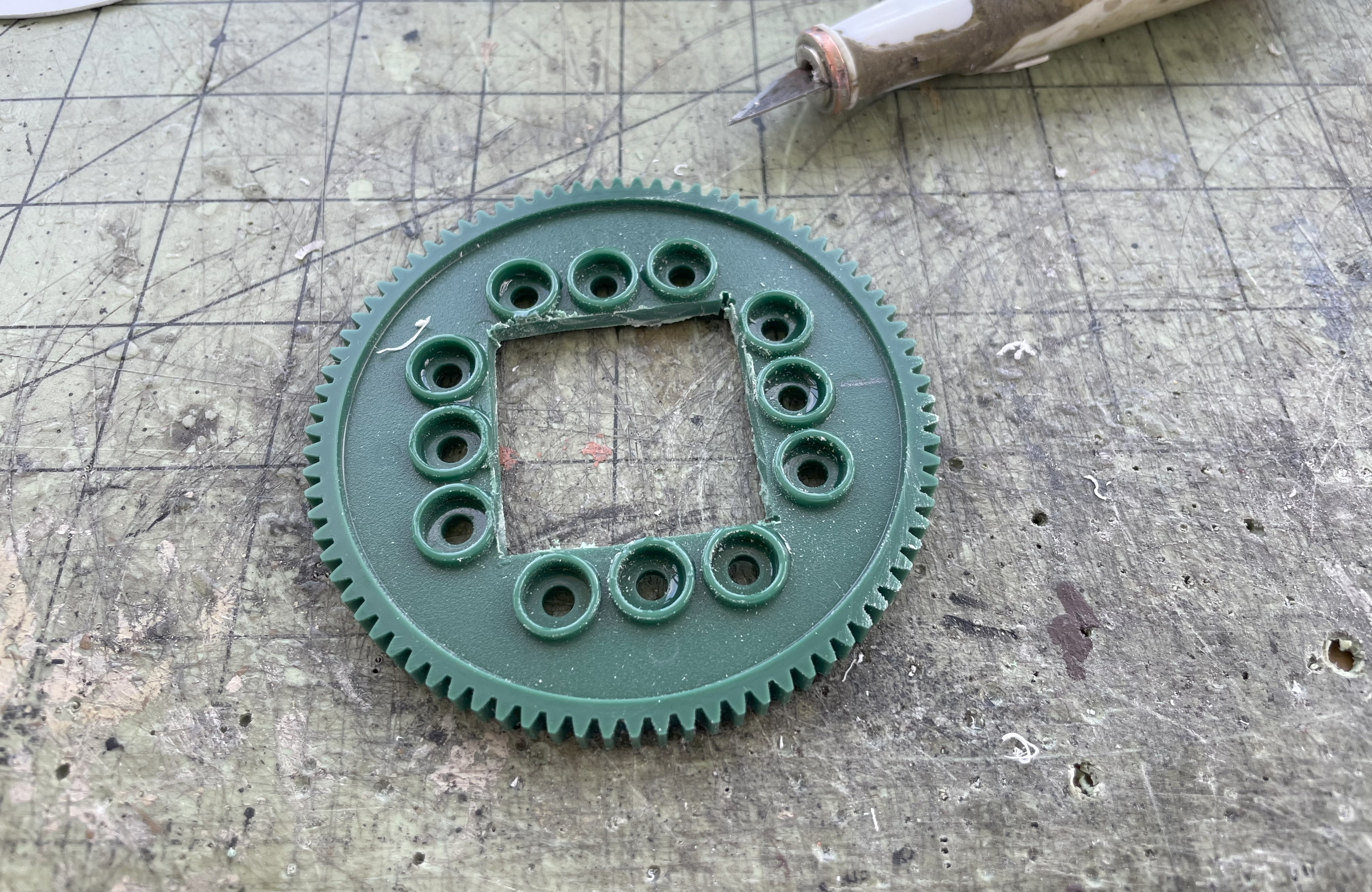

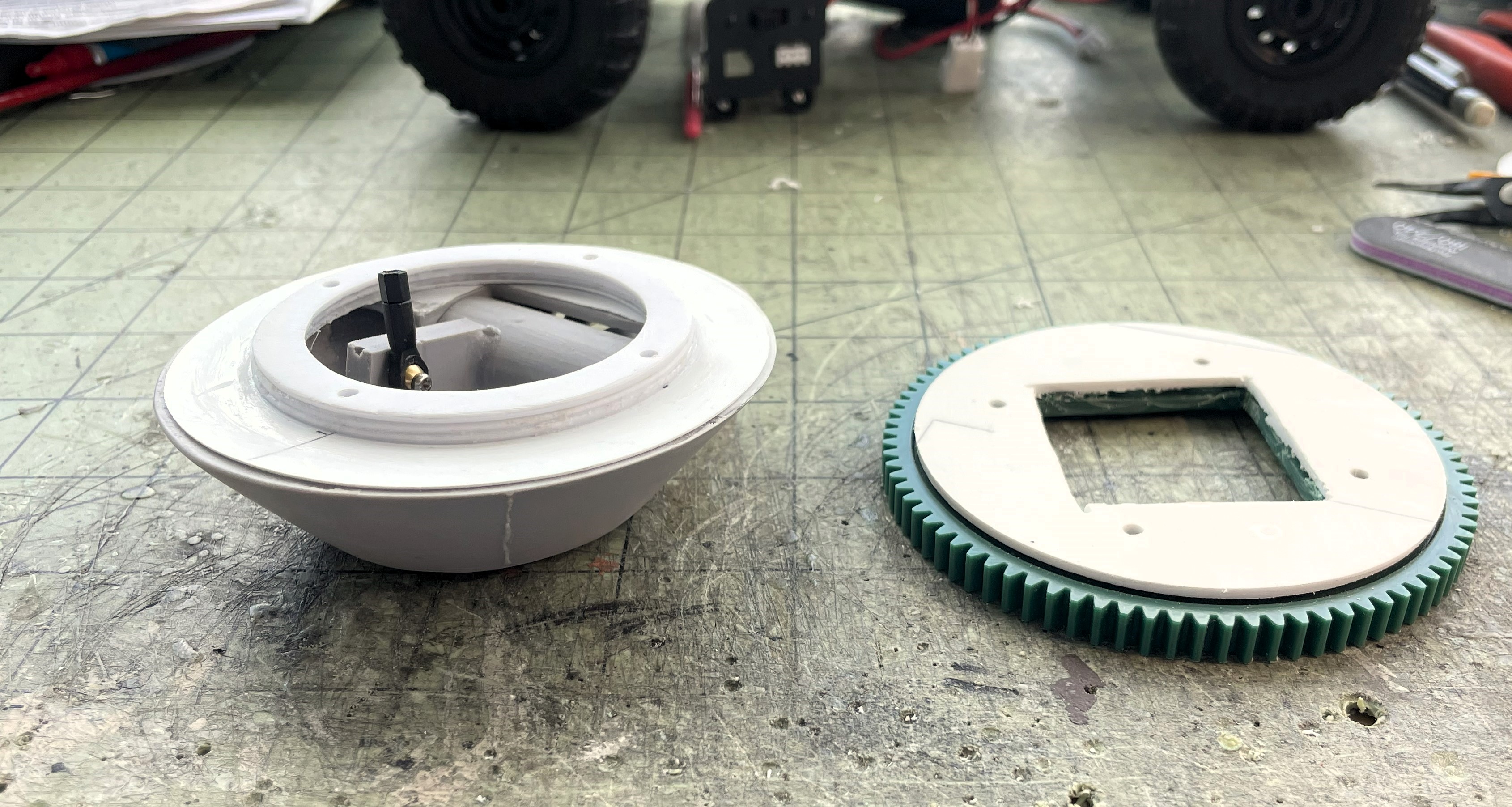

For turret rotation, a mid size VEX Robotics gear is used. A central section is removed to provide access for the gun elevation system.
The resin mantlet was cleaned up and perforated for the main and coax machine guns before installing inside the turret using two short rods as pivot on both sides. The turret was given a new bottom and a set of rings that match the turret ring on the hull. The gear was given a plasticard plate to link the turret from inside the hull, with 4 M3 hex bolts.
A pull rod is attached to the mantlet elevation arm.
The turret is positioned and manually rotated to correct any resistance.

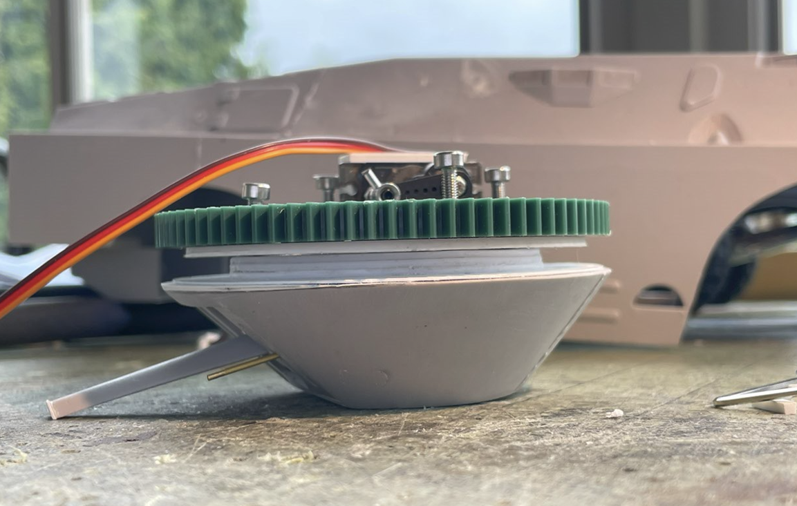

A micro servo is attached to the bottom of the rotation gear and connected to the elevation pull rod. Lots of dry fitting is required to determine the optimal position of the servo, without touching the rotation unit.

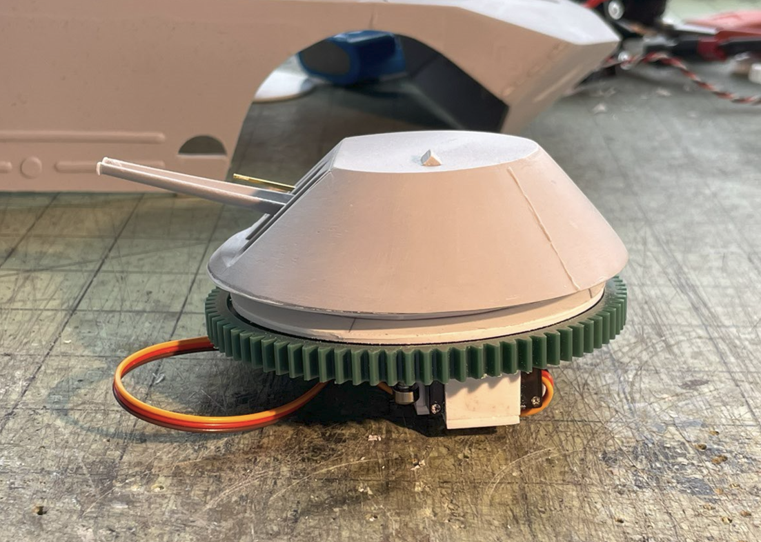

The custom servo elevation unit is thoroughly tested. What is nice about the HL TK 7.1 control board is that the low and high degree for elevation can be easily set uning the K2 button.
Side view showing the complete turret to be positioned with the upper hull in the middle.

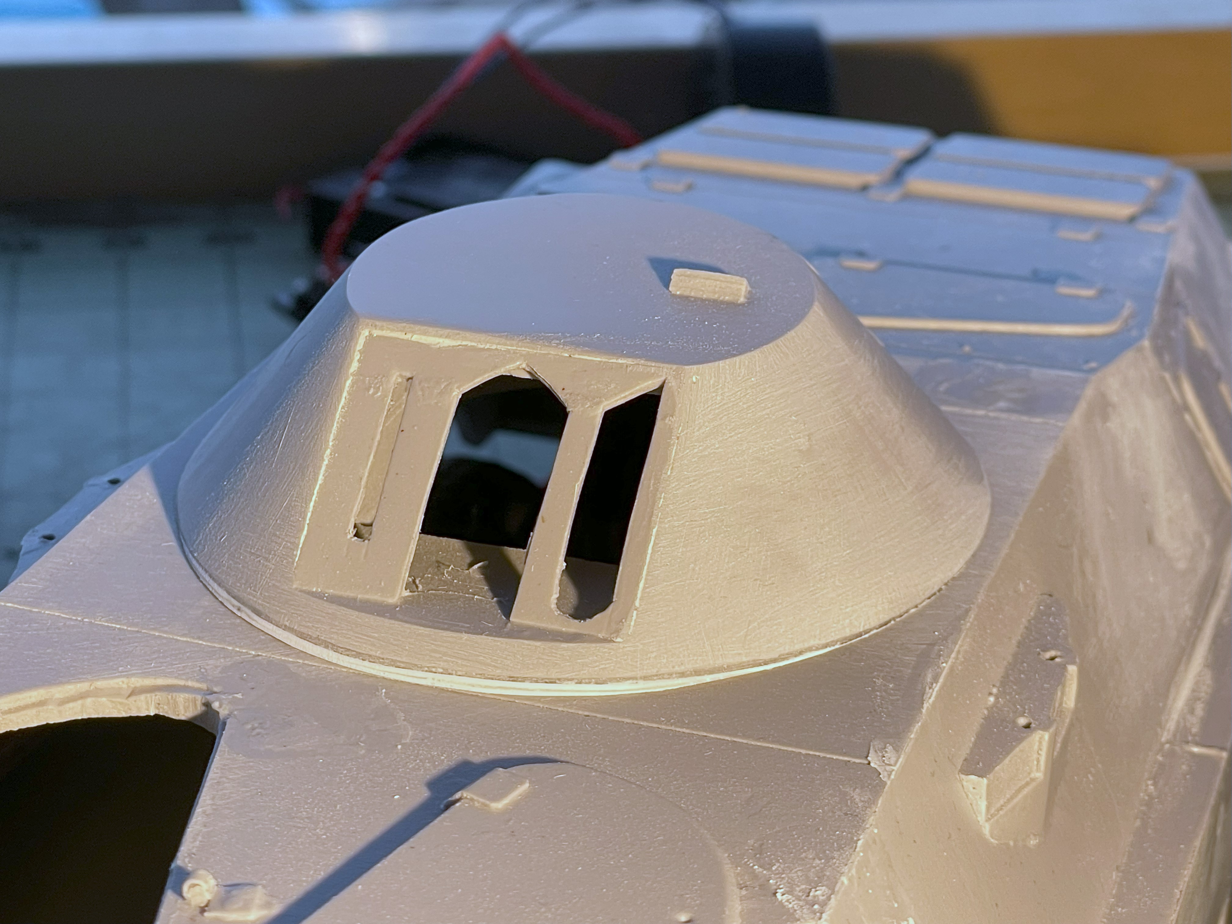

The turret is installed on the upper hull. The resin machine gun is positioned only for the look. It will be attached to the turret with the LED and fiber optics only at the end of the build. It would otherwise be damaged during construction. A brass tube was added for the 7.62mm PKT coax machine gun and will also receive its fiber optic and LED at the end of the build.

Now building the structure inside the hull. After a lot of calculation, pockets are created to hold some of the electronics on both mid sides of the vehicle.
Looking at the inside of the hull, we can see that there is a base on which to sit a platform that will support the lower chassis. Notice the position of the rotation unit on the rear inside roof of the vehicle.
A base in 2mm plasticard is made and covers the entire vehicle.
Continuing on following post
Re: 1/16 RC BRDM-2 Soviet Combat Recon Patrol Vehicle - Build
The basic inner structure is assembled. A small hole is made for the motor and steering servo cables.
The chassis is positioned and screwed in place.
The electronics are added for testing purposes. The TK 7.1 fits inside the right pocket, and the battery fits inside the left one. A thinner speaker is added and will be positioned at the front next to the main switch. Once the cables will be attached together, the mid section is available for the turret rotation and elevation servo to turn freely. The rear is given to the turret rotation unit attached to the inside of the upper hull.
With this setup, the electronics are completely isolated from the running gear dirt, water and mud.

The upper hull slides into place. No need for screws or magnet. It is holding in place by itself, squeezing the side pockets.
33mm, that leaves 11mm between the bottom of the elevation servo and the top of the base for the cables to swing when the turret rotates.
Spacers are added between the side pockets and the metal frame in order to keep eveerything tidy and solid when the upper hull squeezes the chassis when sliding in place.
jhamm wrote: Sat May 11, 2024 7:48 am Hello Louis,
nice build.
Thanks. Indeed, after investigation, the cup and pinion are really too much extended. Before trying to modify them, i checked my spare part bin containing leftovers from past builds and noticed another frontal axel of a much better quality and shorter by a couple of mm.
The first axle i used has cups and dogbone for the swing.
This new one has beautiful cardan swing chafts. So, although there are quite a few of these metal (replacement for WPL) axles that all look alike on eBay and sell at about the same price, they are not equal in terms of quality. Something i will keep an eye on.
The axle is shorter, the alignment of the two axles is better.
The model as it stands today.
Regards, Louis
