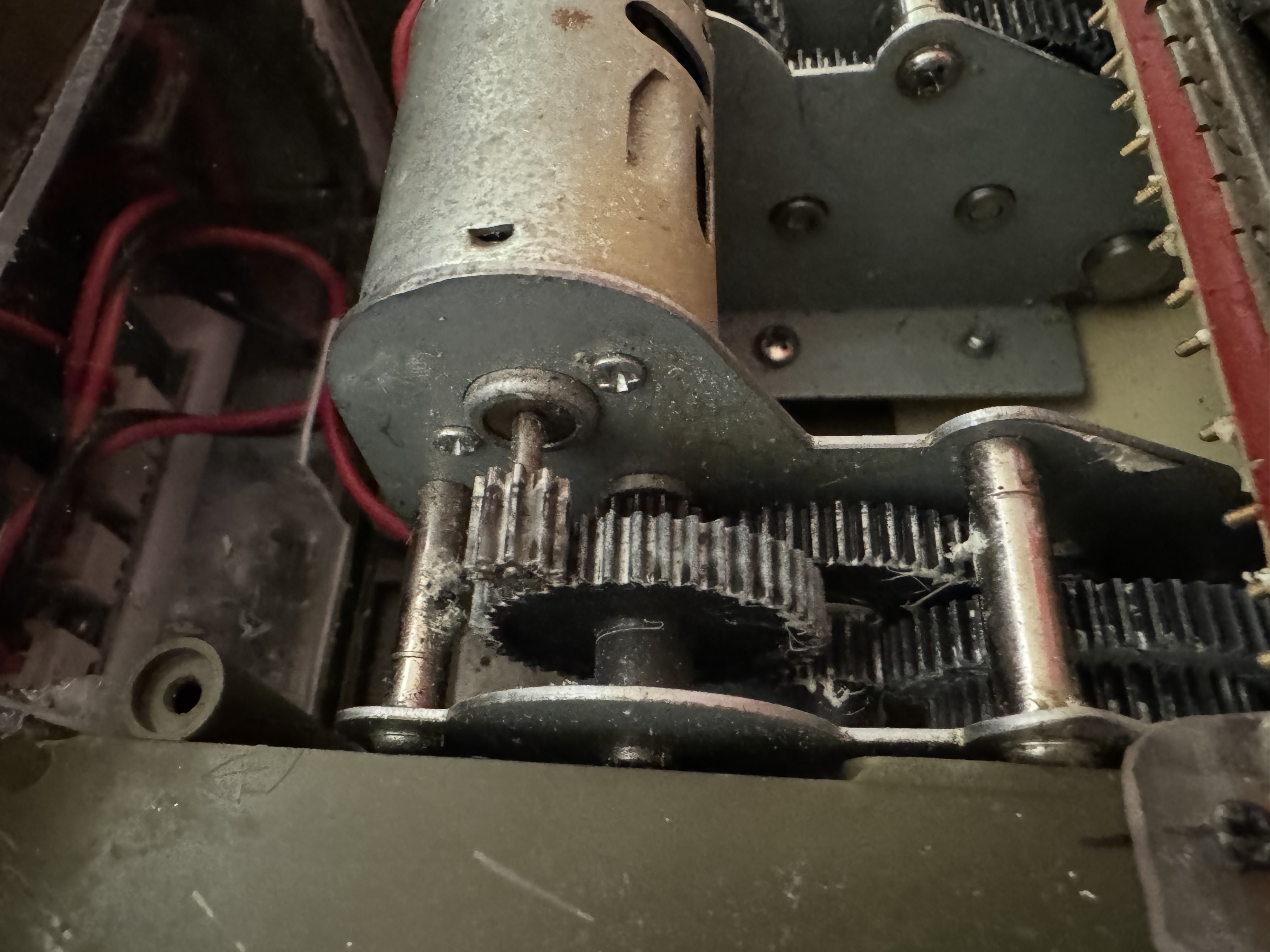

Looking for options on Sherman gearboxes. I have a HL lower hull for my Jumbo and the current gearboxes in there are horrible.
They are supposed to be HL steel with 380 motors and it barely drives even with full throttle on the radio.
Can Taigen/ Torro gearboxes be fit in there instead?
The photos are of what I have now.
Thanks.

They are well worn. I tend to use the hl premium gearboxes they are red with brass gears. They are quieter than Taigen and the ones I have are 2 years old with constant use at shows through out summer and still run well. But some do require part of the guard cutting away to get them in dependant on your transmission cover

Are you sure it's the gearboxes? I've used the HL steel ones in afew Sherman's, even ones with metal running gear, even on grass no issues with power

It is not a radio, tracks, sprockets or electronics as I have checked those on a different tank using different gearboxes and those items all run fine. I even have metal bogies and roadwheels with wheel bearings and the adjustable idler.

I'd be taking them out, giving them a good cleaning with Coleman fuel/naphtha/panel wipe/ white gas, whatever you want to call it to get the worst gunk off, then some carb cleaner. Check for binding with motors off the frames, then reinstall, a little light grease and see how they do.
In the photos, they do look at bit "rid hard n' puttaway wet".
