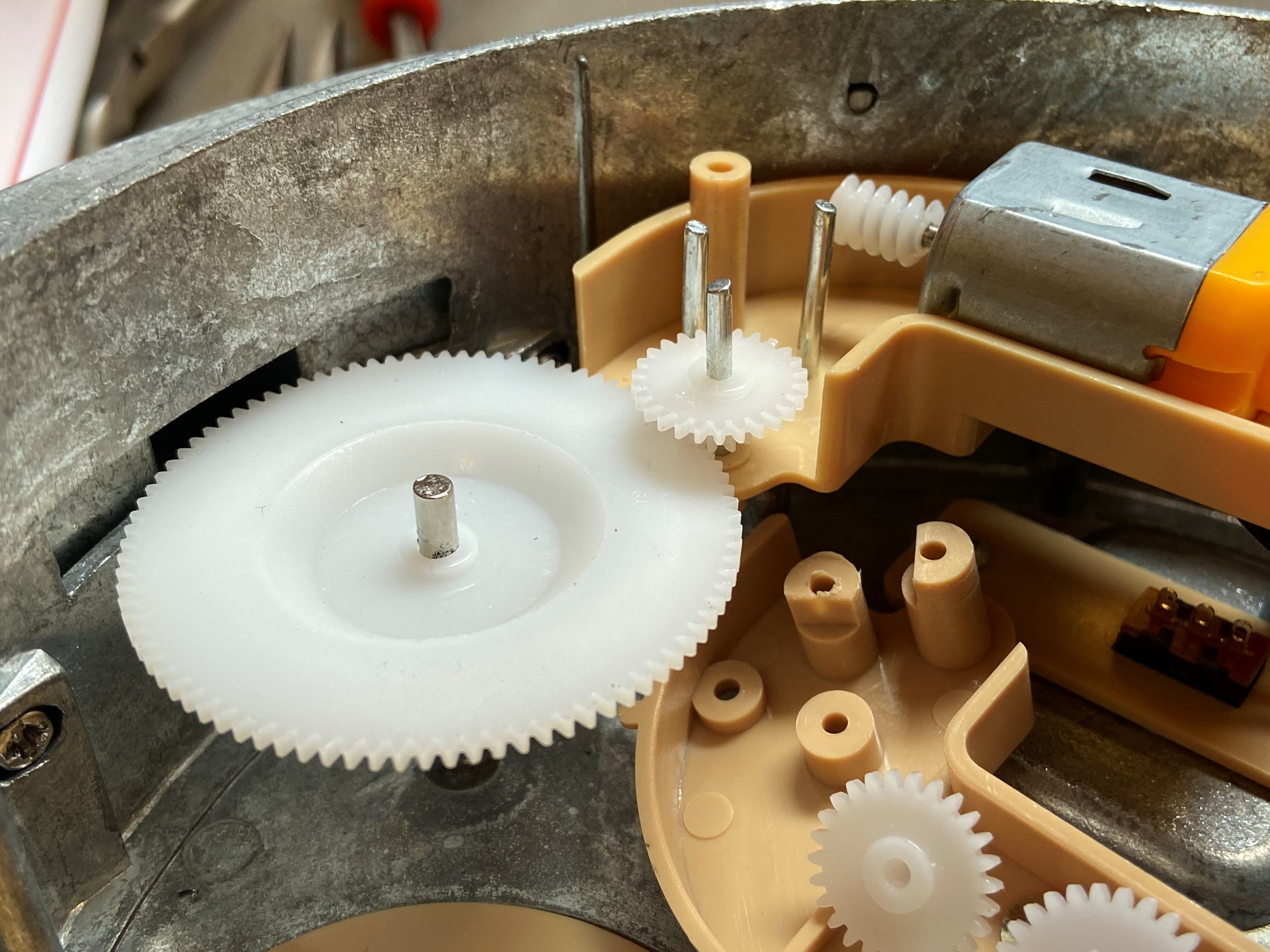

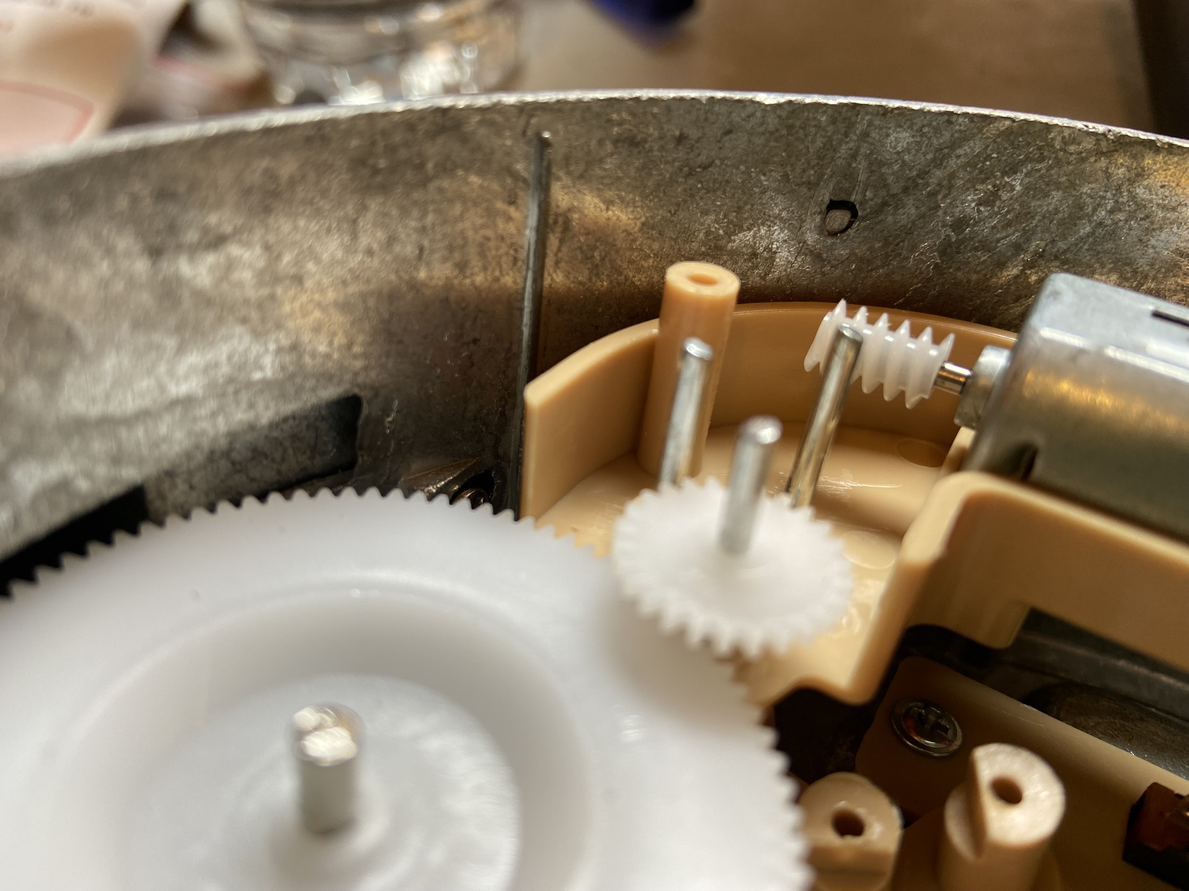

I am building this tank and having an issue with the Elevation unit. The movement of the main gear relies on another gear which should mesh with it. I have installed the main gear but when I fit the next gear it fails to mesh with the main gear. Has anyone else built this tank and how did you get the elevation unit to work?

The OP, appears not to have put all the gears in place.

As for the gear mesh problem, one or more of them could be upside down. The instructions if not clear could be meant to be read as if the gears are as if the turret was in its installed orientation.
Is that possible ?
I would assume there is an intro, but its so far back so as not to be relevant now.
Is that possible ?
