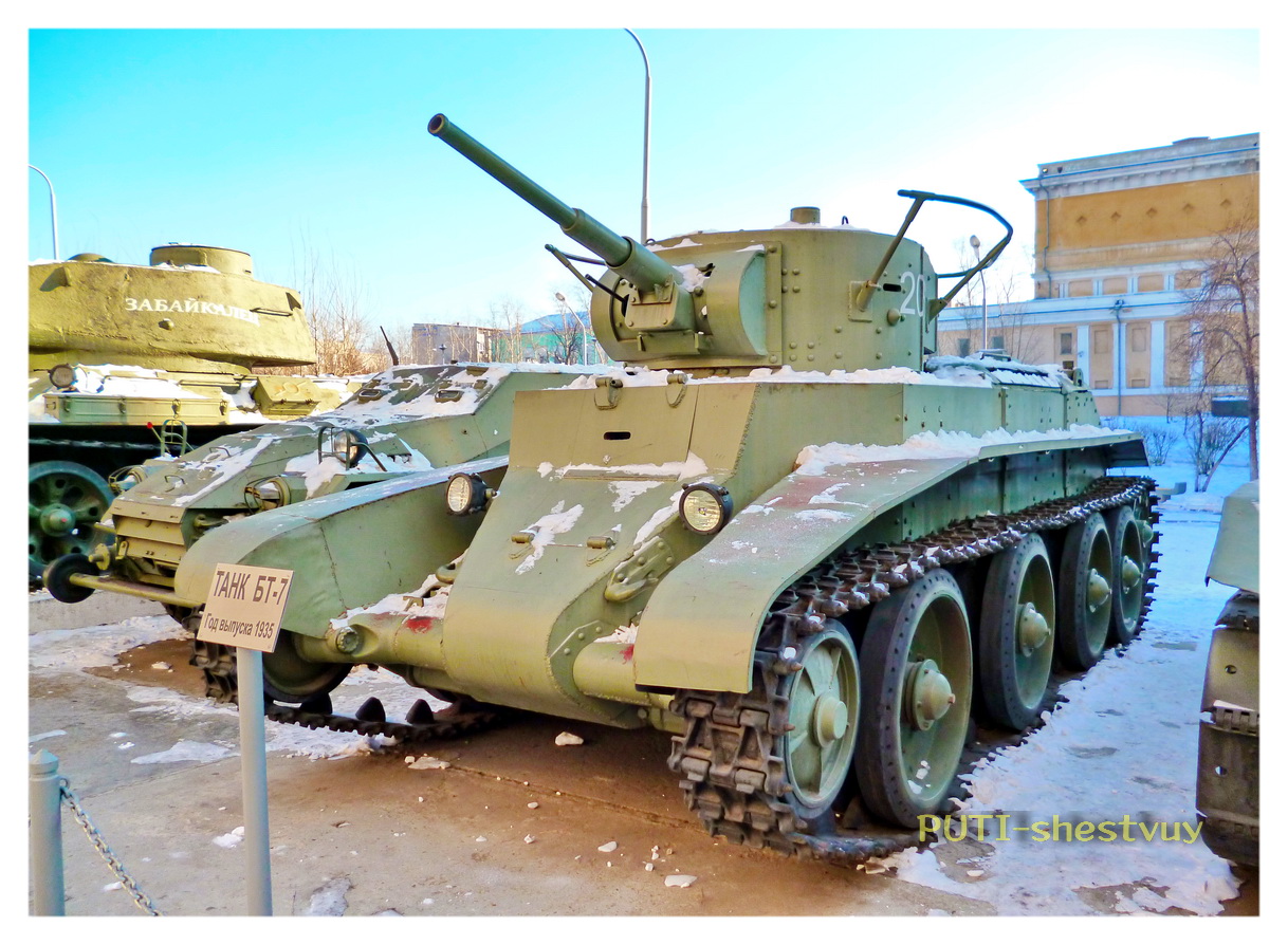

Im thinking of building a BT 5 or 7. It has tracks that look like this:
https://th.bing.com/th/id/R.a0ec97b1a97 ... ImgRaw&r=0
I would like to know;
a) The pitch of the link. Pin to pin centres.
b) Width of the link
That will get me started. But also;
c) Any decent drawings of individual components. Especially suspension, Preferably with dimensions,
Thankyou, Mike

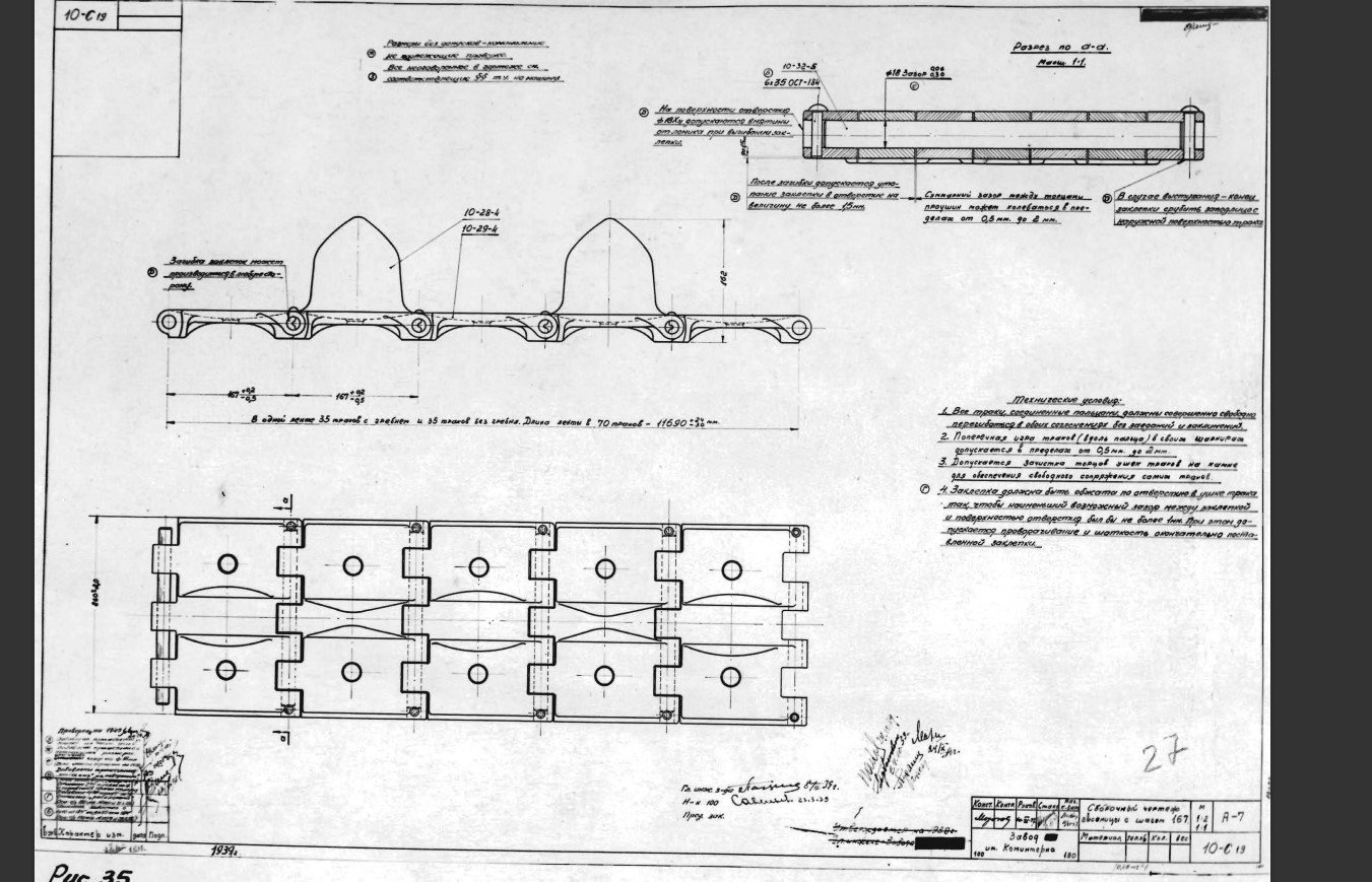

Hi Mike, I have some info for you, mostly copies of original drawings, Unfortunately the document is 24 mb big, I am not sure I can attach it here.
bt-7 2.jpg (309.05 KiB) Viewed 761 times
Regards,
Jaap :wave:

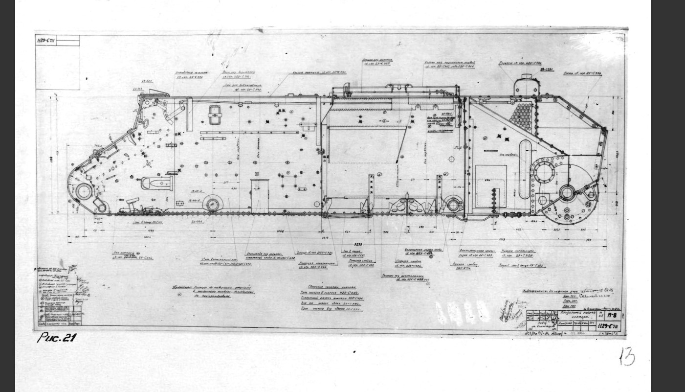

jee
Posts: 1006
Location: Siberia
Re: Soviet BT series tanks
Post by jee »
Regards,
Jaap :wave:

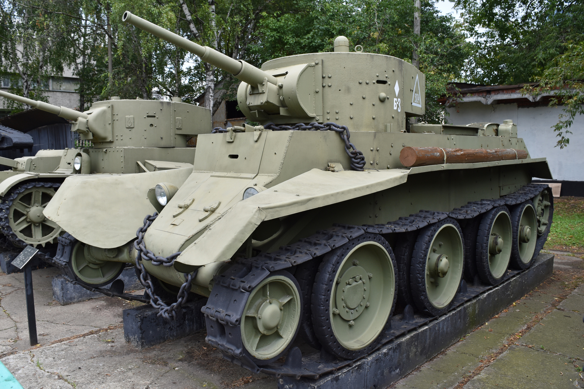

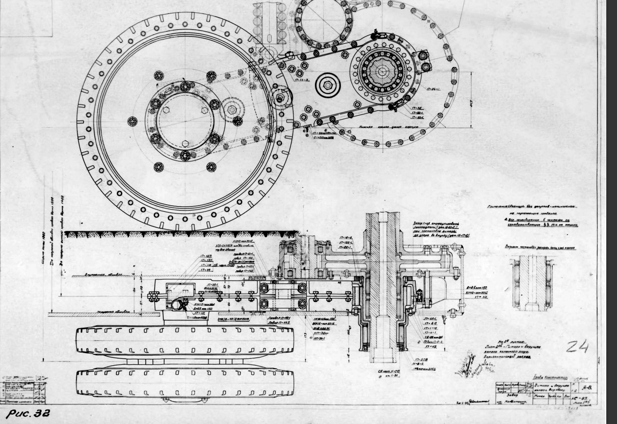

jee
Posts: 1006
Location: Siberia
Post by jee »
seems they used a lot of different version tracks
Regards,
Jaap :wave:

Those are really usefull drawings. Thanks very much.
Do you have any any more!
Also, Can you confirm the track plate width. Its a bit fuzzy at my end. It looks like 240?

MikeN wrote: Tue Apr 16, 2024 4:54 pm Those are really usefull drawings. Thanks very much.
Pitch is 167 (with a limit of .75mm!) very generous tolerance. But then its Russian.
Mike, you can download it here: https://drive.google.com/drive/folders/ ... sp=sharing
2 books, and in the zip file you will find a PDF with the drawings.
Also another 2 books but in djvu format, I guess you need to download some viewer/reader for that.
You can easily enlarge the PDF to check the numbers. For me it is a bit unclear if it is 2 or 340, but in any case you will have the length (167), and I think with that number you should be able to recalculate the width of the track.

jee wrote: Tue Apr 16, 2024 4:49 pm seems they used a lot of different version tracks
Yes, the type in my first post with the smooth tread plate is the only one I think I can fabricate reasonably well.
Also just realised that the smooth links are longer pitch so only 92 required instead of 136 of the other types.
