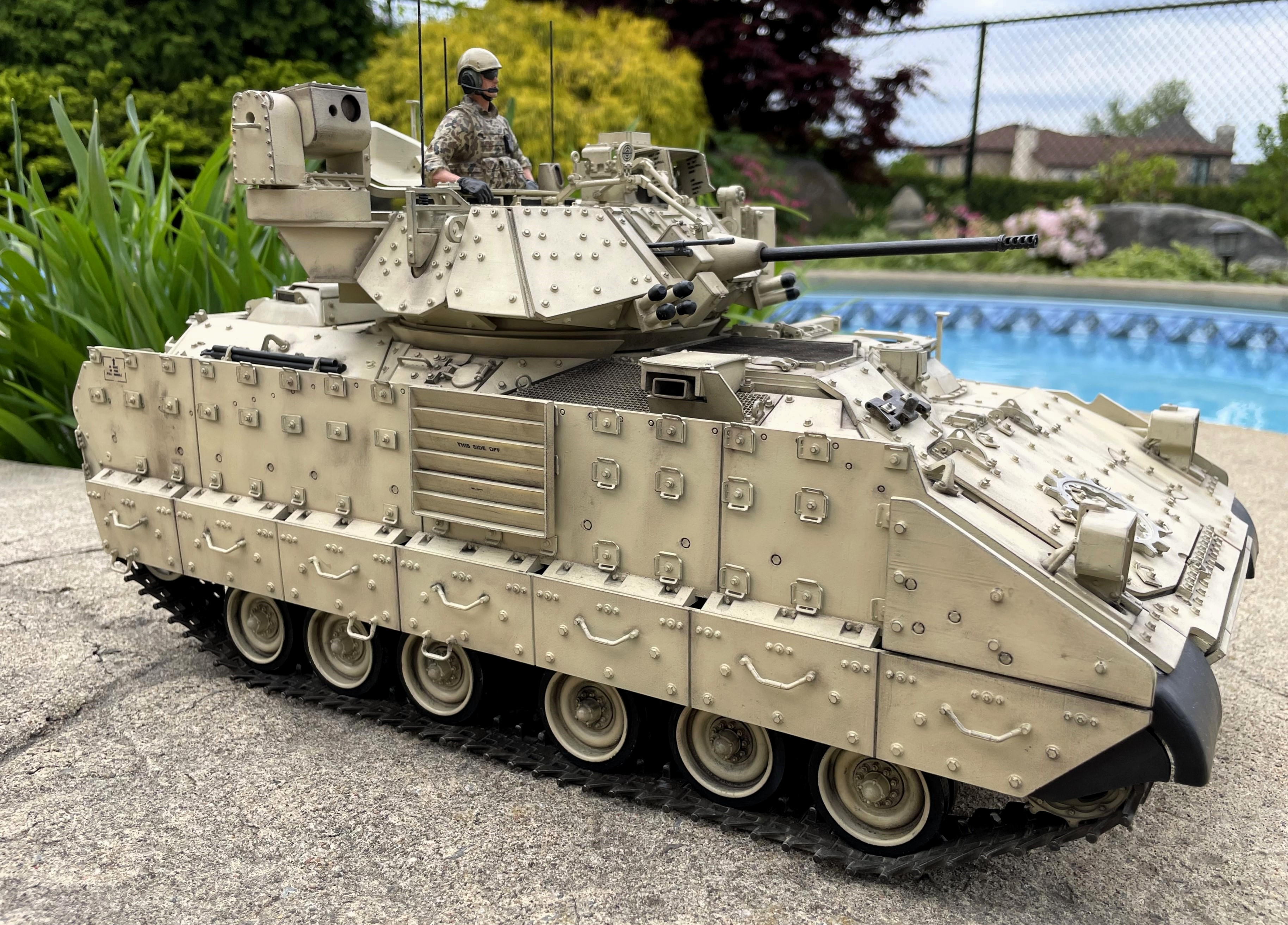

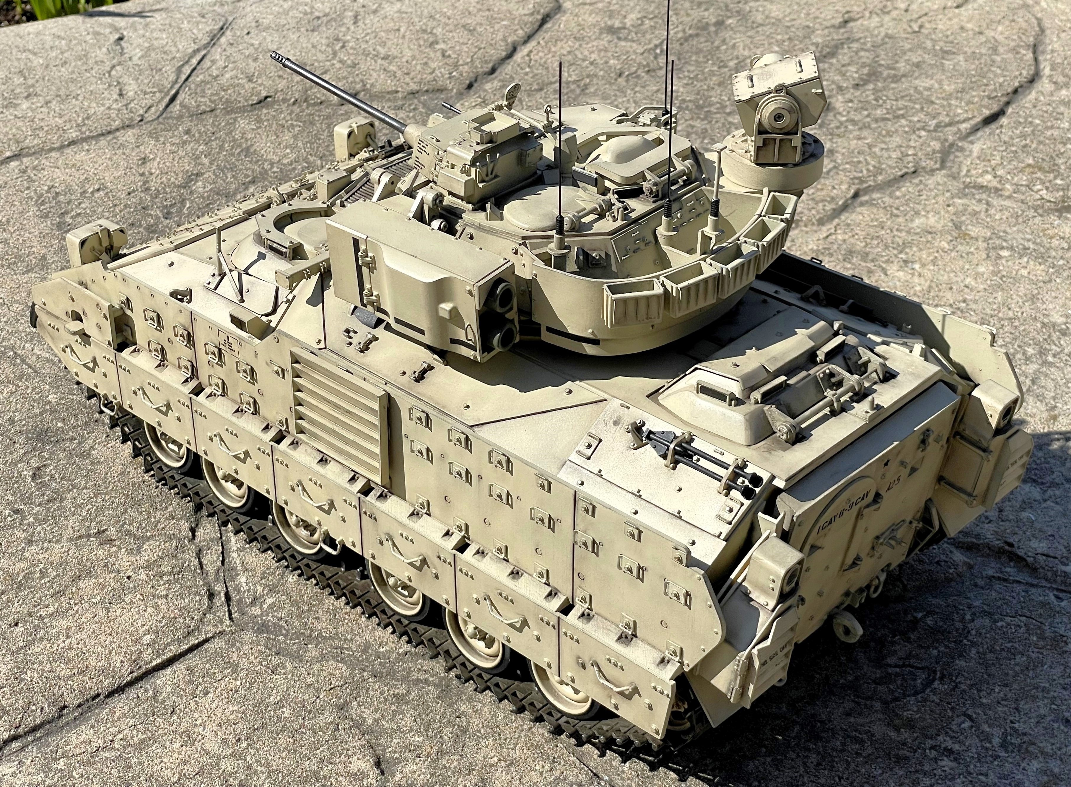

1/16th OKMO DKLM M2A3 Bradley converted to the M3A3 recon variant with the following upgrades and features;

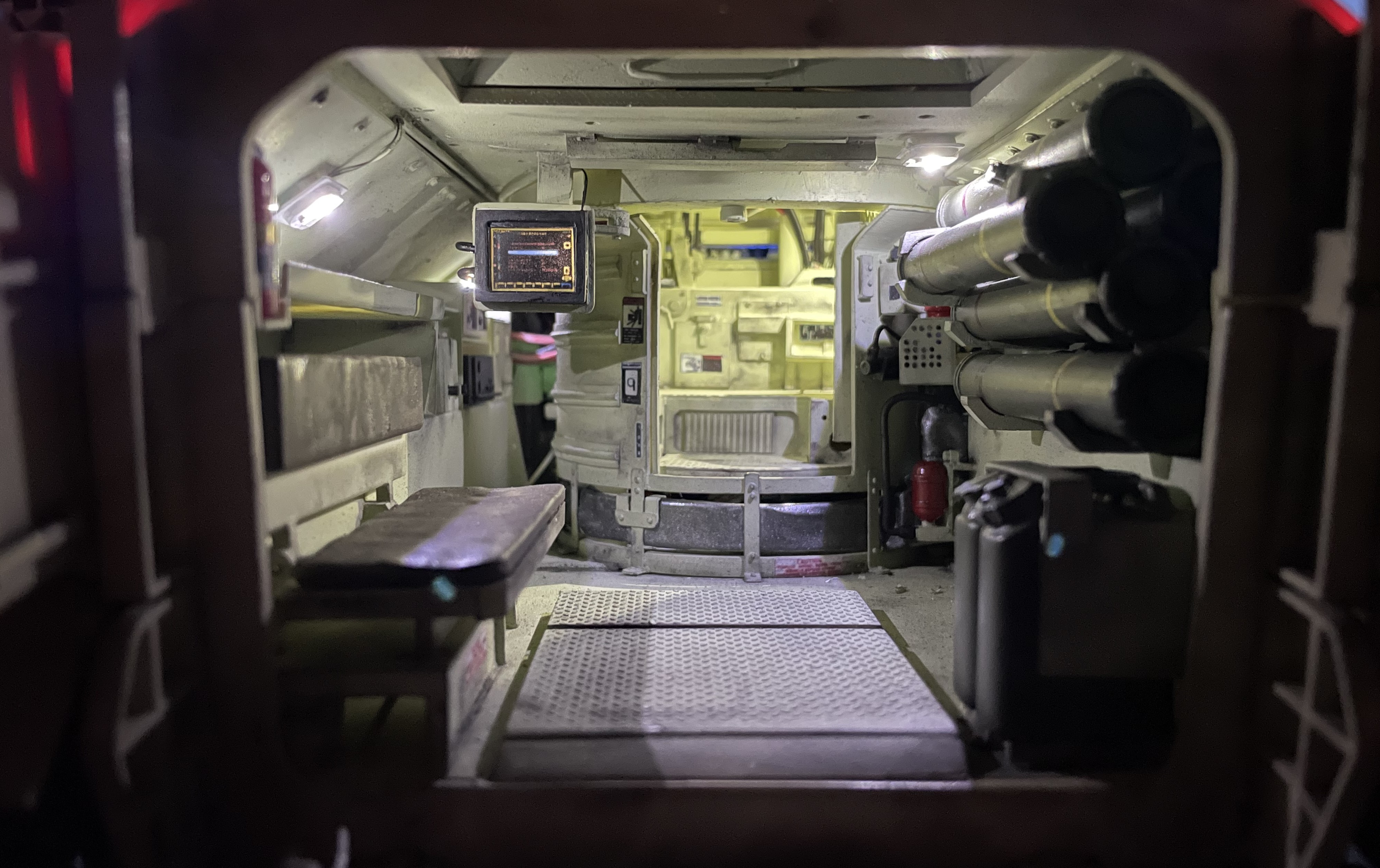

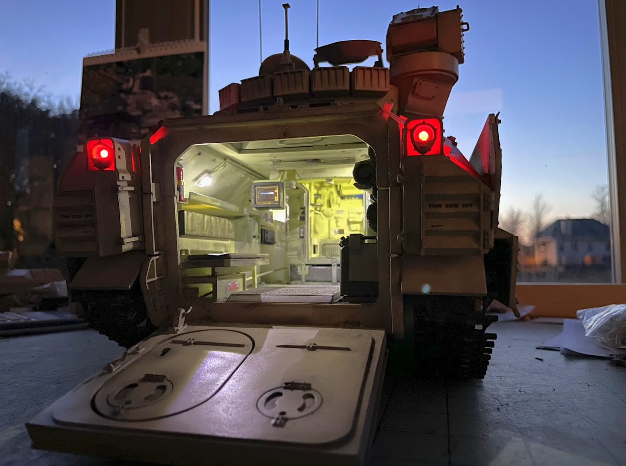

- Detailed scratchbuilt interior of fighting compartment with rotating turret basket, interior lights, M3 rear top hatch details
- Servo operated rear ramp

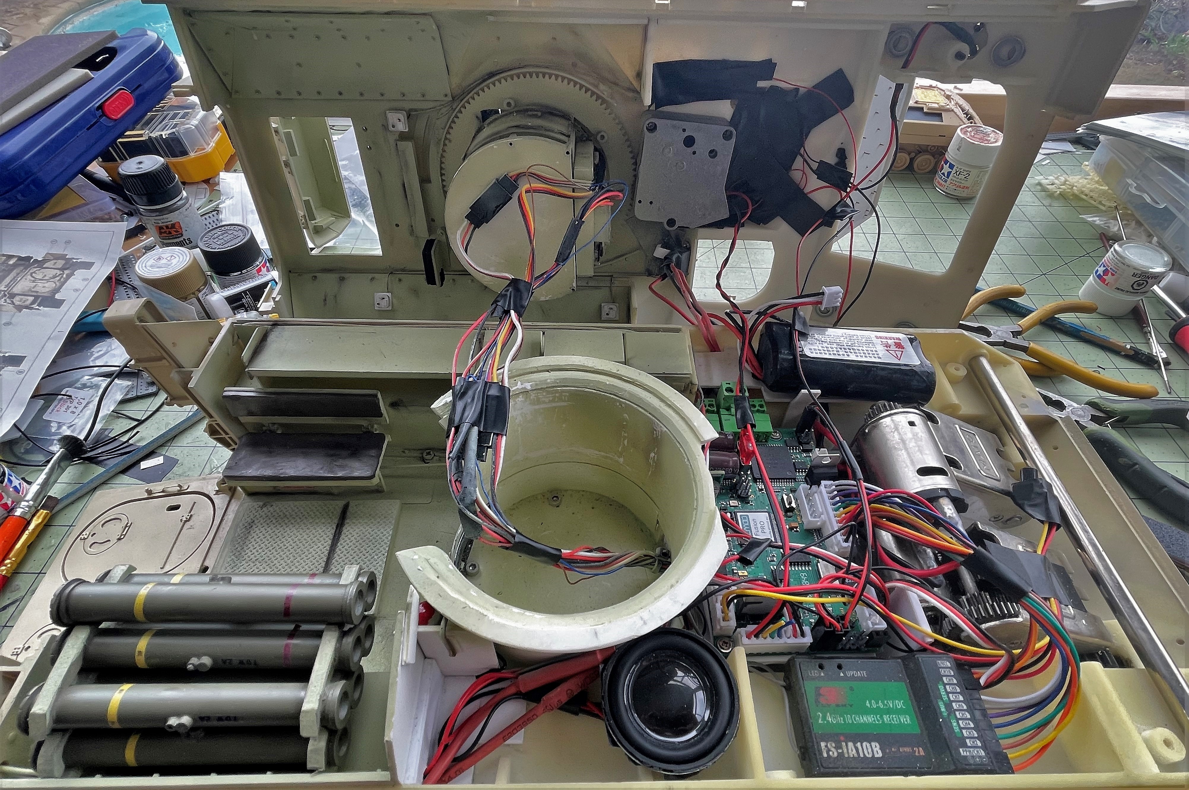

- Mato Panther metal gearbox adapted to DKLM sprocket gears
- Elmod Fusion Pro control board
- Sherman tracks replaced by AFV-Model Bradley early metal tracks converted to late Big Foot tracks with rubber pads, and metal sprocket

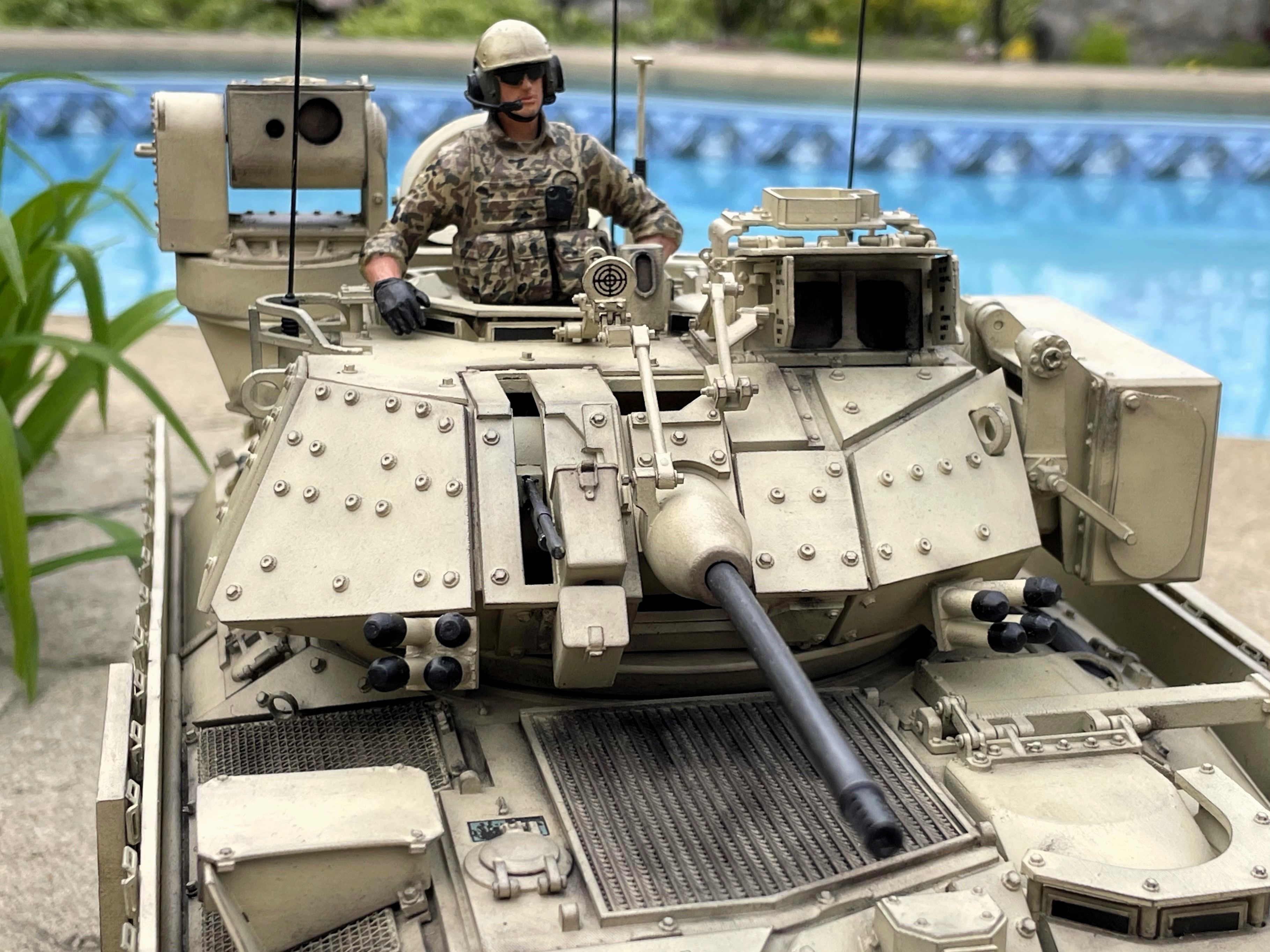

- Operating Bushmaster main gun with barrel recoil, elevation, flash and sound
- Operating coax machine gun with flash and sound
- Tow launcher can be raised
- Added missing add-on armor plates
- DKLM commander figure
