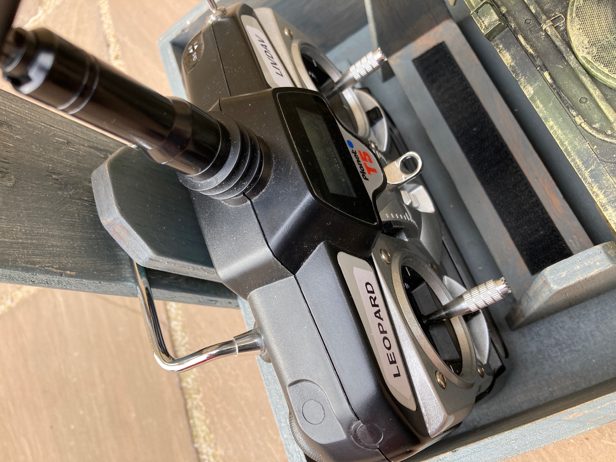

Suitable shapes were chopped up to make "buffers" at the front and back to keep the tank in place inside the frame and another to hold the transmitter in place. A strip of Velcro was added to hold the tank battery safely as it is never in the turret until the tank is being run to help delay the inevitable Tamiya 2A6 Leopard turret sag.

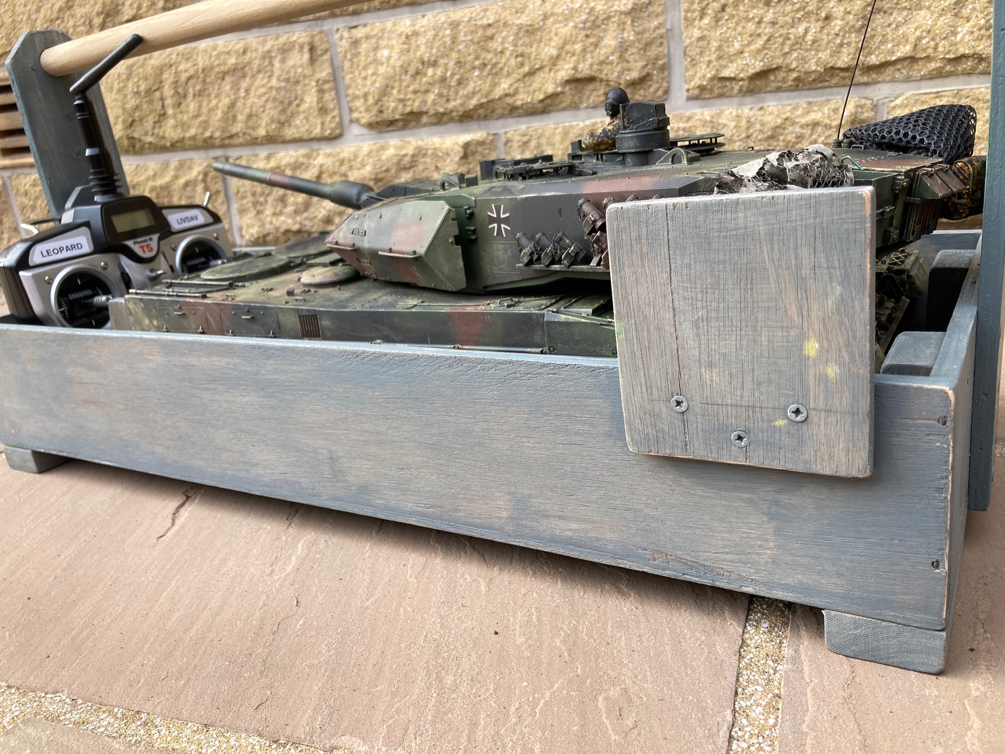

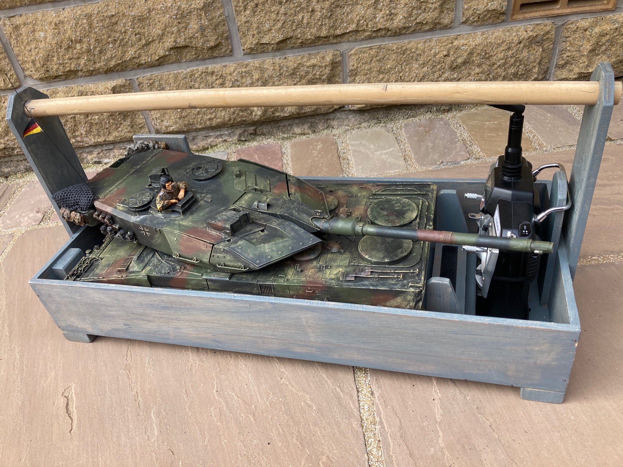

Here is a picture of the “carry cot” that I knocked up quickly to help transport my Tamiya 2A6 Leopard to the club without damaging it.

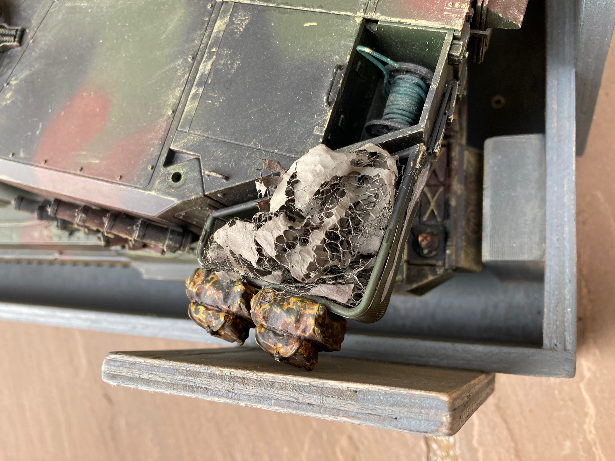

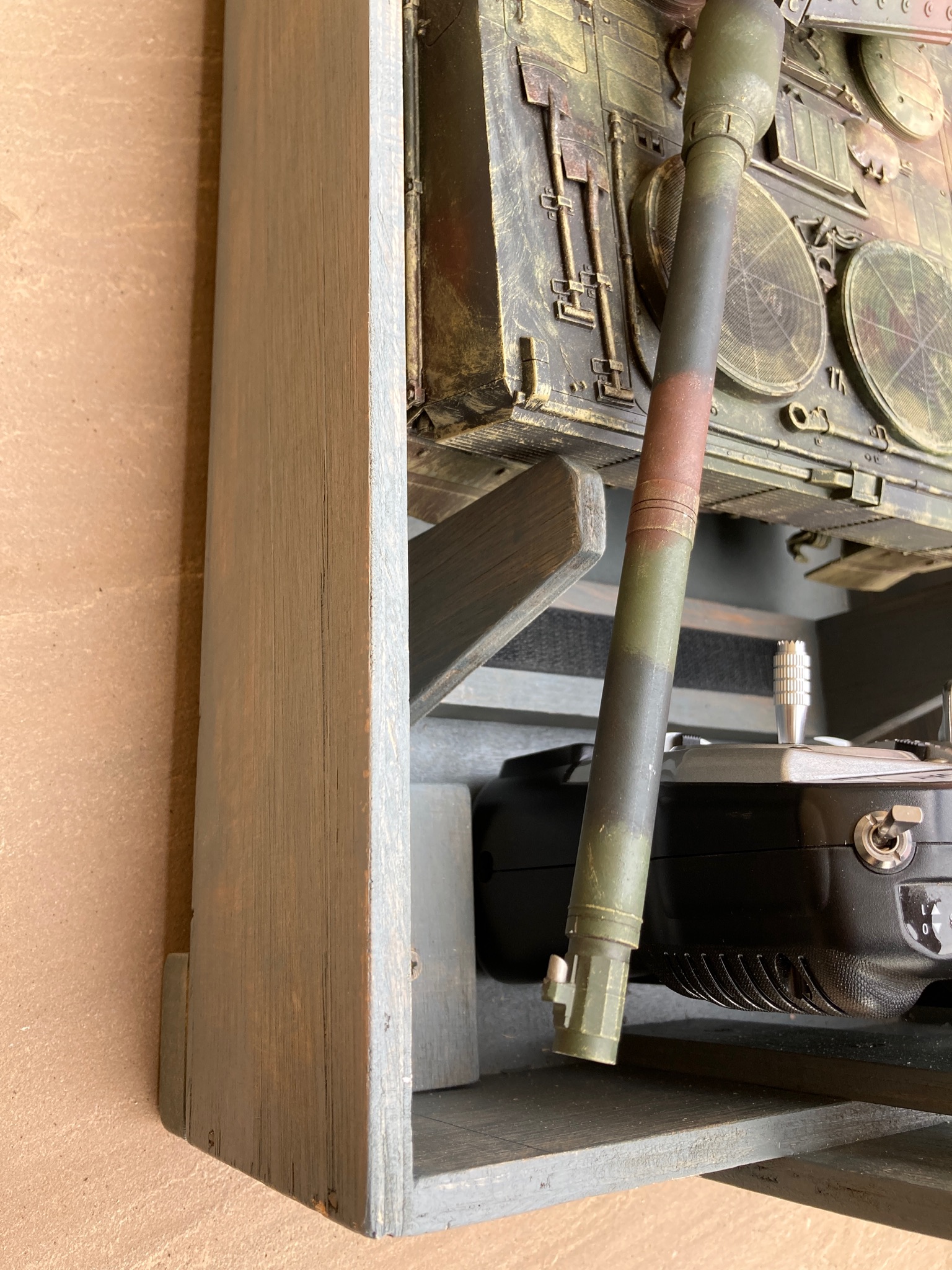

Plate added to protect the turret basket.

A wooden "shield" was added to protect the turret basket and the length of the carry cot is just long enough to keep the barrel safe.
All the "add-ons" are only screwed-on so the carry cot can be modified and changed as I find out what works !

The diagonal angle that the turret has to take to give the shortest overall length (and clear the transmitter body) does position the Leopards turret basket close to the edge of the cot, so an "armoured plate" of scrap plywood is added in this area to protect it as I know that it could get damaged in transit without it. Other tanks that I have tried to date do not need this, but my Chieftain and Challenger may need a similar "plate" to protect their turret baskets as the angle of the turret does leave the baskets a bit too close to the sides and potentially vulnerable.

Mk2 carry cot in a nice subdued camoflage colour 😂

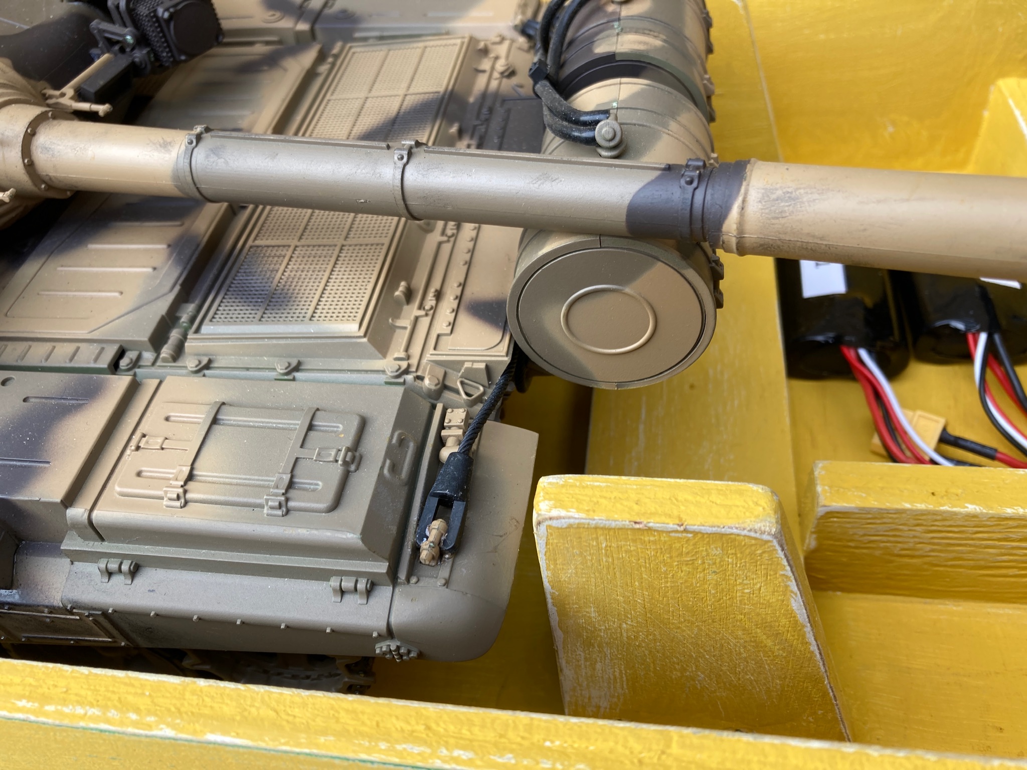

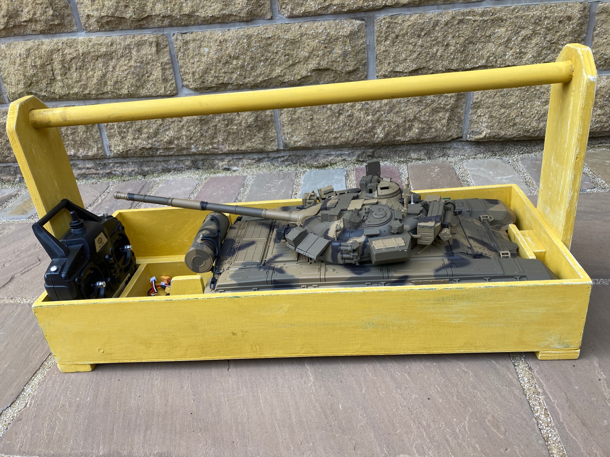

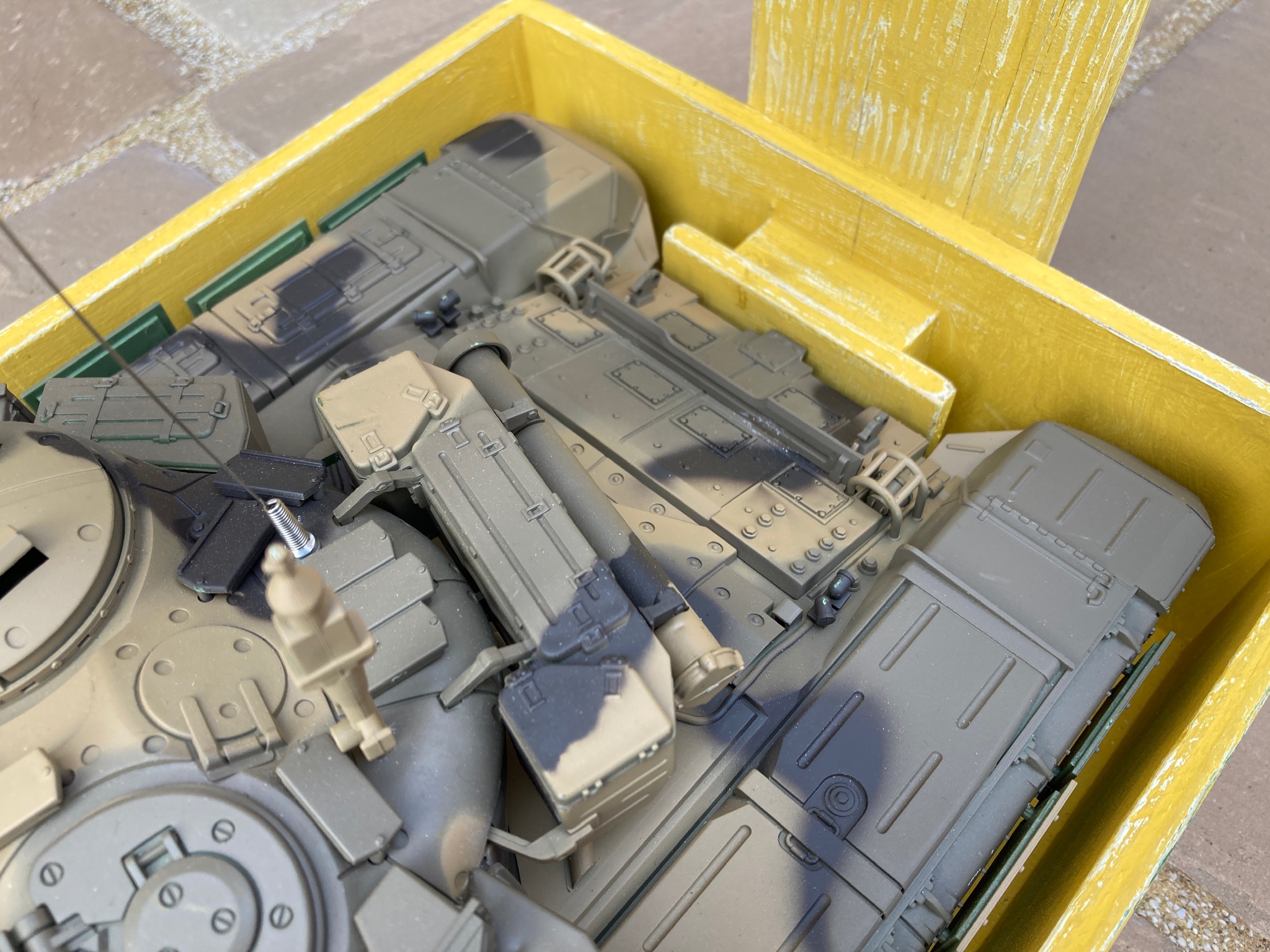

This version is to fit my new Heng Long T90.
