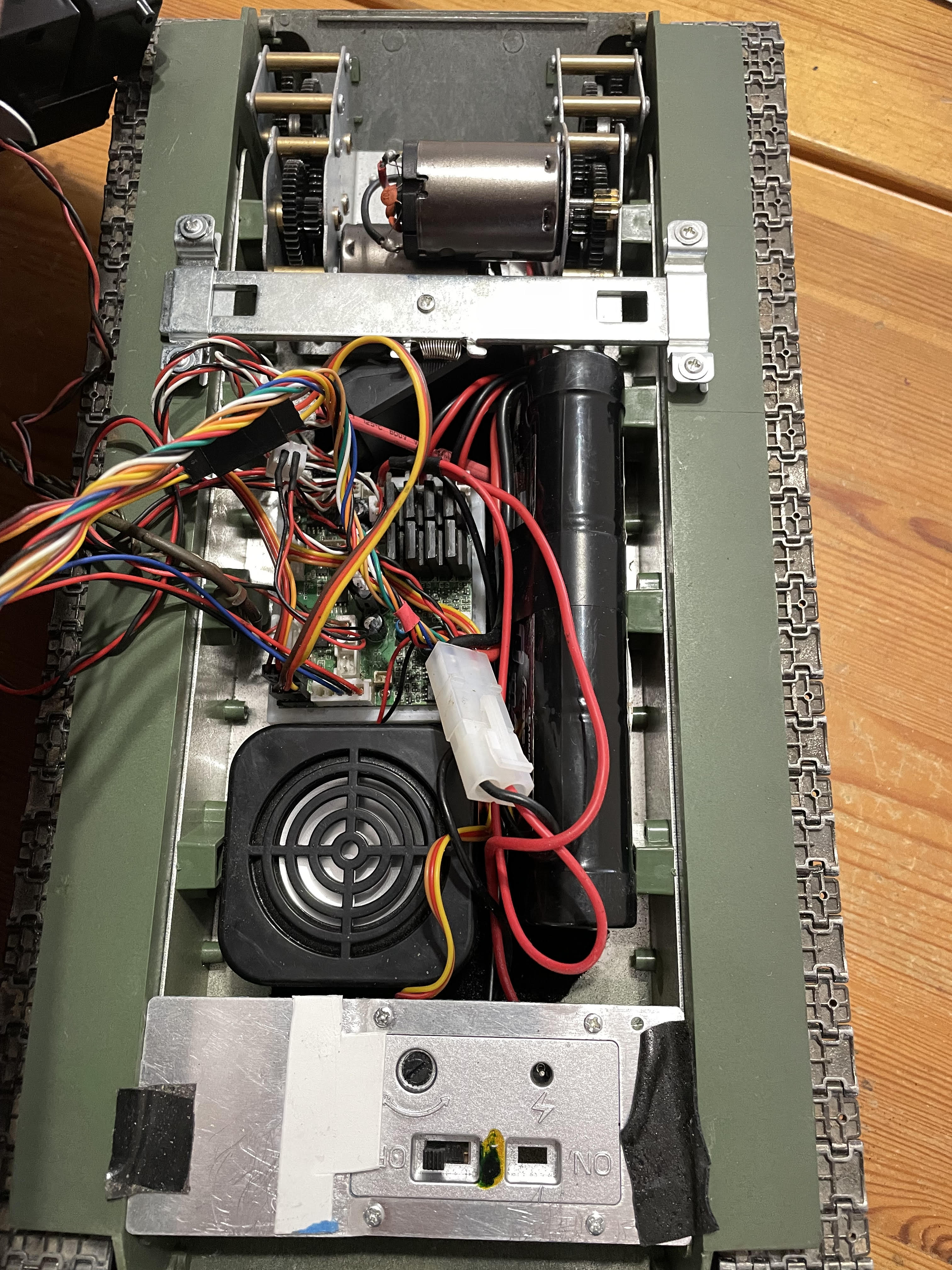

Gas hog wrote: Fri Mar 22, 2024 12:48 pm Hello
I have been trying to find out which battery type would be the best to use for my tanks, my problem tank is a Taigen T34. It does not have much space to fit a 6 cell battery. Can a Li- Ion battery be used to power Heng long Haya Tamiya and Taigen MFUs ? . Any advice please!.
Are Lithium batteries safe? i am a little concerned after reading articles about electric scooters and things catching fire with these types of batteries.
If you are running the V3 board in your Taigen T-34 it's an easy fix to put a 6 cell 5000 Ni-Mh in that will run all day . Just unscrew the V3 board and speaker and put some velcro on the floor and then move them over. This is mine with a Clark in it but I had a V3 in originally
T-34 bat.jpg (1.38 MiB) Viewed 651 times
