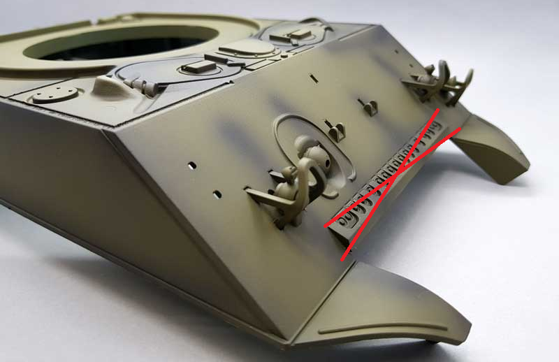

In my opinion, the HL upper hull is of lower quality (e.g. softer plastic). In my case it is only held together by gravity. Additionally, in HL you have to remove the strip with screws to fit the Taigen lower hull.posting.php?mode=reply&t=35745

Thanks for the responses everyone. I was aware of the turrets not being compatible due to the differences in turret rings but somehow missed the fact that the bolted section of the transmission cover is molded onto the HL upper hull.
