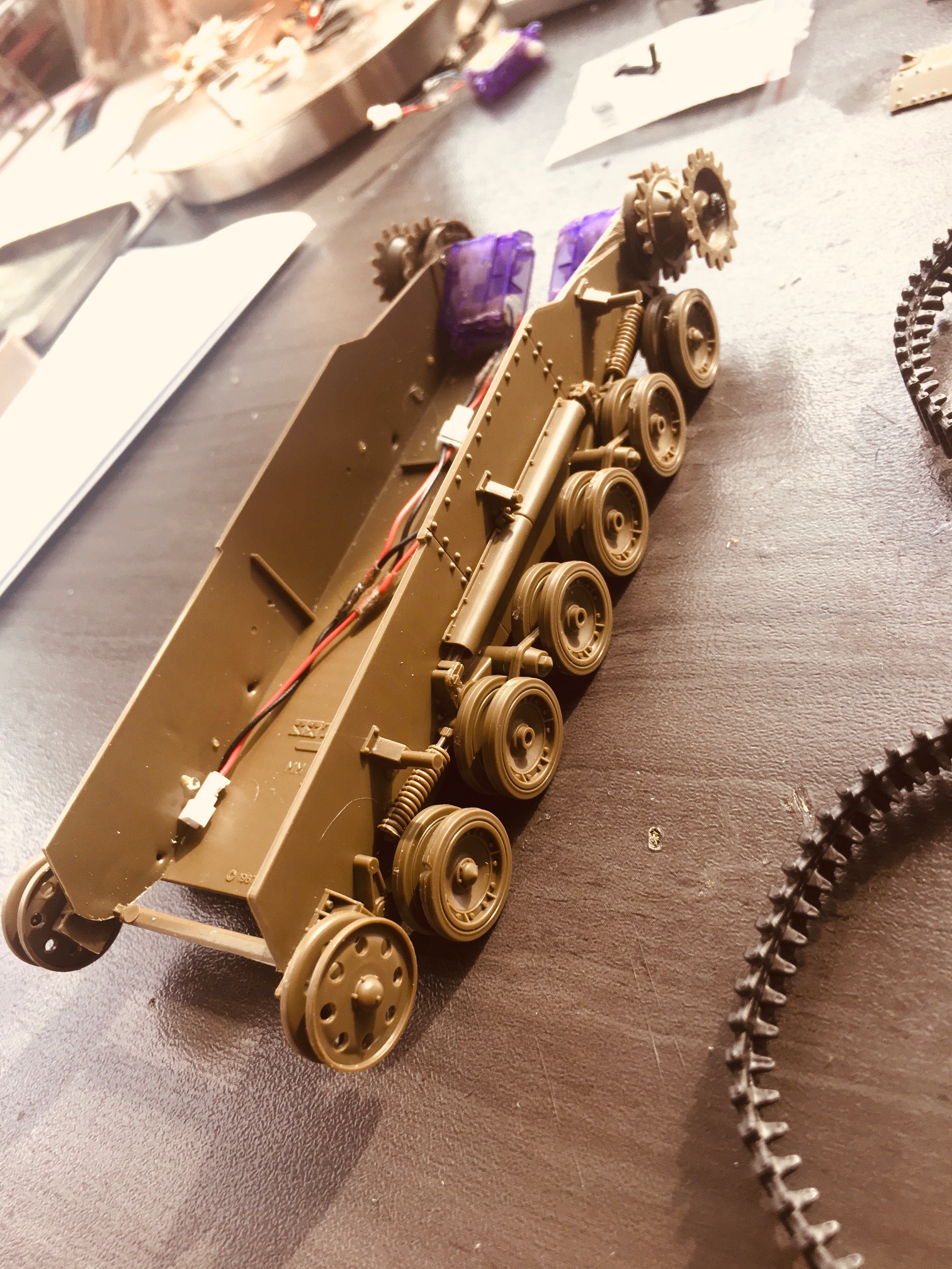

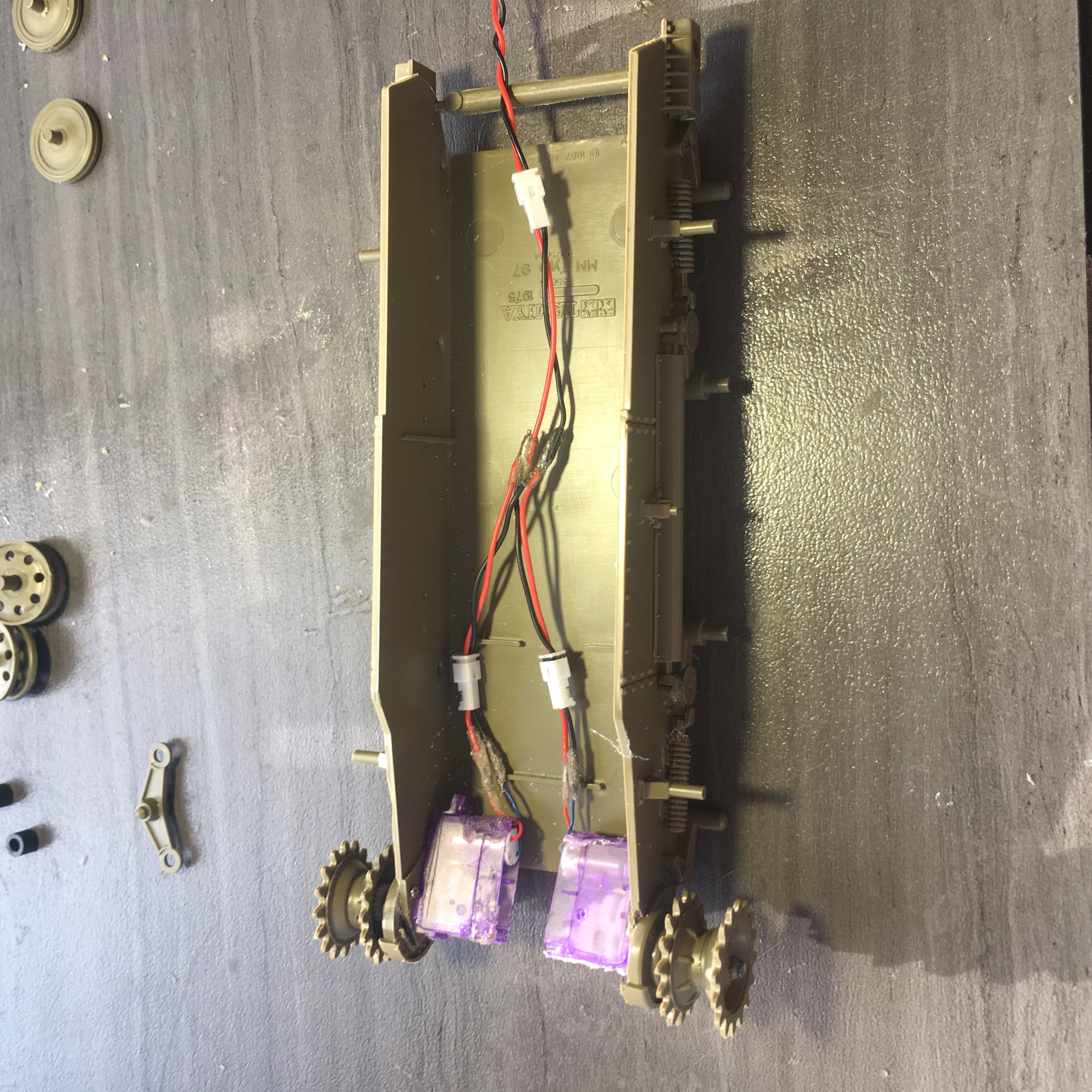

Just got one of these new, sealed in the box from 1975! I will be doing something different on this one using servos for the gear box and then using the servo circuit boards as ESC's.
Some servos can be modified by adding a few resistors to be repurposed into speed controls.

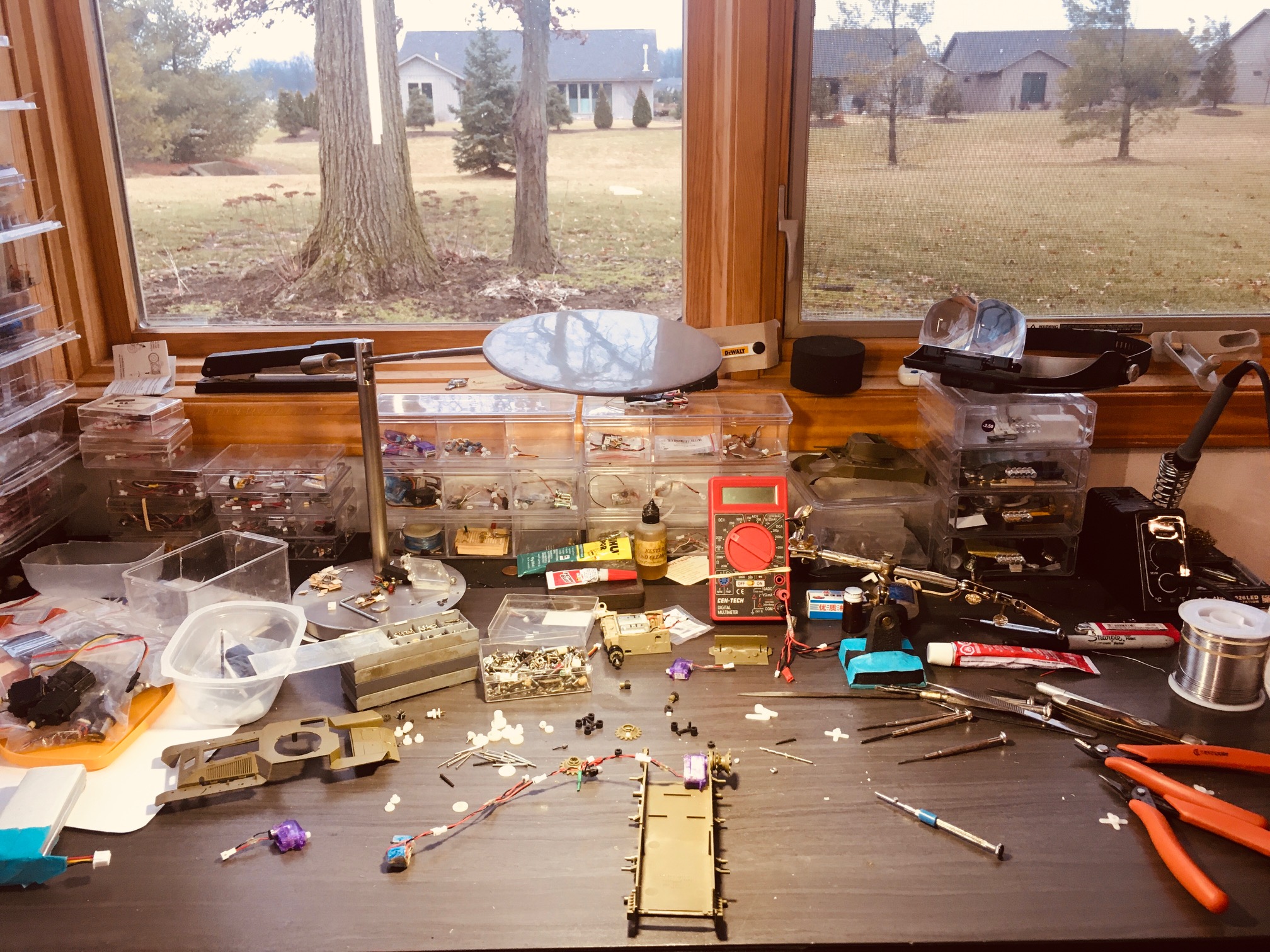

model build shop in operation.

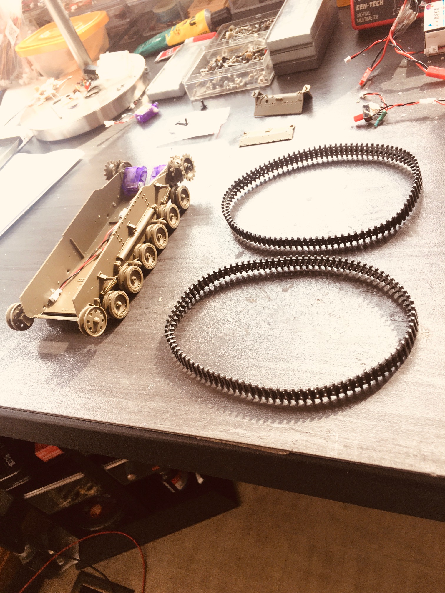

One servo gearbox in position.

I often wondered how much servos will stand up to continuous running? Oh, and I like your modeling table right by the Pella windows that can be opened for fresh air on nice summer days.

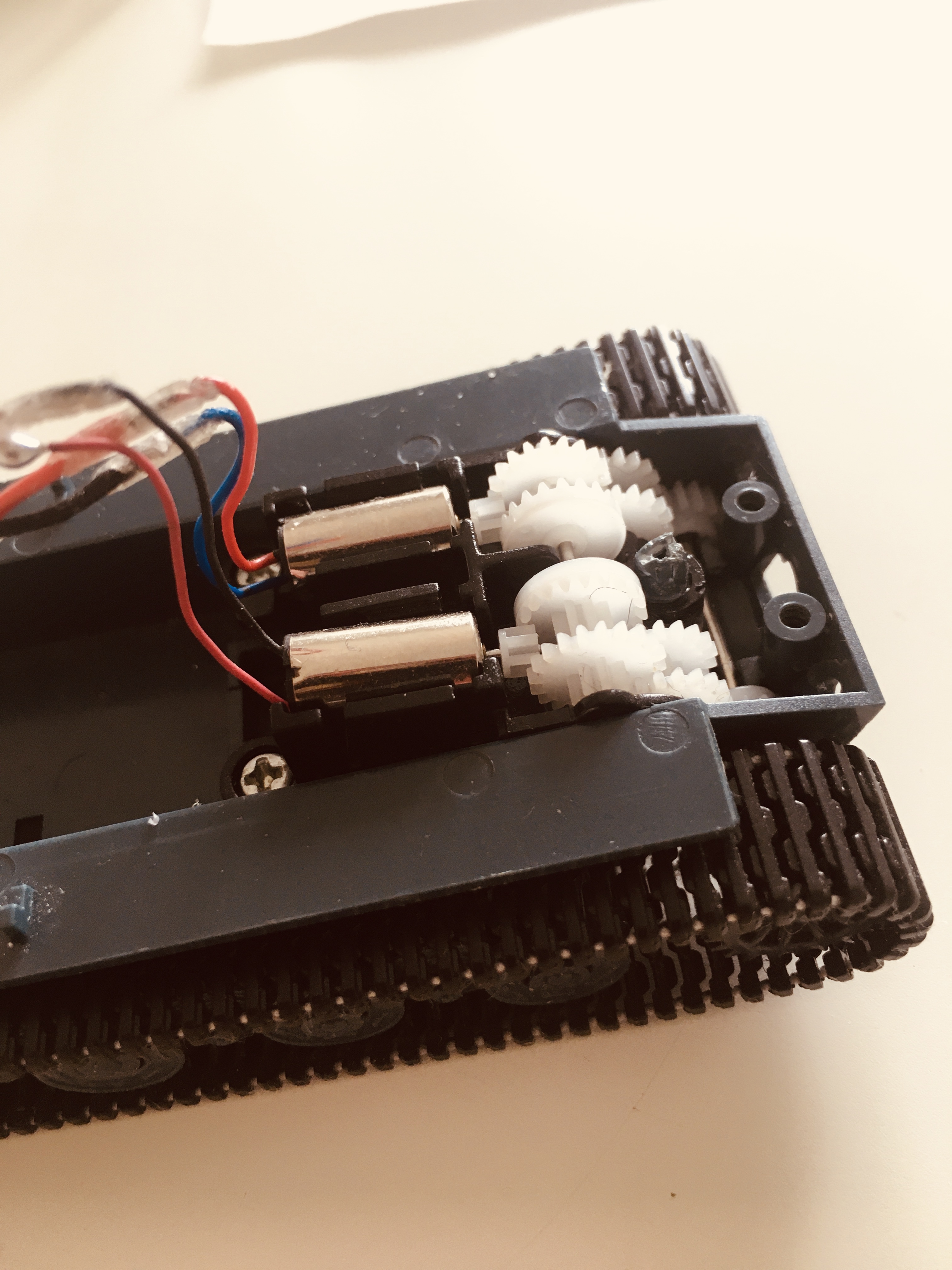

I have several micro Tanks with coreless motors and they seem to hold up good. Of course they are lightweight Tanks with 1s lipo.
Depends on what you mean by continuous running. I run these smaller Tanks until the battery is done, anywhere between 10-20 minutes. Oh, there is little else that will fit in this tank. Even the MTM gearboxes are too big for this one :O
Yes on nice days I certainly open the windows for fresh air, I live in a rural area where the air quality is good.

Here is an example of coreless motors with gearbox in a Tank. The motors are the same as in most coreless servos and no they do not last as long as brushed motors and generally are run at a higher RPM than standard brushed motors. If kept at higher RPM's, they seem to last a good while plus they are much smaller and use less power
10 hours to get to this point and nothing is really done until the tracks are spinning and don't fly off lol. You can see the date inside the hull 1975!
these servos I am using are Blue bird 303's and are pretty small and they just fit in this Tank..
ready for tracks and testing drive.

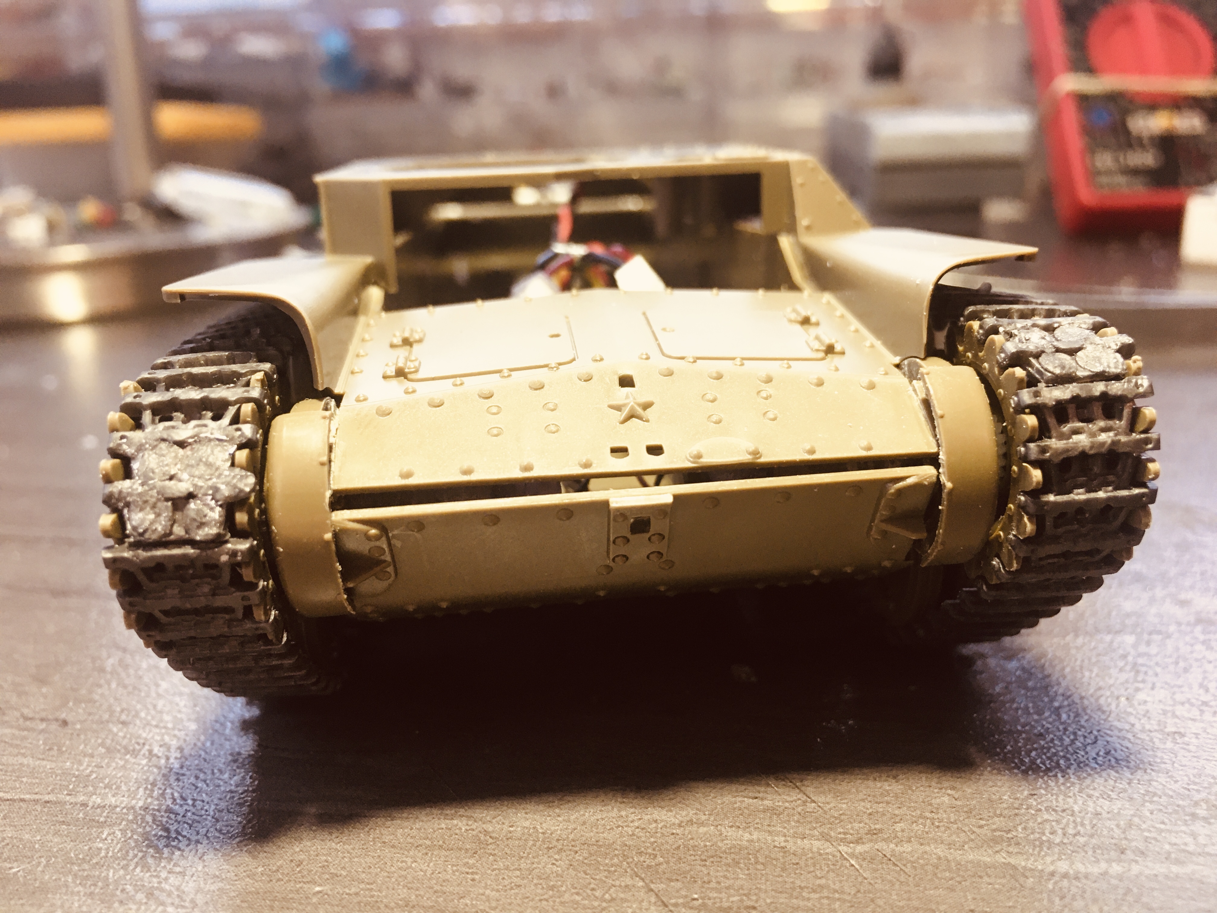

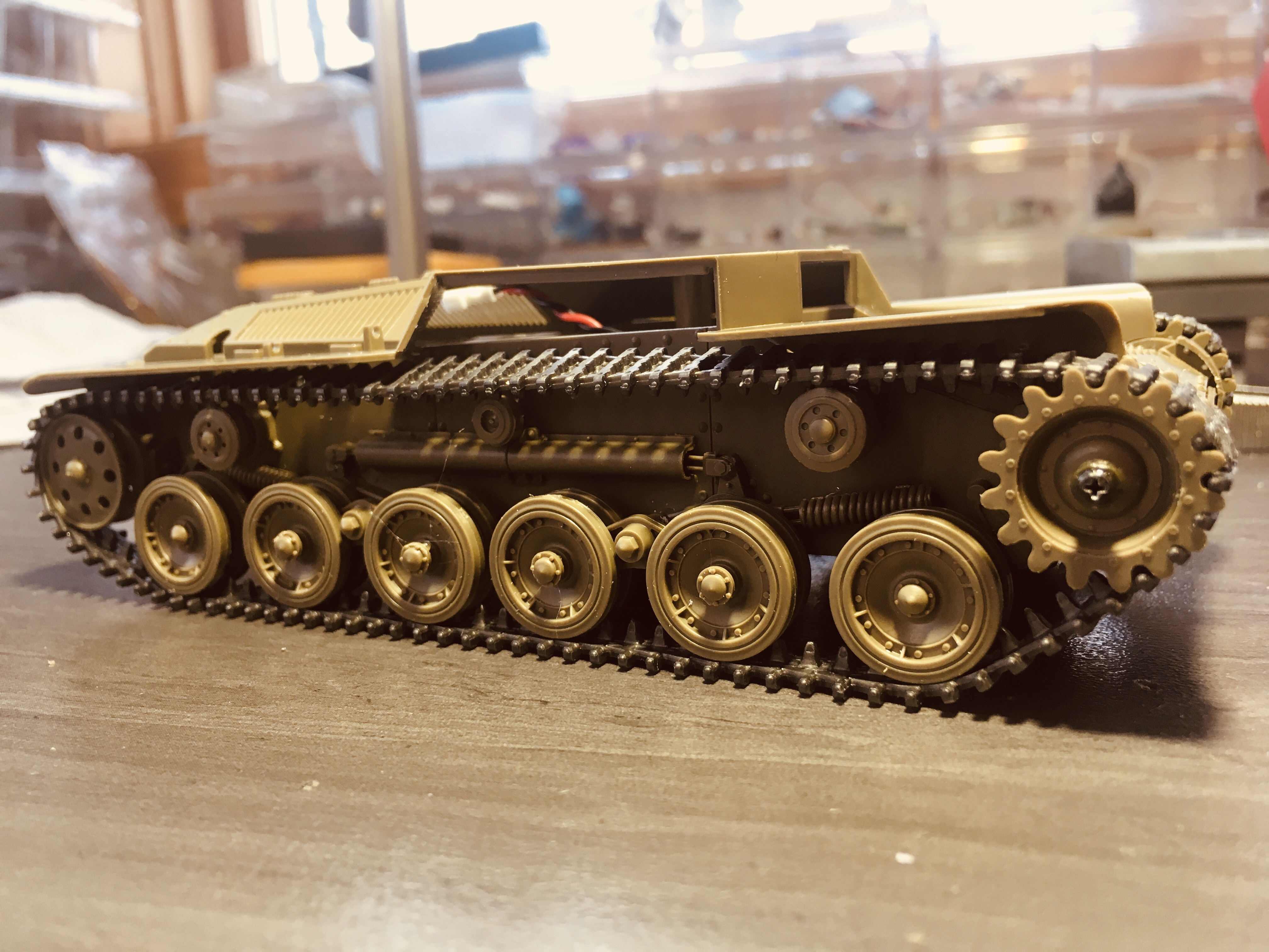

Time to install the tracks and do a test run :D
Ok, this T-97 has super gradient ability. The tracks system works perfect. No danger of this thing throwing s track 8)
Here is a short video of the Tank doing a test track run
https://youtu.be/St8xM1NH6Z0

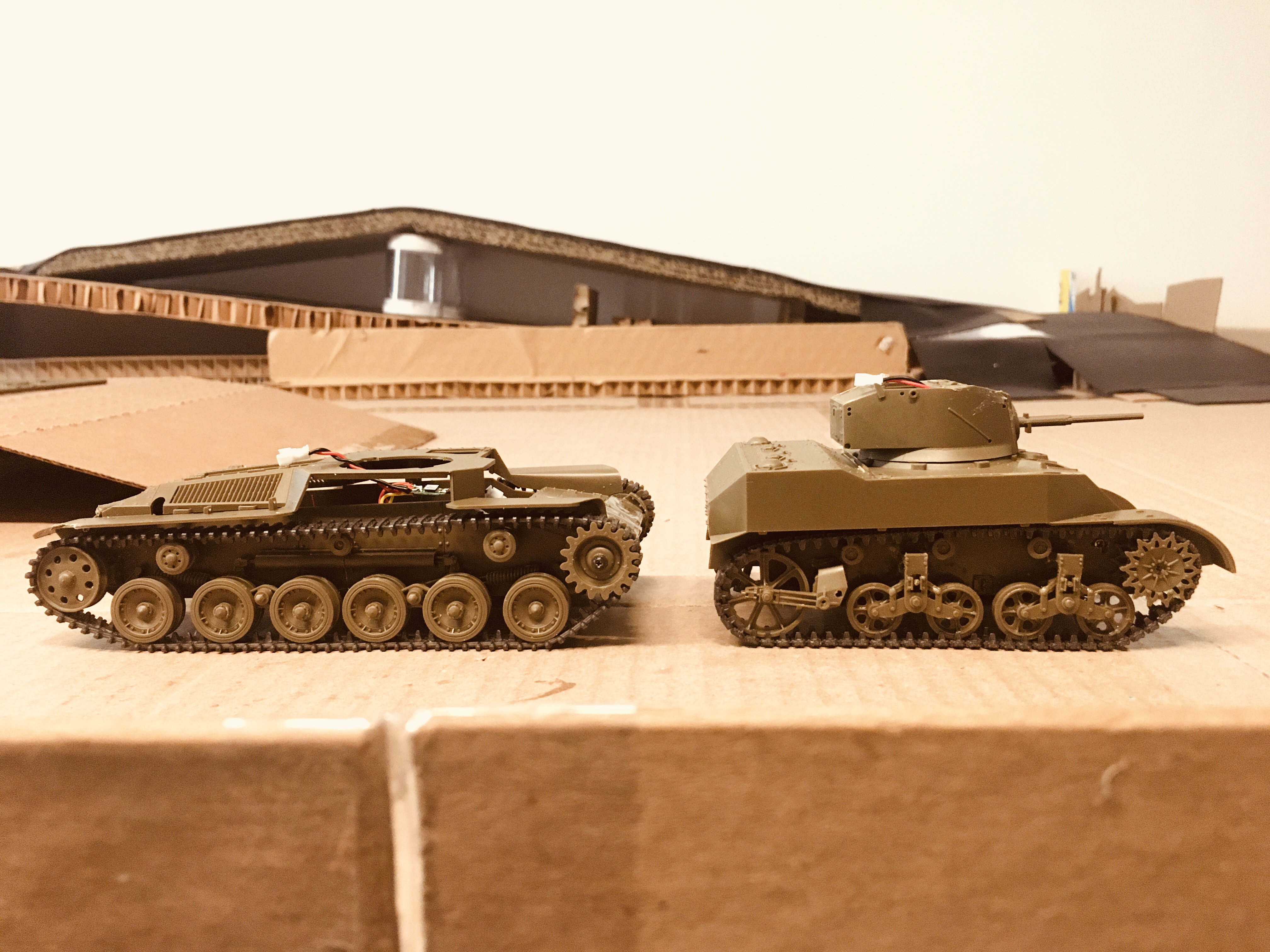

T-97 Vs M5 Stuart. The T-79 wins in every aspect especially suspension.
the middle four road wheels have some suspension travel if mounted properly so this tank does have workable suspension.

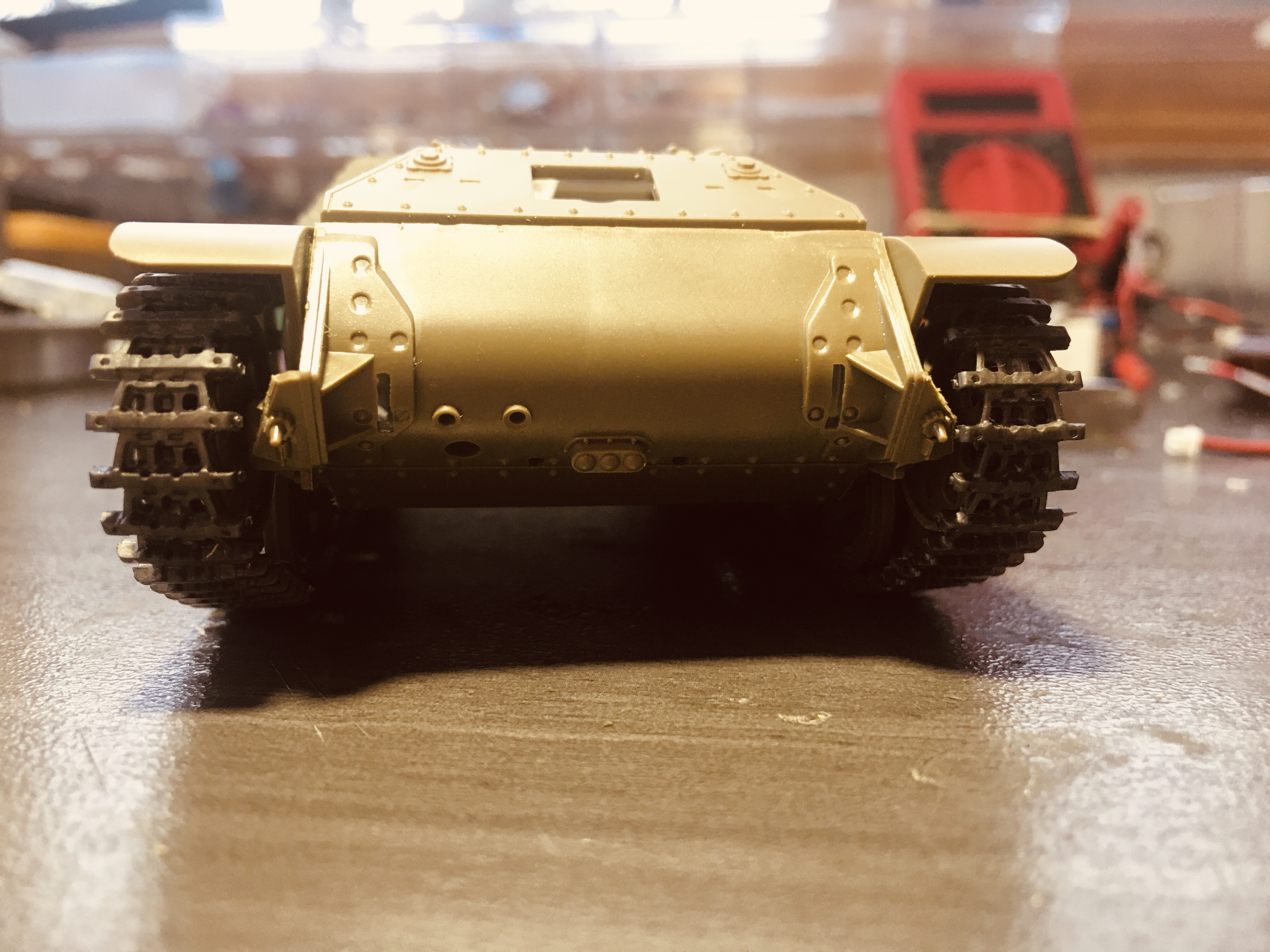

The area under these panels is very tight and I had to grind material off the gearboxes to allow proper alignment of the upper hull to lower hull panel.
this is better. The upper hull comes off so complicates the lower hul panel. Took some time and patience to get it right as you see it here.

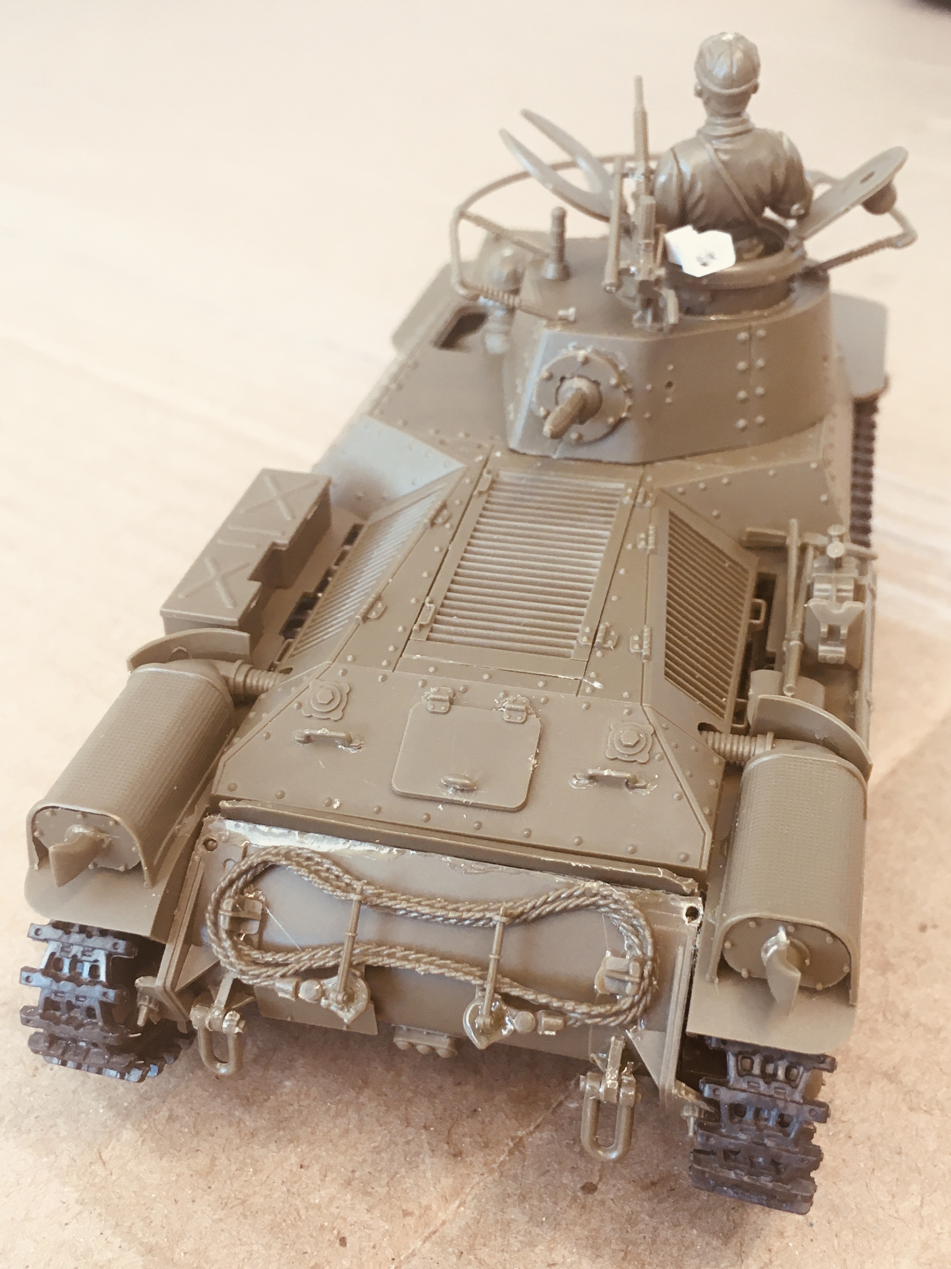

This rear panel is very difficult to get lined up. Took some time to get it right as the top hull is removable as in all hobby grade radio control Tanks.

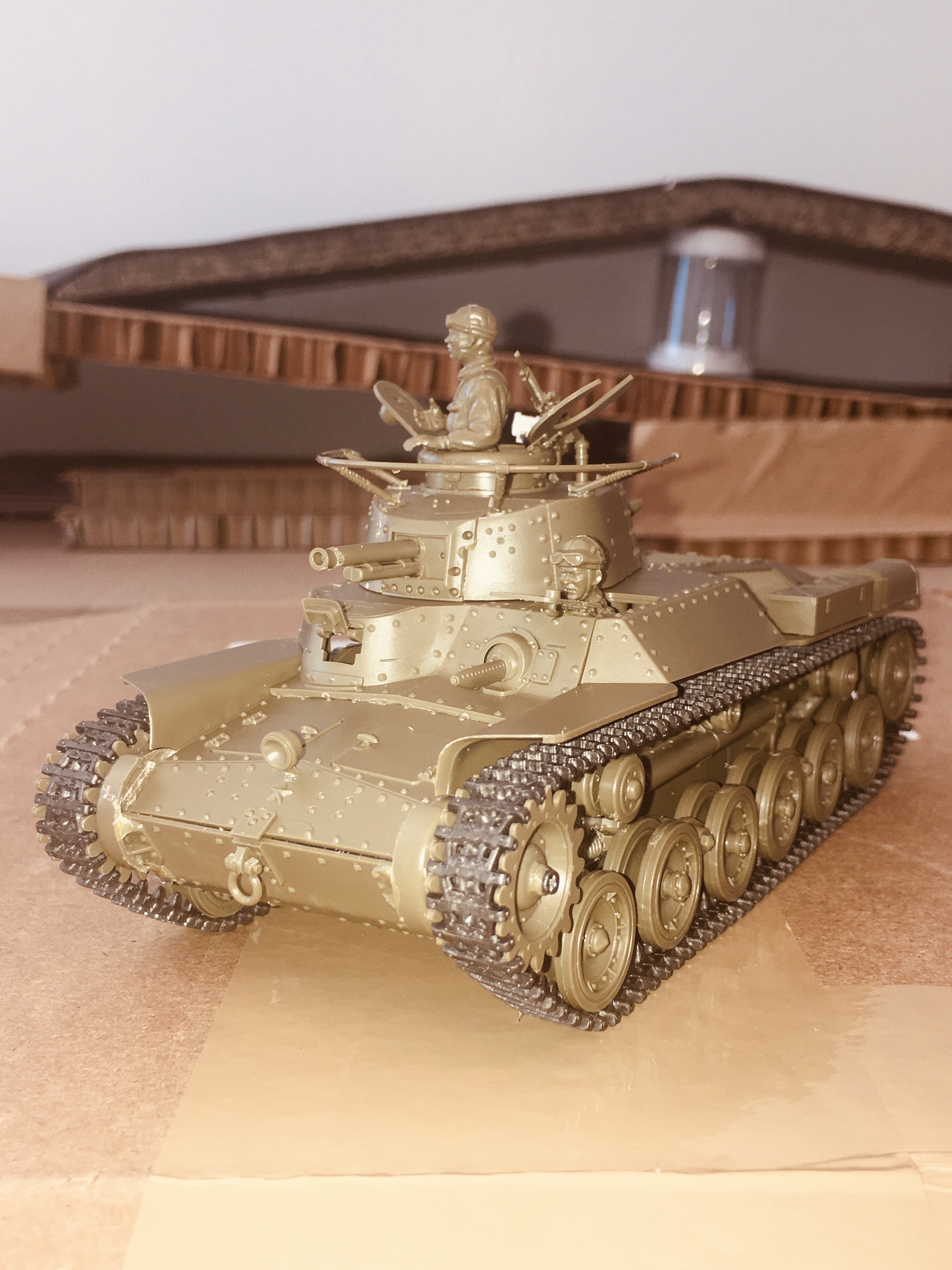

Assembled and RRC
Assembled and RRC
Assembled and RRC
Assembled and RRC
Assembled and RRC
Assembled and RRC

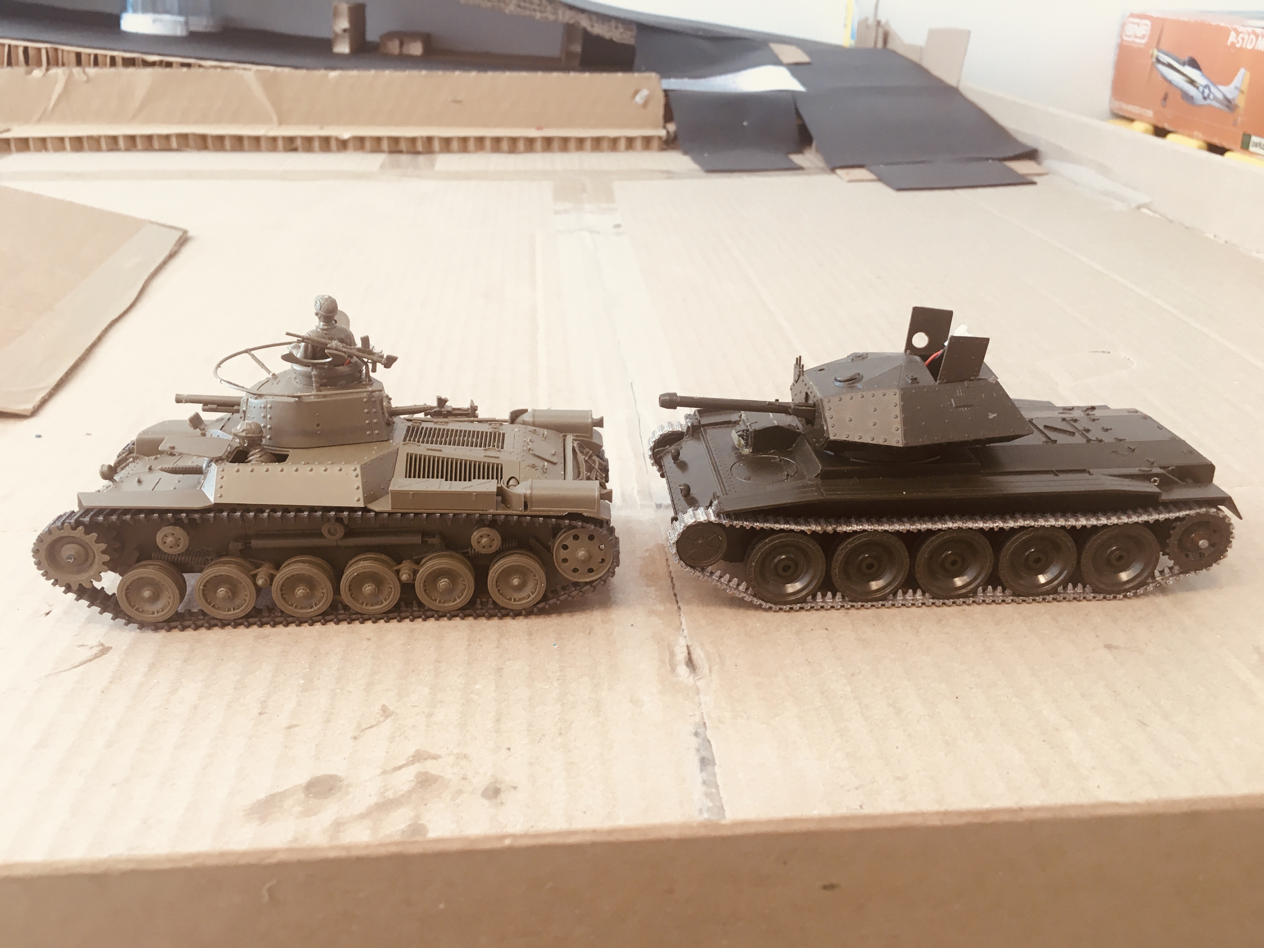

Type 97 vs Crusader Mk III
The Type 97 is close to final assembly and is fully functional RRC.

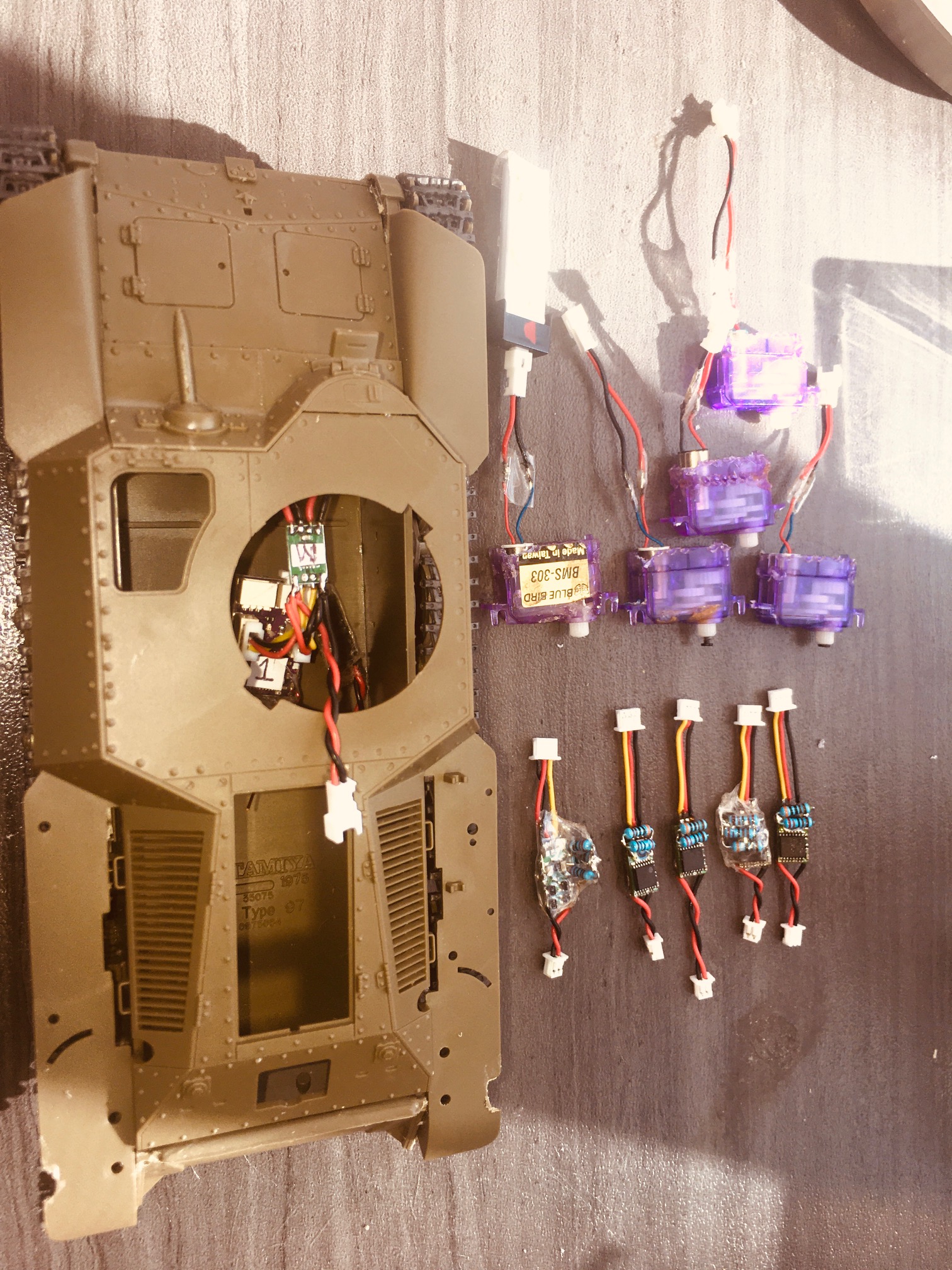

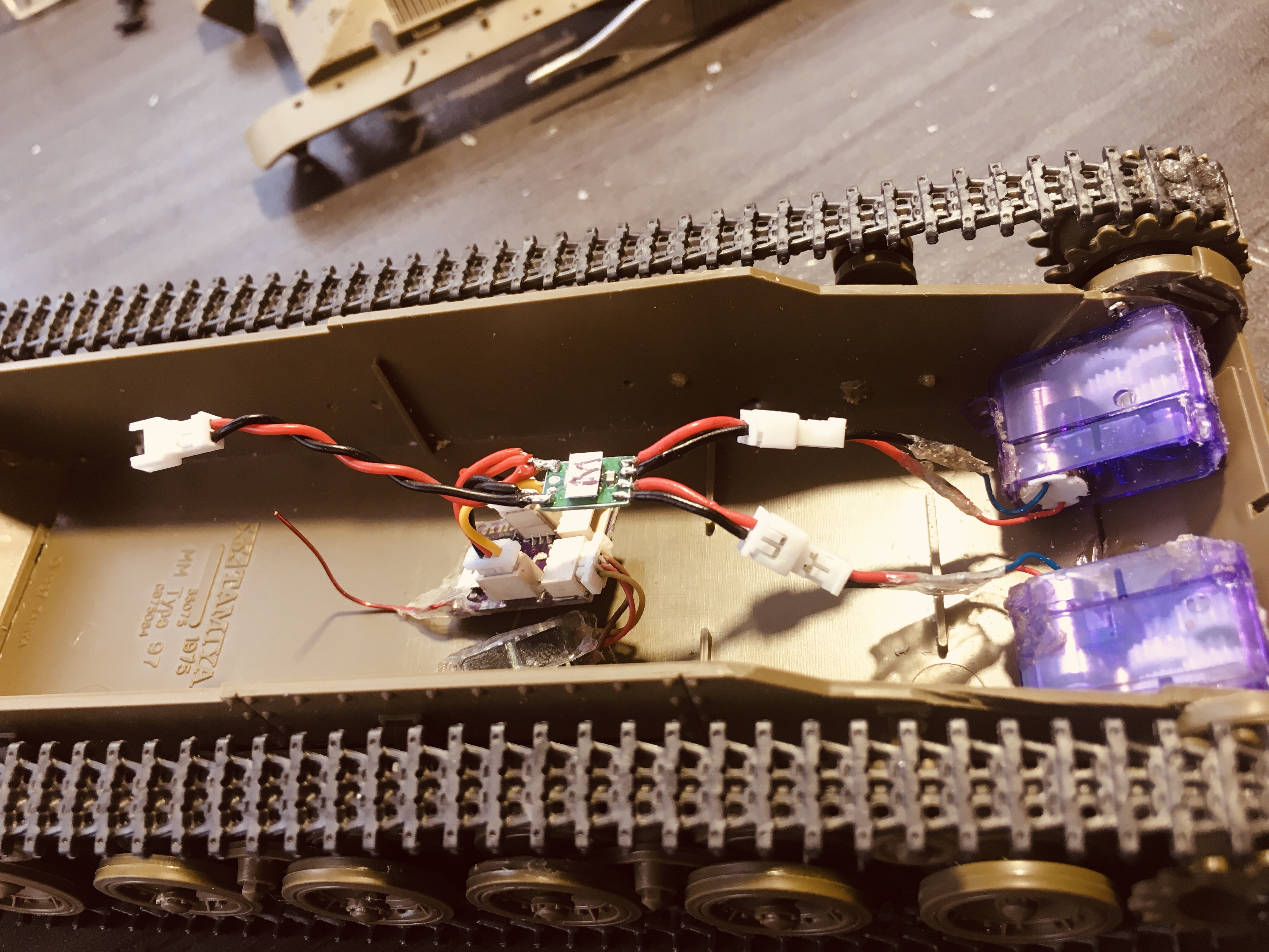

These were popular about 12 years ago. The sad thing is they have a design flaw that renders them useless as a servo after a very short life compared to other servos but I kept them for parts (12) thinking I could repurpose them or use them for parts. Well that time is now.
The T97 has drive sprockets that are offset to the ouside more than most so a long screw is required.
This servo case screw is used to interface the drive sprocket to the servo gearbox.
Salvaged 5 servos from the scrap pile. The electronics have been converted to ESC's and the gearboxes will be used to animate more projects.

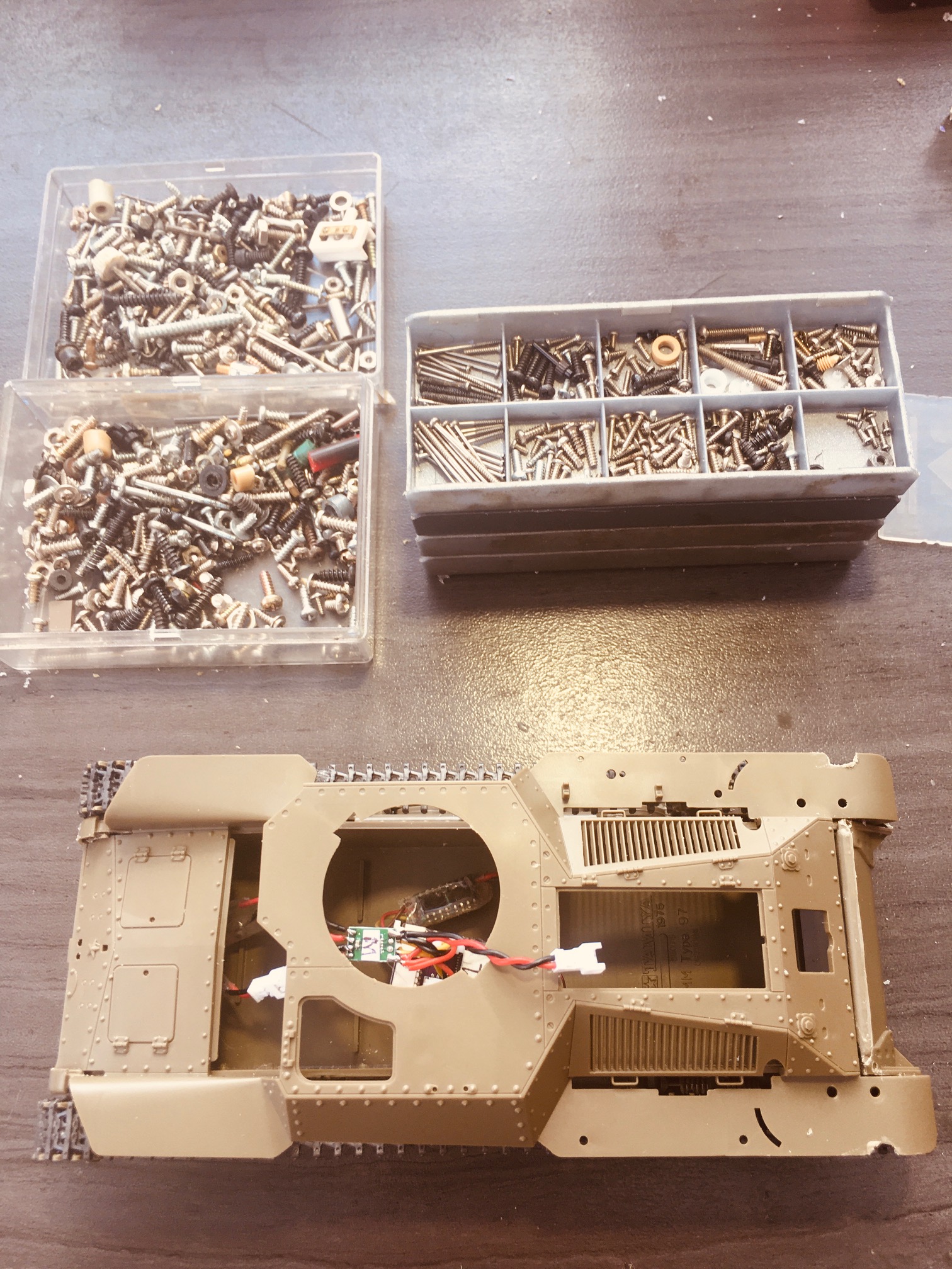

Some of the hardware I use in the 1/35 models. I used 6 micro screws in the T97.
