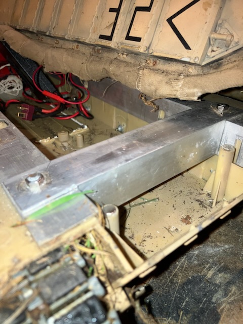

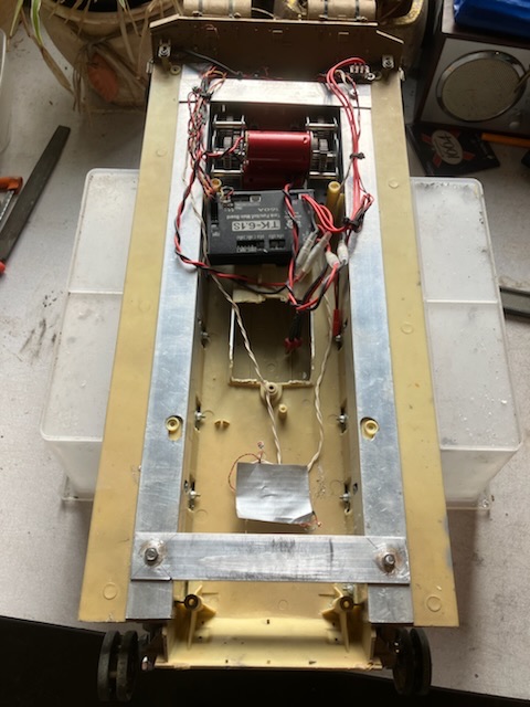

My simple aluminium frame installed in the Challenger last year. Simply made from 25 x 25mm angle.

The photo is from Wednesday 8 November 2023 4:58 pm in your Operation Telic thread (here for anyone who wants to check the build for advice: viewtopic.php?t=32250&hilit=Telic ). You say that the reinforcing frame is 25x25mm angle. From the photo the aluminum appears to be flat stock, but I wonder if I am just not seeing the angle on either side of the hull tub with flat cross pieces. I would think that combination would do much to stiffen the frame.

Herr Dr. Professor wrote: Tue Feb 13, 2024 12:20 am You say that the reinforcing frame is 25x25mm angle. From the photo the aluminum appears to be flat stock, but I wonder if I am just not seeing the angle on either side of the hull tub with flat cross pieces. I would think that combination would do much to stiffen the frame.
Hopefully this makes it more clearer. The rear one is the same, but reversed.

The side pieces are bonded on with my favourite adhesive JB weld. The cross braces are removable by taking out the bolts.

9) An internal frame, made from 25mm x 25mm x 1mm aluminium angle. This is bonded to the sides, with two removable cross braces.
