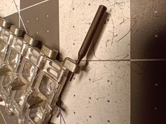

1)taking a small vice type thing and mounting the tracks in that . Hanging them over the end of a workbench left everything a bit loosey-goosey
2)Then I used one of the track pins that was SLIGHTLY too short to designate the unknurled end of the pin [1]and hit it (as hard as I dared not as hard as I could just dared) with a small picture hook pin , this started the knurled end out of the link.
3)Then I used a small drill (reverse mounted) in a pin vice to slowly knock from the unknurled end the knurled end totally loose.
4)Then I pulled the pin out with a pair of fine needle-nose pliers.
Voila the track was split.
This was the vice, pin vice etc that I used.
https://i.postimg.cc/Y9CjqhzS/Screenshot-1.png

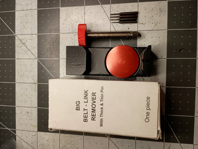

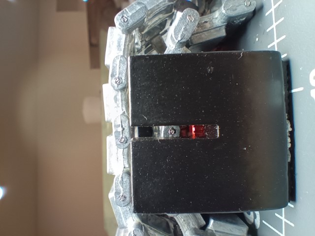

One has! I've tried tiny finish nails, tiny screw drivers and punches, and track pins. They work but it's fiddly and kind of a PITA, usually drop the tool or tracks 2 or three times trying to get everything lined up right. This thread got me thinking so I started looking around.
Most watch band tools I looked at didn't list any maximum width and those that did were all ~30mm wide, including the type that look like pliers, I would think those would be wider. I eventually found one listed on ebay as "Watch Link Remover Jumbo" it's description said "Will accommodate watch bands up to 1 3/4" (45 mm) wide".
Here it is on ebay https://www.ebay.com/itm/134076649516, the same seller also sells it on Amazon https://www.amazon.com/dp/B0BBXPYLNY
I ordered one from ebay, It got here today.
Big Belt Pin Remover 001.jpg (121.53 KiB) Viewed 1488 times

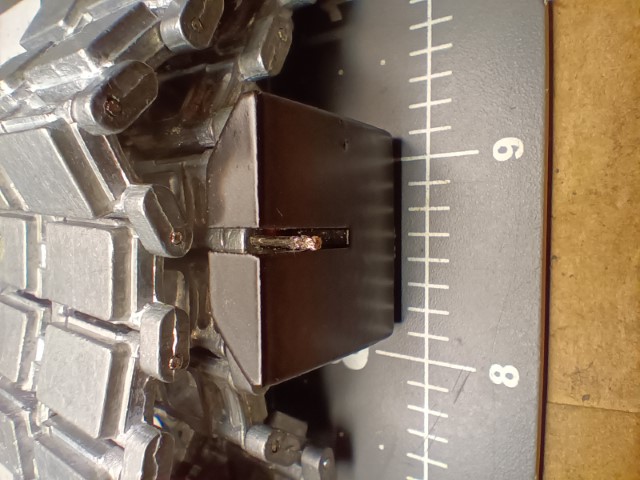

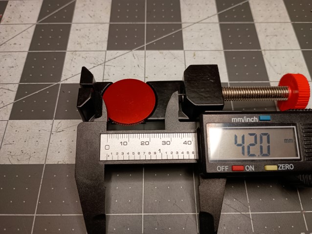

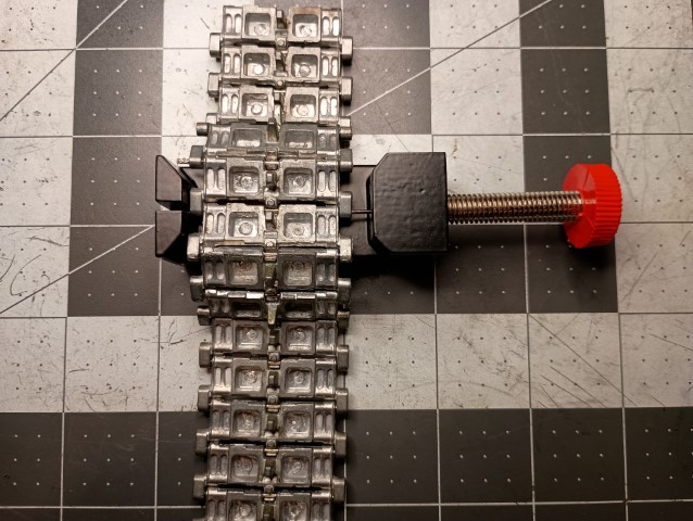

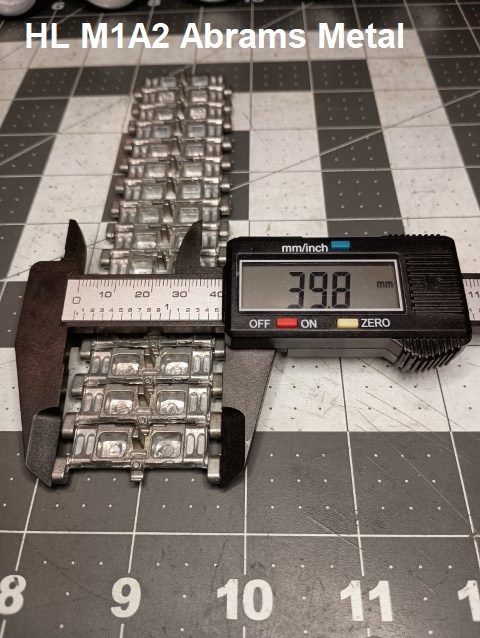

With the press screw barley threaded into the base the maximum width to the pin is 42mm. The widest tracks I have are HL M1A2 Abrams metal tracks they are 39.8mm wide. The plastic are 39.6. I also have plastic Chally II tracks they measure 38.5mm.
Big Belt Pin Remover 002.jpg (126.71 KiB) Viewed 1488 times
Big Belt Pin Remover 003.jpg (126.57 KiB) Viewed 1488 times

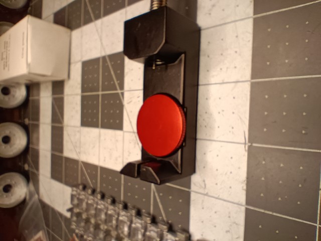

The tool comes with 4 pins 2 small and 2 large. The large fit the HL track pin hole perfectly.
Big Belt Pin Remover 004.jpg (148.35 KiB) Viewed 1488 times

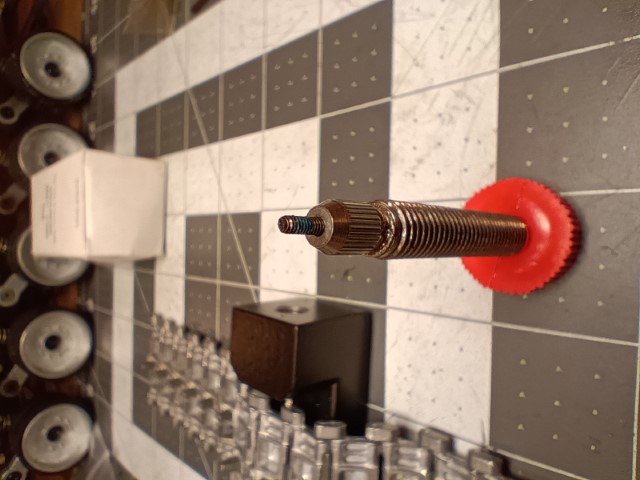

The base has a threaded turn table thingy to adjust height making it easier to align the pins. Really helps with metal tracks that haven't been split yet and are stacked. Almost like having a third hand.
Big Belt Pin Remover 005.jpg (104.61 KiB) Viewed 1488 times

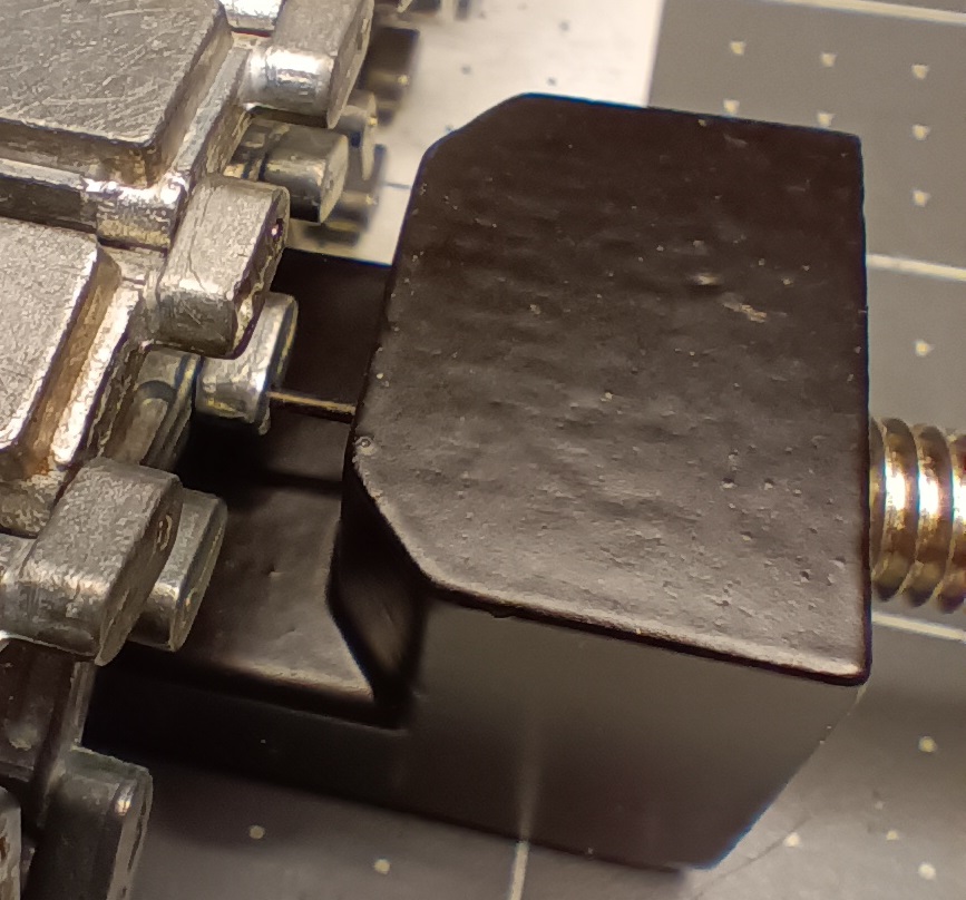

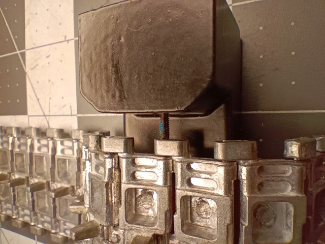

Let's give it a try shall we?

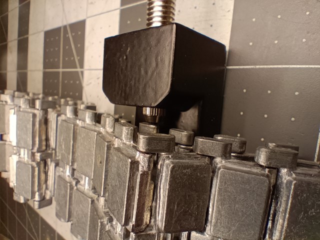

Took all of 20 seconds to line everything up once I'd adjusted the height using the handy dandy turntable thingy.
Big Belt Pin Remover 006.jpg (190.65 KiB) Viewed 1488 times
Big Belt Pin Remover 007.jpg (106.54 KiB) Viewed 1488 times
Big Belt Pin Remover 008.jpg (143.06 KiB) Viewed 1488 times
5 turns of the knob on the press screw later...
Big Belt Pin Remover 009.jpg (131.11 KiB) Viewed 1488 times
Big Belt Pin Remover 010.jpg (125.77 KiB) Viewed 1488 times
Just for grins, I grabbed a small screw out of the jar I throw small screws and hardware into that I save from old laptops and such before they get pitched. Used it to press the pin back in. Granted I can do this in 5 seconds with the tip of needle nose pliers. Just pointing out bonus added functionality.
Big Belt Pin Remover 011.jpg (110.83 KiB) Viewed 1488 times
Big Belt Pin Remover 012.jpg (133.67 KiB) Viewed 1488 times
Conclusion: This little tool makes splitting tracks a breeze. Absolutely no doubt about it! No fiddly bits, no bent pins easy peasy, it's well worth the ~$15.00 it cost with shipping.

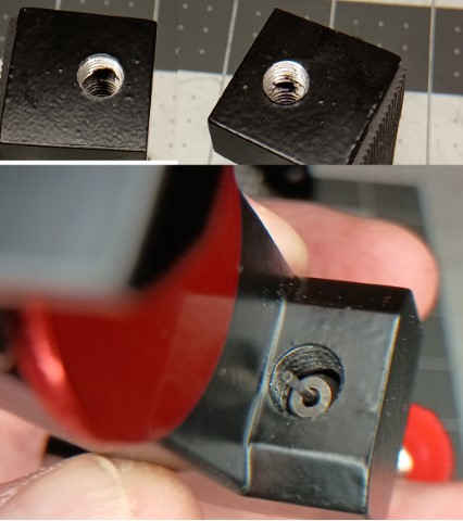

I do have one problem with it, at least the specific one I received. While using the tool there were quite allot aluminum flakes falling out of where the press screw threads into the base. After trying it out about and splitting different tracks about 10 times I decided to unscrew the press screw, clean the threads and lightly grease them. When I unscrewed the screw from the base I found that there was a void in the cast aluminum base where the press screw is threaded. When the press screw in threaded in enough so that the press pin meets the Abrams track pin the screw's threads only engage 4 or 5 threads in the base thanks to the large gap left by the void in the casting, without the number of threads would be double. Even with just 4 or 5 threads the little tool had no problem pushing track pins out at all, turning the knob was almost as if it were pushing nothing. The tool would probably be just fine and useful for a very long time. At the same time, even for $15 item I prefer it not have one with a defect, one that could eventually cause the screw to strip the threads in the aluminum housing.
