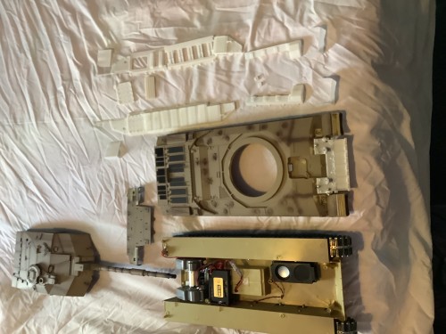

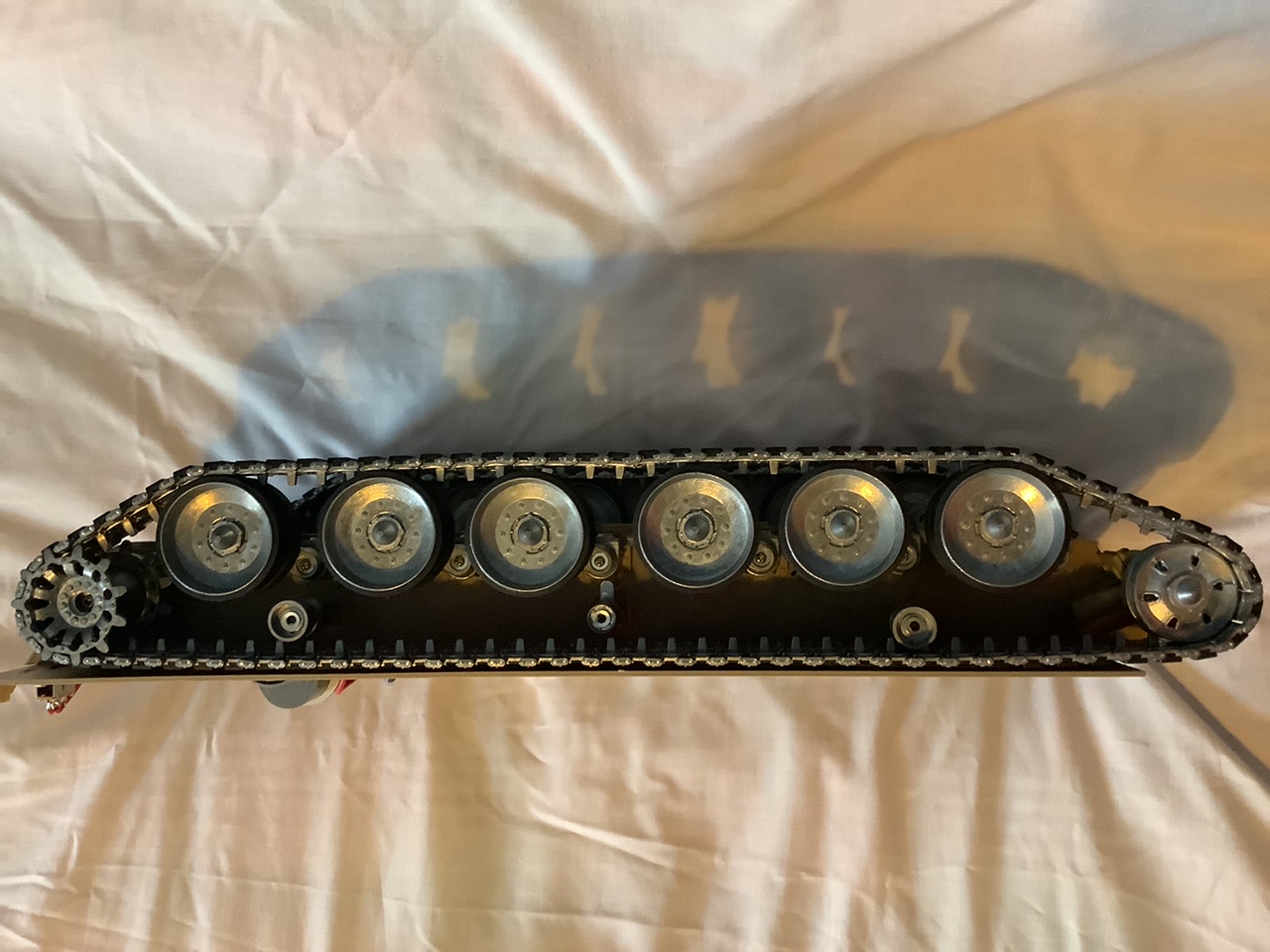

Anyway a couple of weeks ago a box came from DKLMRC, containing tracks, drive sprockets, idlers and the Chobham Armour. The tank was dismantled and the new tracks, idlers, and sprockets fitted.
First problem, the DKLM drive sprockets are too narrow, so used the original sprockets, which resulted in a very smooth drive.

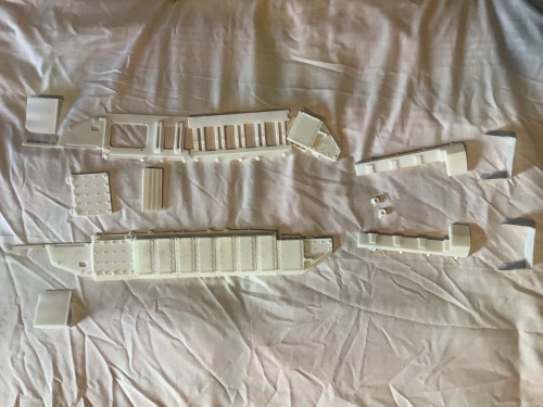

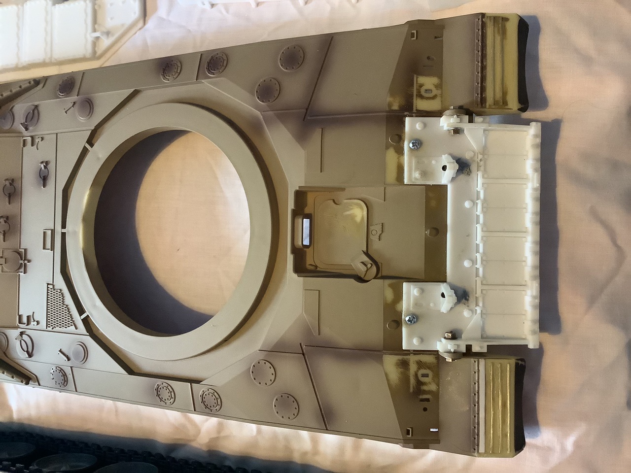

Next I assembled on side of the add on armour, just for fun and to see what it looked like.
A start has been made on the nose armour pack, which was glued into place and a pair of screws and nuts were used to represent the large nuts and bolts that hold the armour to the recovery points. Two self tappers were used to get a good glue bond. The nose armour required the detail removing from the front and a small amount of filling to fit.These will be filled later.

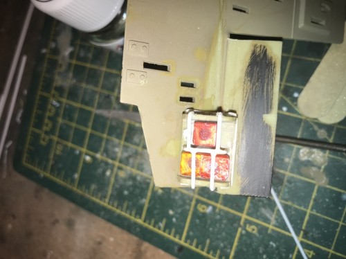

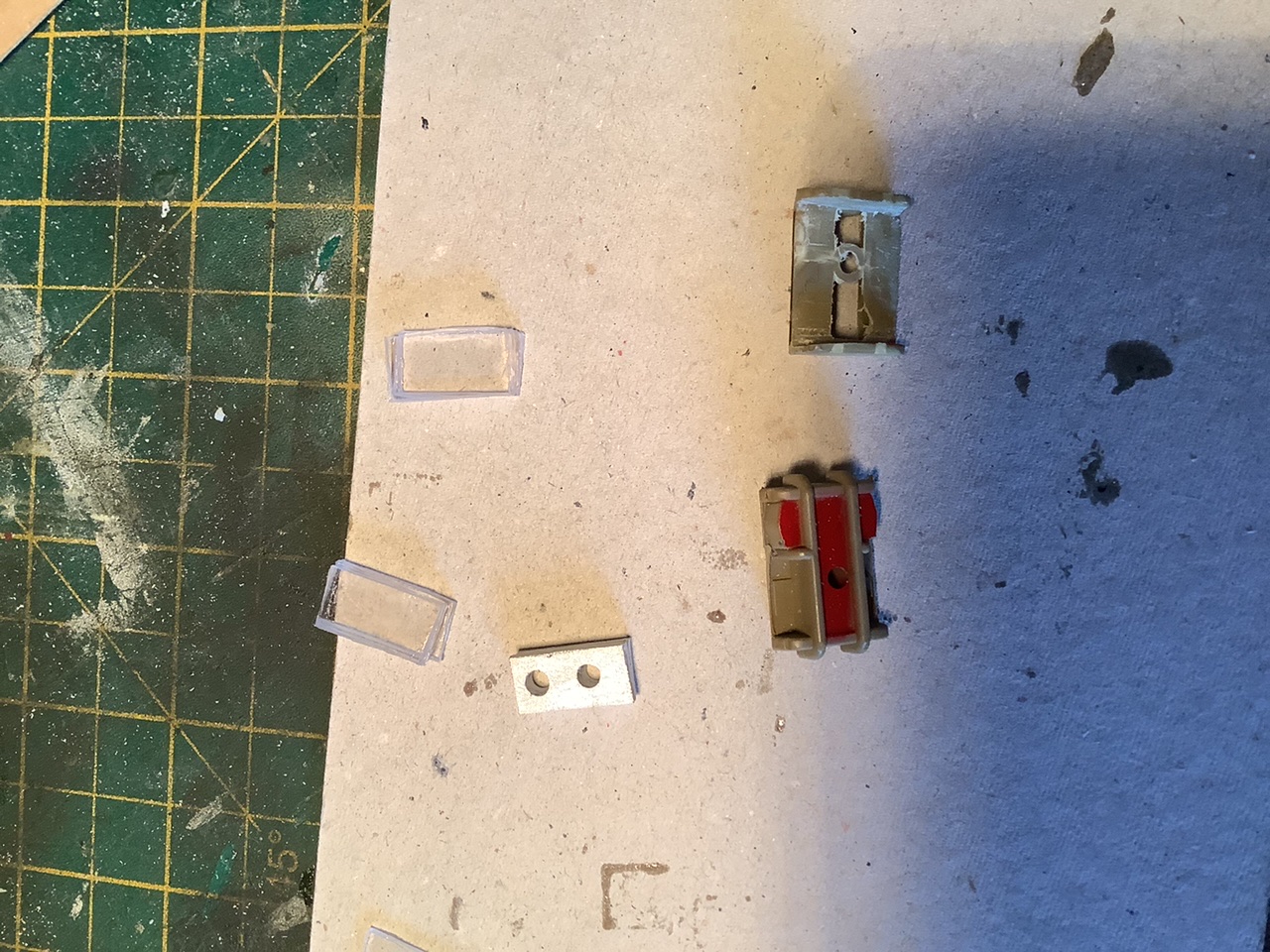

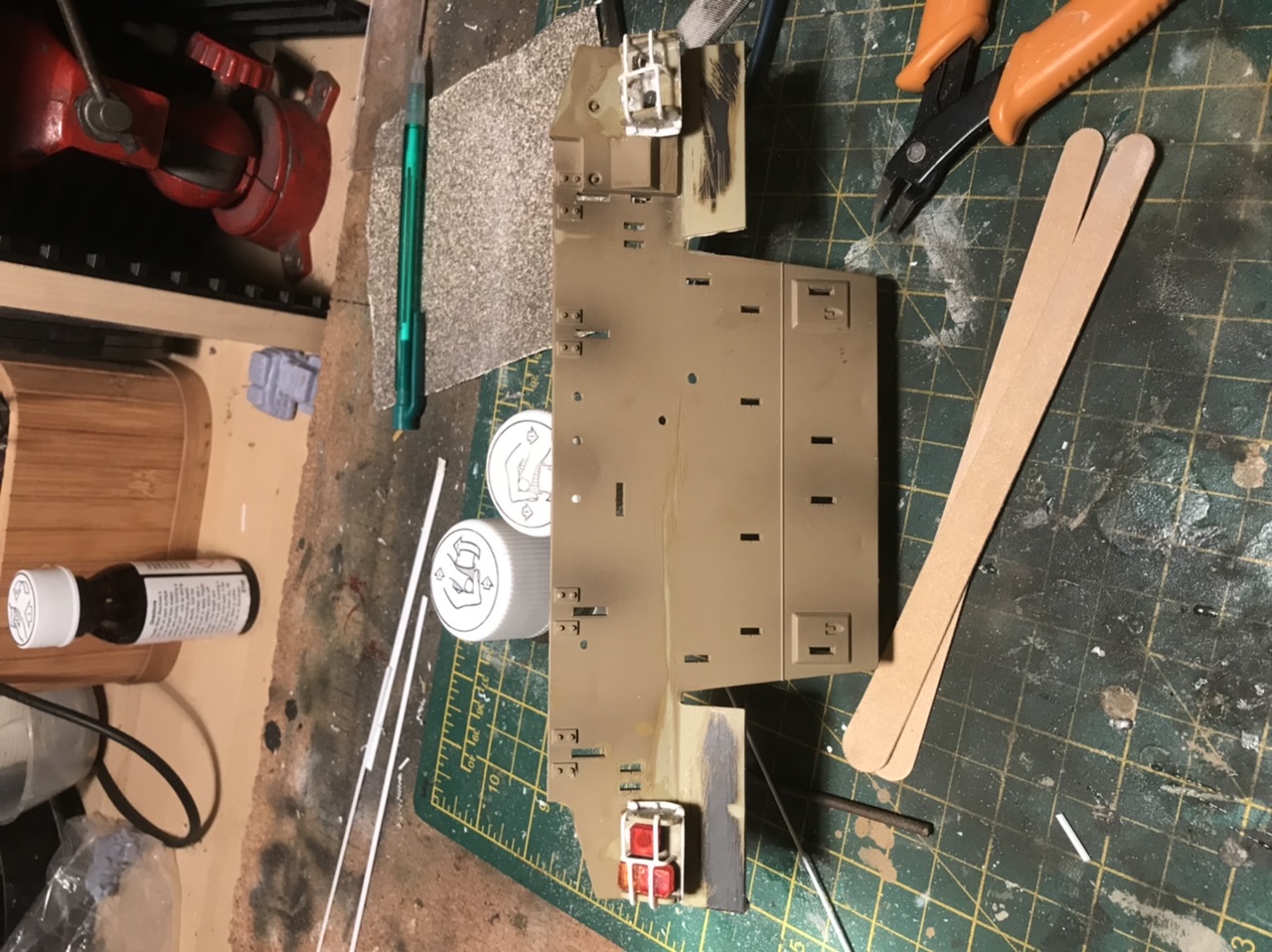

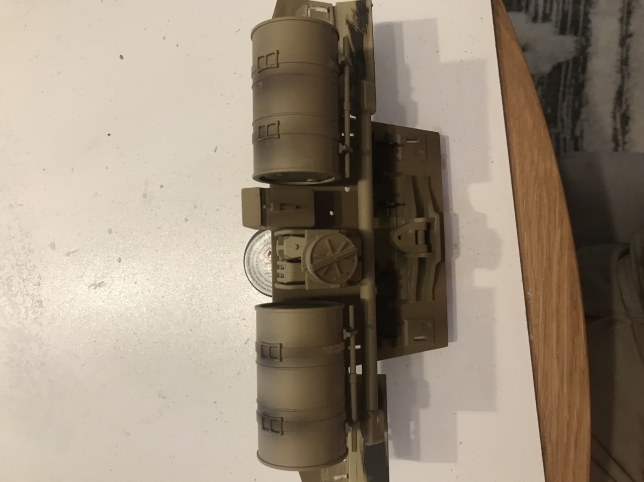

Today I have been held up on the re-wiring of the house renovation we are doing, in Argyll. And being the West Coast of Scotland it is slightly damp, so cannot work outside. So a little work has been done on the rear. The rear has been loosely assembled to see what can be improved. Looks like all of it!
Back lights and lenses. Drilled out for 3mm LED’s. When looking at photos of the real lights there is an awful lot of detail to make, especially the mounting brackets
Looks like every bit will need something doing to it. By breaking things down to more manageable sections the whole thing becomes less daunting. Unlike the Abrams where I flitted from one job to another. The light will be finished to the point where they can be painted and attached, the lens will then be fitted.

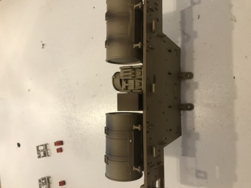

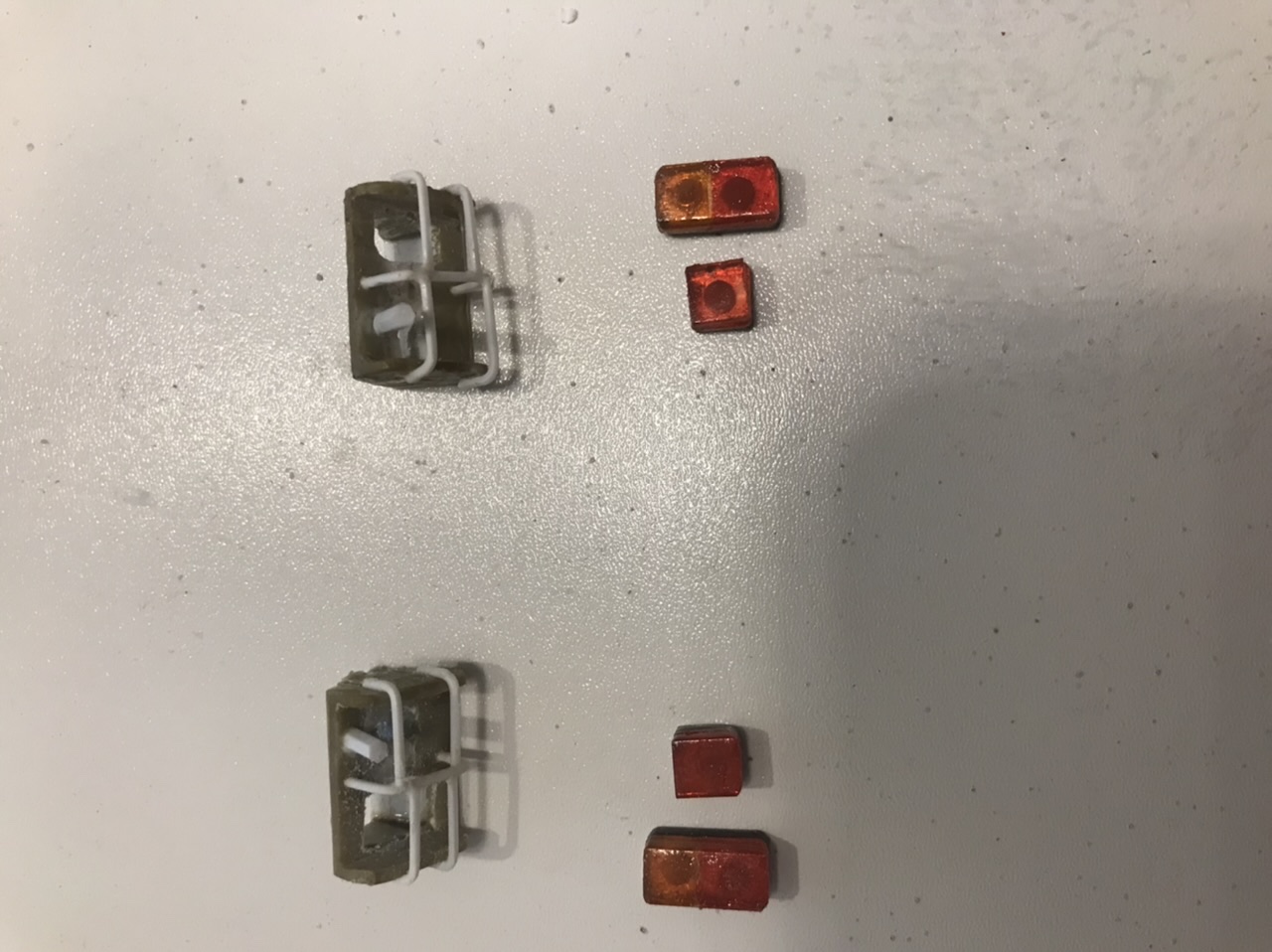

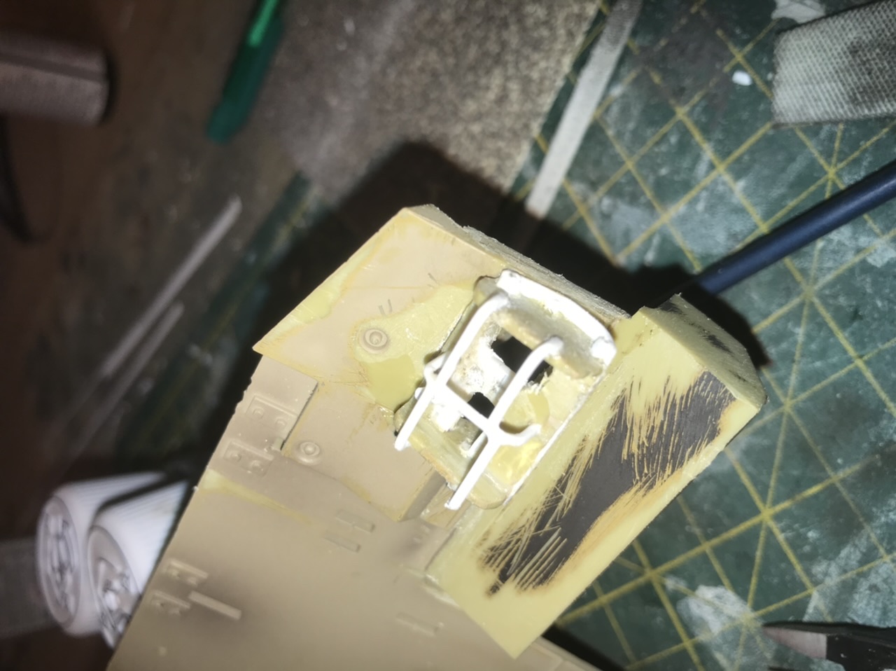

Small victory. For me anyway. Back lights attached. The lens are not fixed in place yet, as they are just dry fitted. When you look at these lights, you realise how much detail there is, like the rubber mounts and the guard bars/cage. Slowly and working on one part and at a time. Next work will be on the tow hooks.
By working on one part at a time, things definitely become manageable, and this seems to be raising my skills.

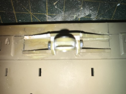

Post by Meter rat »

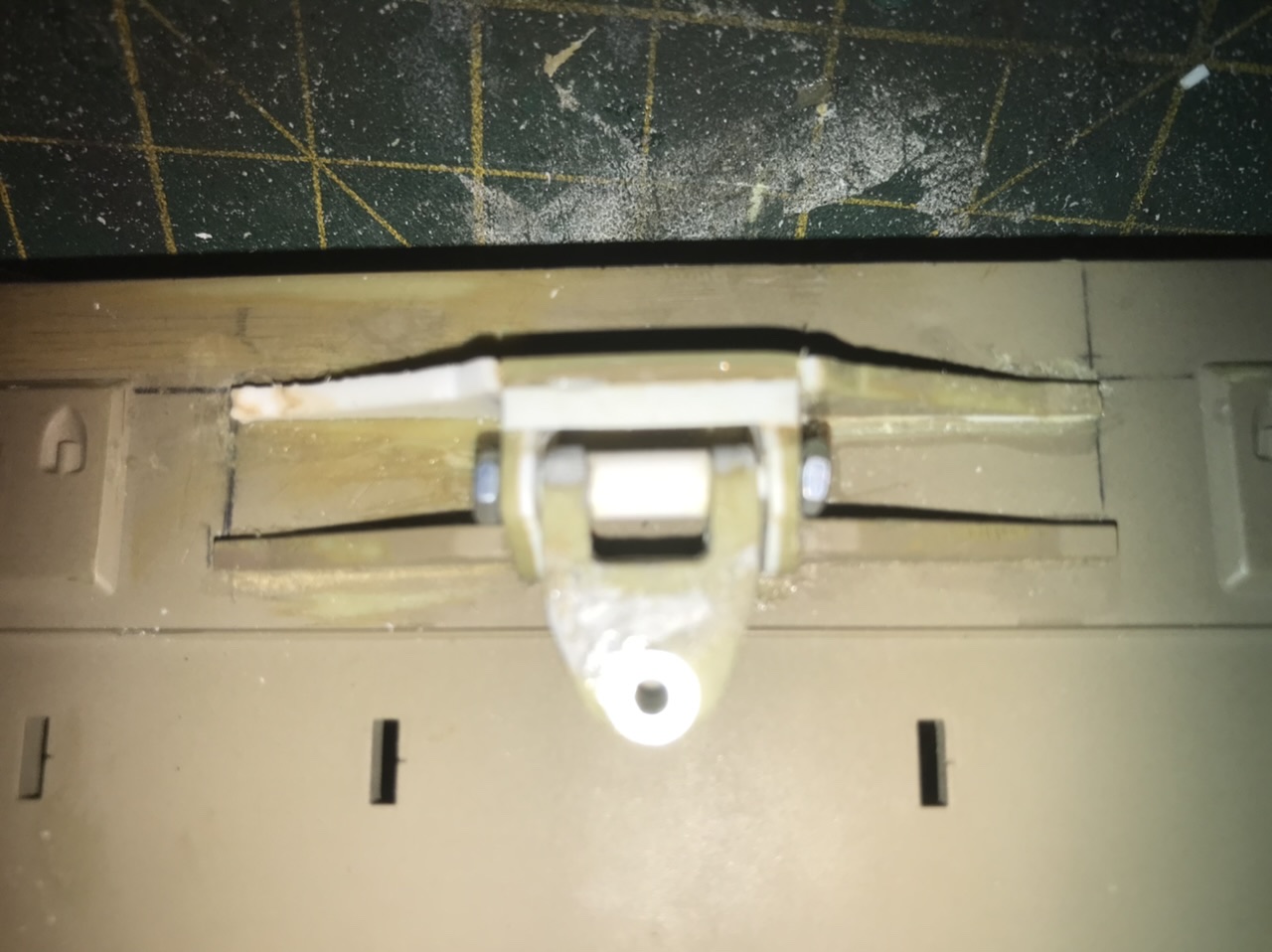

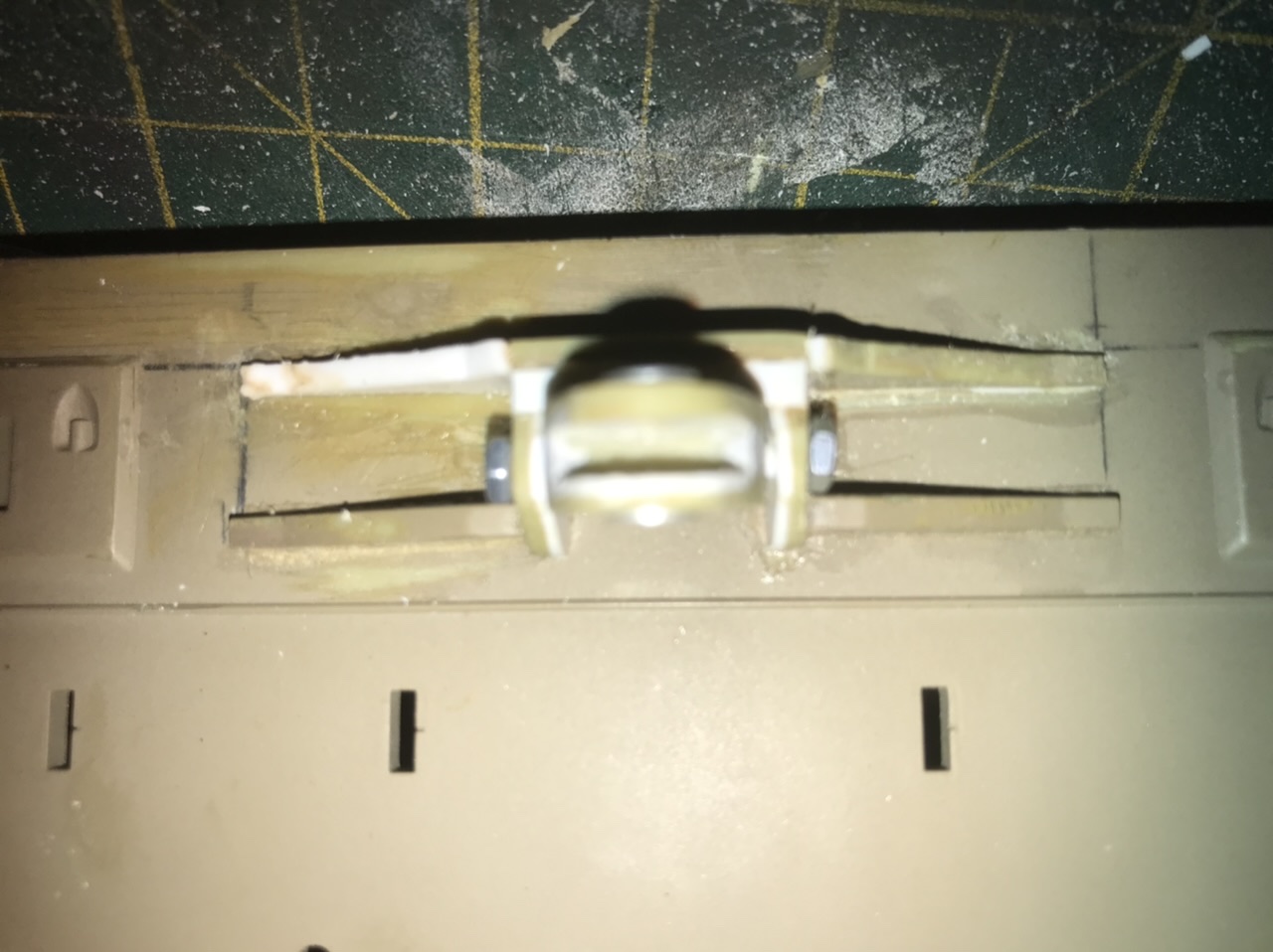

Small update. Over the last couple of evenings work has been on the towing pinitle. The first thing to note is that the movable part is a lot closer to the rear bulkhead than the model. With a bit of reworking, I was able to to build a working pinitle, that looked, imho, a lot better..
Next will work on the rear draw bar.
Does any one have any clear pictures of this, and how it works? I have one not very clear picture.
