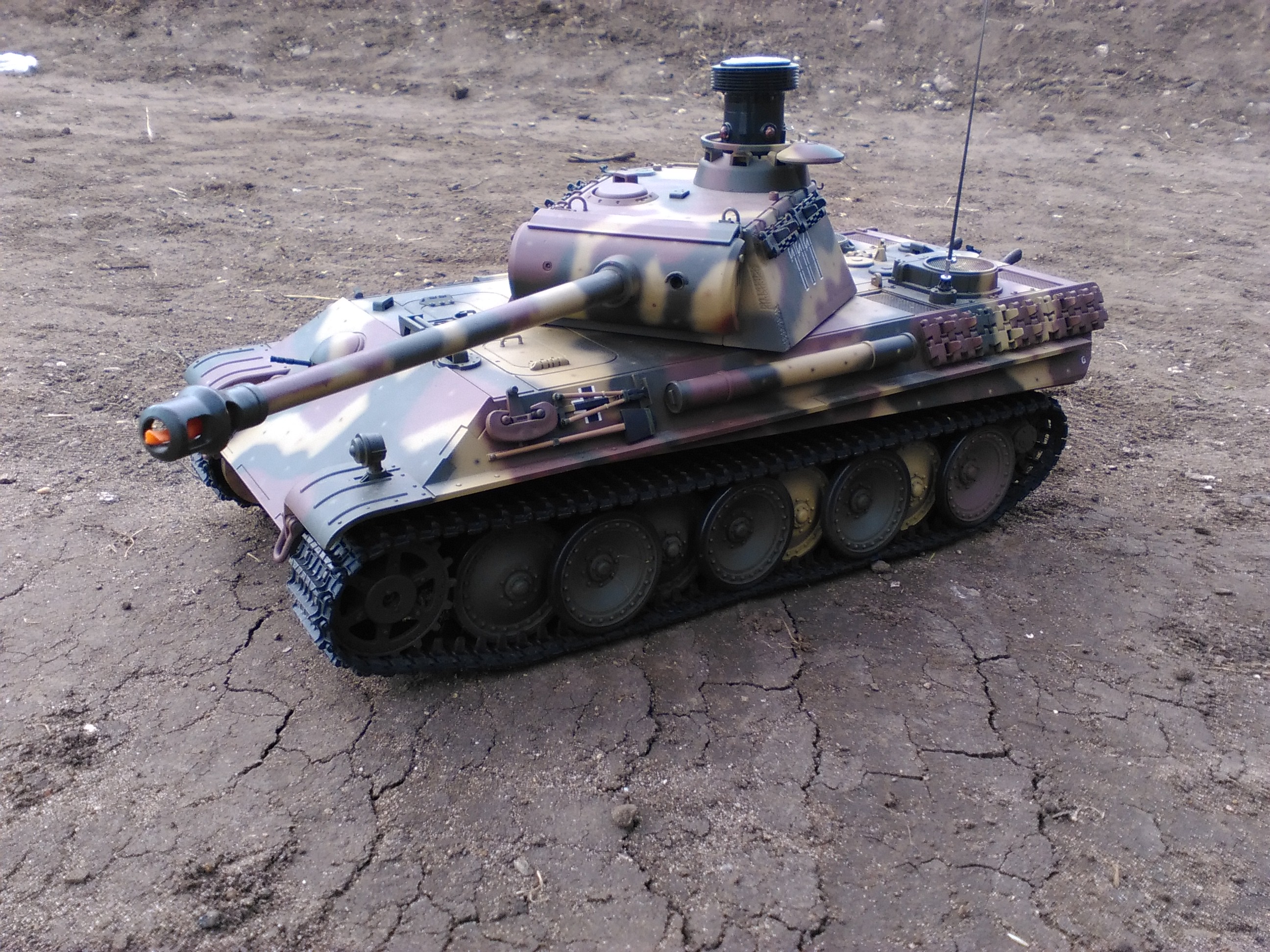

I would like to give this a shot on my HL panther g?
What method is easier? There are so many.
Any help or website would be appreciated.
