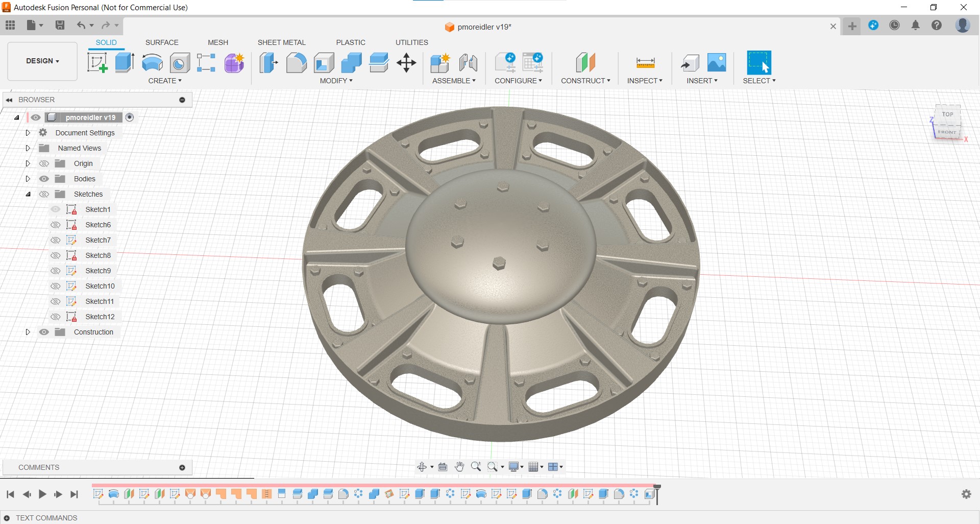

The PZW3 early rear idler is starting to take shape. The measurements aren't exact as I'm just getting the workflow sorted out at this stage.
Finding decent detail pic's of an early idler isn't as easy as I thought. So I just wondered how you think the dished section of the wheel should be modelled. The part with the oval cut outs. I have the angle ticking upwards a bit and now I'm wondering if that section should be flat to the XY plane. It would make sense if it was flat to the plane making the reinforcing fillets and the wheel easier to produce during WW2.

Hvae you looked here? https://tanks-encyclopedia.com/ww2/nazi ... iii_ausf_e
also about 3 mins in here:

Wow good resources Tiger6, the encyclopedia is great. I looked at the Saumur site but I must have missed the video. It's good to see the idler on the video too.

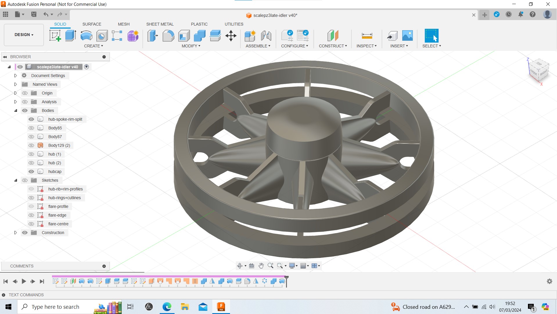

I've made some progress with the Late PZ3 idler. It seems as there are some variations with these. Maybe different foundries having slightly different moulds.
Still making slight changes with this. I have to settle on what looks right, what will SLS print well and what will actually work !!
