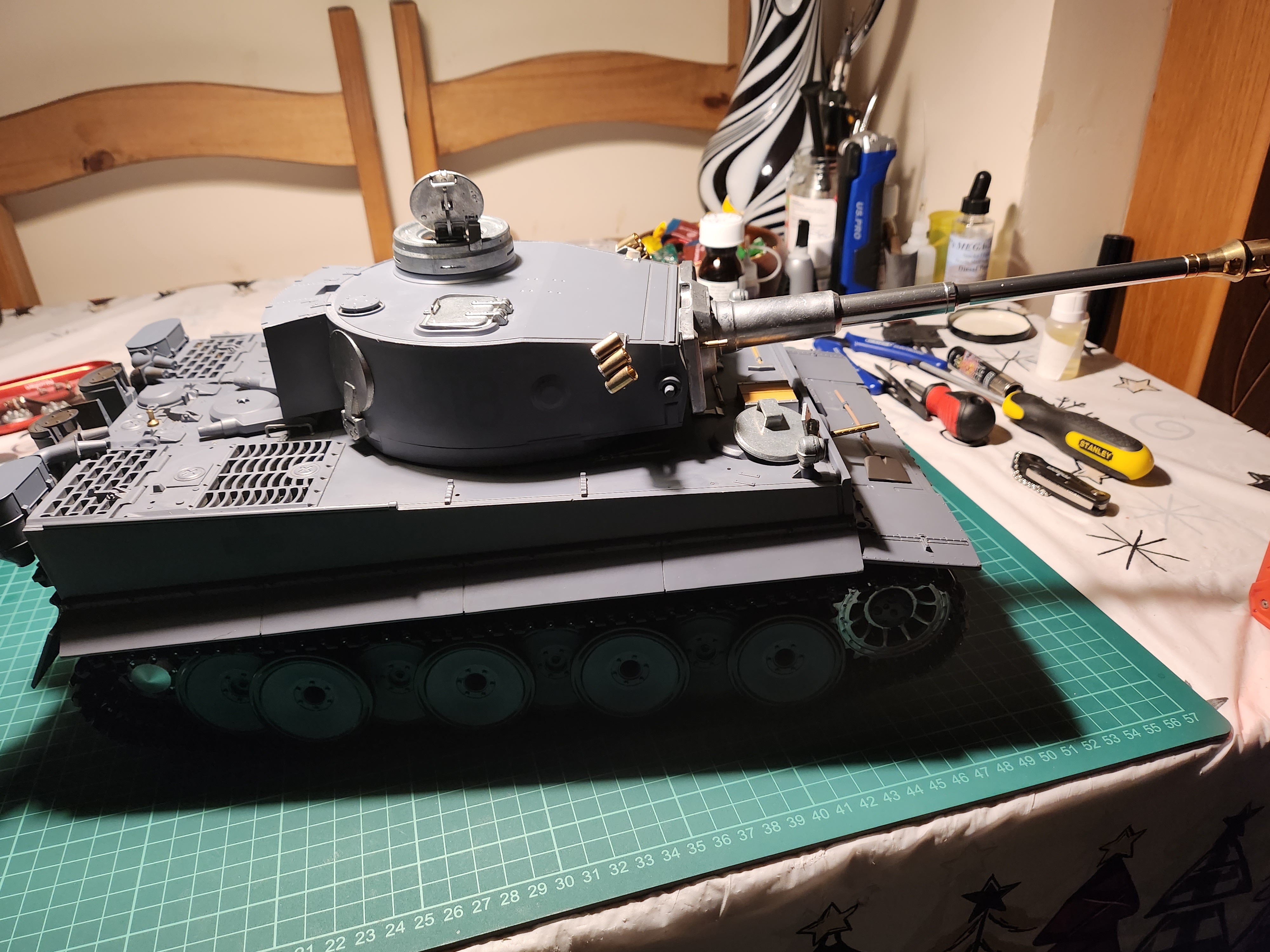

Just a quick update on the Tiger,not been too good(arthritis playing up AGAIN :( ) Apart from that the Tiger is moving on.Iv'e decided to go for a winter camo finish.The upgrades are coming along niceiy,gone for a monster hard case 4500 mah 7.4v lipo,just fits into the battery box although the cables now exit into the main tub ive rigged a balance charging lead and hidden it in one of the the air boxes at the rear.suspension springs have been uprated as she's begining to put some weight on lol.Big shout out to Dave and Julie at Forgebear(exellent supply of parts at great prices and a service that's second to none) Ive replaced the gearboxes with thier steel version,they maybe slightly noisier but i think the sound from the straight cut gears adds to the appeal and realism.

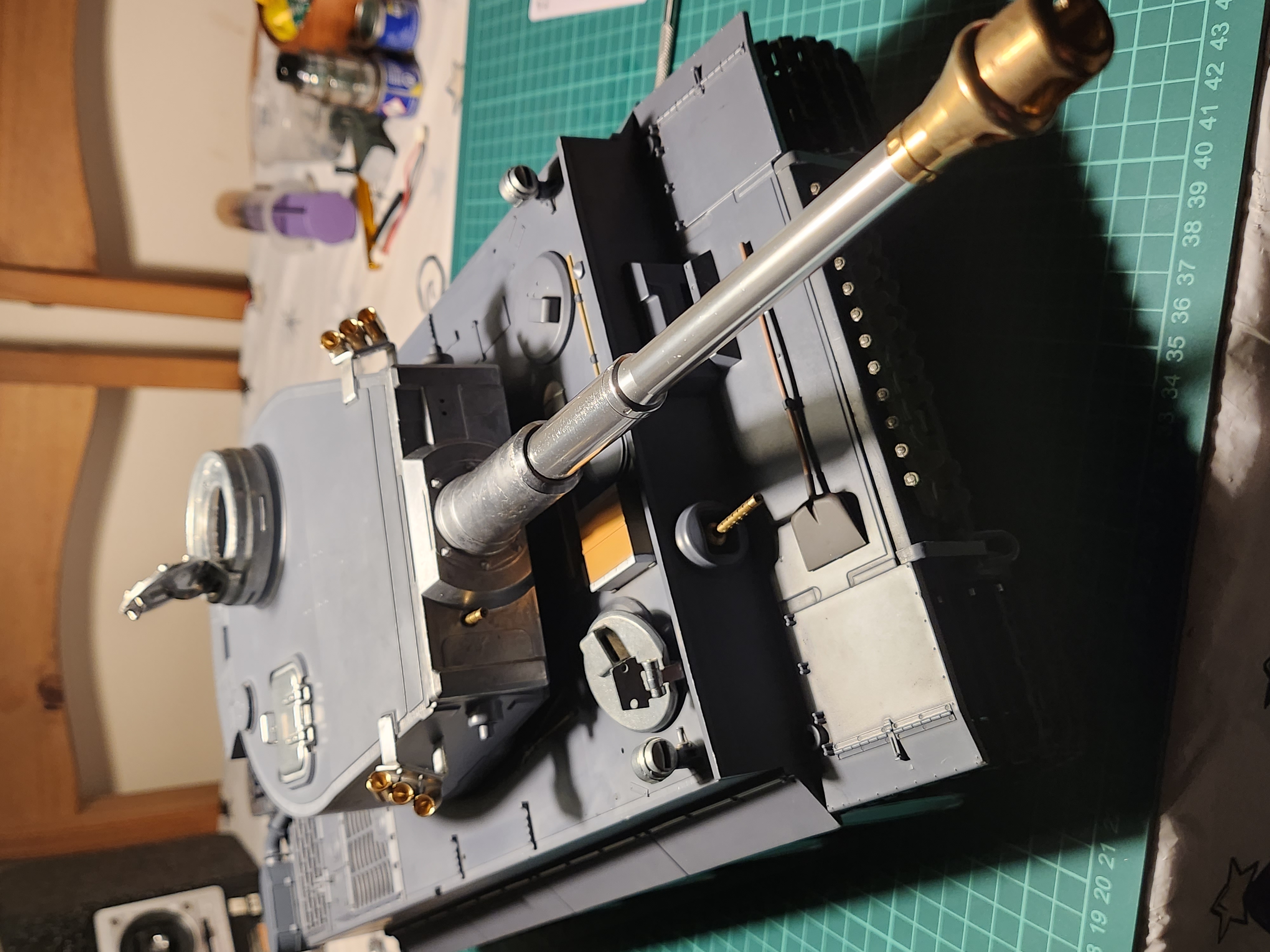

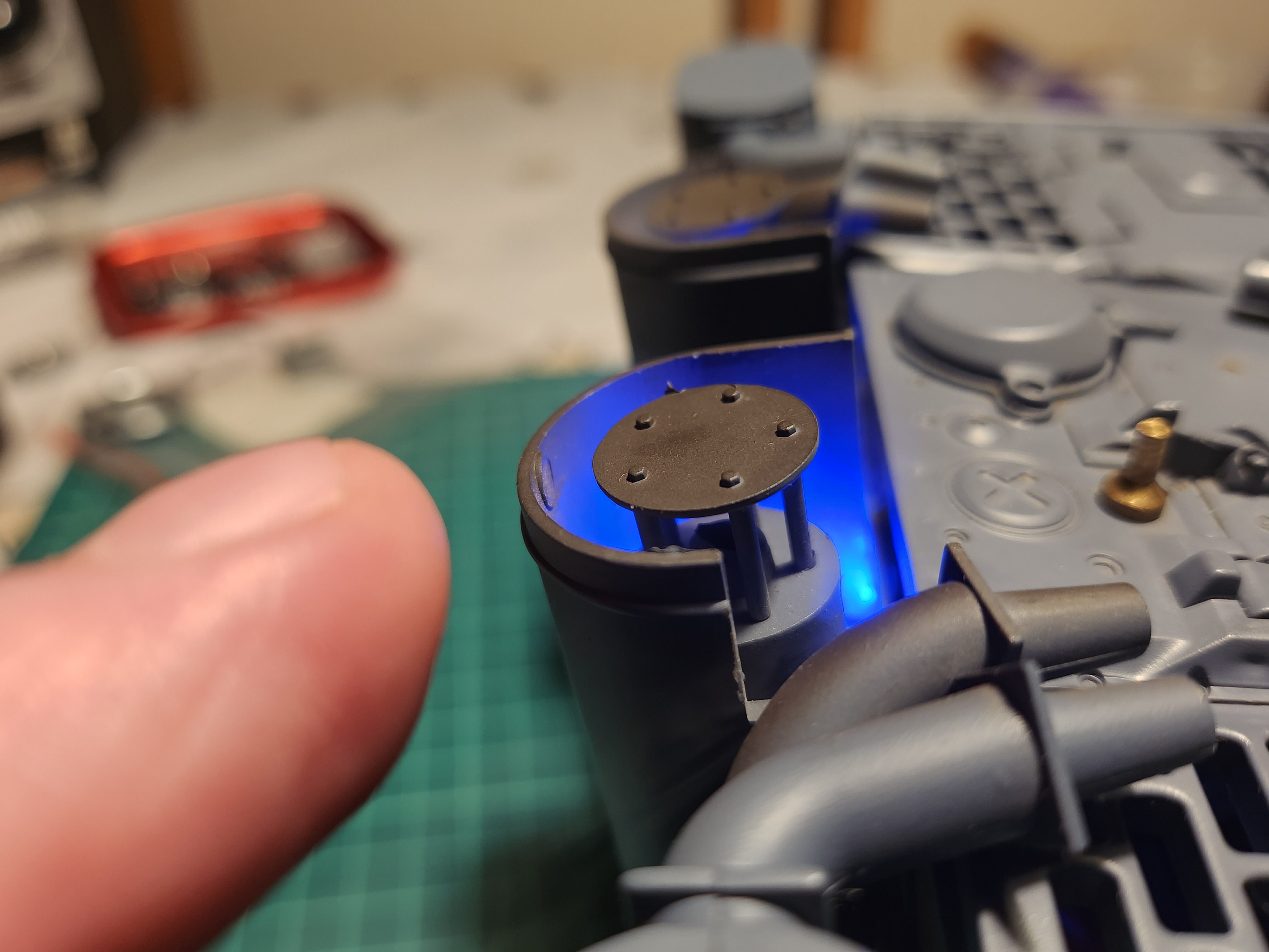

Mantlet and barrel have also been replaced with thier much more accurate metal version,puts the mg on the correct side of the barrel and the barrel length is a lot more to scale.hatches,cupola and smoke generators are now in metal(much more detail)the cupola now opens in the right direction,mg opening on the turret side also now in the right orentation and gone are the horrible moulded plastic periscope hatches,the opening metal versions are a much better look. As for the exhaust smoke,iv'e replaced the dead oem smoke unit with a pump style replacement unit (FB),closed off the back and bases of the stacks and fed the smoke tubes into the stacks to make the exhaust smoke exit as on the real Tiger.to try and get some realistic blue smoke iv'e added acouple of blue Led's behind the shields,bit bright at min though lol,hopefully once the paine works done it'll dull them down a bit,if not might have to add acouple of bigger resistors to bring the output down.
I guess that's the longer version of a quick update,get a bit carried away sometimes,not that it shows lol. A bit more fettling,some fake wiring to the smoke generators,some battle damage to add and i guess it's time to brake out the airbrush and see what happens.
