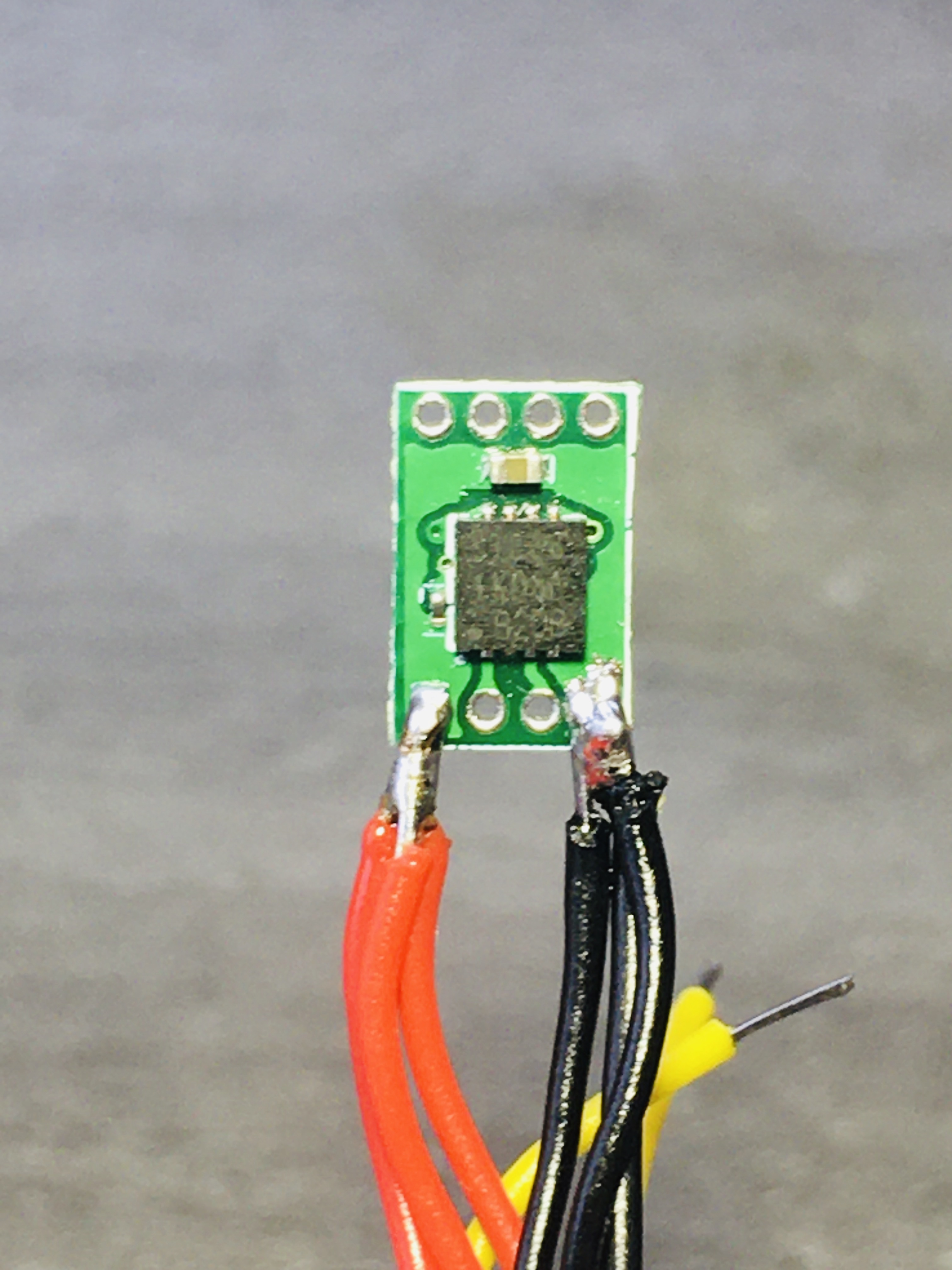

1s - supply voltage BLACK wires separately tinned then soldered together in parallel. The parallel BLACK wires are then soldered to the tinned pad on the right.
The yellow PPM signal wires are soldered on the back side of the ESC after the center pads are tinned.

The pads are "tinned" first as are the wires. Also the tinned wire ends are trimmed to lay across the pads then are soldered to the tinned pads.
this one looks good.
It took 1.5 hours to build these up. Next phase is testing. Then clear tape heat shrink wrap for electrical isolation and keeping dirt from such from very small circuit boards
