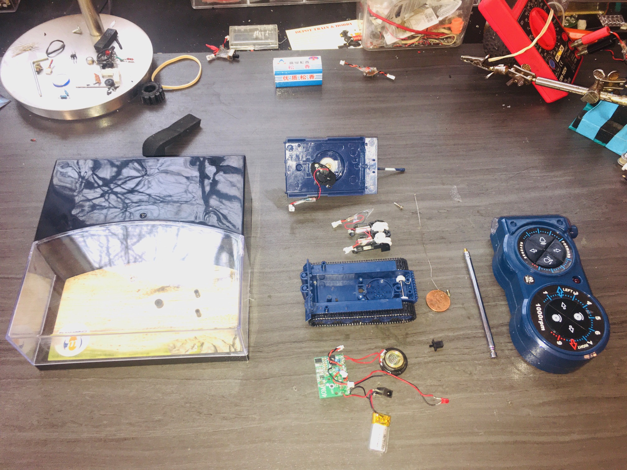

Remove one small screw at the bottom and you're in.<br />I added 1.25 mm micro JST connectors so that the motors can be changed and the circuit board can be removed and used in something else. I do this on all my models making everything interchangeable

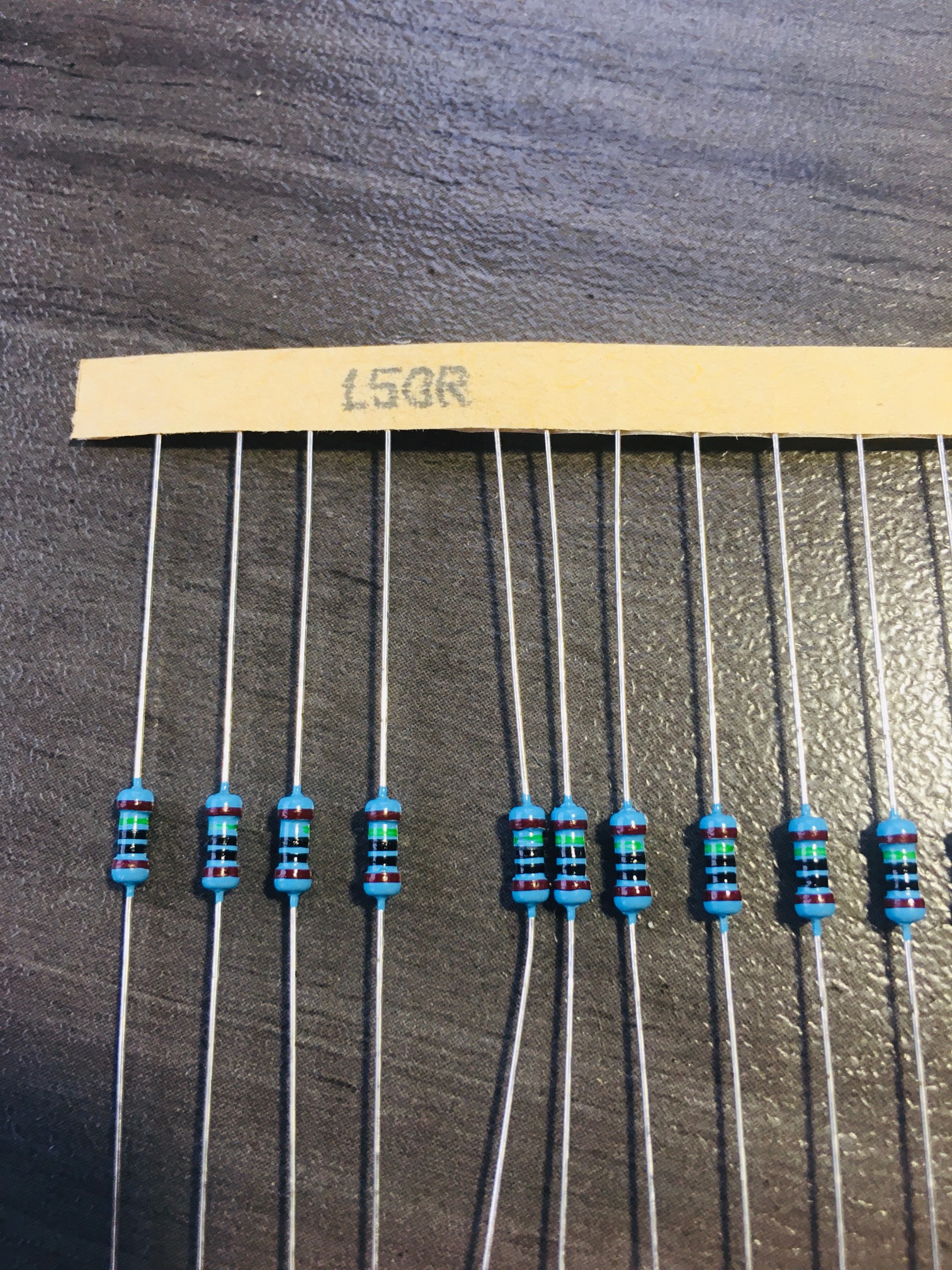

Added 4.7 ohm resistors here to slow the Tank down just a bit.
These are very small 1/8 watt Resistors

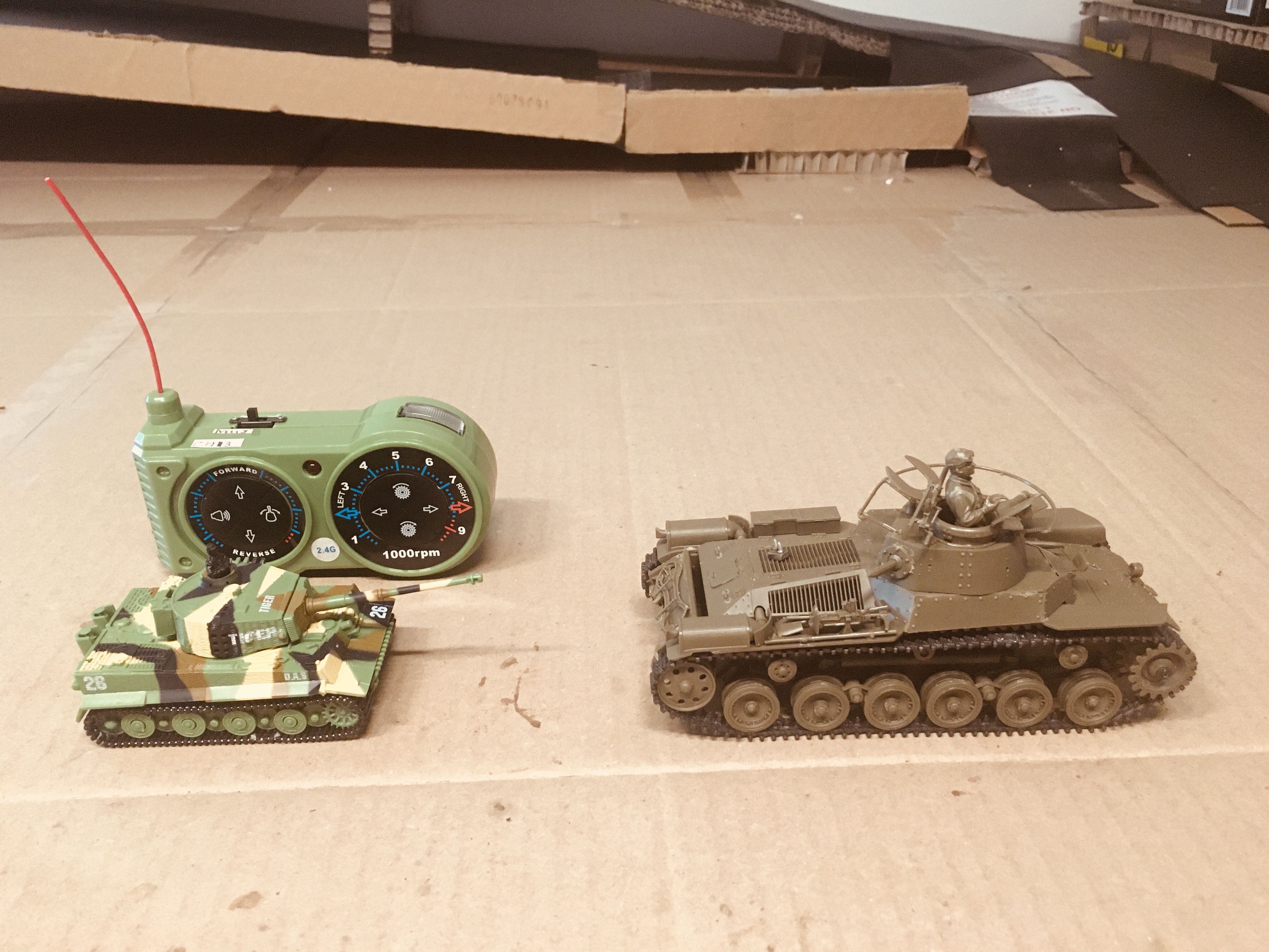

1/72 scale RRC Tiger Tank in the middle. 1/35 RRC IR Tiger on the right. 1/77 Leopard RRC on the left.

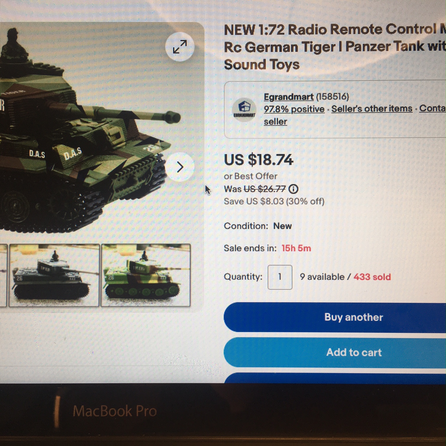

ebay link here.
from this seller
Egrandmart (158549)
https://www.ebay.com/itm/284132822784

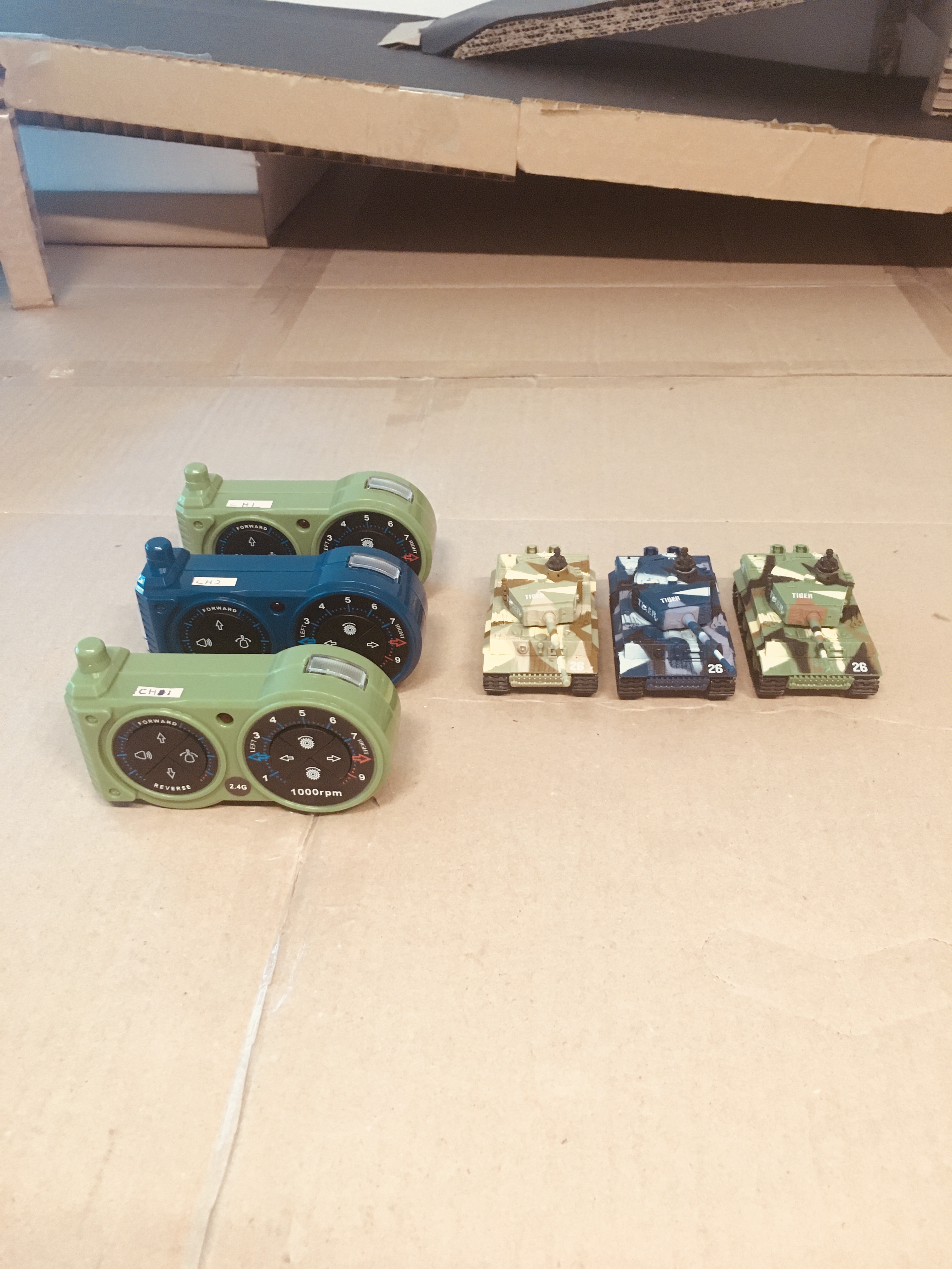

got some more of these 2.4G 1/72 scale Tigers as they are inexpensive 5 channel radio gear that is just right for 1/35 scale models.
A few minor mods make the Tx better. I will describe these mods if any interest.
Excellent models for ~$20.

I am going to use the electronics from one of My Tiger Tanks in a Japan Type 97.
1/72 Tiger to 1/35 Japan Type 97
