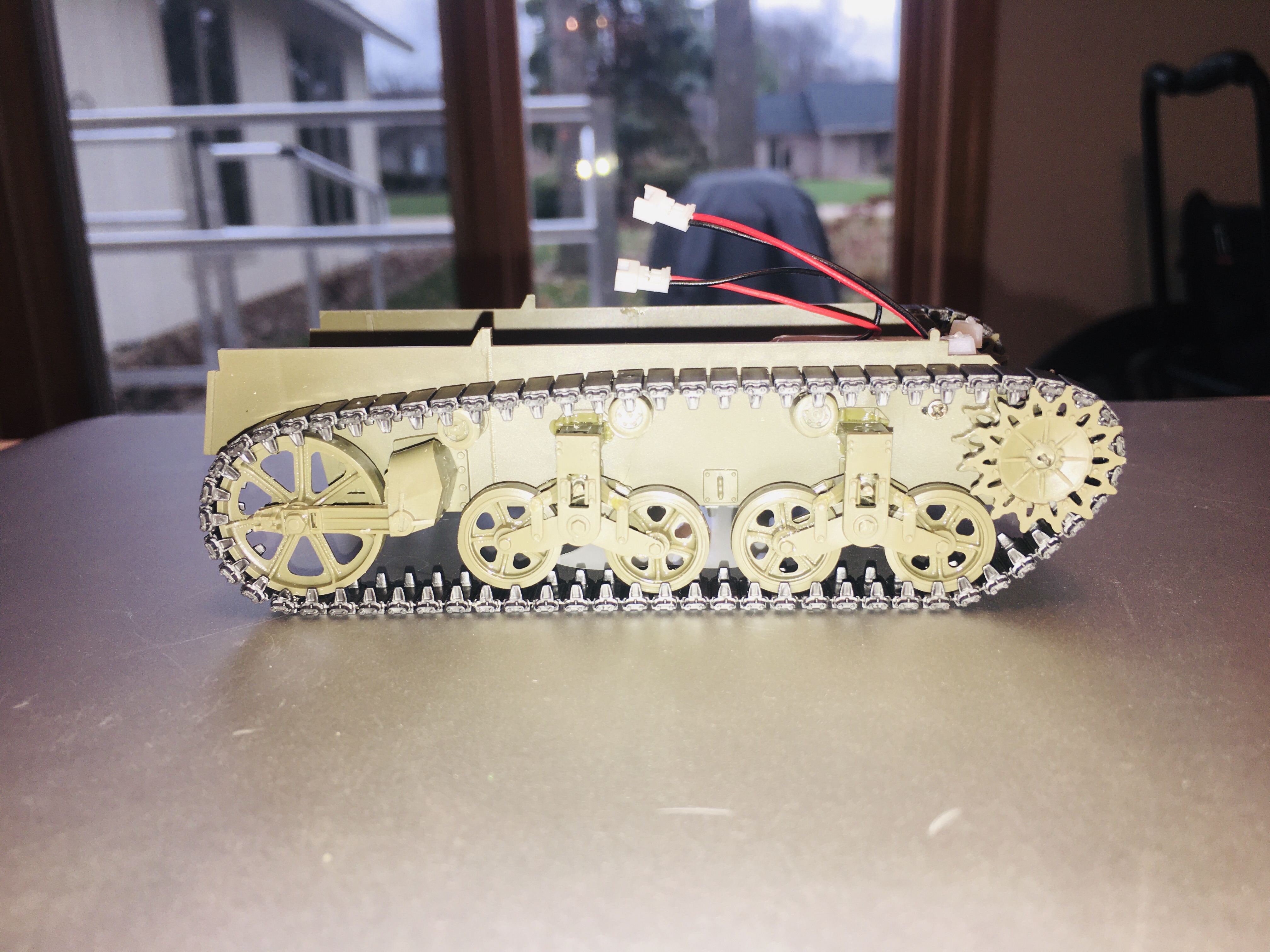

Model is going through test runs before final assembly

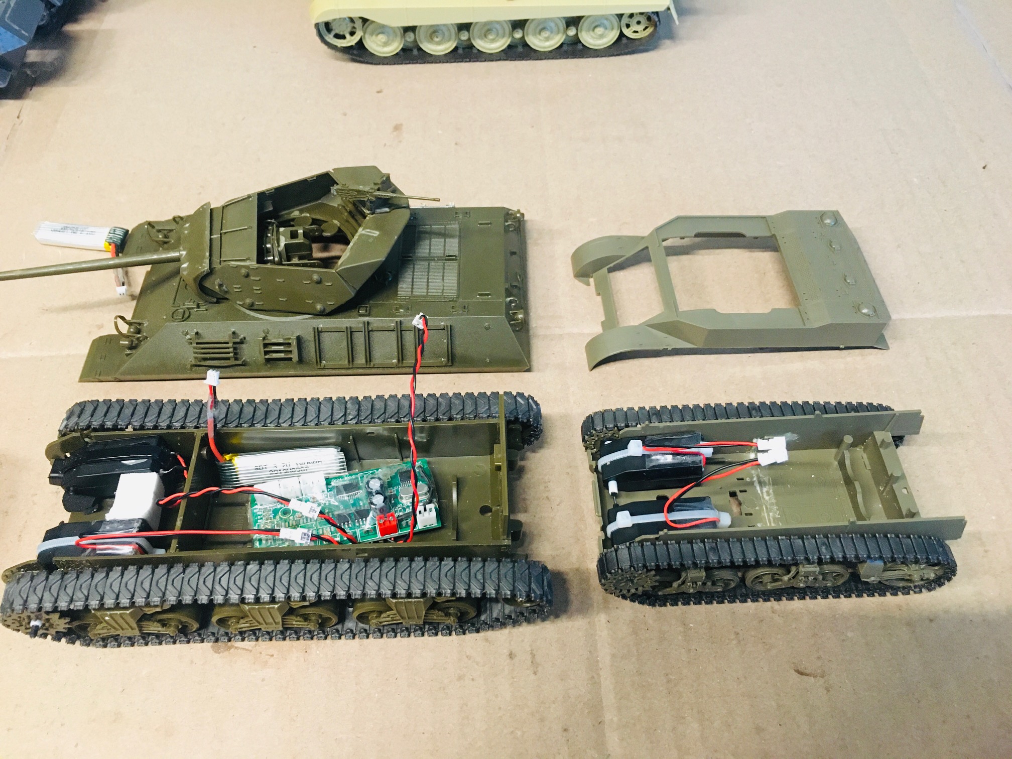

These are two MTM conversions in my collection, more on the way!
This took me several hours to add these gearboxes but like anything, it gets easier after you do a few.

Oh they can still be found with (all metal gearbox) but at a much higher price of course. In the case of the model in this thread, MTM gearboxes can be installed with good result. I have bought several used models with the metal gearbox that had never been run so they were in VGC!
I have also bought several new ones still in shrink rap. They cost upwards of $200 but they are pretty unique and can last a long time. I have a Sherman M4E8 with metal gearbox originally a "motorized remote control" model that is 45 years old and still is in operation 8)

Yes this is a very cool model with excellent tracks. To get the suspension lined up takes a bit of patience so that all the road wheels spin (mostly) when in operation. I had to cut 2 of them loose and realine also had to raise the rear idles wheels up just a bit. I will show that in the next pictures. It is now running very well and has very good track action. very smooth and takes very little power to run the tracks. if you look at the forth picture down from the top you can see road wheel issues. Still works good just looks bad visually when a road wheel is off the ground not touching the track and of course does not spin with no load when in operation.

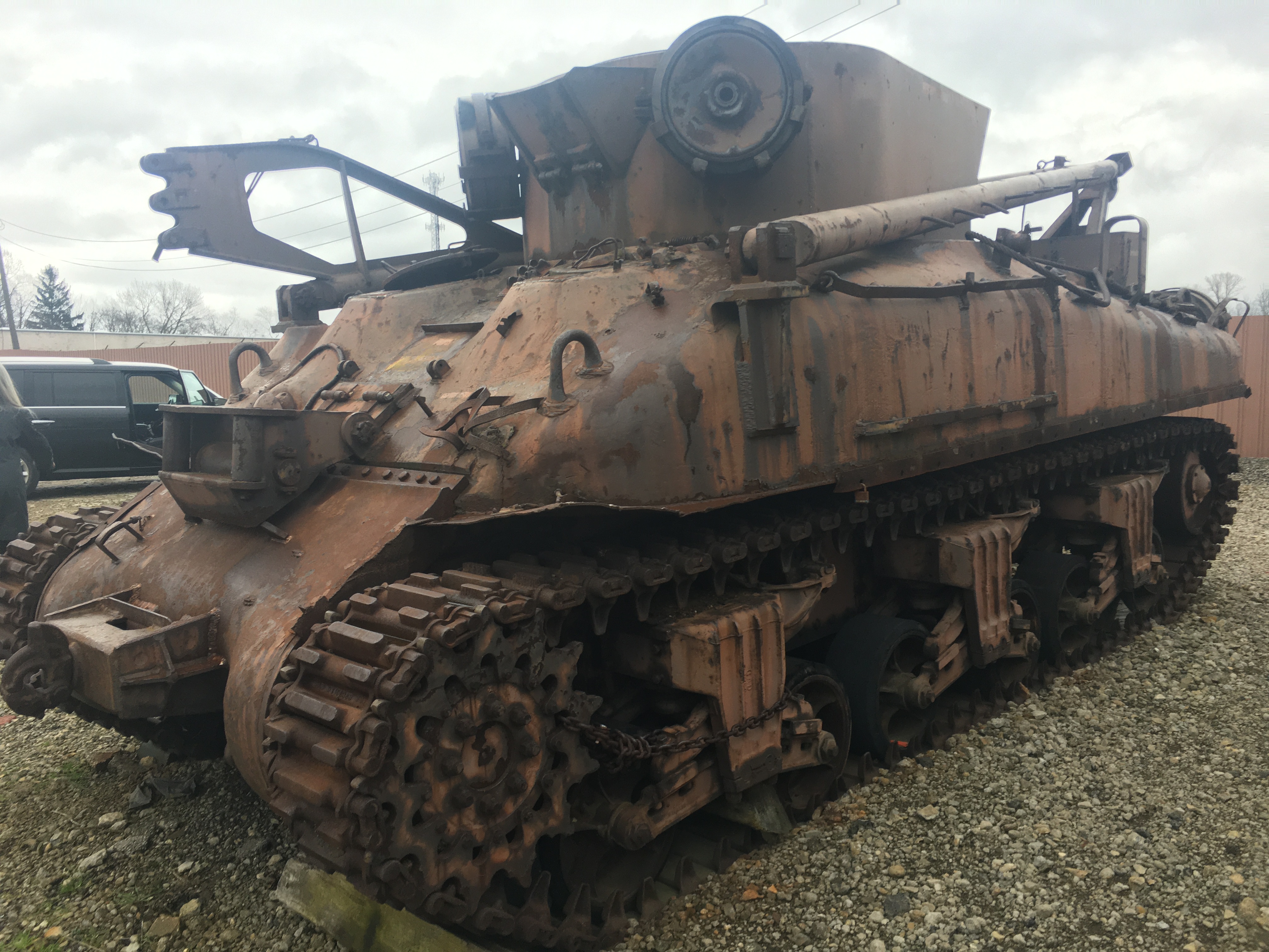

Here is a local M4A1.
rear view
rear view
Up for sale @ Sam Winers Akron Ohio

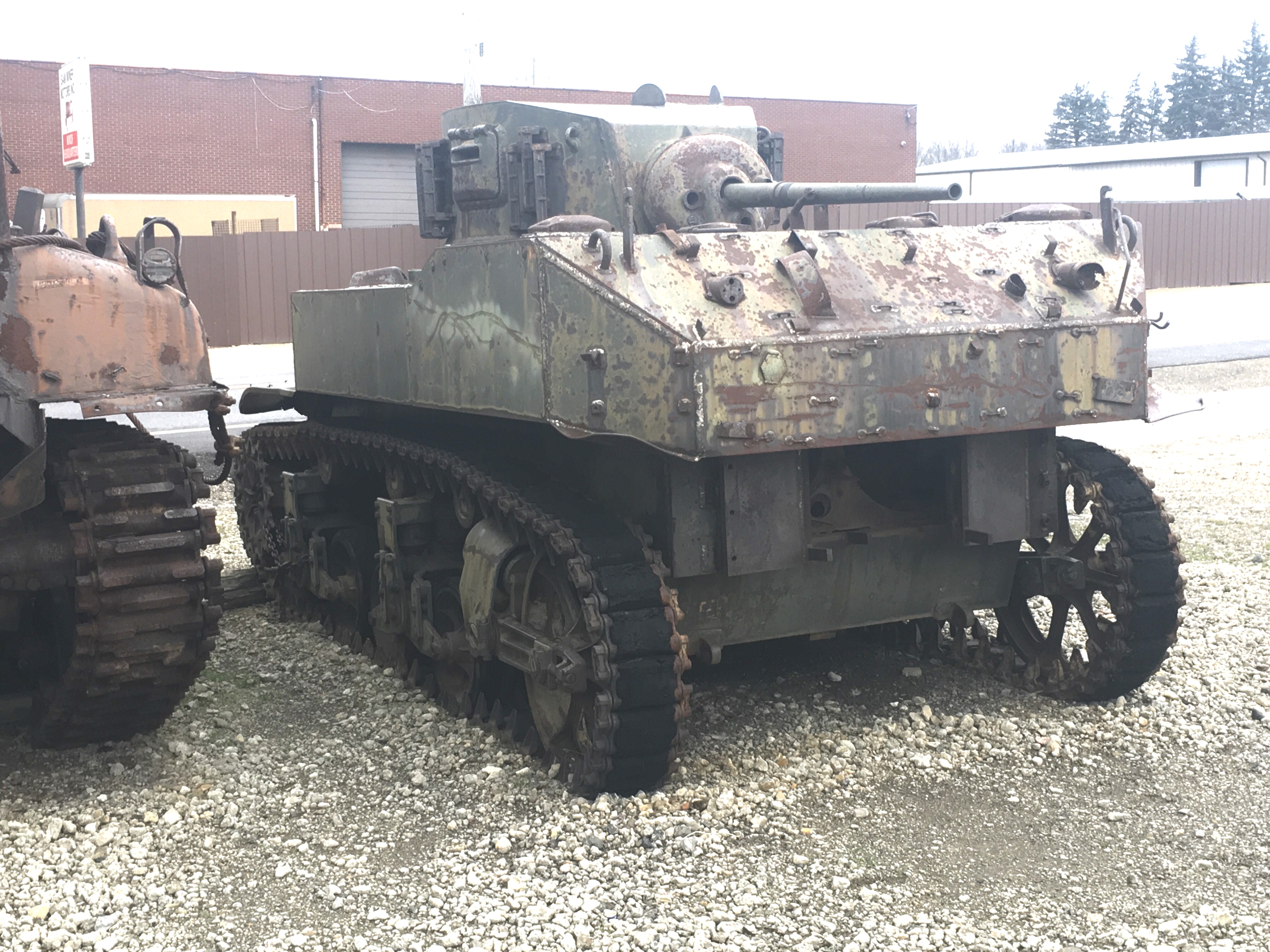

That Stuart looks frail in 1:1, no wonder it's a hard R/C conversion (reliably). Do you think the chain on the front sprocket is a anti theft device? Even have an M32B1 in the background!
Eric
modler
Posts: 621
Re: 1/35 scale M3A1 conversion to RRC with MTM gearboxes
Post by modler »

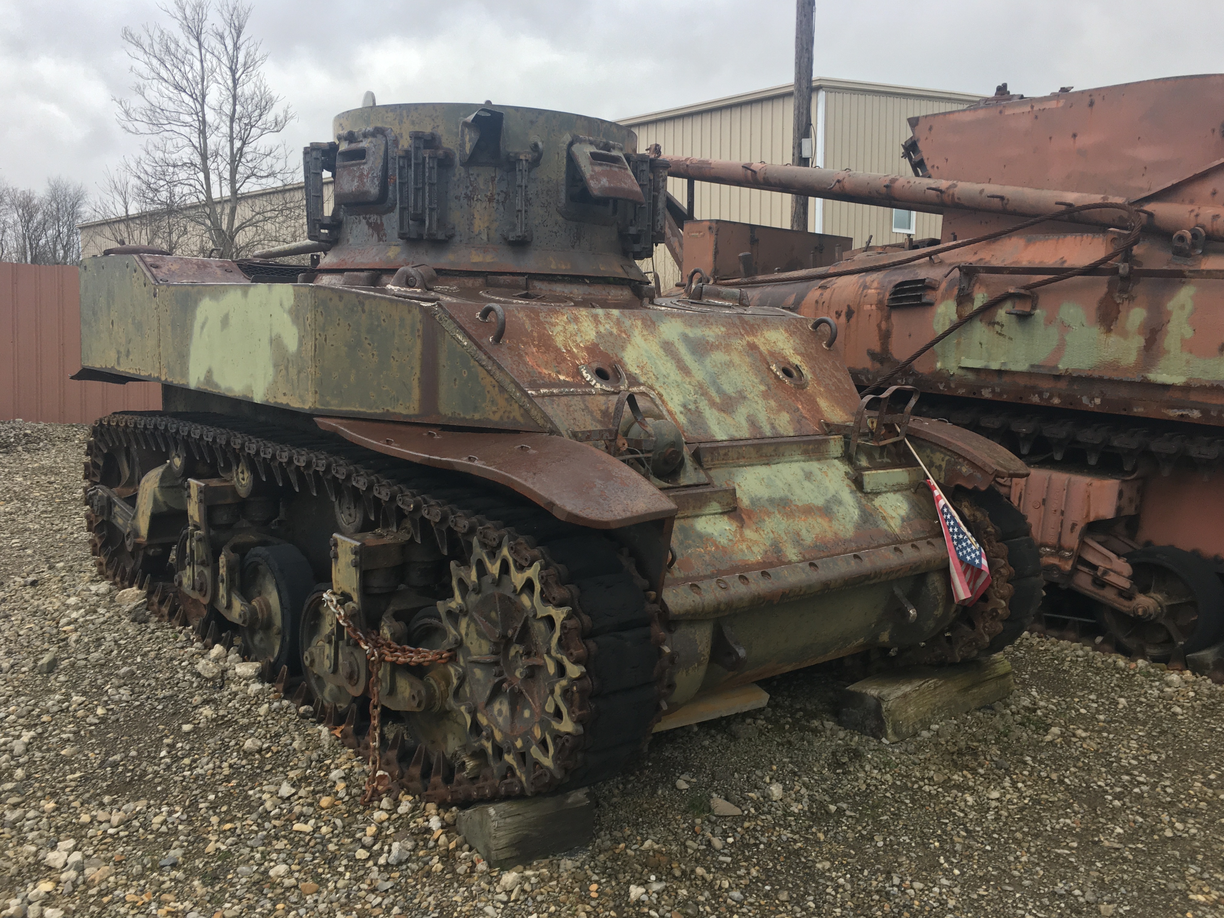

Ecam wrote: Thu Dec 14, 2023 5:22 pm That Stuart looks frail in 1:1, no wonder it's a hard R/C conversion (reliably). Do you think the chain on the front sprocket is a anti theft device? Even have an M32B1 in the background!
Yes and or to prevent someone moving\dragging it forward into the busy street as a prank ;)
Well the M4A1 "Stuart" may look frail in the picture above but up close looks quite sturdy. I think these things are known as sports cars of the Tank world with the twin V8 Cadillac motors.
I wondered what that other Tank is... M32B1 eh? I will post a better picture of that one...as you can see, it is chained as well.
M32B1
M32B1
