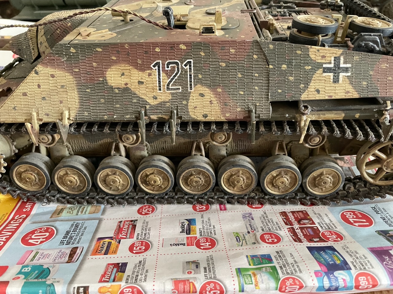

I asked Atak what glue they recommended and they replied with Migs Ultra Glue. Worked fantastic on both my Tamiya King Tiger and JP IV/70.

Seems to be PVA but it must be a different formulation than regular Elmer's white glue as it works great on the zimmerit sheets with plenty of time to allow for precise fitting. Both my models using it have been bashed around outside pretty hard and only tiny pieces have ever been knocked off from some pretty good contact which actually lends some realism as battle damage. I prefer using it to CA for attaching any slight lifting. Also have to say from my experience the Atak zimmerit kits are fantastic and well worth the money

It was Atak themselves that recommended the Mig product to me and 2 years of heavy duty battle usage outside on these 2 Tamiya tanks has not proved them wrong, Both of them have spent extended hours in conditions from barely above freezing to bright sunshine and 30C + with no lifting. But if people prefer messing around with epoxy then fair enough
