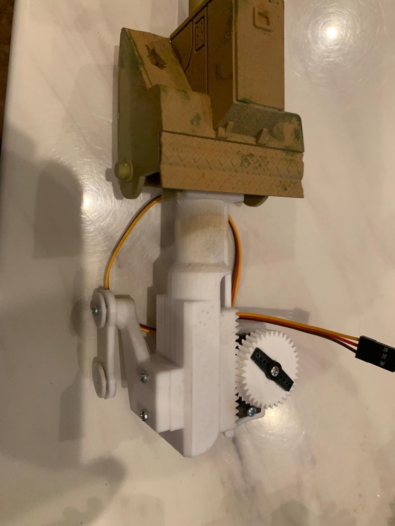

Hi guys and gals….I have the HL Chally 2 that I’ve stripped out internally and now want to refit with better kit, I bought a 3D kit recoil barrel for it and says it can only be used with a Clarke TK board, I’m useless with all this stuff, would anyone be able to point me in the right direction on what to get and if preferable it being all plug in and go:
What upgraded gearbox to use that is available
Speaker
Control board (the Clarke ones)
Turret rotation servos (any other servos I’d need)
Transmitter/receiver
Any other kit I’d need??
I removed everything as I didn’t think the Ch2 deserved the equipment inside, I didn’t like the lights that come with these tanks either, I’m not bothered about putting them back in either. Any help would be much appreciated.
Thanks
H

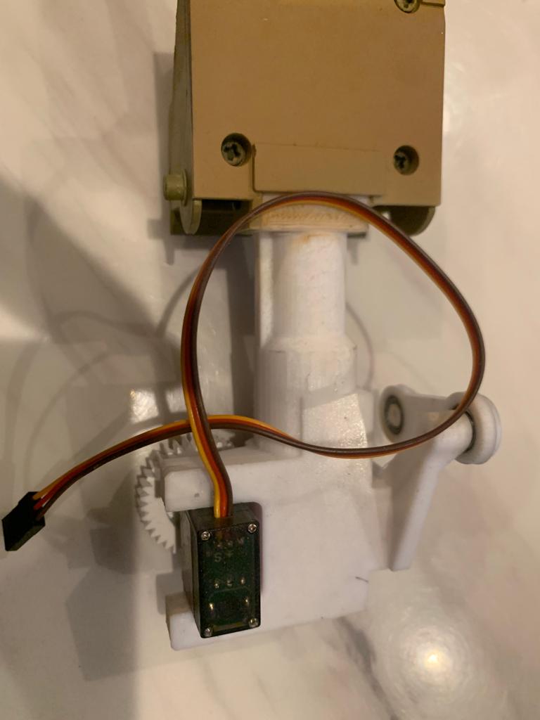

maxmekker would be the person to talk about clark boards and what would be best to use with them. A link to his profile
memberlist.php?mode=viewprofile&u=2177
tankme
Posts: 3132
Location: Elgin, TX
Re: Advice on internals.
Post by tankme »
The Clark recoil can be used with other boards besides Clark. It can be used with any board (Clark, Elmod, ASP, TCB, SGS, Beier, and IBU) that has servo outputs. The Heng Long 6.1 and 7.1 boards can use the Clark recoil system as they have servo outputs. The HL 6.0 and 7.0 don't have servo outputs, but some have added other electronics to allow servo use on those boards.

Sorry for the delay in responding to you. My Challenger has a TK6.1, with a recoil from Dave at Forgebear. It requires a a plug putting in CN6. Having pictures of your recoil mechanism may be of benefit.
Transmitter. Get a HL 7.1, which has outputs for servos, as does the 6.1
Gear box. Mine currently has a standard HL steel one. Soon to be upgraded to the ultimate one. It has red motors for more torque, and slightly improved speed.
Servos can be used for gun elevation, and the recoil.
Turret rotation can be left alone.
If you read my build it will give you a good what’s involved in getting one up and working reliably.

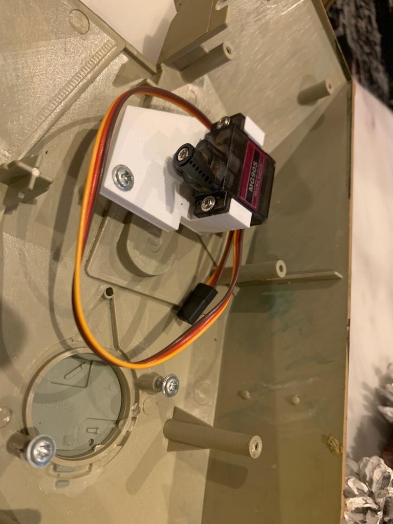

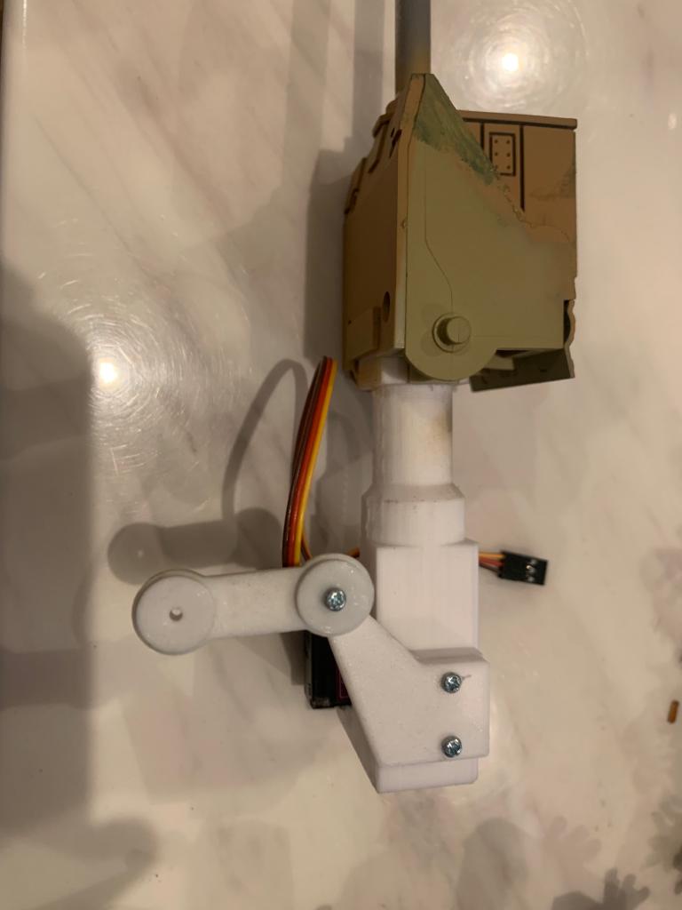

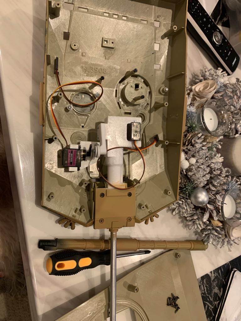

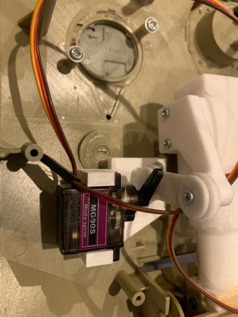

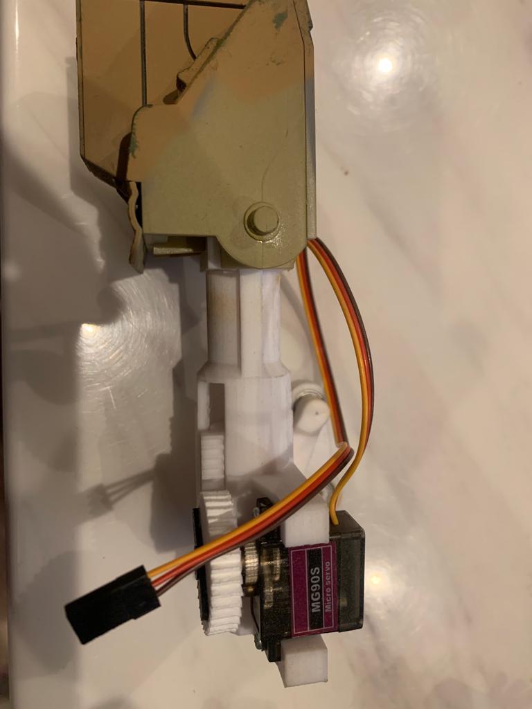

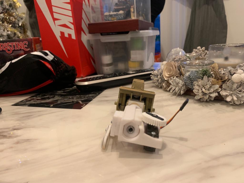

6742hitch
Posts: 5
Joined: Wed Oct 18, 2023 3:11 pm
Location: United Kingdom
Post by 6742hitch »
These are the pics of the recoil kit I have, from the same supplier on eBay who does the Chobham kit, it looks like a decent recoil kit to me but don’t know if it only works off a Clark board or what….electronics aren’t my AOE so am completely clueless at the moment, hence asking what components I’d need to just install, plug in and away I go? Any help much appreciated.
