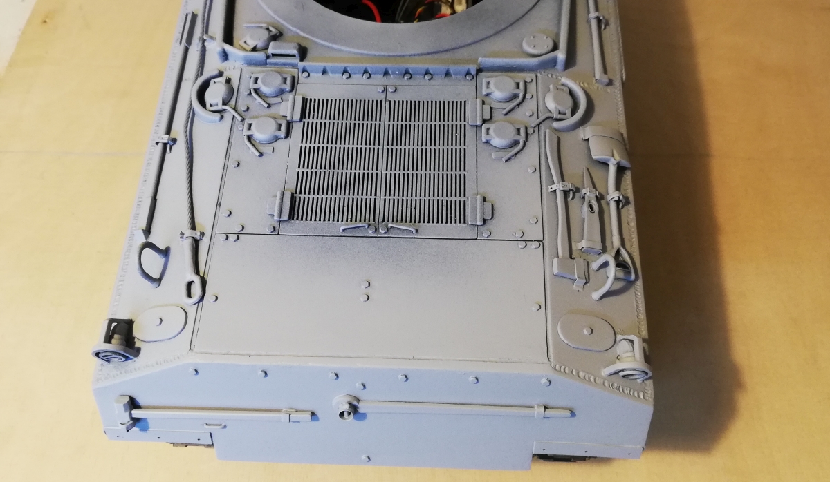

Do you know Where could the "Engine deck" be sourced from? Is this the same thing that Adam is doing for his M4AE38 in the group build?

HL and Taigen have the correct deck for the Ford powered M4A3 and M4A3E8. Unless you are starting with a different hull (M4A1 or M4 - cast and welded).

MrChef wrote: Tue Nov 07, 2023 9:08 pm Do you know Where could the "Engine deck" be sourced from? Is this the same thing that Adam is doing for his M4AE38 in the group build?
Mine was scratchbuilded using sytrene and some 3D printing parts for engine doors and additional fuel caps.
There is proper deck on Shapeways:
https://www.shapeways.com/product/62D2U ... ngine-deck
Posts: 7533
Re: Russian Sherman M4 Easy 8?
Ecam wrote: Tue Nov 07, 2023 9:10 pm HL and Taigen have the correct deck for the Ford powered M4A3 and M4A3E8. Unless you are starting with a different hull (M4A1 or M4 - cast and welded).
No, he needs to convert either the Taigen M4A3 (76) VVSS or the Heng Long M4A3 (105) VVSS to an M4A2 (76) VVSS for his project.
The Taigen already has an acceptable turret with 76mm barrel. It's just a case of transforming or changing the engine deck. And sadly the Taigen will be at a premium. Unless a Taigen top half can be acquired and will fit a Heng Long rolling chassis. Otherwise it's an expensive resin turret that is manufactured to fit a Tamiya hull. Or lastly a Mato Turret fitted on the Heng Long, which is the least accurate turret.
