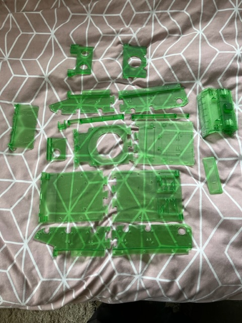

In this thread is something I have been working on, I decided to be different and print inkors comet in an abs like resin.
So far it’s picking all detail out and seems as strong as hl plastic, here’s some photos of what’s printed so far

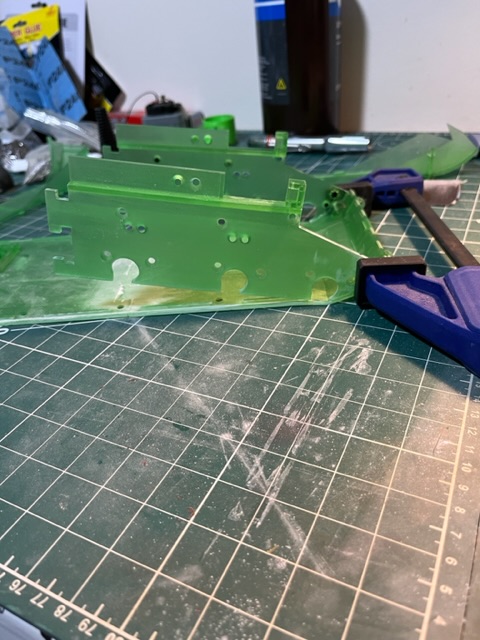

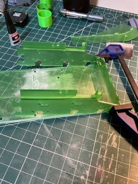

I did start assembly but I stuck the hull sides on the wrong way round and the glue had started to set when I realised so in the bin it went and a new hull is being printed. Photos will go on when it’s all printed and I start to assemble next week

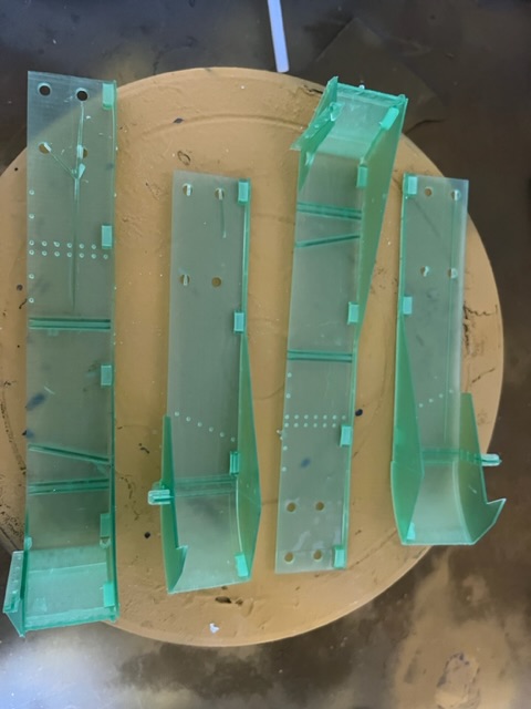

As you can see in the bottom photo the mudguard are assembled but at the moment just clipped together. Though the clips seem to be self locking and the won’t come appart now without snapping off the tabs they will be reinforced along the joined and in the clips with superglue

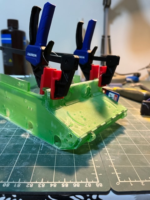

A bit of the comet assembled. So far it seems strong enough

Some of the thinner parts have warped slightly but it’s has been designed to be screwed together rather than glued like I am, how ever I will print another and build it the way it was designed
Exhibitedbrute
Posts: 1794
Re: I dare to be different
Post by Exhibitedbrute »
I have dealt with the slight warping by putting the piece in place then weighing it down, in this case with some gearboxes, and as you can see because it’s quite thin it’s done the trick, I would also point out that building it how inkor designed it and screwing it in place useing m2 or m3 x 10mm countersunk self tapping screws should also do the job, but as stated I used glue just because I had the glue but not any screws
