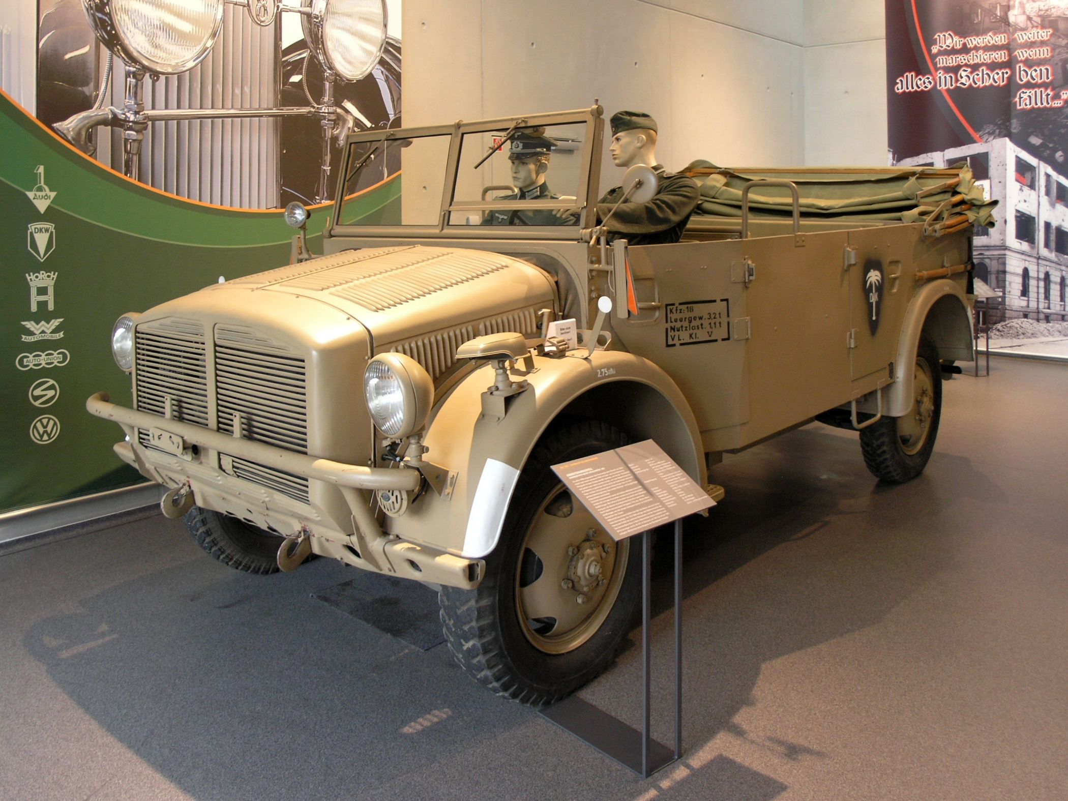

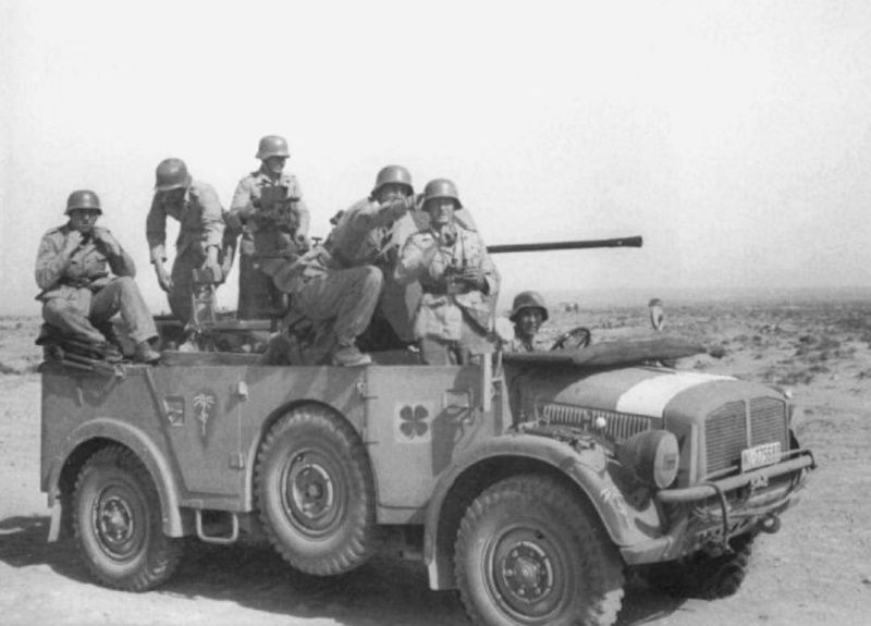

I looked again at the pictures but it iseems they used a lot different rims and tyres. I added the pictures. Aybe I looked at the wrong type of horch? personally i would prefer the bigger tyres :D
