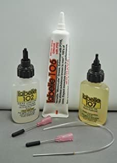

I use Labelle 106 grease and 102 oil for 1/48 trains and 1/16 AFVs. I use the grease for gears and the oil for shafts. Neither has never given me a problem in over 20 years.
