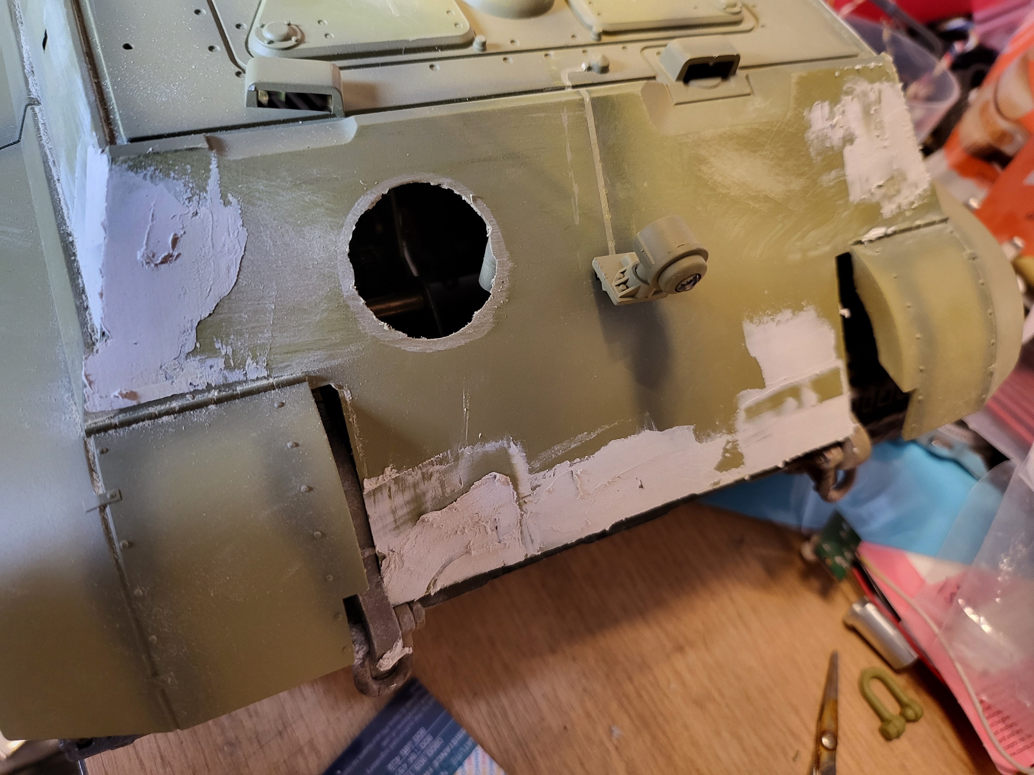

My next stage was to prep the hull and turret for the zimmerit. I started by filling in the various bits on the hull and turret where the sides and front meet along with other recesses on the flat panels. I wanted to have a nice flat surface for applying zimmerit as it is so thin you would see these as dips and getting a good join at the corners would be difficult otherwise. I removed the rounded bit on the hull front where the machine gun is mounted (and I cannot remember the name for the part as I type). The whole rear turret hatch was also pulled off carefully as this comes as a complete section in the Atak set.
There were then two or three rounds of filling and sanding getting everything the way I liked making sure to clean all the dust off when done so the glue would have a good surface to apply the zimmerit.

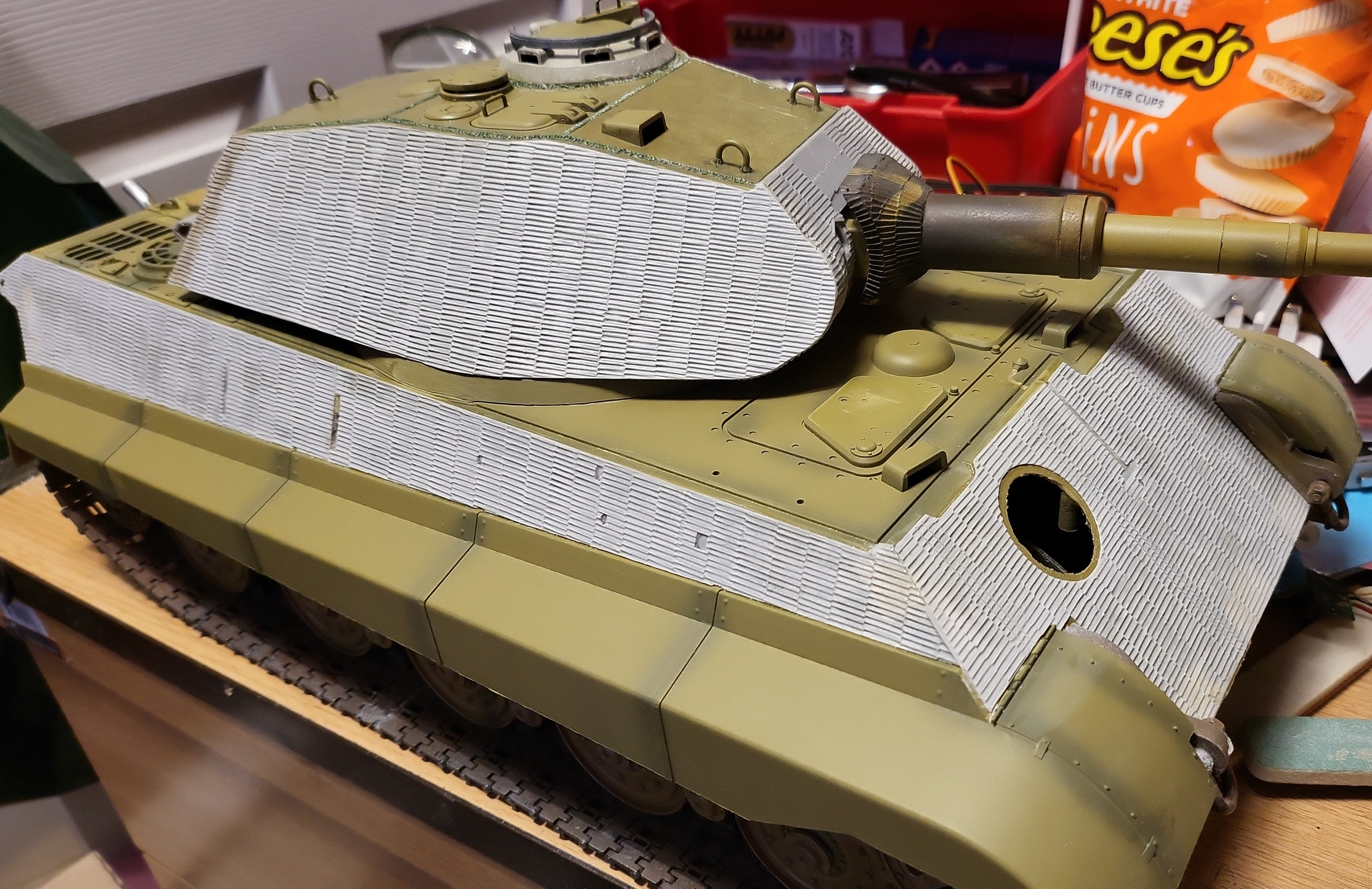

Onto the zimmerit then. It seems to frighten a lot of people off but using the Atak sets is not as daunting as it seems if you make sure you take you time and prep everything ready before applying any glue.
I got all the filler previously applied sanded smooth and made sure all the areas that would be getting any zimmerit applied were keyed and then cleaned so that the glue had something to stick to. I used 480 grit sandpaper and gently scuffed all the areas. I also did the same to the back of the zimmerit sheets as they are quite shiny and not best for adhesion with the glue. Be careful sanding the zimmerit though as it is very thin and easy to break. I tend to hold it at one edge and gently pull the sandpaper along in the same direction a number of times to make sure it is all keyed.
Once everything was nice and clean I started applying the parts of zimmerit one at a time, measuring each for fit and placement as I went. I applied a thin layer of 2 part epoxy to the tank making sure the area was fully covered but not overdoing the glue - I have always used the ZAP Z-Poxy 5 mins as this gives great adhesion but also gives you about 5 mins time to get it adjusted to just the way you need but other similar brands are available :D . The parts were applied making sure there is no air trapped in between the sheets and the tank and it is placed exactly where you want it. I then waited for the glue to go off before moving to the next to make sure I did not disturb and move parts and spoiling the finish. The only part I had any issue with was the small half moon shaped bit on the commander's side of the turret as it kepy springing off due the the tight curve. This was easily sorted by warming the part up gently with a hairdrier which made the zimmerit panel a bit less springy.
Once it was all applied I put small amounts of filler where there were joins I was not happy with and sanded the edges of panels to get the finish I wanted.
The main part with the process is to be patient and take your time. One thing I noticed is that the zimmerit has bits that are lighter than others once glued on but this is nothing to worry about as this is just to do with an uneven thickness of the sheets due to the way it is made.
