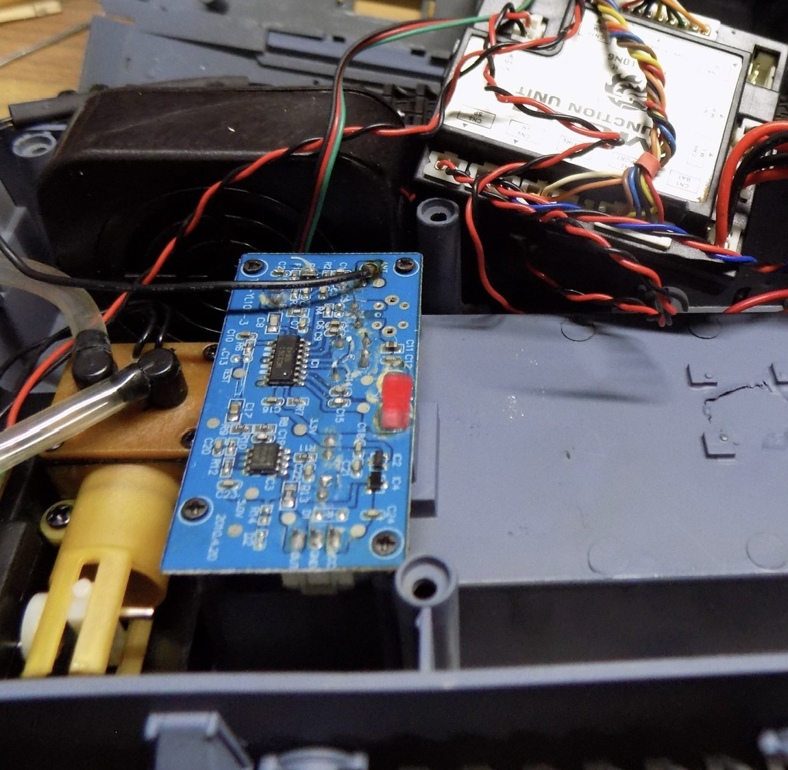

One of my early tanks is a PzIII with and exposed circuit board no crystal but a three position switch on the board. I believe it to be an RX18, the TX is silver. I plan to upgrade it so that is not yet my question. The other first tank was a 2.4 MFU in the box like most of the my tanks have. Now the question...
My brother sent this to me as a birthday gift. It has the familiar MFU but is not marked 2.4. And it has the blue exposed circuit board with a crystal. It did not come with a TX or instructions. WHAT DO I HAVE? What transmitter is needed or is this a good candidate to upgrade the electronics. If it is a version of RX18, I'll assume the non crystal TX I have from the PZIII would not work!?!

if it has a crystal, you also need a tx with a crystal (same number as it indicats the channel)

It may well be an RX13,
Are the connections to the control board plugged in or soldered in place ?
If you go to E-Bay you can find the old transmitter they have a little box on the front with the number of the crystal on it, of course you need matching crystals they certainly were available so try E-Bay but the lack of functions compared with what we are used to I would modernise the tanks electronics.
There are a number of conversions on the Forum if you check through the relevent menu.

I'd bin the electronics and get a V6.1 or a V7.1 so you can use servos for the relevant controls.
As for the Rx 18 description, the non-crystal versions are Rx 18 but carry a version like V5 or V 5.4 etc. Its actually fairly hard to nail down a specific version post crystal!
they are all 2.4 gig and have switchable sounds, or not, 4 sound options, or 2, etc etc.
Just bin it and get one of the latest H/L options.

Its a heng long stug iii IR version fitted with a heng long rx18 27mhz control board and receiver there should be a crystal in the receiver board accessed through the battery box
the transmitter it uses is pictured below can be silver or black. Crystal is located bottom right corner 02
If you search through the forum you will find that people waste more money trying to get these old systems working than it cost to replace it so if you don't have a transmitter that works with it don't waste money on 1. it's more a case of what you want to do with it.

Old Heng Long system, with quartz, in red on the photo, location of the crystal on the reception plate. Exists the same in 2.4 Ghz (RX 18) but with the same functions. There were also systems without quartz, (very old .. .) without quartz, but switch 3 positions on TX and platinum of the tank, thus allowing to choose the frequency
very old HL turntable without qartz

I gutted the Stug and swapped in a newer system from a tank waiting it's turn on the bench. All systems (recoil, flash, sounds, and movements) work. I am still debating going to aftermarket boards for my three TDs to get my recoiling barrel and breeches working. That would free up the systems for use in retrofits.
