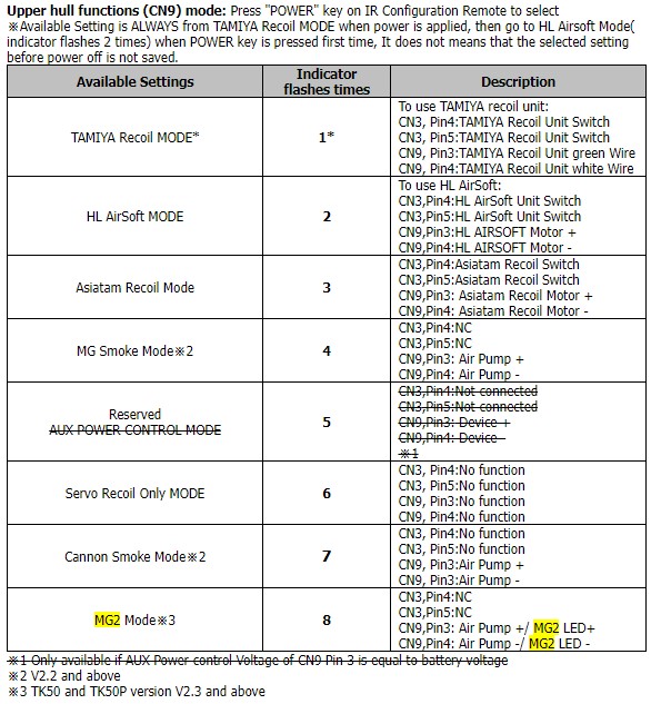

I'm a bit confused also after looking through Clark's docs. My educated guess is that CH4 MG2 function is for the non-Sbus type boards and the CH4 is triggered with stick movements. For the Sbus boards, VR A triggers the MG2 LED connection wired to pins 3 and 4 on connector CN9. In order to make that work you need to select option 8 (Power button on remote). This is a just an educated guess at this point since I've never hooked up an MG2 on a newer Clark. Hopefully this helps.

Sherman1981 wrote: Sat Aug 26, 2023 4:41 pm Yes I have the sbus system. I can fire both machine gun sounds. However CH4 a red light lights up permanently instead of flashing with the machine gun sound / button. Is there anything on the Sony remote I need to press to enable the CH4 function as an LED flash?
Hence my question? what kind of plate? if I rely on the latest info from Tank me, the MG 2 led is connected to CN 9 ​​and therefore would work from an inter or knob? so direct on Ch.4, knowing that there is only plus and minus and command signal, would explain why the Led is permanently lit?

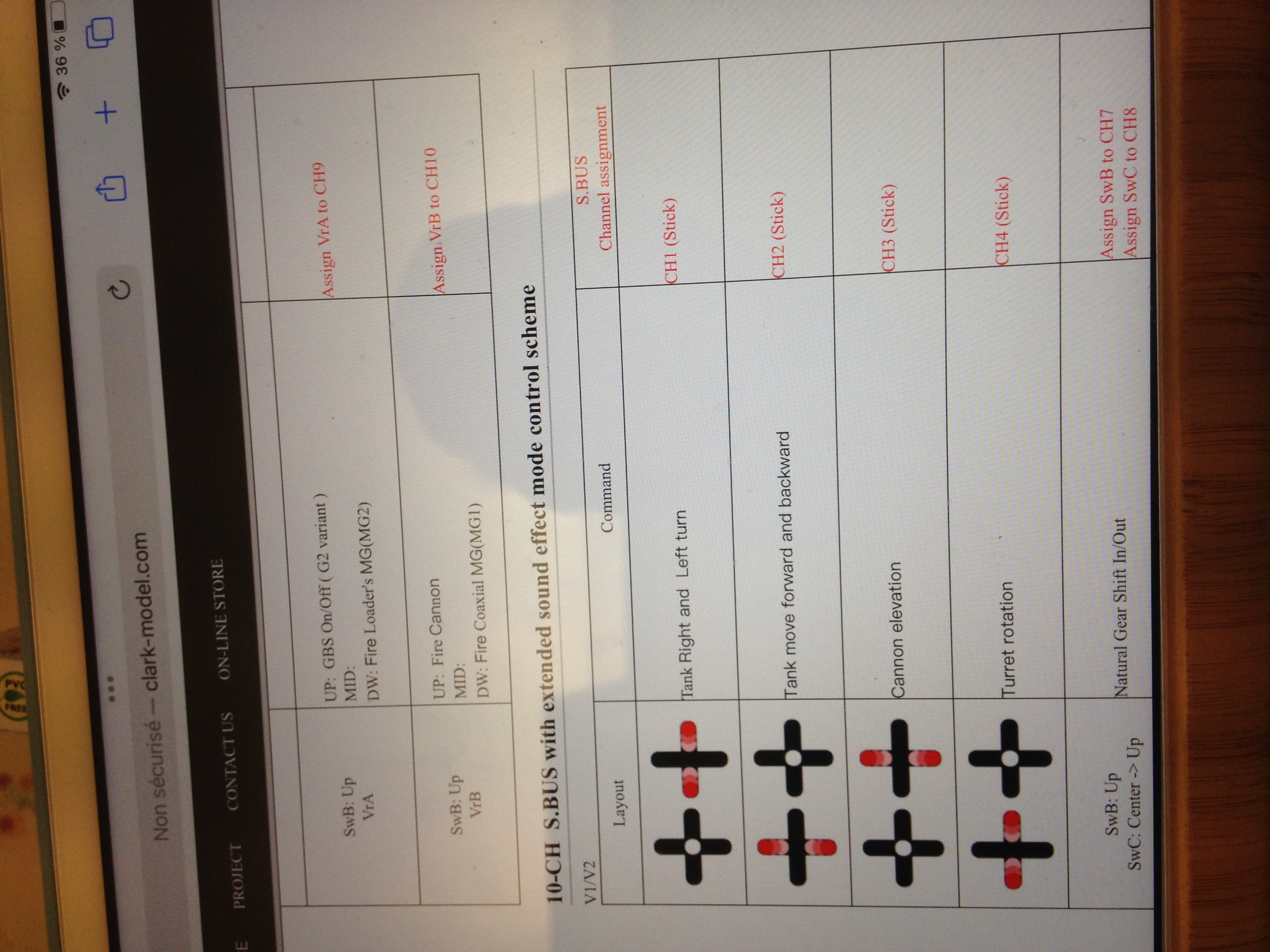

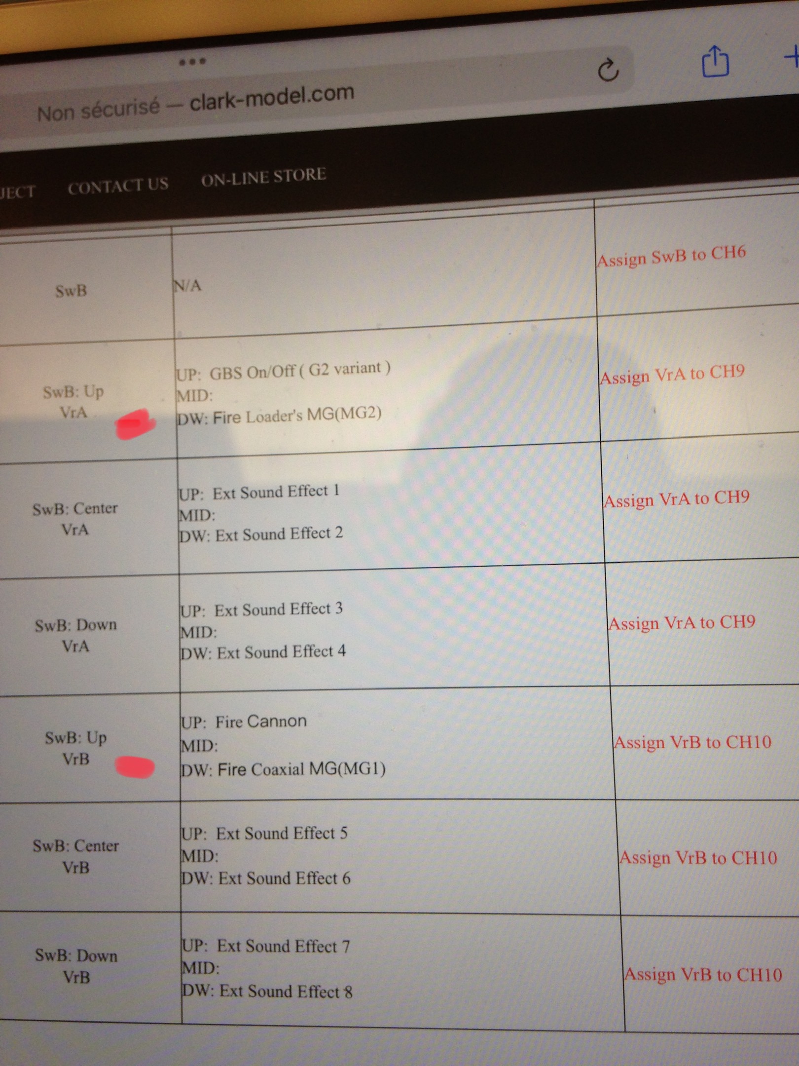

Found on Clark site, channel assignment for TK 50 Sbus!!! ( red ))Radio 10 channels minimum, and no LED on Ch.4
