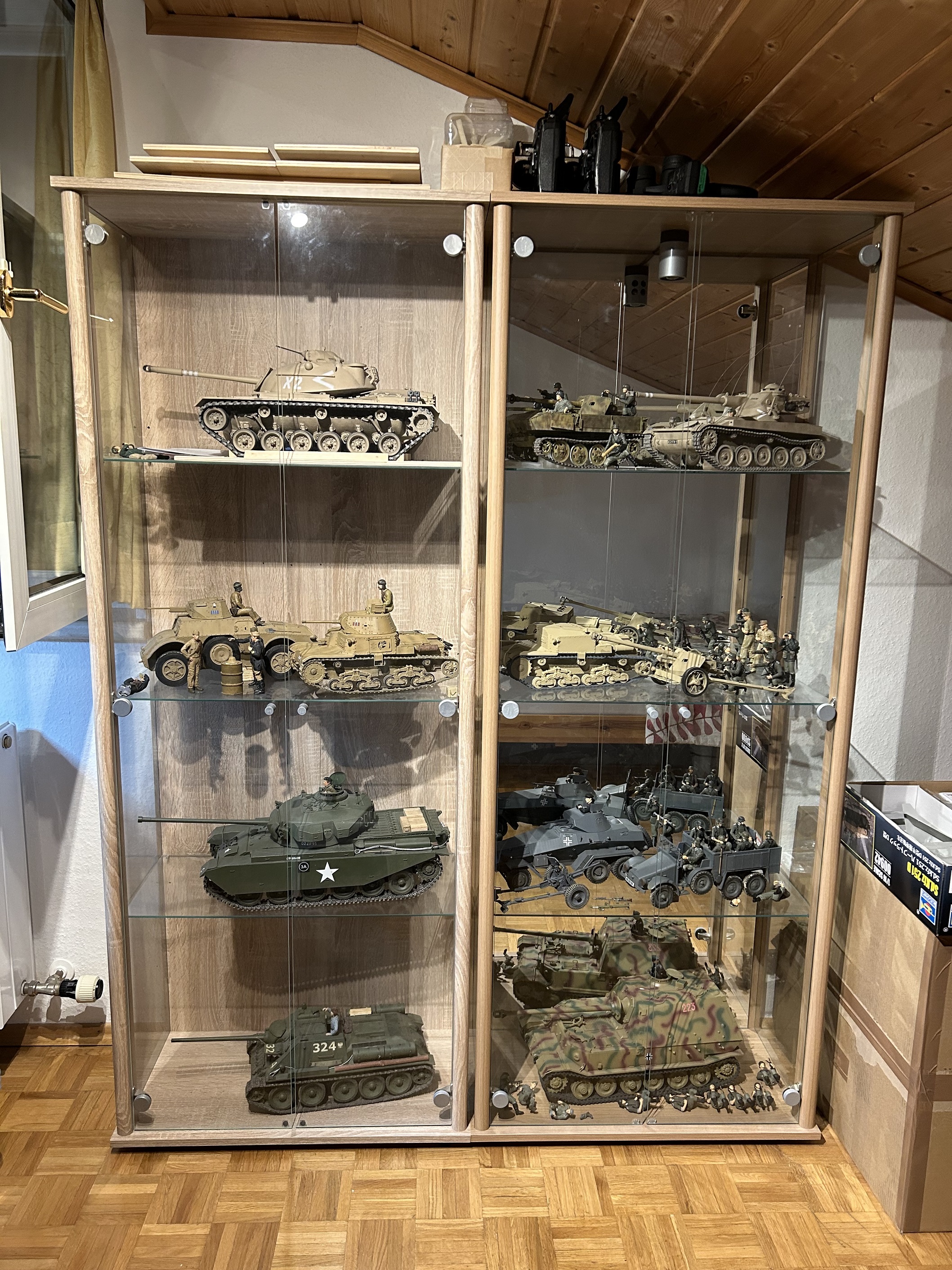

Ok, here we are... from the left downwards

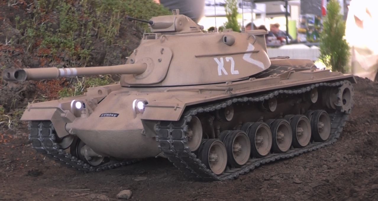

M48A2C
This is one of my favorite MBT tanks after WW II. The shape of the later motor deck and especially the frog nose is unique, so this is much more favored to me than the later M60. The decision in favor of an IDF tank or in the Vietnam theatre on the former, because there much more tank battles took place (succeeding IDF’s).
Overall design of the kit was made by myself. A master of the hull and turret were printed for casting in more numbers in Resin. The straight parts were made of styrene sheets in different thickness.
It was built in 2017

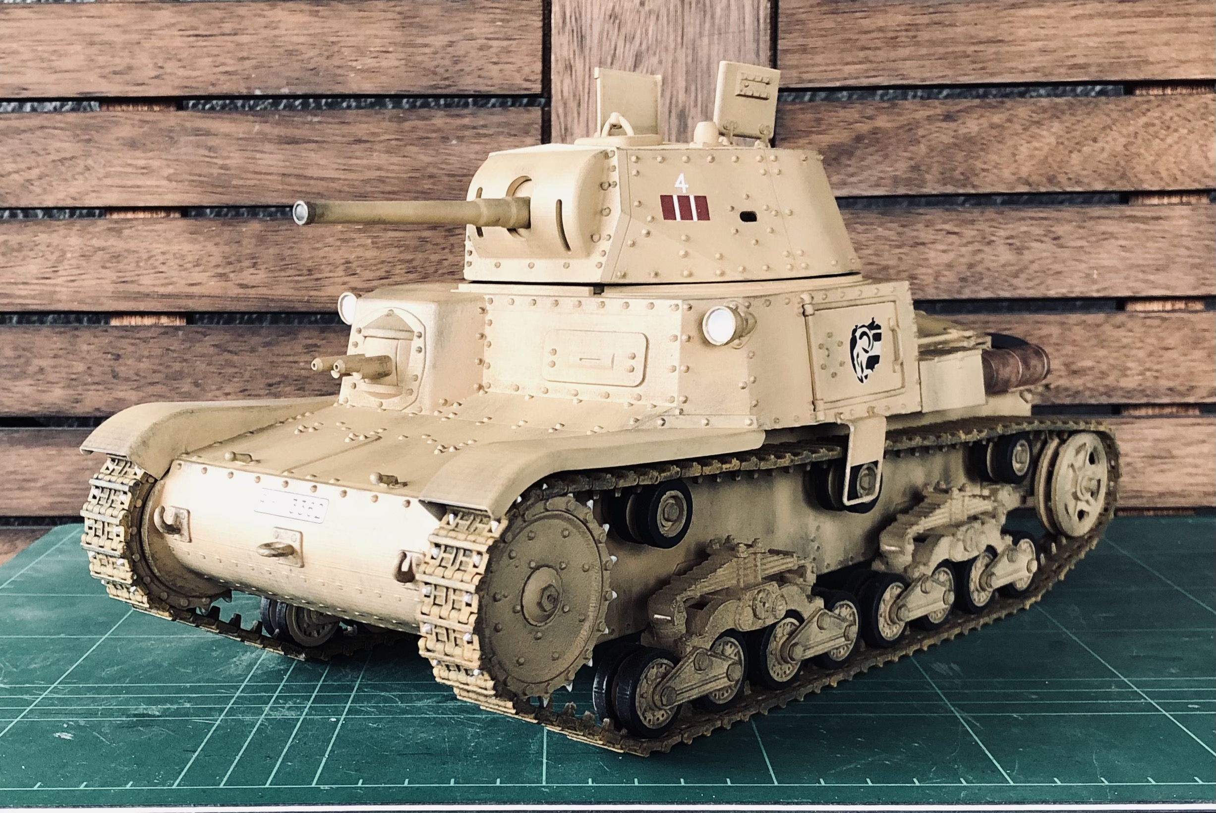

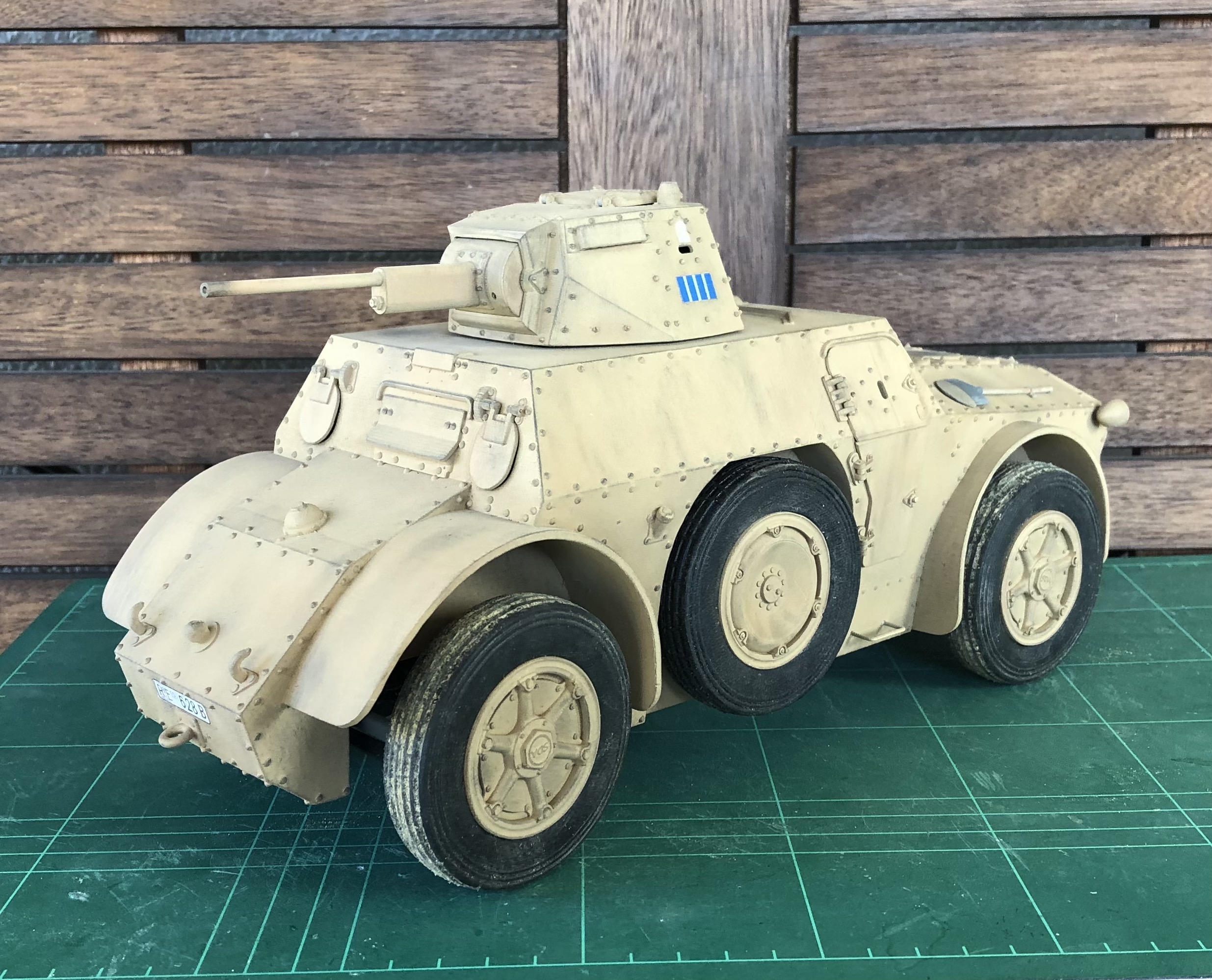

Autoblinda 41, M13/40 and Semovente (right column)
Because the Italian forces in WW II are very often overlooked and nothing is available in 1/16 so far, I was happy to add these two models to my collection. They fought very bravely, but unfortunately their weapons were too weak.
But in combination with the German Africa Corps they succeeded, especially with the Ariete division that fought side by side with the Germans, so both vehicles got decals of this division.
Both again were designed by myself, mostly 3D printed; the Autoblinda got a chassis of the two axles WPL truck, but changed the dimensions.
The tracks also are 3D-printed out of sintered PA that is very durable.
All three kits were built 2021-2023.

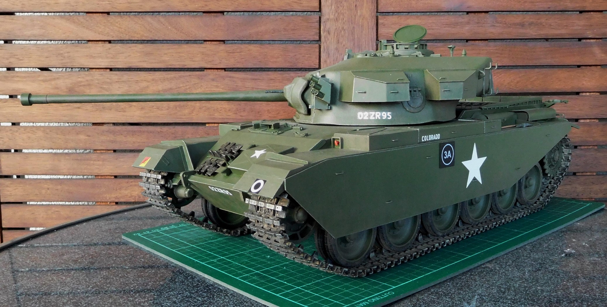

Centurion
Next to the M48A2C this is also a favorite MBT tank after WW II of mine. The Centurion was very wide spread at European Armys. Because the Korean theatre was a main campaign the decision was to mark it „Colorado“ (C-Squadron) of the 8th King’s Royal Irish Hussars.
Designed by myself, most parts are made out of styrene sheets, the turret was 3d printed, metal tracks are from Asiatam Ferdinand (Elefant). An upgrade will happen because TongDe now offers Centurion tracks.
The kit was built in 2016

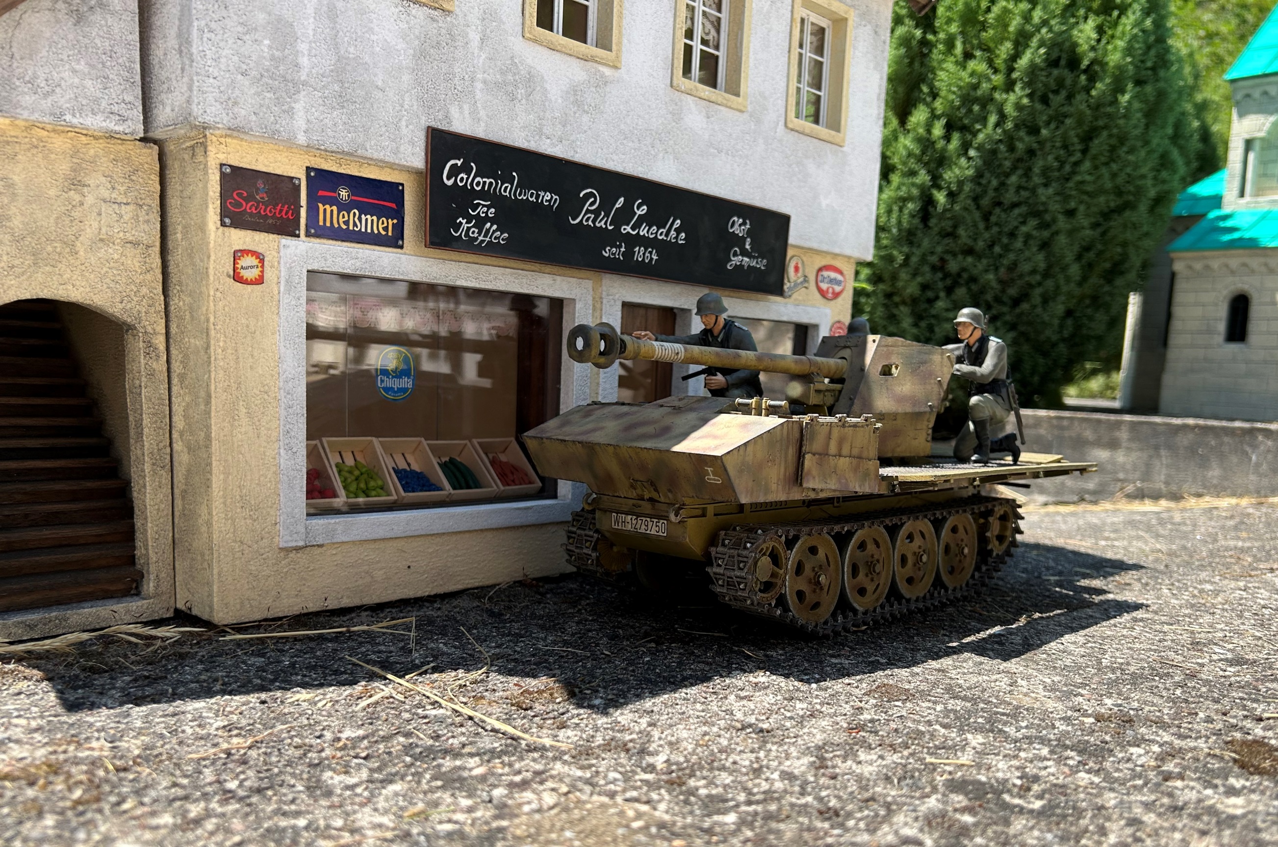

7.5cm Pak 40 auf RSO
A unique and cheap tank hunter was the powerful Pak 40 mounted at a RSO hull. Everything designed by myself and 3D printed by my colleague Lukas. It was not easy to place gear motors for elevation and rotation to the gun that were not visible. Very less space for electronics made it much more difficult.
Built in 2023.

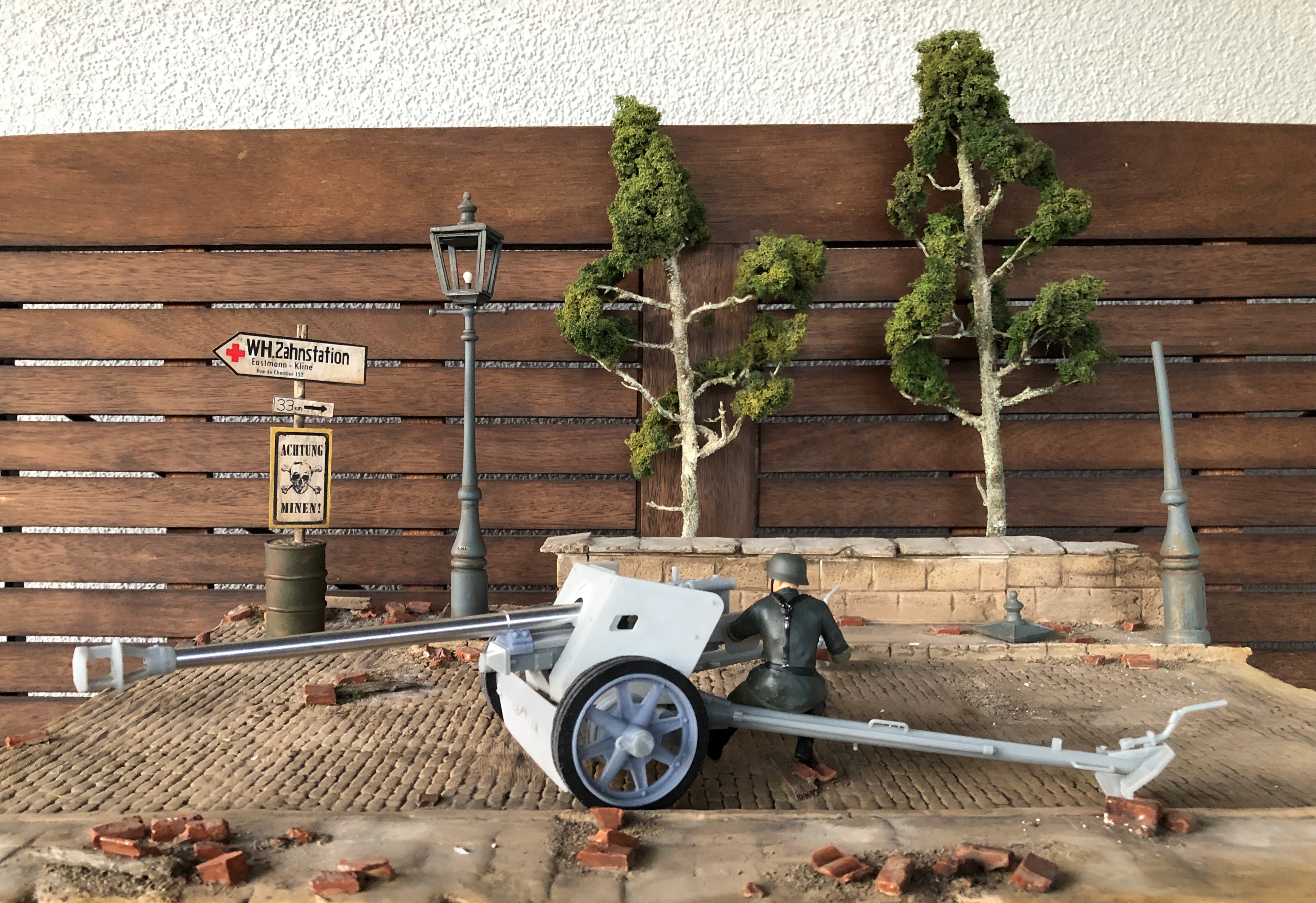

Pak40
The Pak 40 was designed und 3D printed to have various applications (pulled or mounted at the RSO tank hunter).

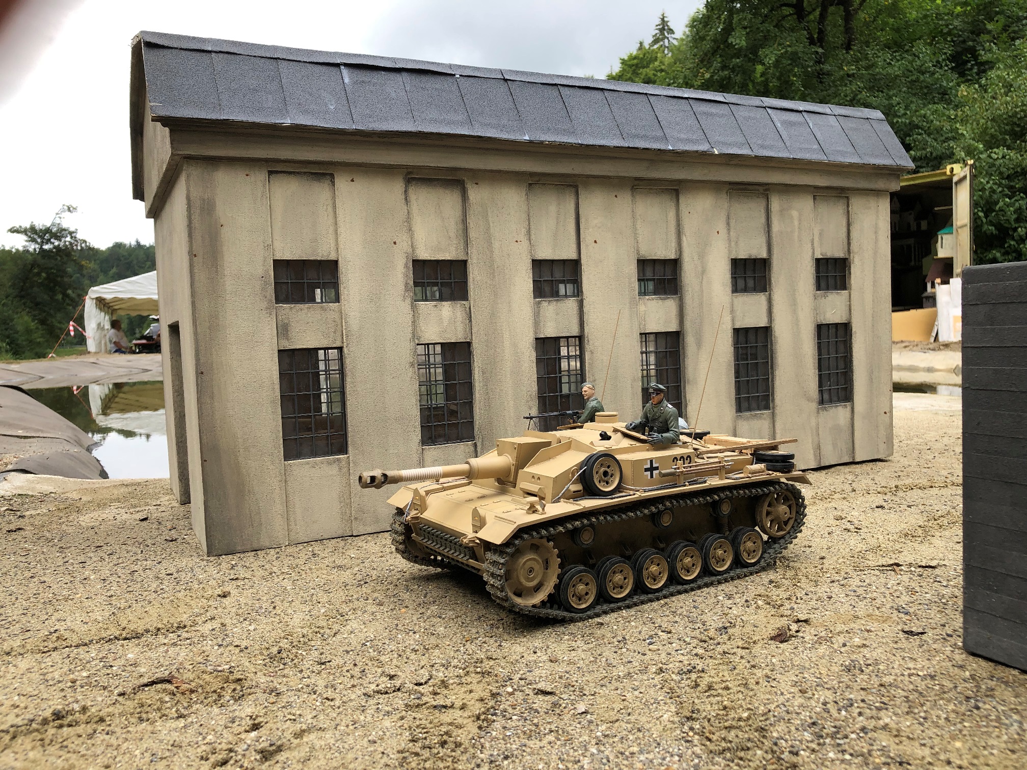

StuG III Ausf. F
My first RC tank conversion built in 2010! I have used a Heng Long Stug III Ausf. G and made a scratch build casemate of the F Version. I prefer the tank hunters to battle tanks, so this was a must for me starting into the RC scene. It was the first German tank hunter succeeding against Russian tanks in 1942.
This StuG was commanded by Owm. Kochanowski, 2. Battery of 201. StuG.Abt. awarded with the Knights Cross.

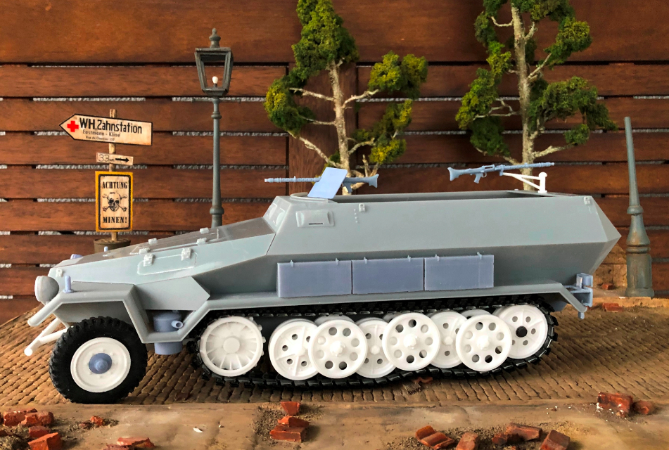

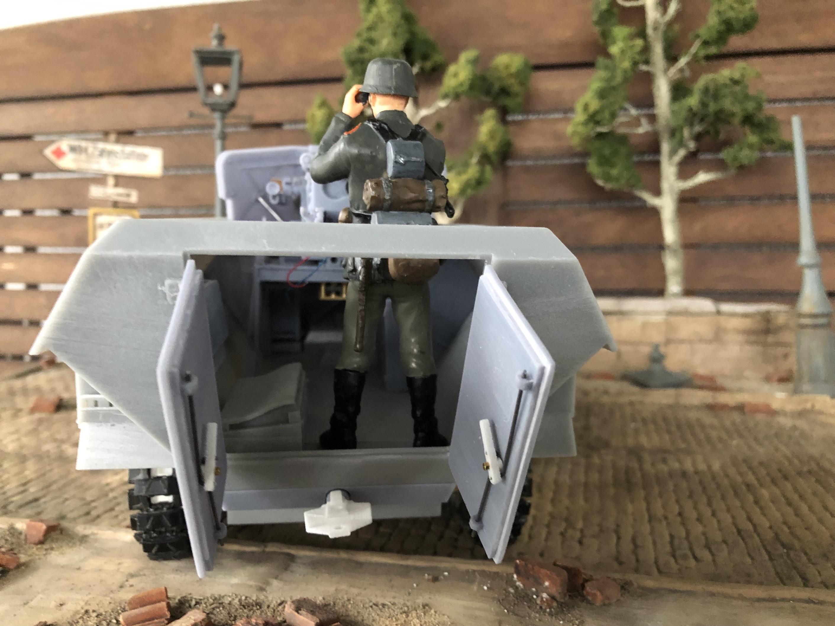

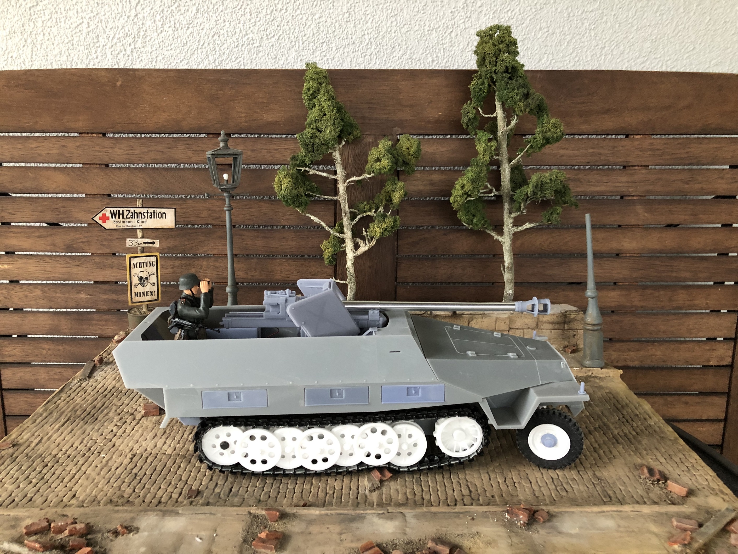

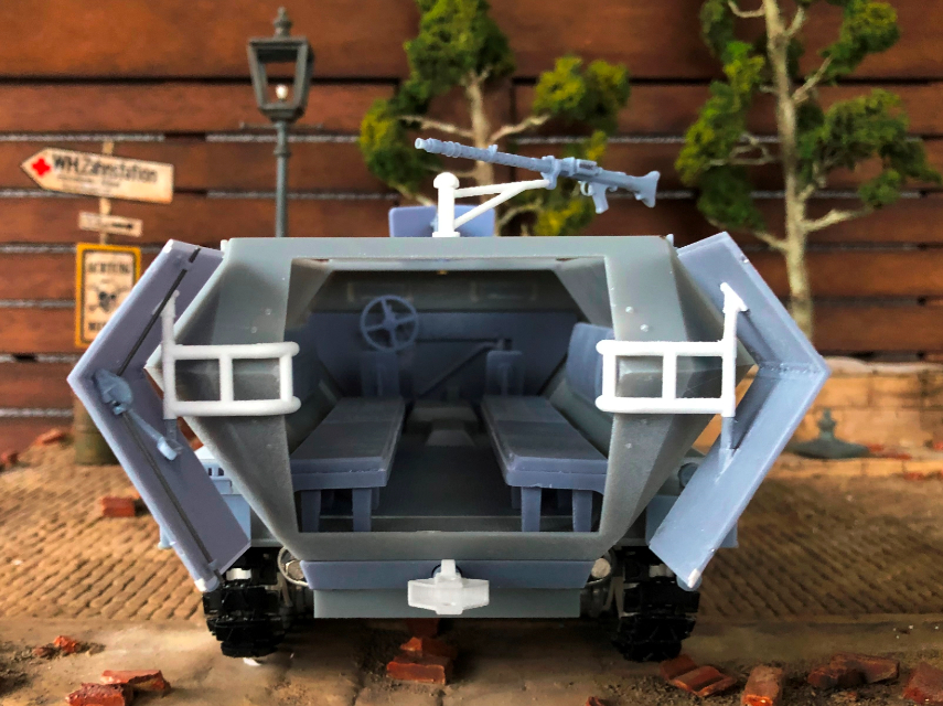

Sd.Kfz. 251 Ausf. B and Sd.Kfz. 251/22 Pakwagen
The first versions we have built in 2021 and redesigned the suspension this year. The new versions are assembled, waiting for the electrical work.

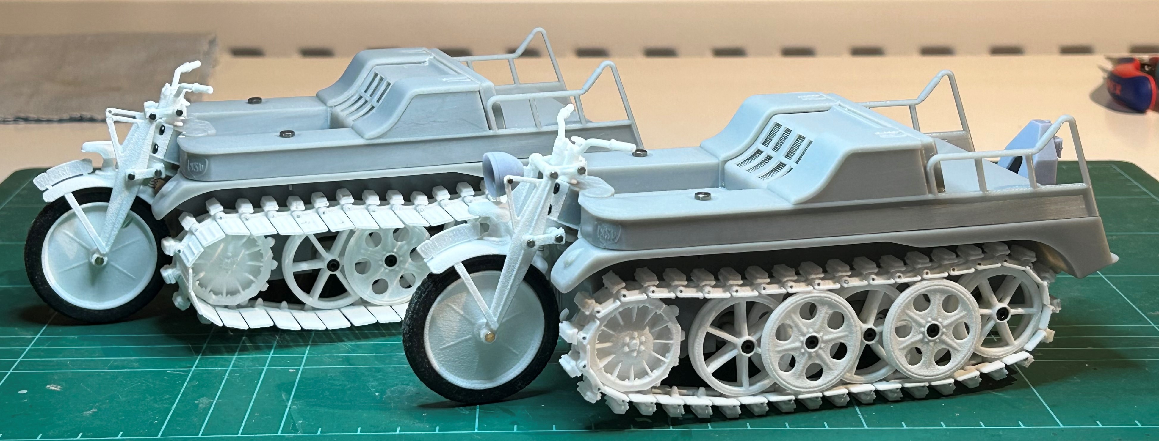

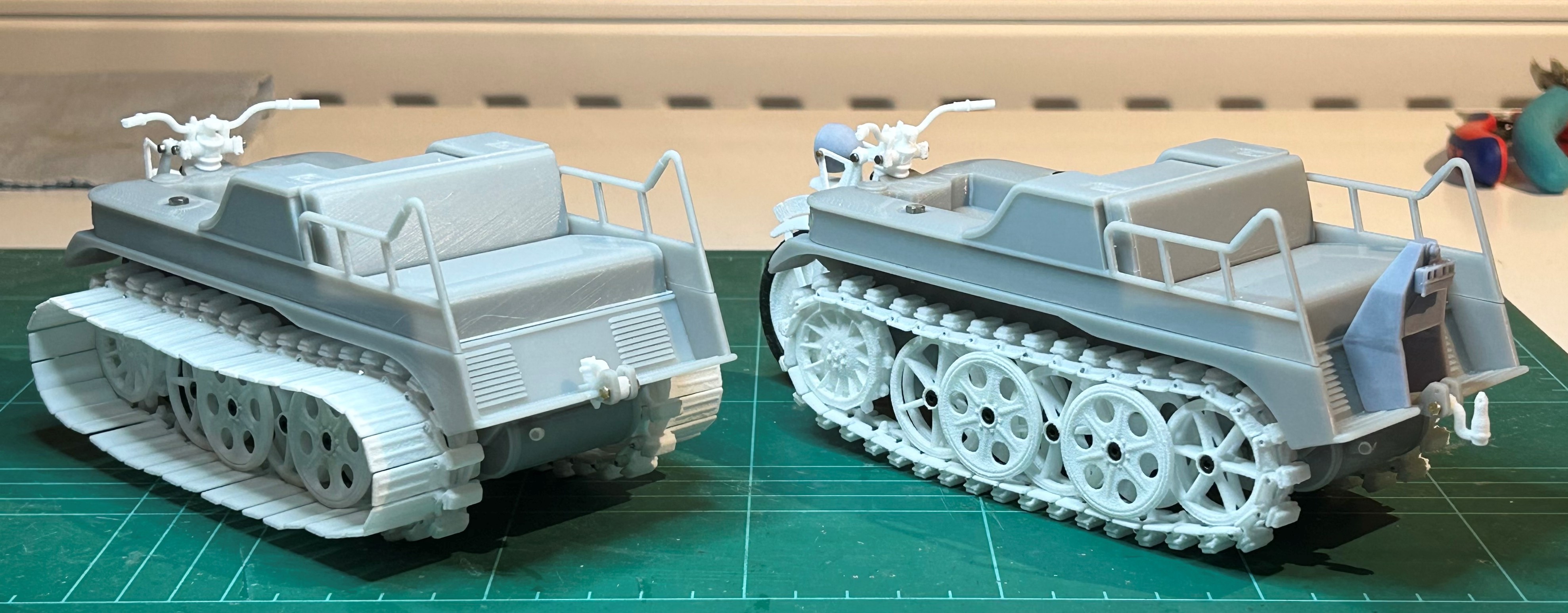

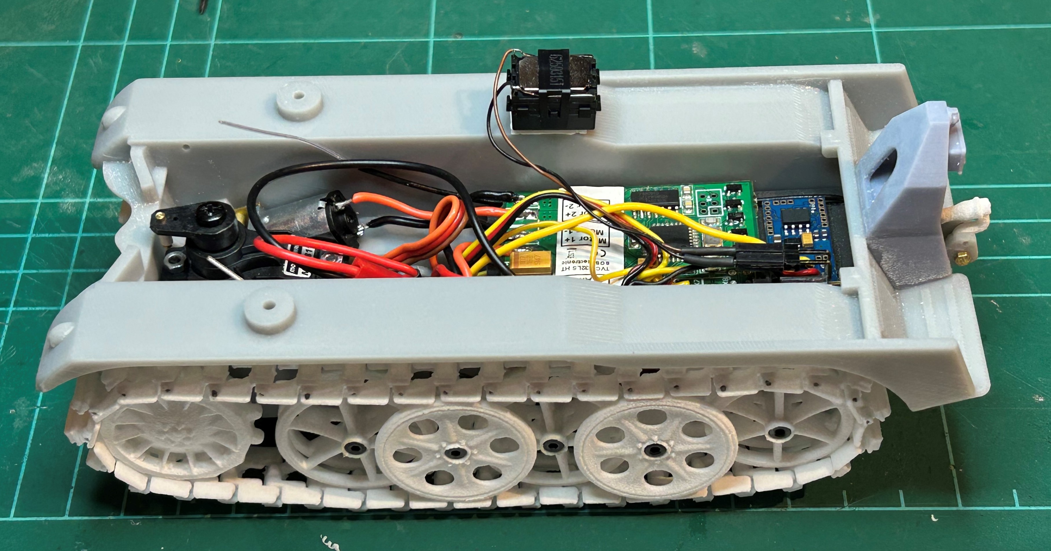

Kettenkrad
The newest built, so this is not ready build, waiting until electrical work is done.
