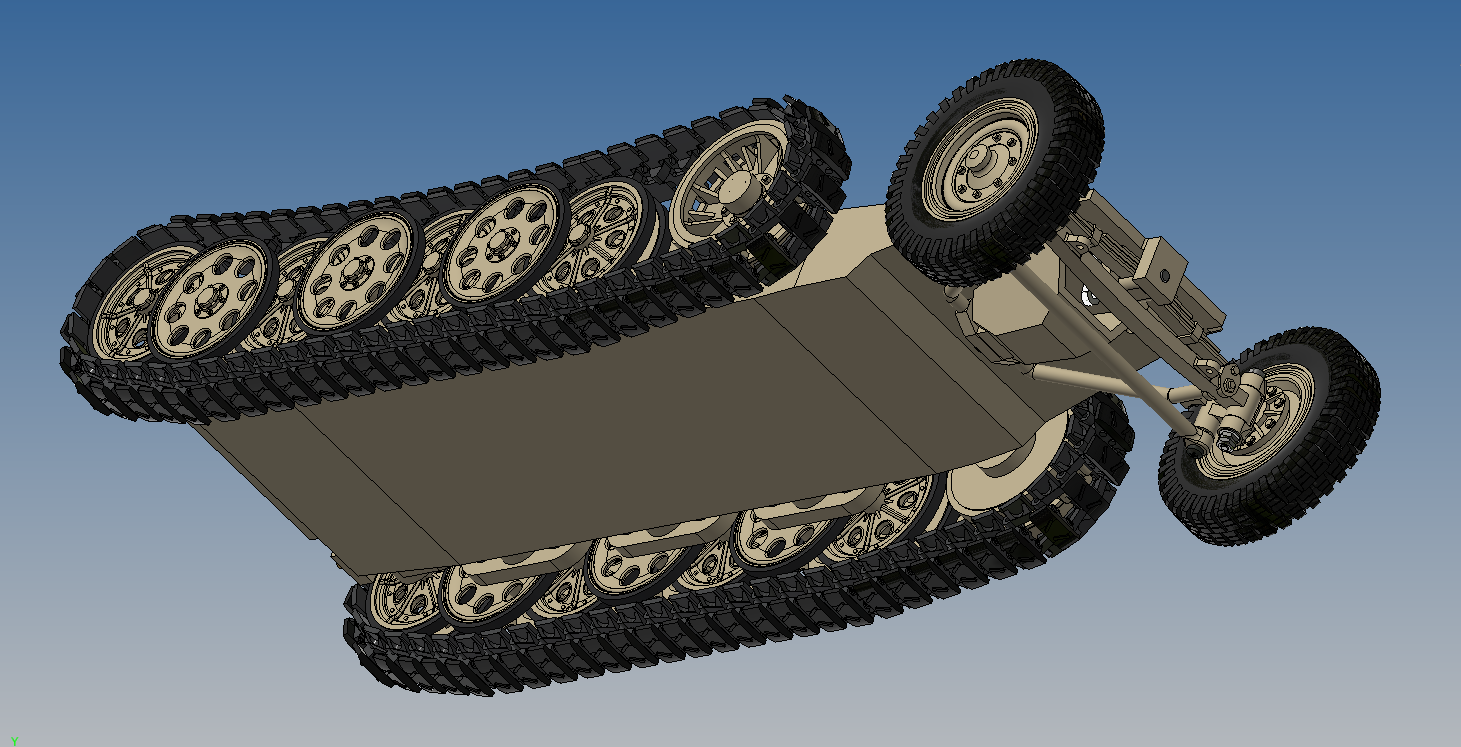

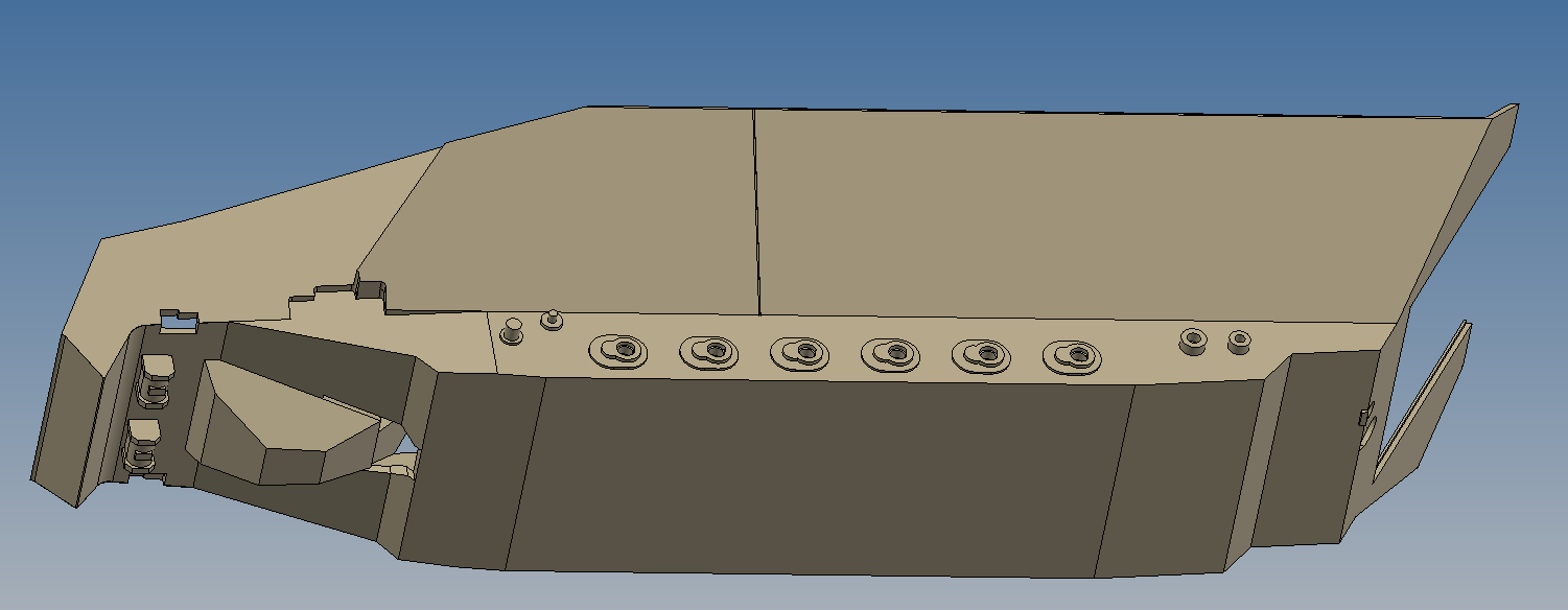

Trumpeter now released the 1/16 Sd.Kfz. 251 Ausf. D and many have the kit already at home. Some had hoped that the model could be converted (easy) to RC, but the longer the more disillusionment spread.
I also got the kit and wanted to see, if and how a conversion to RC would be possible.
First I measured and made a drawing of the lower hull
and this is what came out:

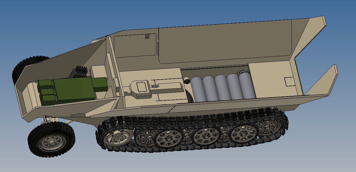

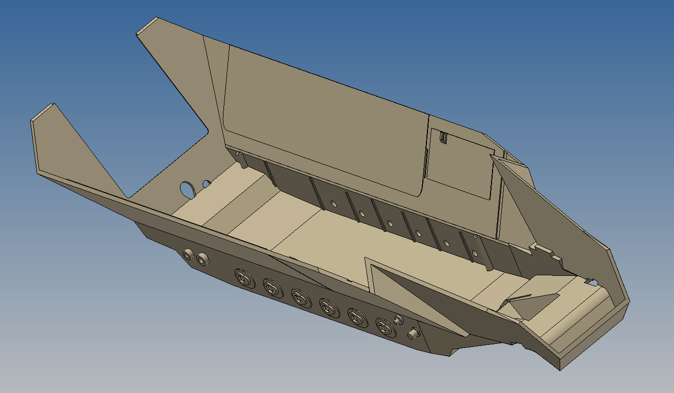

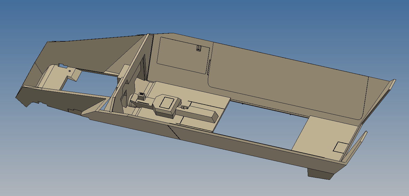

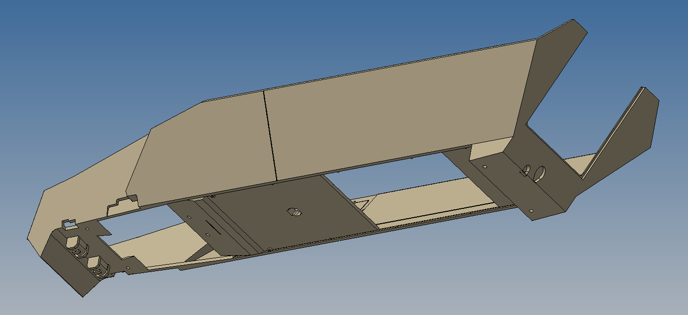

the lower hull have to be reworked below

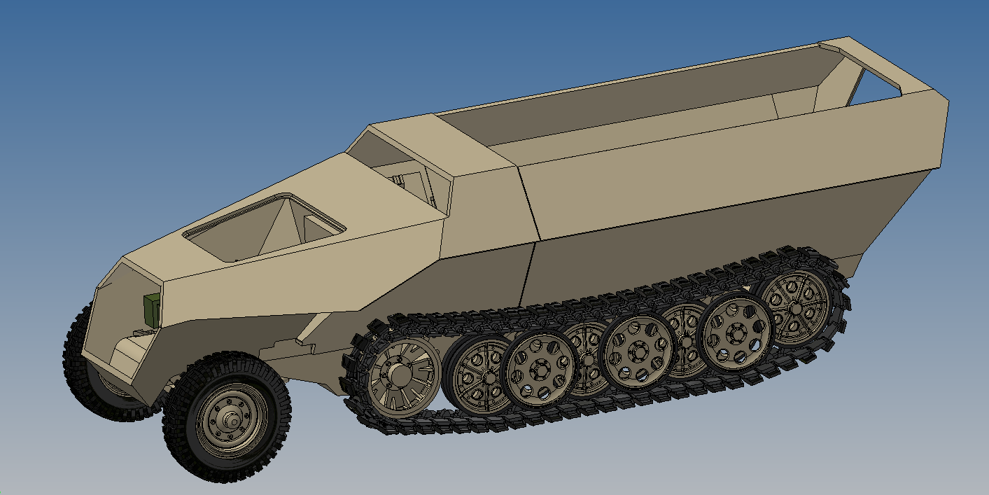

it will fit and looking like that:

:thumbup: I see a challenge with the promise of a fine model. :think: Do you have in mind a specific MFU? Will you reinforce the lower hull in some way? Will some of the front steering have to be reinforced or remade?

Herr Dr. Professor wrote: Thu Aug 17, 2023 1:27 am :thumbup: I see a challenge with the promise of a fine model. :think: Do you have in mind a specific MFU? Will you reinforce the lower hull in some way? Will some of the front steering have to be reinforced or remade?
Oh, I forgot to mention that all parts at this picture will be new and printed respectively (the hull is stiff designed, so no additional reinforcement will be necessary) :
Also the tracks are printed, but the metal tracks from Asiatam will fit with the suspension too.
The MFU will be this one (especially created for half tracks):
https://sgs-electronic.de/webshop/produ ... -s-32ls-ht
I have already run the suspension several times some time ago.
