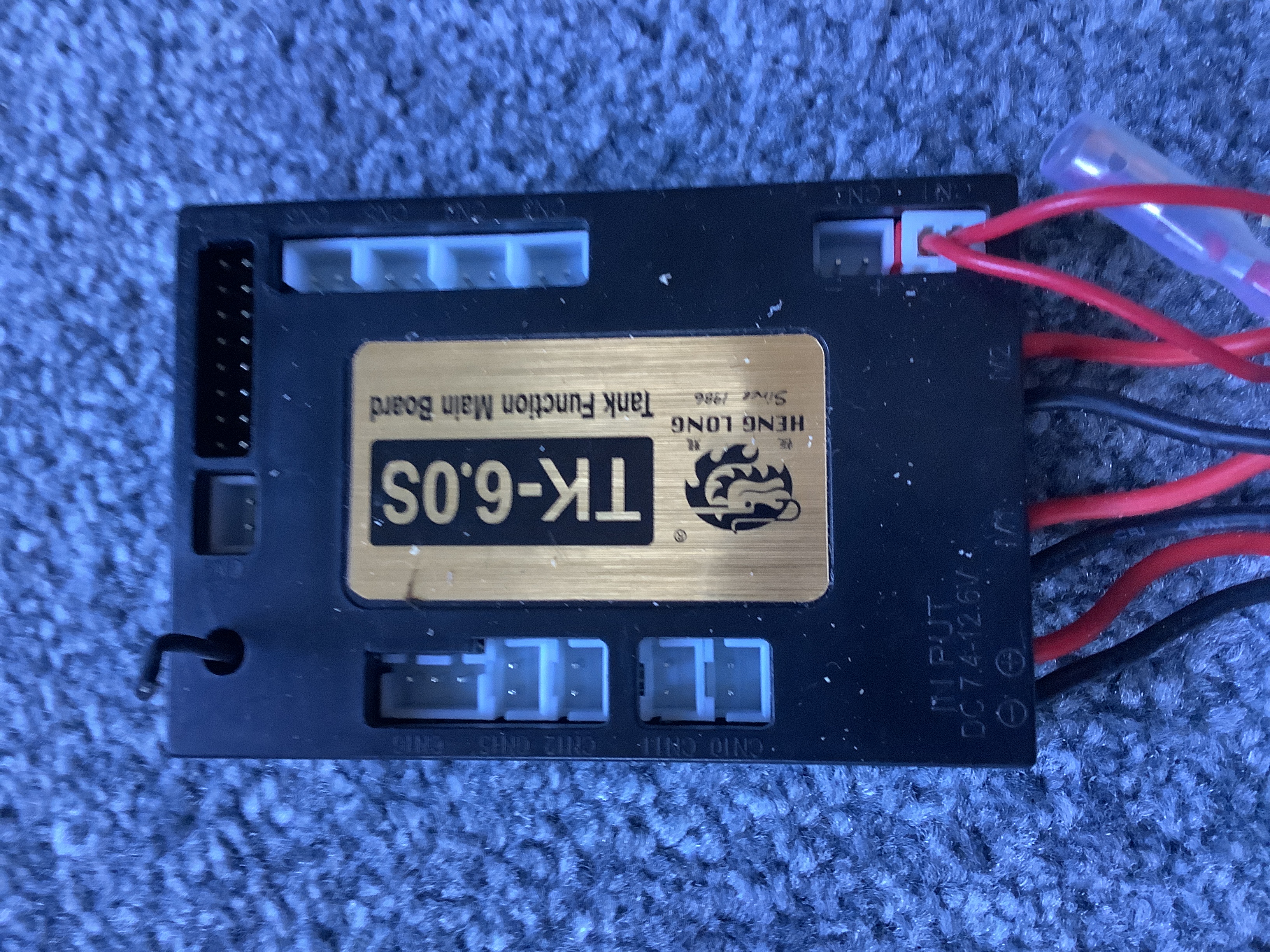

Thank you both. Tried Jofaur86, with some interesting results. CN4 is the turret turn motor. So connected it to CN10. Worked that out myself, with some even more interesting results.
John1970, I have a spare TK6.0 which I wanted to use in this tank. I was confused about the three wire, and assumed, quite wrongly that I would need a servo out put. Would I connect the blue wire straight to the battery neutral, for testing purposes? Do you know which is the live on CN10?
I think it is the right pin as orietated..Is there a simple way of confirming the live, as I do not have access to any test equipment?
Regards Ian

The live is on the left as your picture orientation towards the outside of the board. The earth is on the right towards the inside.
look at the wiring diagram i posted before its not very clear if your not sure what your looking at but the white wire on the diagram is the earth so when it plugs in, it will be on the inside of the board.
The blue wire straight to the battery negative black wire.
