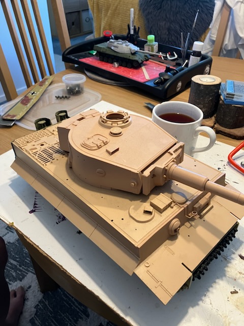

Because I have nothing to loose, the Hobby Boss Tiger was exhumed from the loft, and careful :haha: measurements were taken. It looks like it will fit.

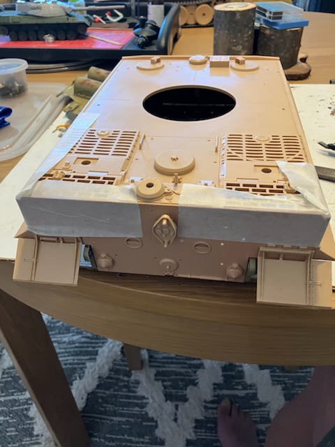

Grievous butchery, involving knives and saws, saw most of the Tamiya upper hull, and rear panel removed.
The rear panel from the Hobby Boss was grafted in and glued in place. Surprisingly it seems to fit. I will need to devise a method of holding the upper hull on. Possibly a slot and magnets.
And a selection of parts salvaged which may be of use, later.
Regards Ian
