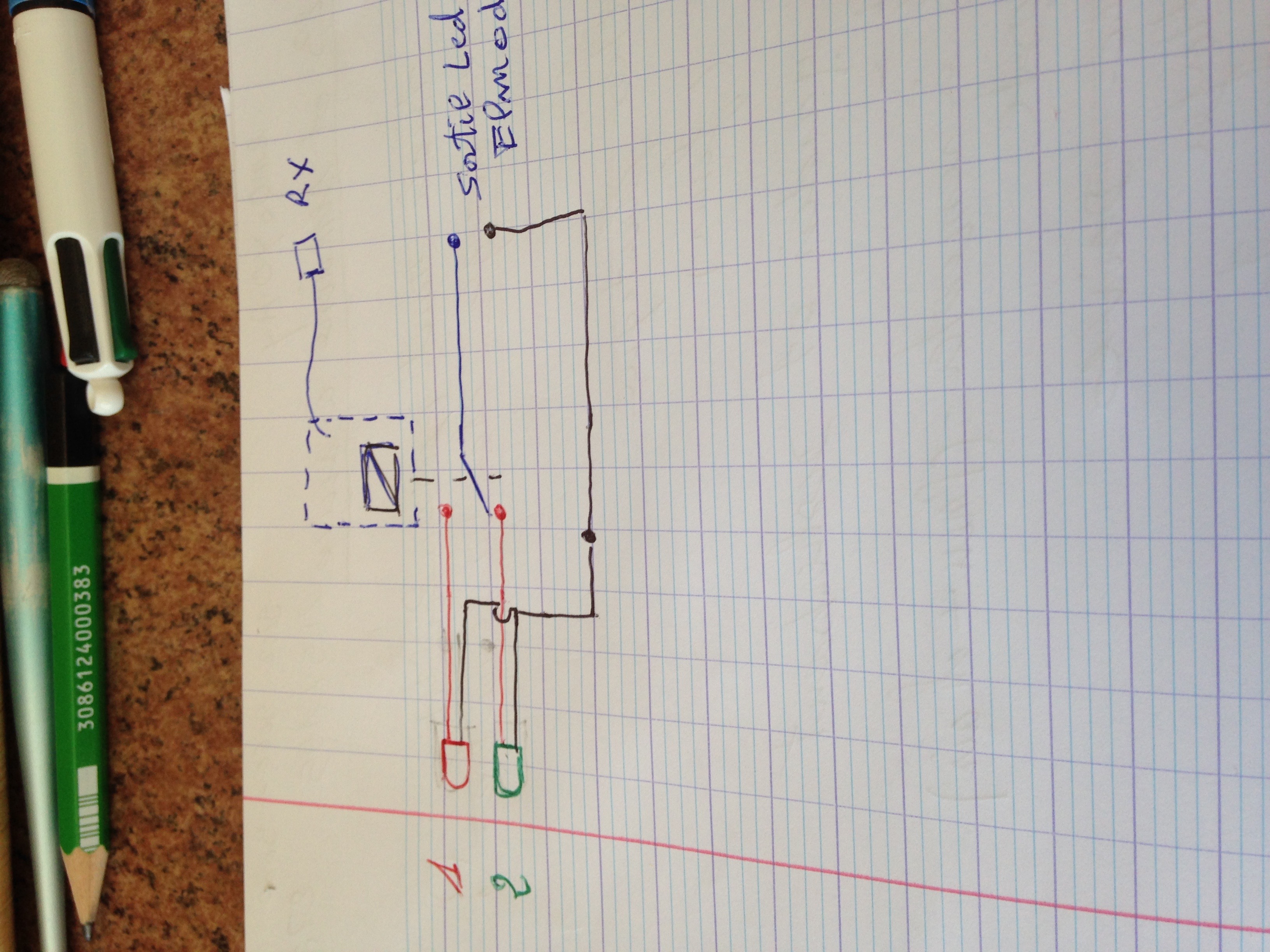

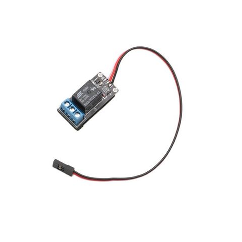

Jofaur86
- Posts: 2208
- Location: Centre France
Re: Main machine gun and aux LEDs
You can do this, but you have to do some engineering
you can fire either machine gun, but not both at the same time. inverter relay,on "Aliexpress"
Sherman1981
- Recruit
- Posts: 22
- Joined: Sun Mar 05, 2023 5:39 pm
Wow amazing. Thanks v much for your help. Ok I’ll check this out. That could do the job for the two LEDS.
As long as I can separate the two machine gun LED’s and sound to two switches then mission accomplished..!
