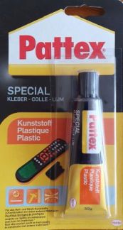

A bit late to this thread, but, if you can get it, I have found that this worked very well with the ABS used in many tanks, and makes for a strong bond. It needs a bit of care, as it will dissolve and damage a plastic surface if spilt. I also originally tried polystyrene cement, but it was hopeless...
