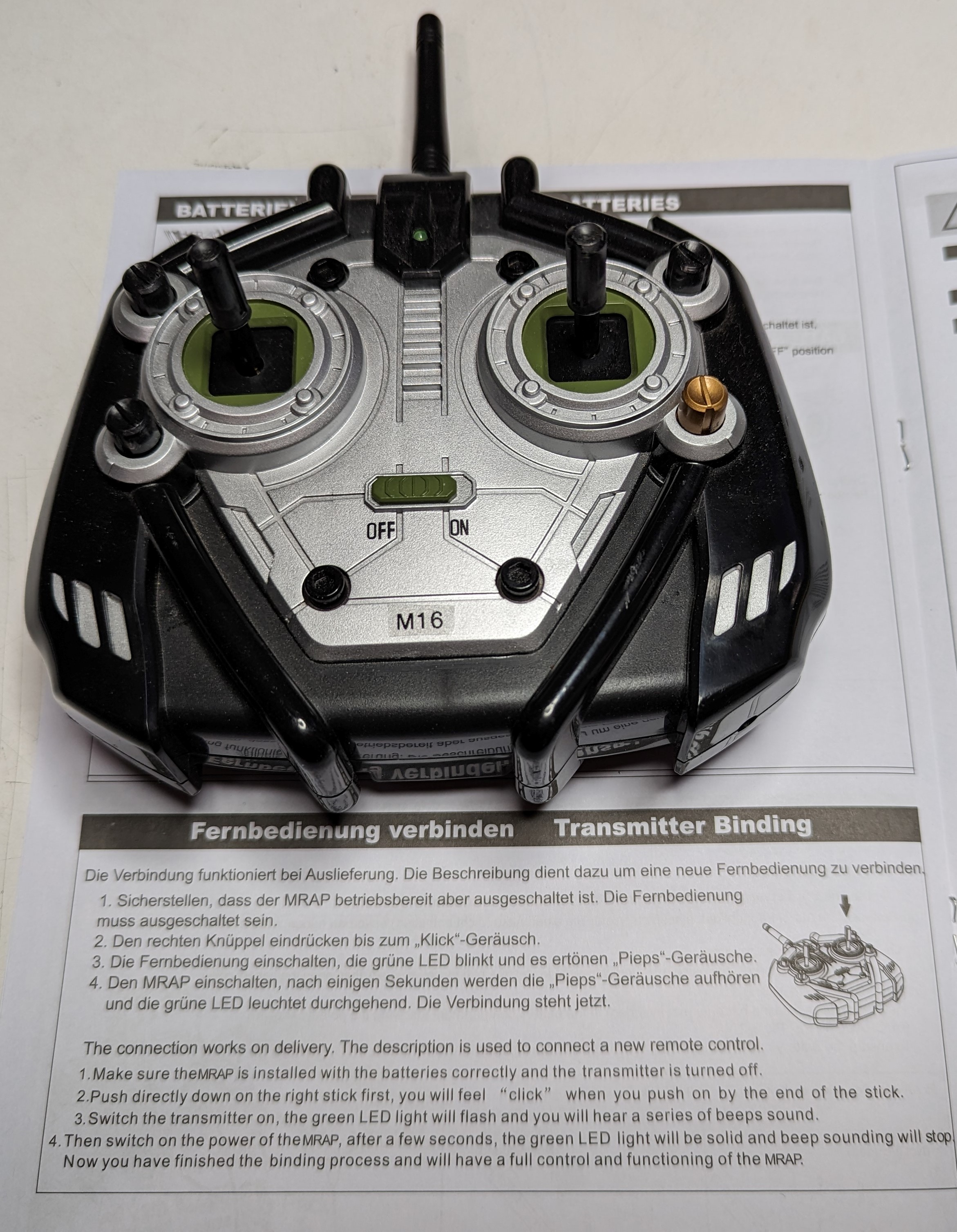

Folks, can anyone please post a pic of the factory out of the box transmitter to suit a Torro(?) M16 half track please.
And if possible, the binding method.
Have one with no transmitter and the pile of options is enormous.
Be handy to narrow down the options with a picture.
The web sites seem to focus on the model itself rather than the transmitter.

I'll see if I can find the documentation with mine when I get home from work. There are actually two possible transmitters for these half-tracks. I believe one of them is FM and the other is 2.4Ghz. The original WSN release of the half-track used the FM transmitter. My 2.4Ghz version looks like the attached pic.
download (1).jpg (5.34 KiB) Viewed 337 times
