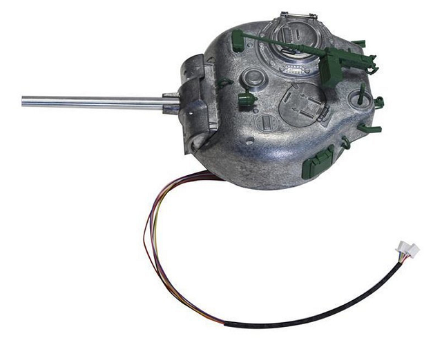

There are few options. Easiest (but costly) ist to change whole turret for Taigen one. There are BB and IR version available.

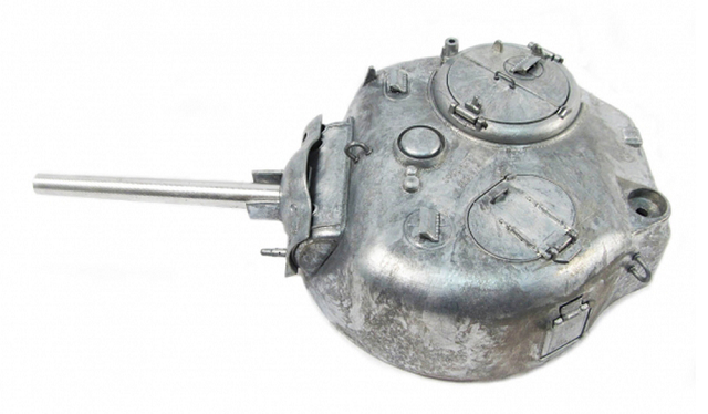

Or Mato turret if tou want ealier "low bust" turret with early split hatch. Only note that it's using servos.
Guns in both turrets are slightly oversized but it's close enough.

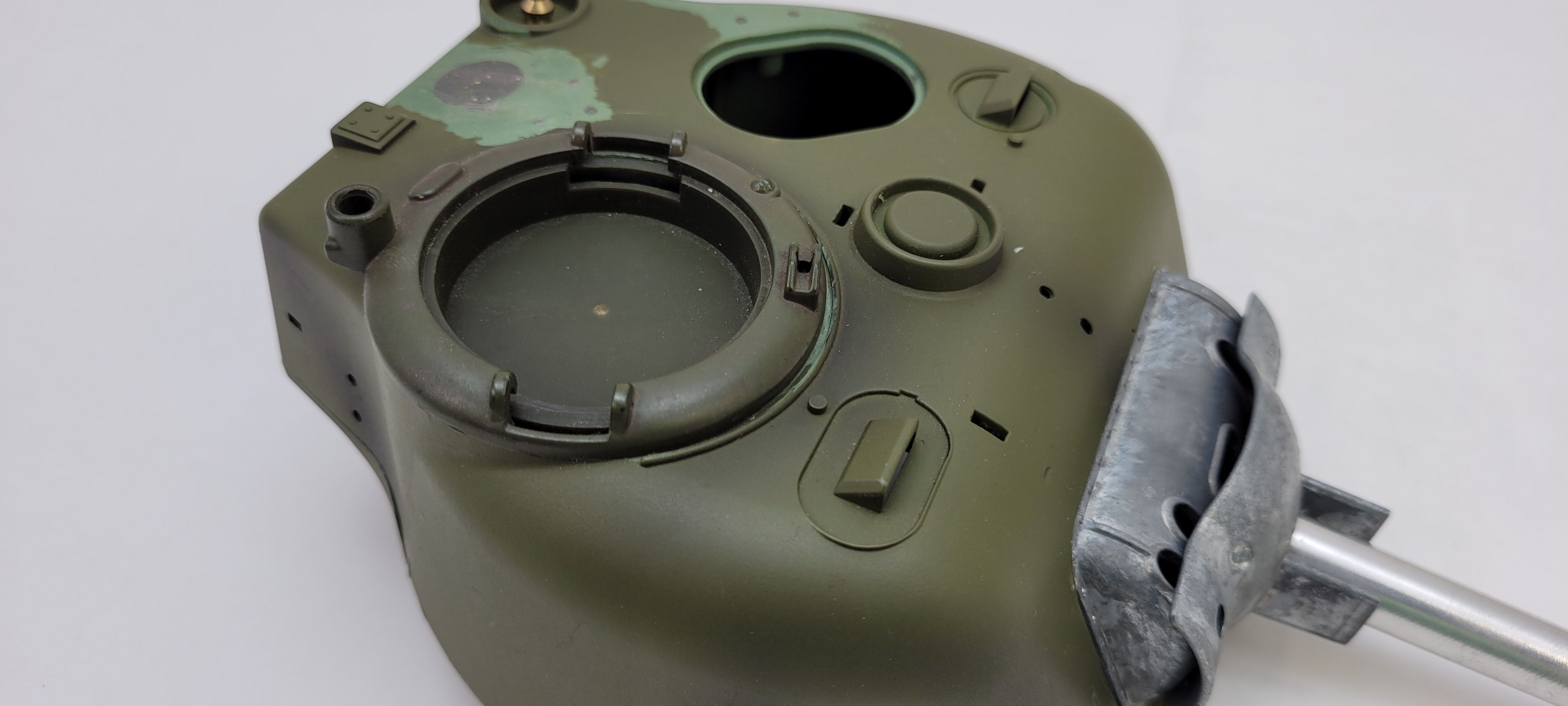

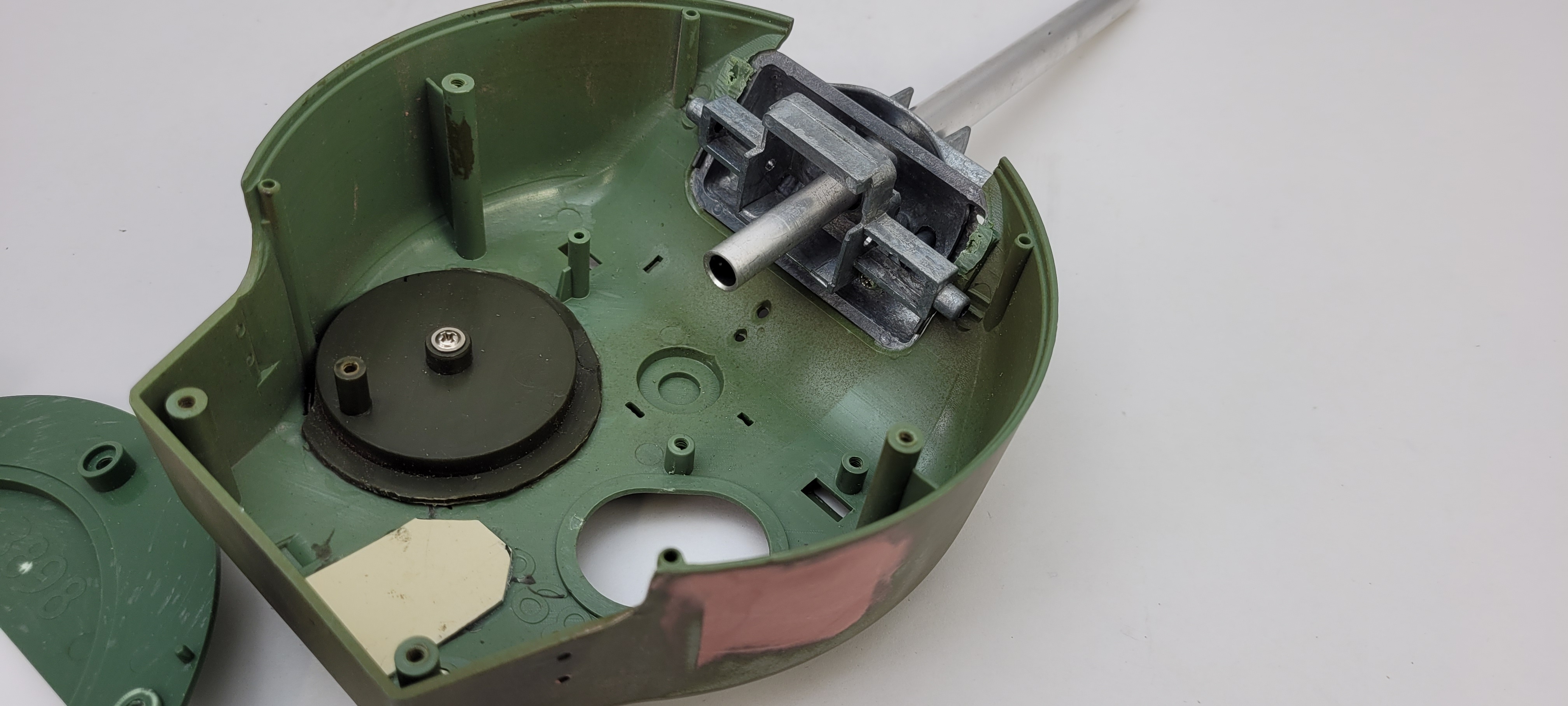

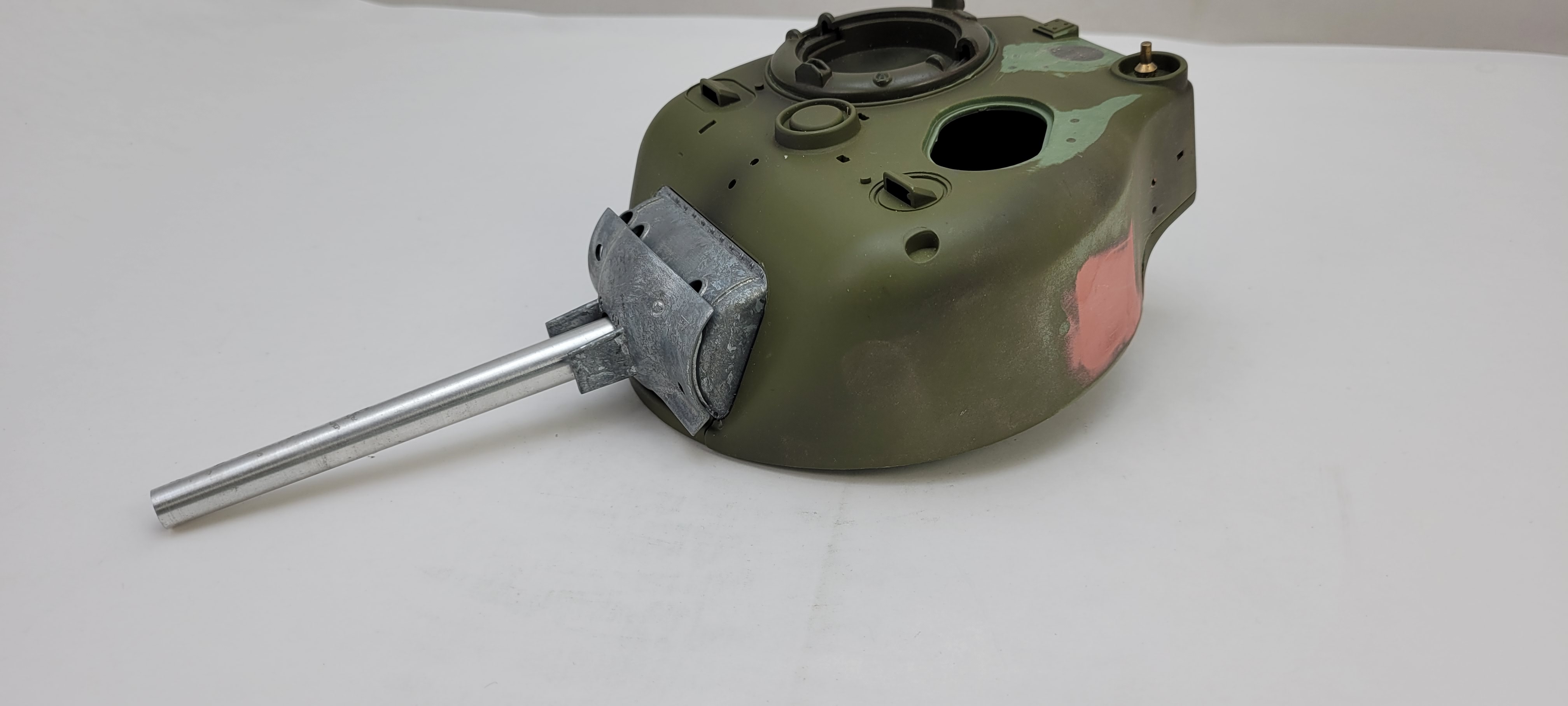

Somebody else a while back was looking to do the same, the link above shows the mato gun and mantlet that is available to purchase, the picture there shows the conversion I did using those items, hope this helps

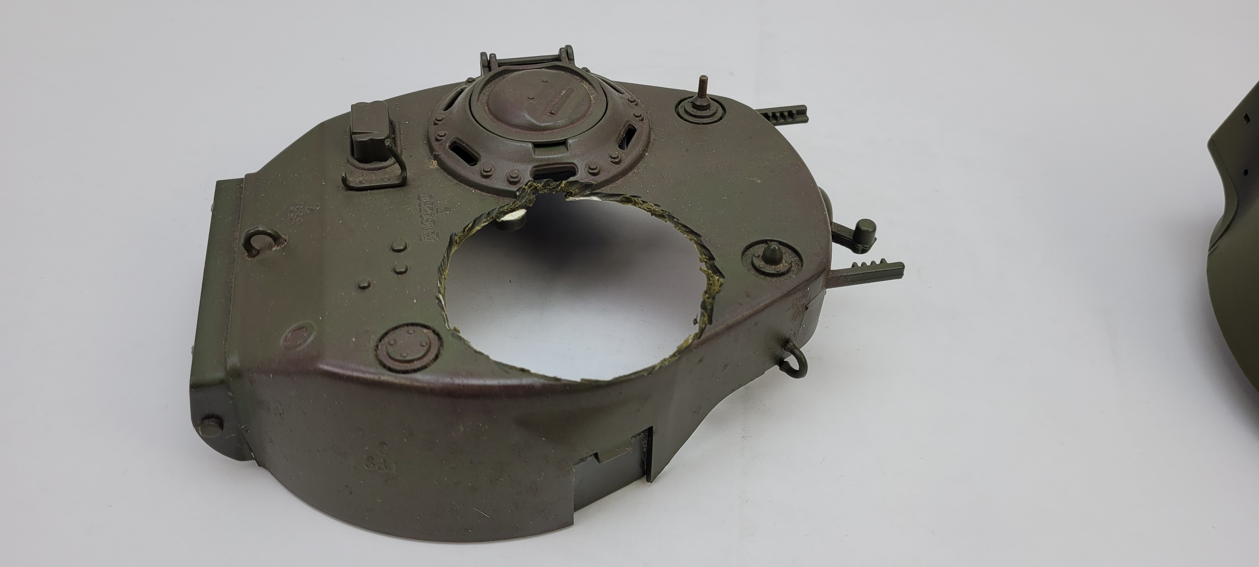

I'm working very slowly on a Grizzly-ish M4. Having grown up in Montreal, Quebec, it seemed only right to create a tank made at the Montreal Locomotive Works. I'm using an old Mato M4A1(76) that had been rid hard and puttaway wet by its PO. I'll need to convert the hull to a small hatch version I believe--it's been awhile on this one so I'll need to re-research things.
The Mato turret had its split hatch turret removed and installed on this new turret from Mato. Grizzlies had no loader's hatch or pistol port so they have been/will be filled in. The metal Mato mantlet has been installed and will need pivot points grafted in, then recoil and elevation added. At this point, that is kinda pushing my fabrication boundaries but that'll come in good time. Or...I might just buy the Mato metal turret shown above by Kaczor and get on with life!
