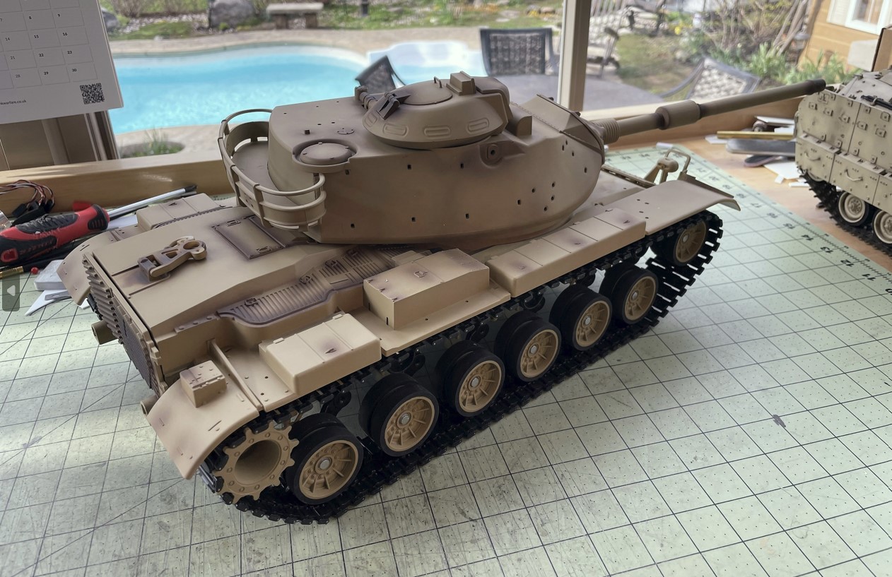

Hi everyone,
My latest build will be a US M-60A1 tank of the Gulf war period.
1/16 RC USMC M-60A1 US tank with ERA - Build
Screenshot 1.jpg (278.26 KiB) Viewed 16664 times
The M60 is well known US tank of the cold war period and does not need much introduction. It never served in Vietnam and the USMC variant equipped with reactive armor is one of the interesting version to model.
Screenshot 2.jpg (308.3 KiB) Viewed 16664 times
Screenshot 3.jpg (86.98 KiB) Viewed 16664 times

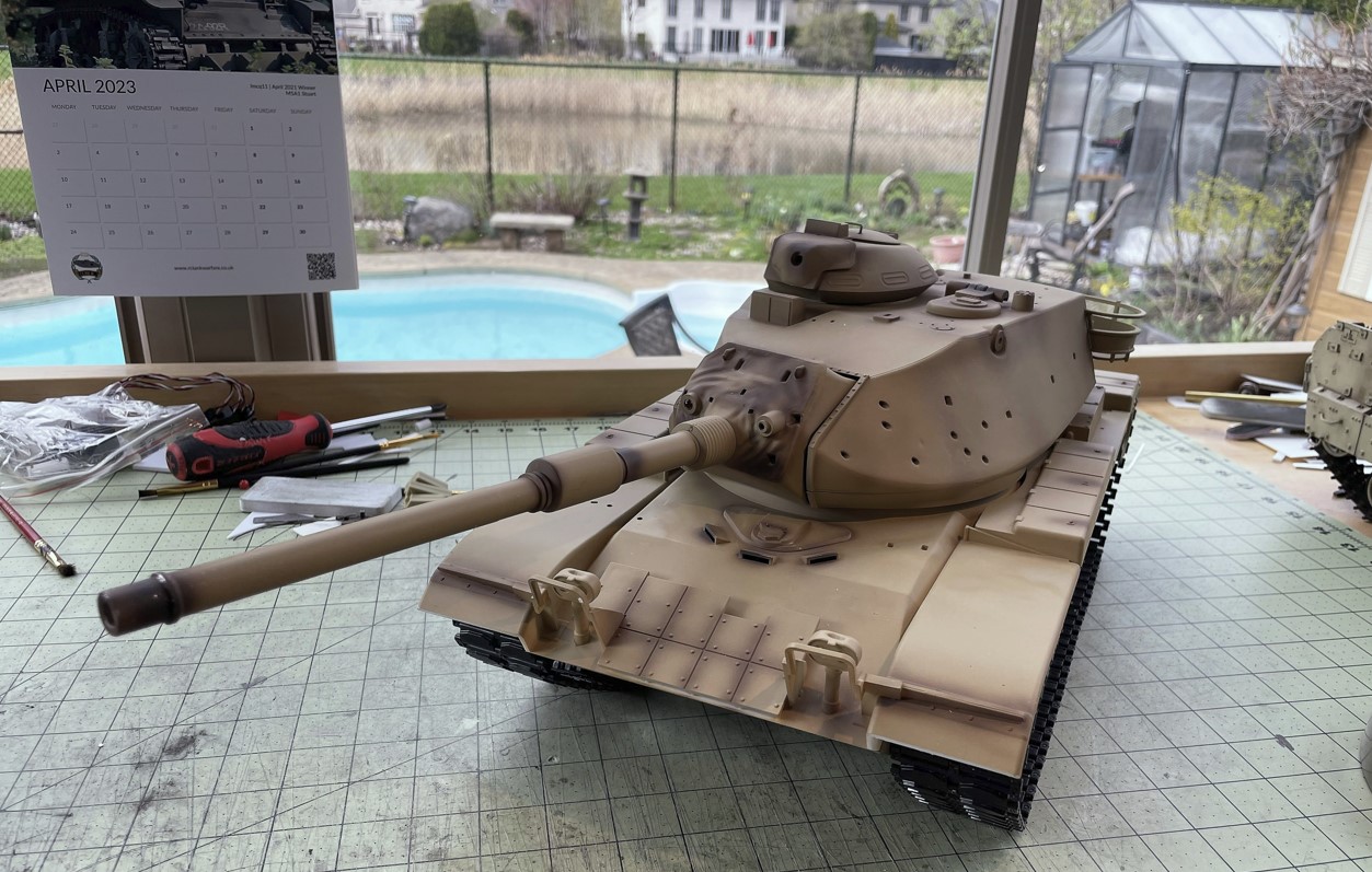

At first sight, there are a number of structural and cosmetic items to take care of and the list of modifications is growing.
Screenshot 5.jpg (271.55 KiB) Viewed 16664 times

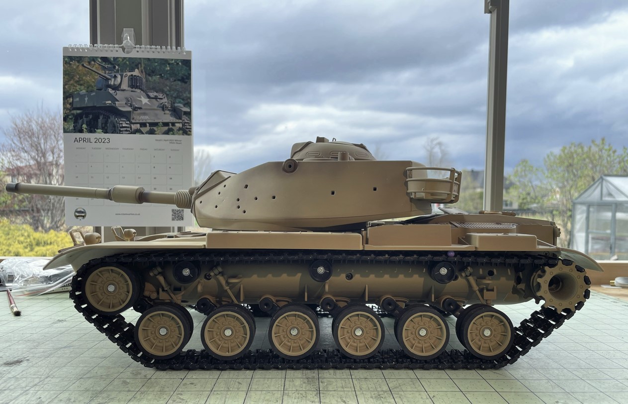

Screenshot 6.jpg (279.23 KiB) Viewed 16664 times

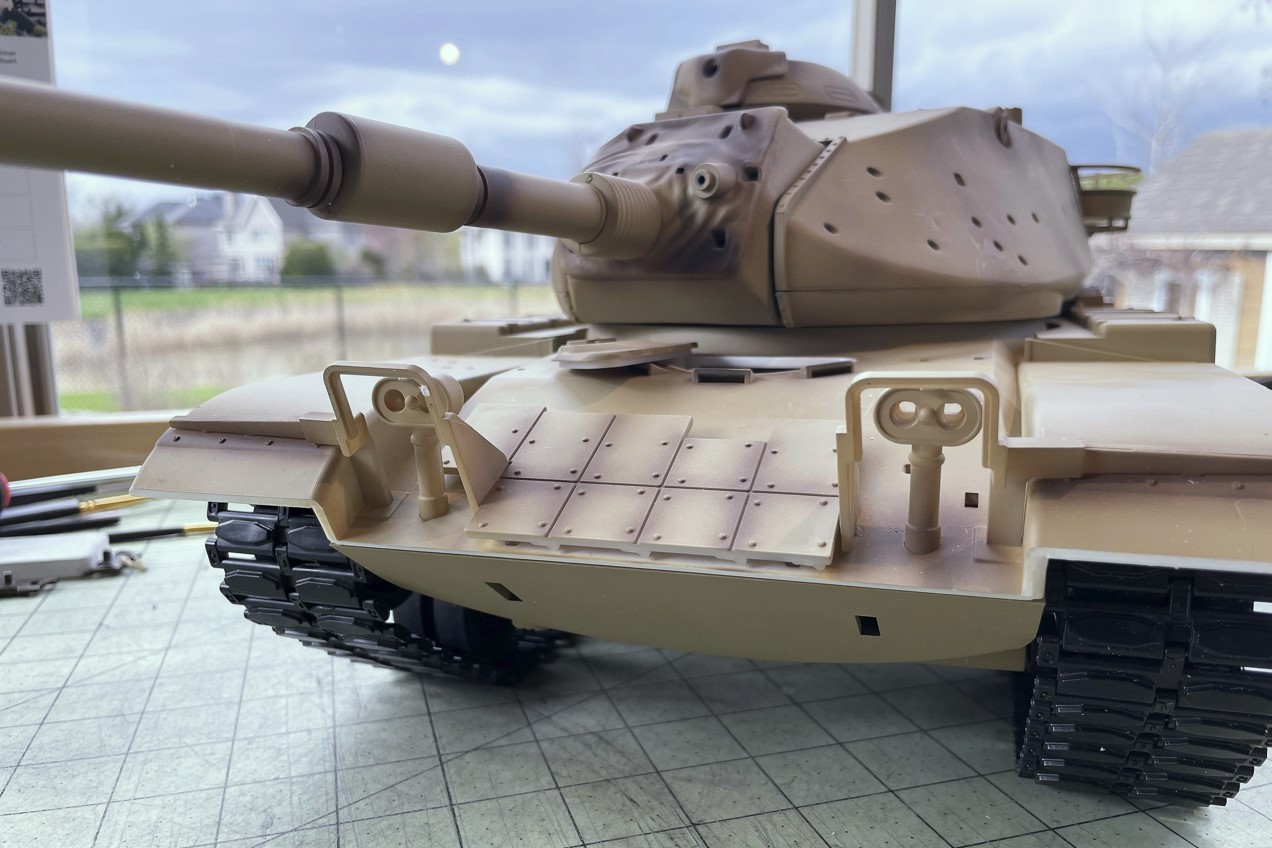

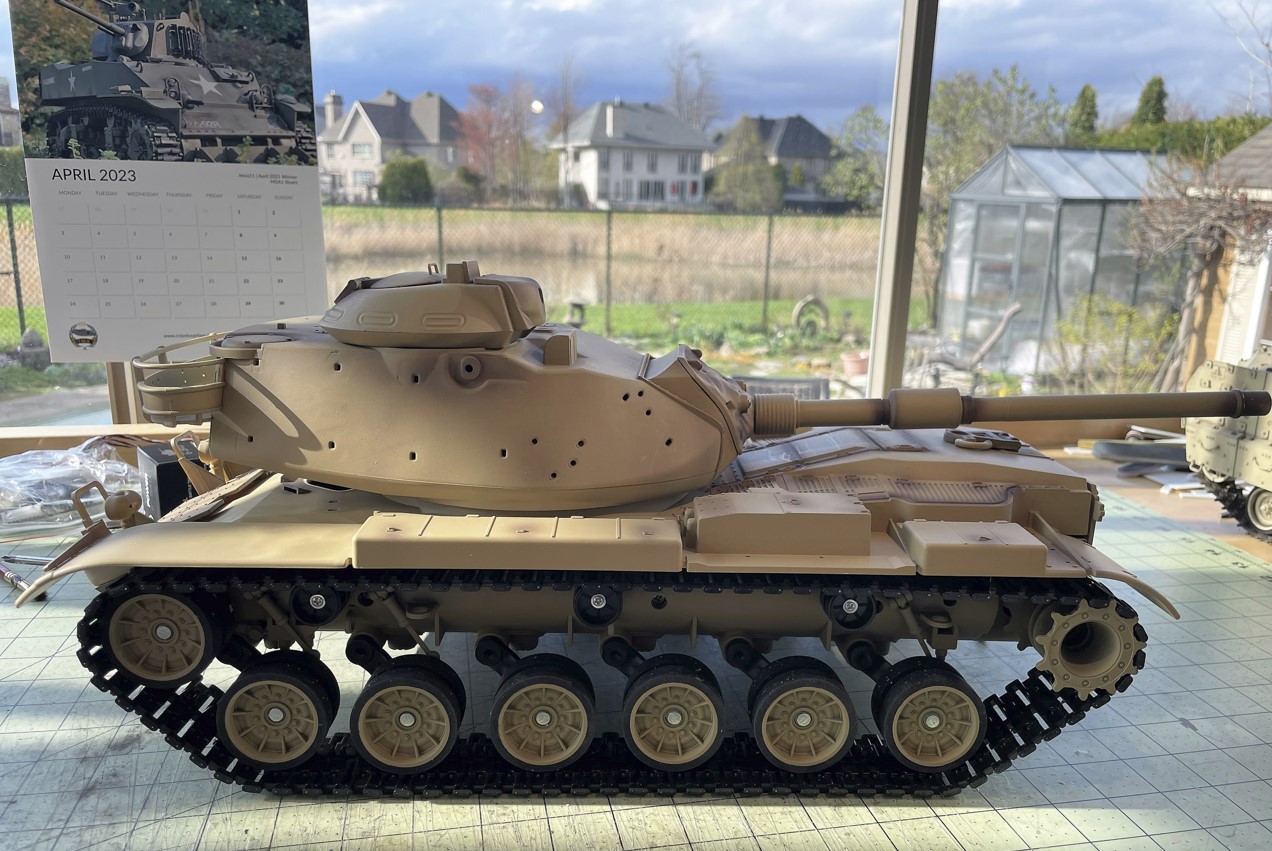

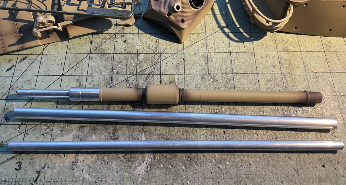

The metal gun barrel with plastic cosmetic detail is definitely oversized. It seems that TONGDE has installed the 120mm barrel of an Abrams on the M60. Instead of having 3 separate barrel sections with a diameter of 9mm, 15mm and 11mm, the barrel sections are 11.5mm, 19mm and 13mm. More on this later.

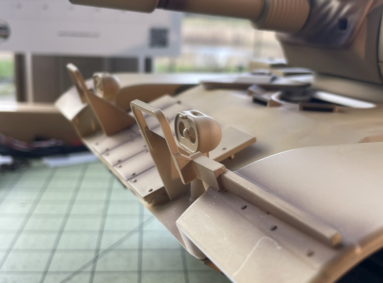

The second striking issue are the setup of the raised headlights and guards, and the shape of the ERA blocks on the glacis.
Screenshot 7.jpg (187.16 KiB) Viewed 16664 times

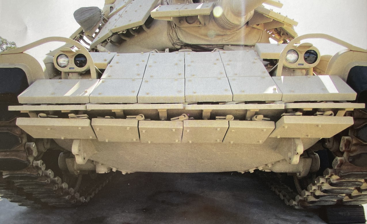

A regular M60A1 glacis and headlights should look like this.
Screenshot 7a.jpg (235.76 KiB) Viewed 16664 times
It did not take me long to understand that TONGDE modelled the glacis on the M-60A1 version with dozer blade as shown below. Although pretty accurate, the model however does not come with its dozer blade and mount... Very sad as it would have been cool. Maybe they wanted to provide it during the design phase but changed their mind.
Screenshot 8.jpg (171.05 KiB) Viewed 16664 times
This will need correction as it really makes the model look weird or incomplete.

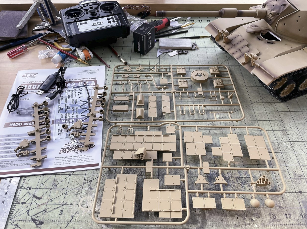

These are the accessories coming with the M-60A1. Sadly, no spare track links. Most of the ERA blocks are provided. I did not check the accuracy or their dimensions yet but some are missing and will need to be crafted.
Screenshot 9.jpg (406.34 KiB) Viewed 16661 times

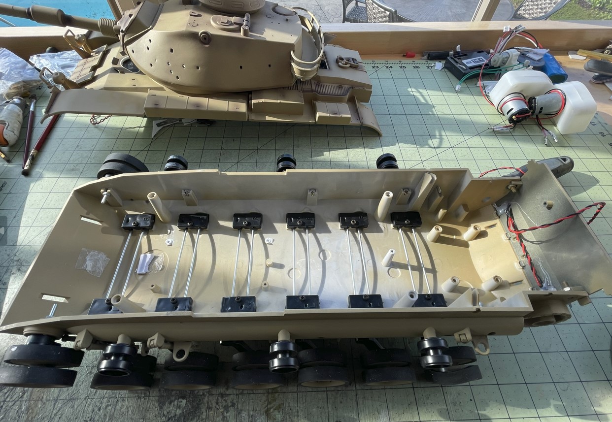

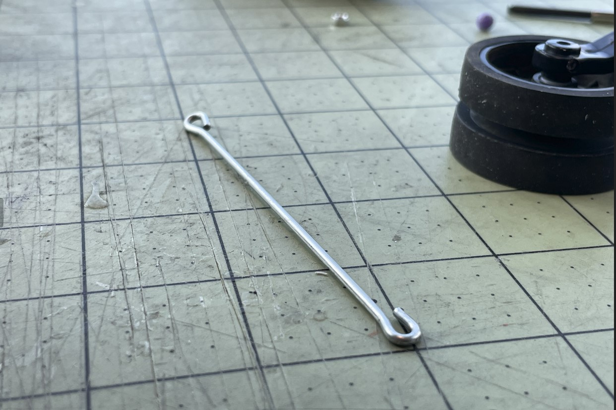

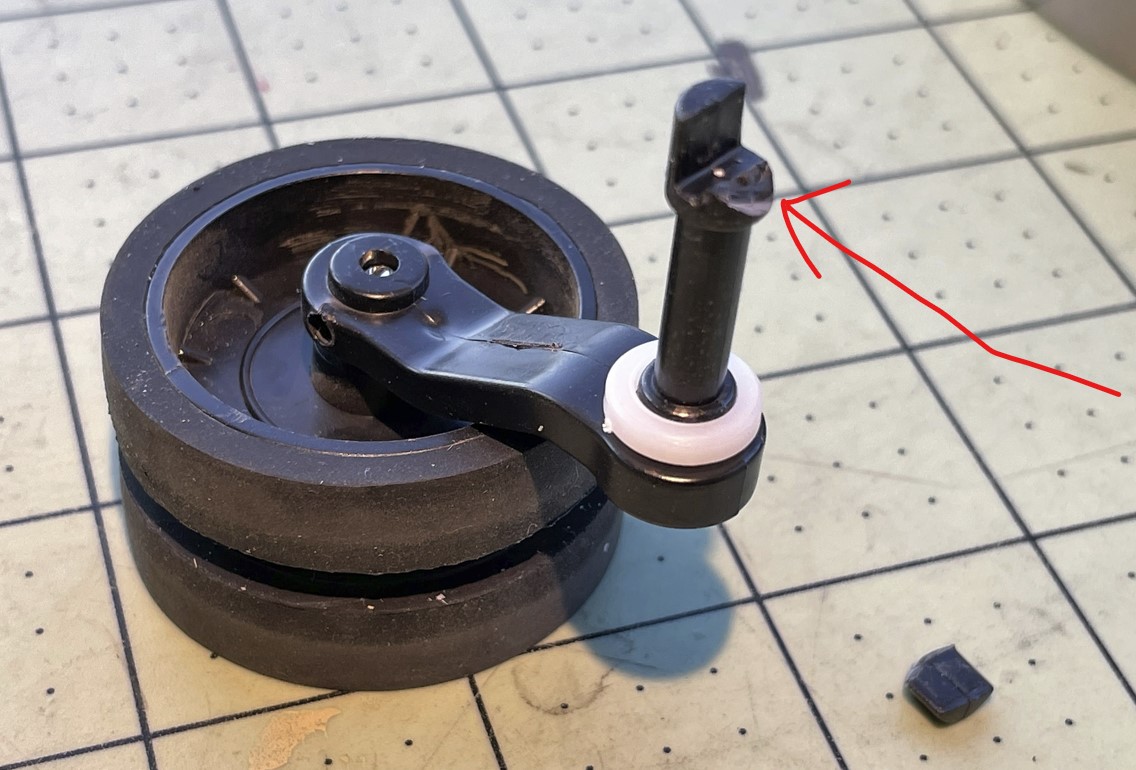

The plastic suspension arms are really weak. I wanted to see the situation before ordering the TONGDE metal upgrade kit, but its availability is limited and spare parts are still non existant, which is an issue at this time. The road wheels have rubber bands.
Screenshot 11.jpg (205.04 KiB) Viewed 16661 times

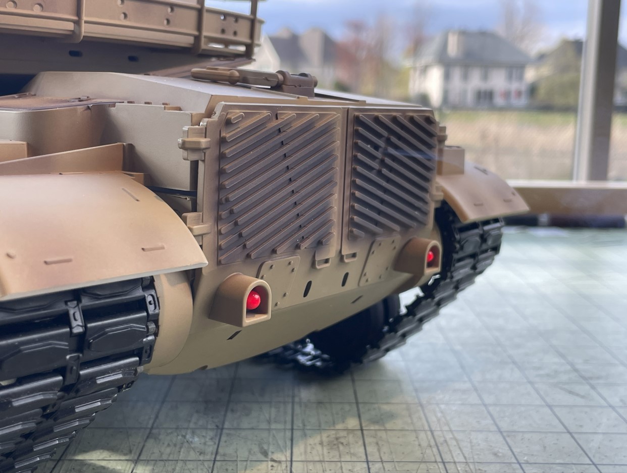

The rear grill does not have the right number of blades, and the upper hull locking mechanism is weak and there is a gap at the back, needing correction.
Screenshot 11a.jpg (190.81 KiB) Viewed 16661 times

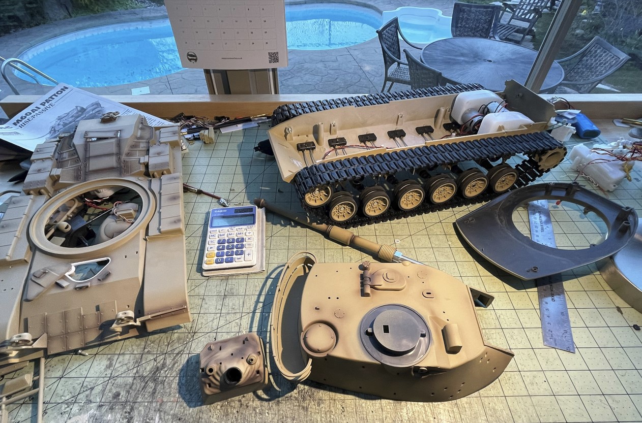

Interior view upon opening the hull. Things have moved a lot in transit. Someone somewhere before i got it plugged the charged battery on the electronics and left it there. That is a big and dangerous fire hazard in my view. I never leave batteries connected to electronics when not attended, and specially during transport where anything can happen.
The turret is equipped with a BB gun. I hate these things. It will be removed and replaced by a recoil system. I did some test and the model works well.

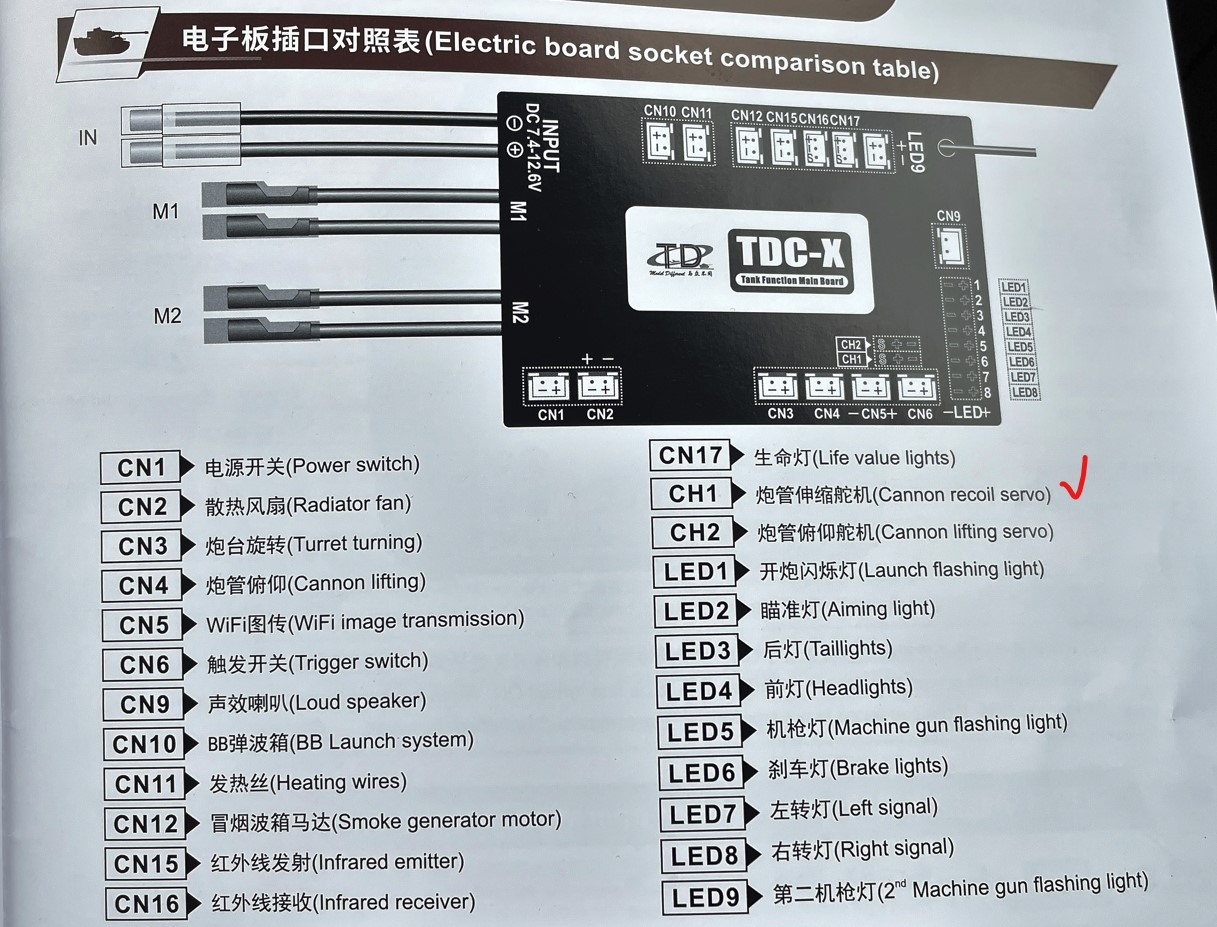

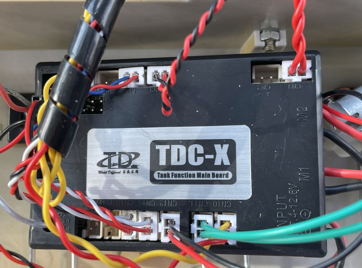

Close up of the control board. I do not know what it is. Not sure yet if i can reuse it with a recoil system or need to replace it.
Screenshot 13aa.jpg (219.92 KiB) Viewed 16661 times

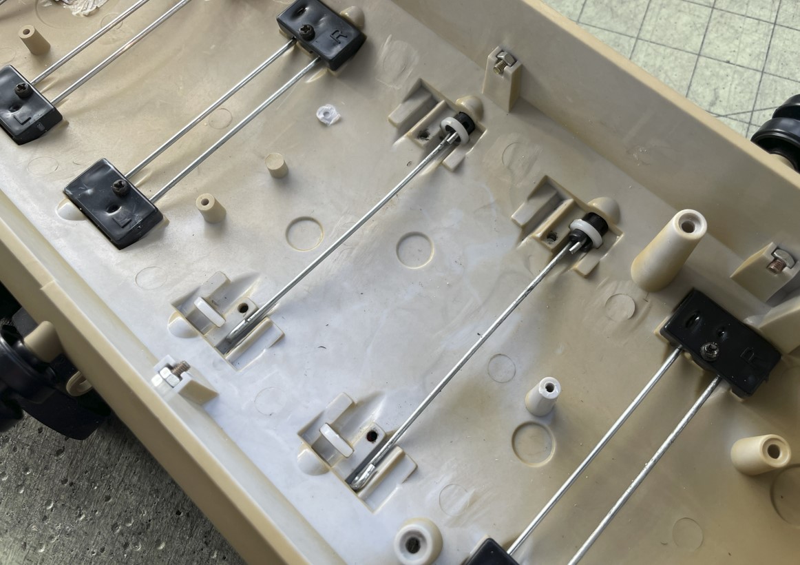

Close up of the torsion bar suspension.
Screenshot 13aaa.jpg (285.06 KiB) Viewed 16661 times
Screenshot 13b.jpg (159.95 KiB) Viewed 16661 times

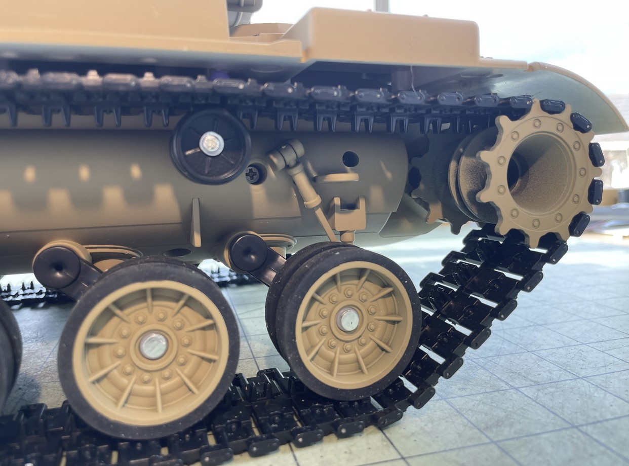

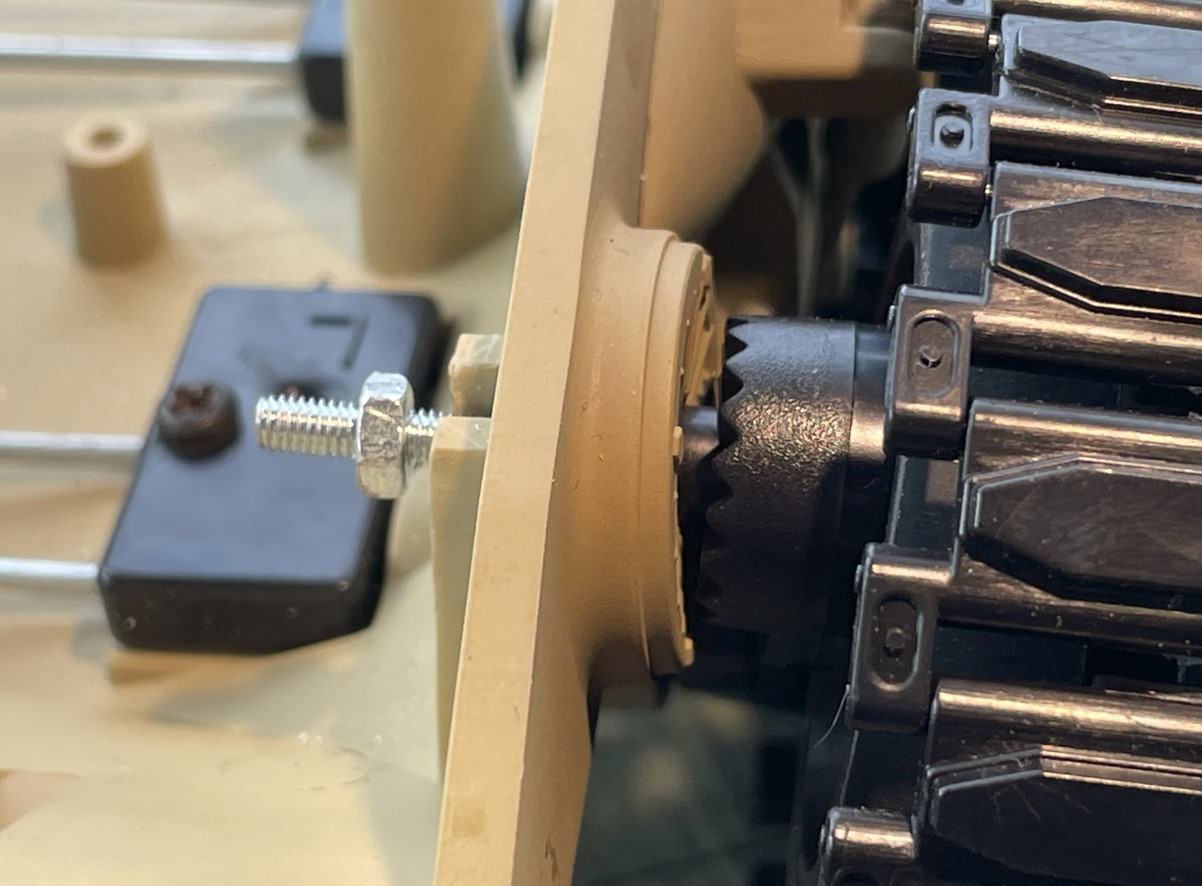

Checking out the suspension. The suspension arm has no stop. Meaning it is only controlled by the torsion bar.
Screenshot 13c.jpg (181.13 KiB) Viewed 16660 times
It is therefore the twisting of the torsion bar by the assembler at the factory that decides on the height of the model. You can see the bar was given a light twist. The height of the tank can be adjusted by twisting the torsion bar with a pair of plyers, in one direction or another. What is difficult is to make all of them the same.

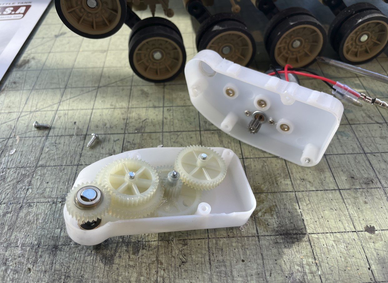

Interior view of the plastic gearbox.
Screenshot 15a.jpg (263.14 KiB) Viewed 16660 times

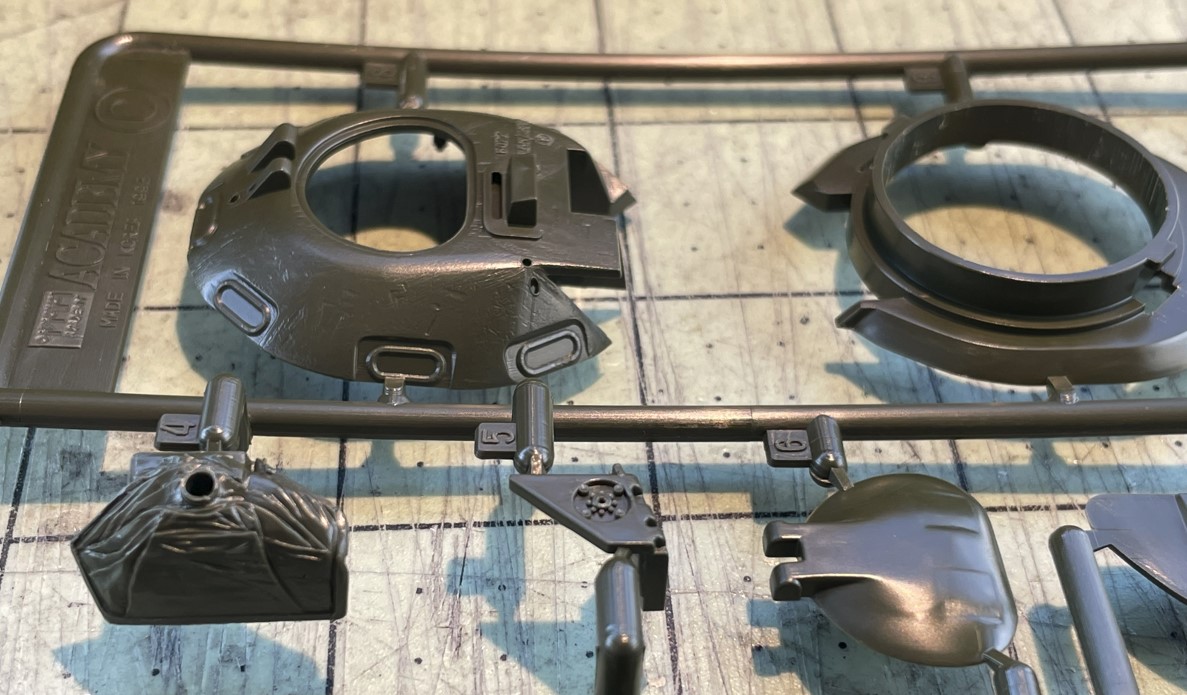

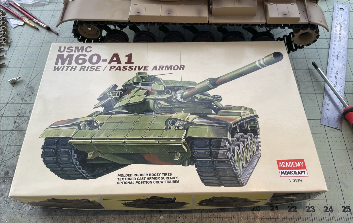

Also interesting to have for dimensions, placement and details is the Academy 1/35 kit of the USMC M-60A1.
Screenshot 18.jpg (262.33 KiB) Viewed 16660 times

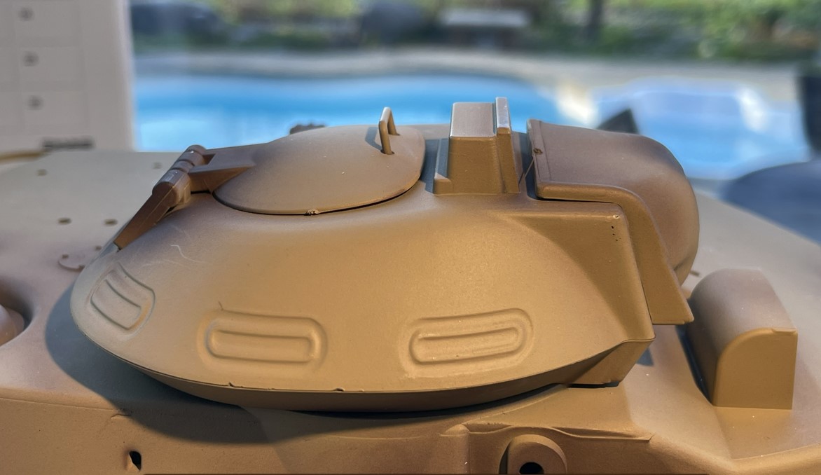

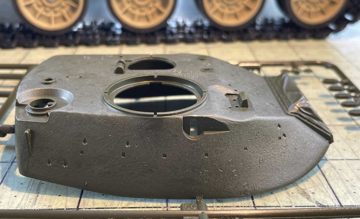

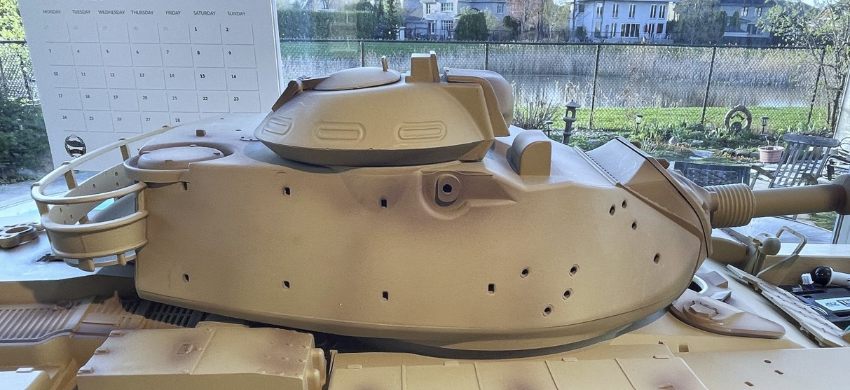

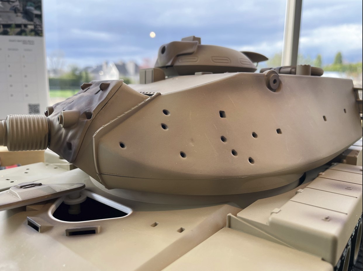

Comparing the shape of the cast textured turret of the 1/35 kit with the TONGDE model. It looks like an M-60 turret...
Screenshot 19.jpg (232.27 KiB) Viewed 16660 times

Comparing the cupola, it will need a lot of improvements.
Screenshot 21.jpg (193.49 KiB) Viewed 16660 times

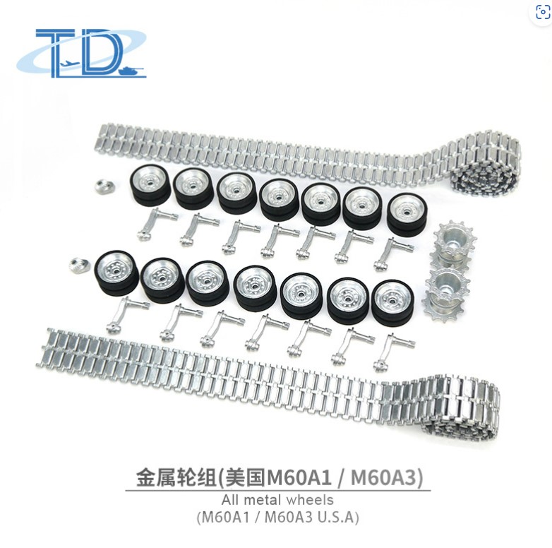

On the standard TONGDE model, the plastic suspension arms are really weak and are easily broken just by touching them. I did not expect this and when i manually activated the suspension on the model to see and test how strong the torsion bars were, i broke two of them. I was hearing a clicking sound inside the hull and i thought it was something else until i saw the arm losing all tension. With no availability for spare parts, i moved these broken arms to the middle of the vehicle. And while switching the arms, i broke another one, so i now have 3 broken suspension arms in 10 minutes... This is ridiculous. I will definitely need the metal upgrade kit if i want to make this model something else than a static shelf queen.
Screenshot 23.jpg (174.59 KiB) Viewed 16659 times

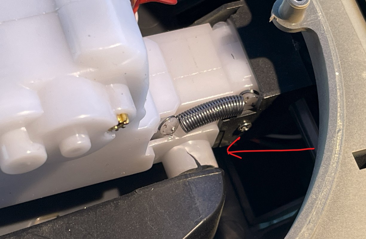

I also noticed the gun elevation parts are quite weak and should be replaced with better ones.
Screenshot 24.jpg (168.13 KiB) Viewed 16659 times
I mentioned earlier that the gun barrel coming with the model is too large in diameter and is more a 120mm gun than a 105mm. I check against references and also extrapolated 1/16 dimensions from the 1/35 kit. The gun barrel will be redone with aluminum tubing.
Screenshot 24a.jpg (73.89 KiB) Viewed 16659 times

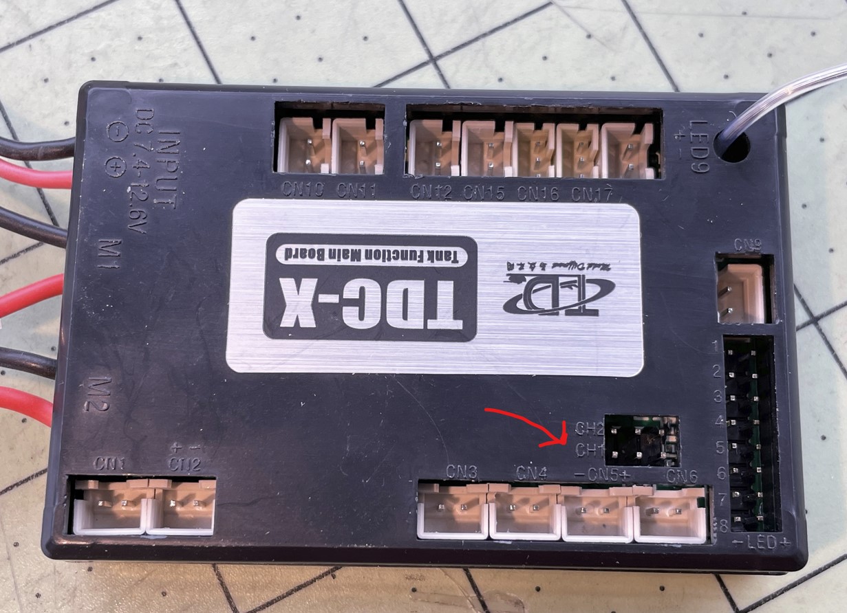

That control board looks like an H/L 6.1s
if you can take a pic of it without any wires in it I can check the socket layout and numbering against mine.

HERMAN BIX wrote: Wed May 03, 2023 1:00 am That control board looks like an H/L 6.1s
Here it is. Can someone help me ?
I am trying to use the servo recoil CH1 port but it does not work. When pressing the B+A button, there is a shooting sound, there is a flash but the recoil servo is dead. The only configuration step documented for the shooting is the T+B button. It deactivates the BB unit but it does not activate the servo recoil port. I think i tried everything. The CH2 for servo elevation does work. I also have purchased the TONGDE Centurion Mk5 (an upcoming project after the M60) and it is the same situation with the same board, so it does not seems to be a malfunction. There must be something i need to do.
Screenshot 1.jpg (240.44 KiB) Viewed 16543 times
Screenshot 2.jpg (281.63 KiB) Viewed 16543 times
Screenshot 3.jpg (298.7 KiB) Viewed 16543 times
thank you,
Louis
