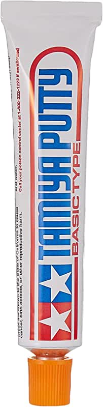

Tamiya white putty works well. You may have to fill the hole, let it dry, sand it with a very fine grit sandpaper (600 Wet or Dry works well), and fill it some more, as putty sometimes shrinks. (And, yes, there are and have been a few women here on RCTW; more would always be welcome.)

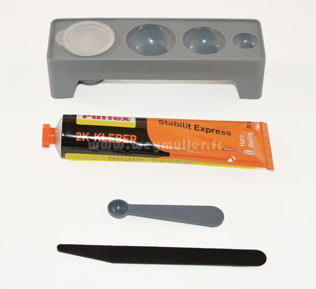

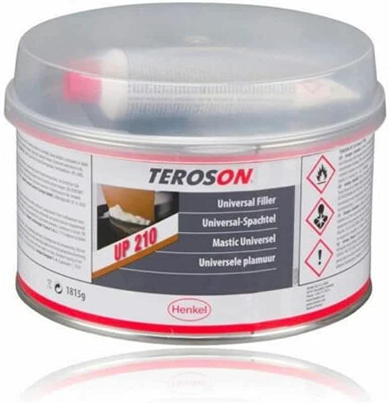

there is also this type of glue, 2 components, can be drilled, sanded, etc. once dry, ideal for plastic, otherwise Tamiya
Mastic carrosserie

Two-component "finishing" car body putty is my way. One-part modeling putty like Tamiya tends to shrink.
